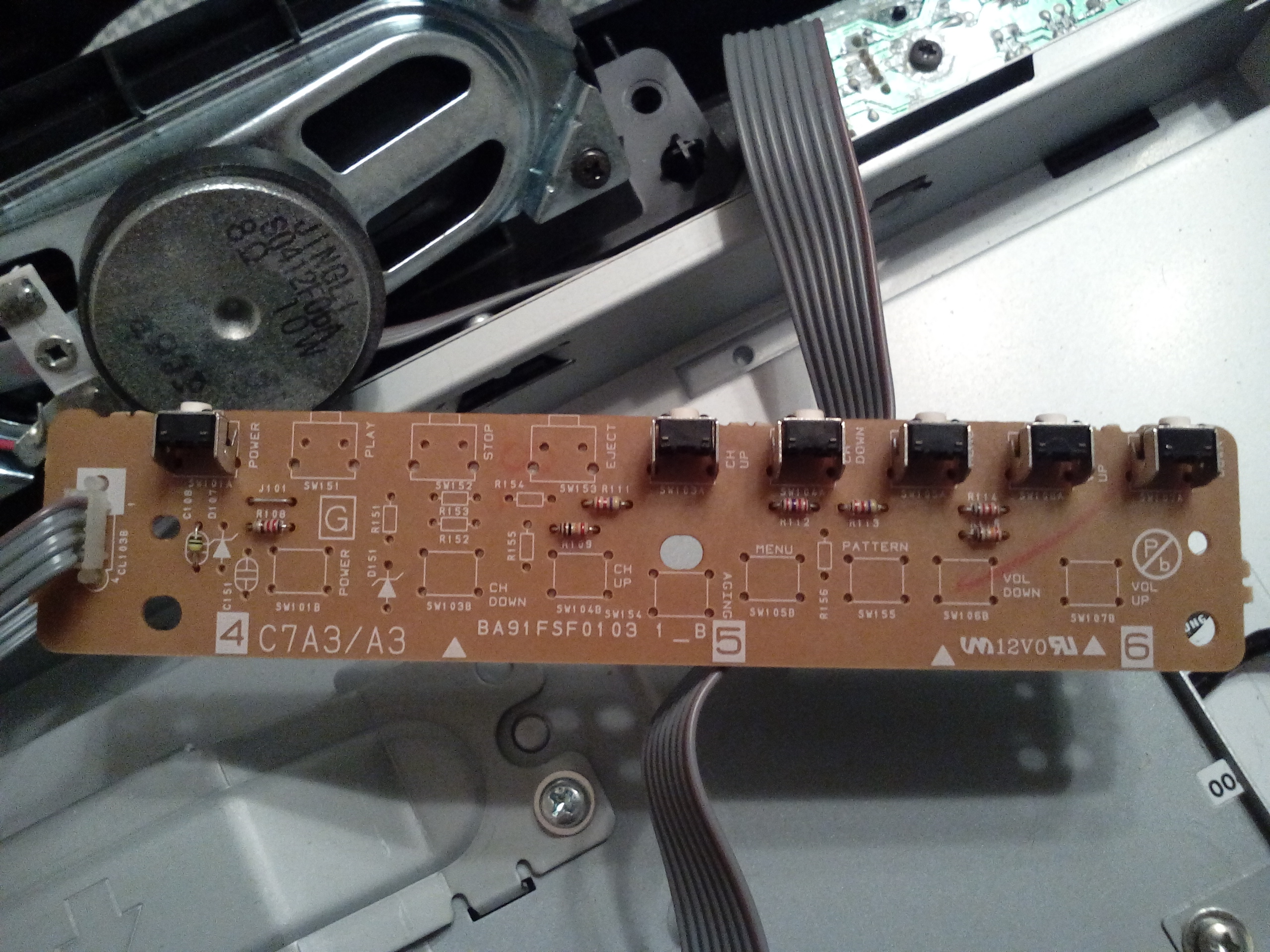

        I have seen those tactile buttons go shorted and other wacky things, and they don't show as shorted consistently when tested with a meter.
        I would certainly try the set with the buttons disconnected. Just desolder the cable.

                                  i think the easiest thing for you to do is lift 1 leg of r114. you will have to confirm, but it looks like it feeds from the volume up button. this way you will only have to lift 1 pin and still have access to the power button.

                                      upload a good clear pic of the left side of the board (i think. the area around the volume up button.) and we will confirm that it is the right resistor.

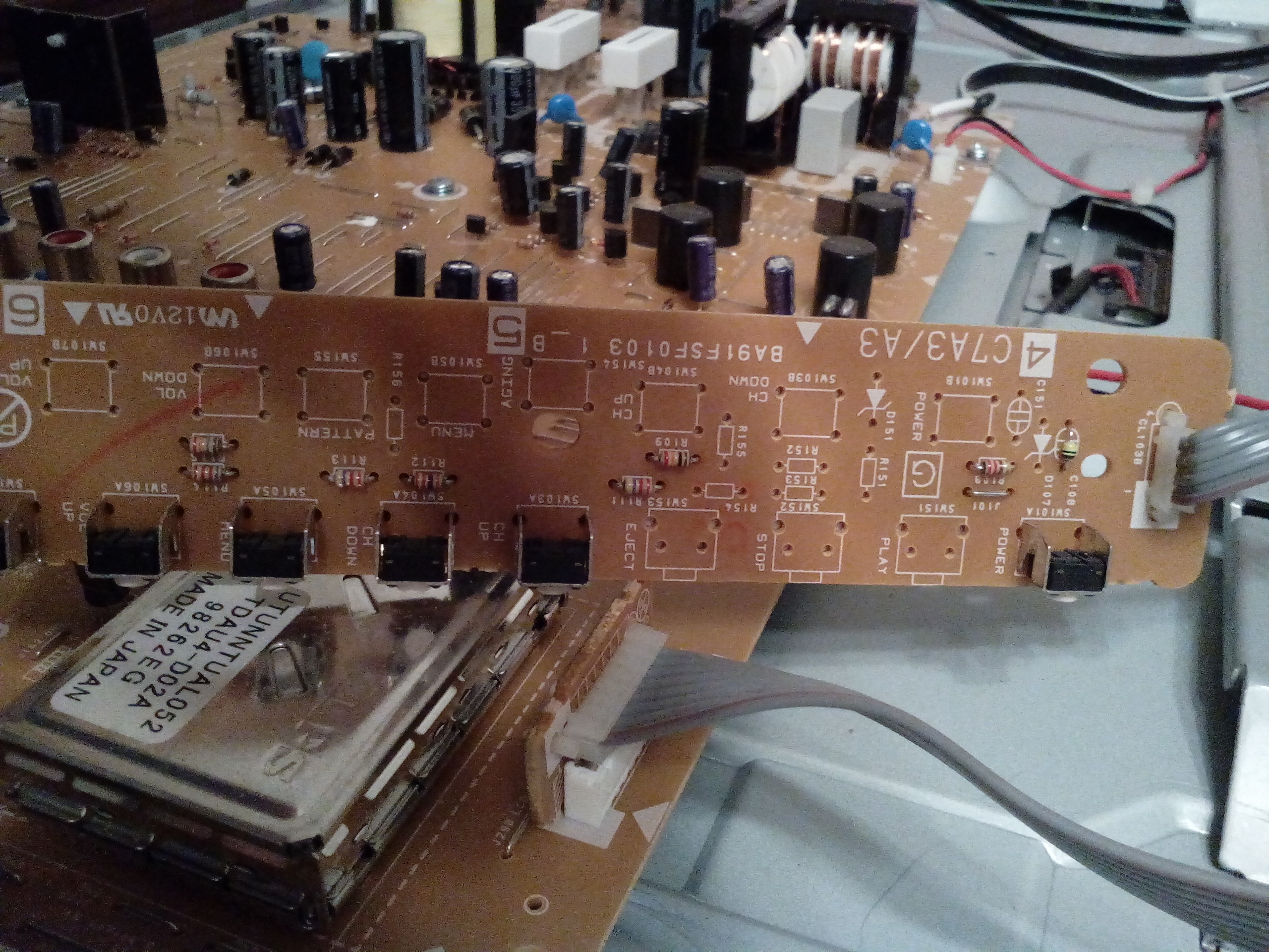

                                        here's 2 I hope theyre good enough

                                          we really need to see the underside to see the traces clearly.
