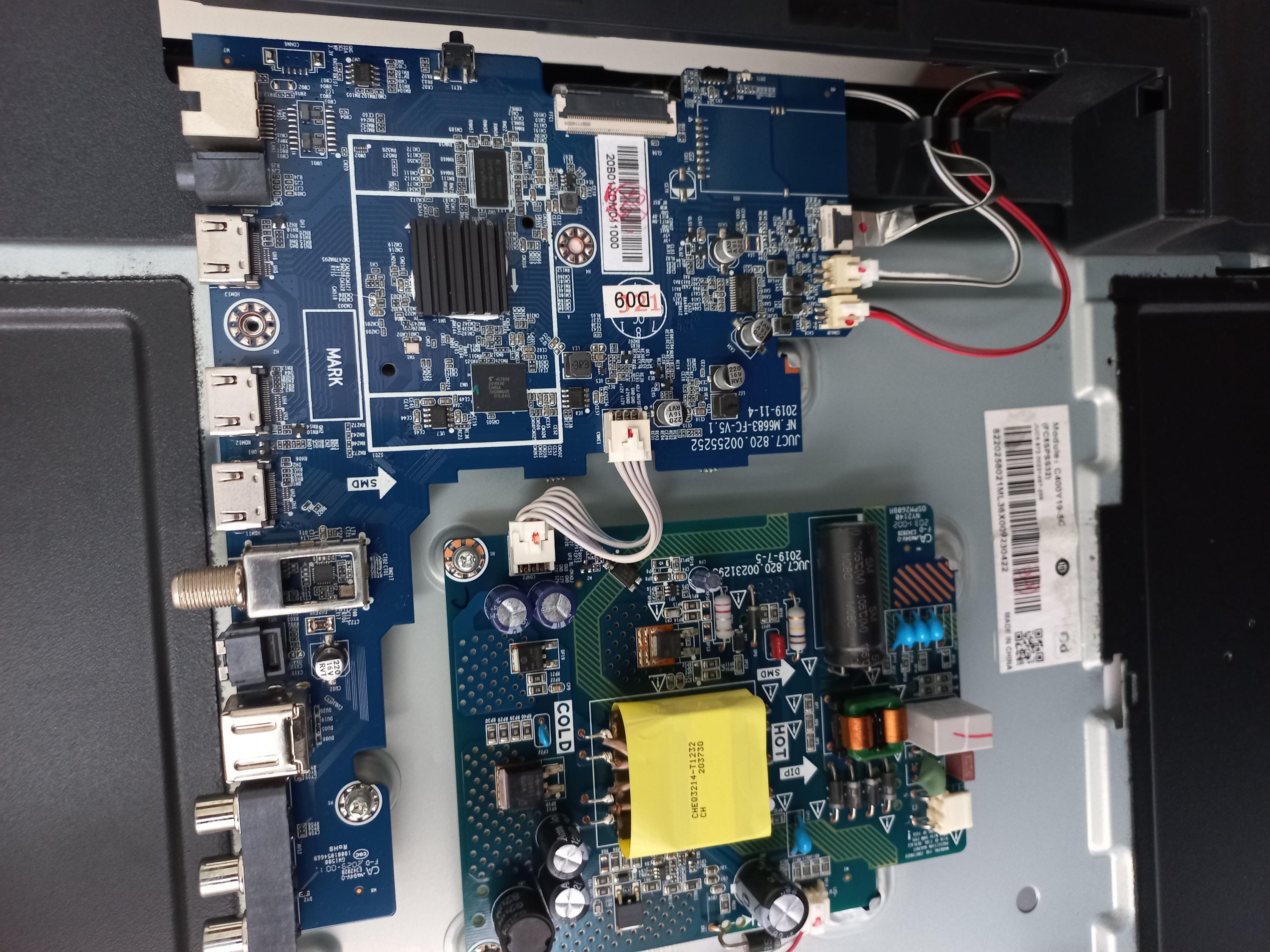

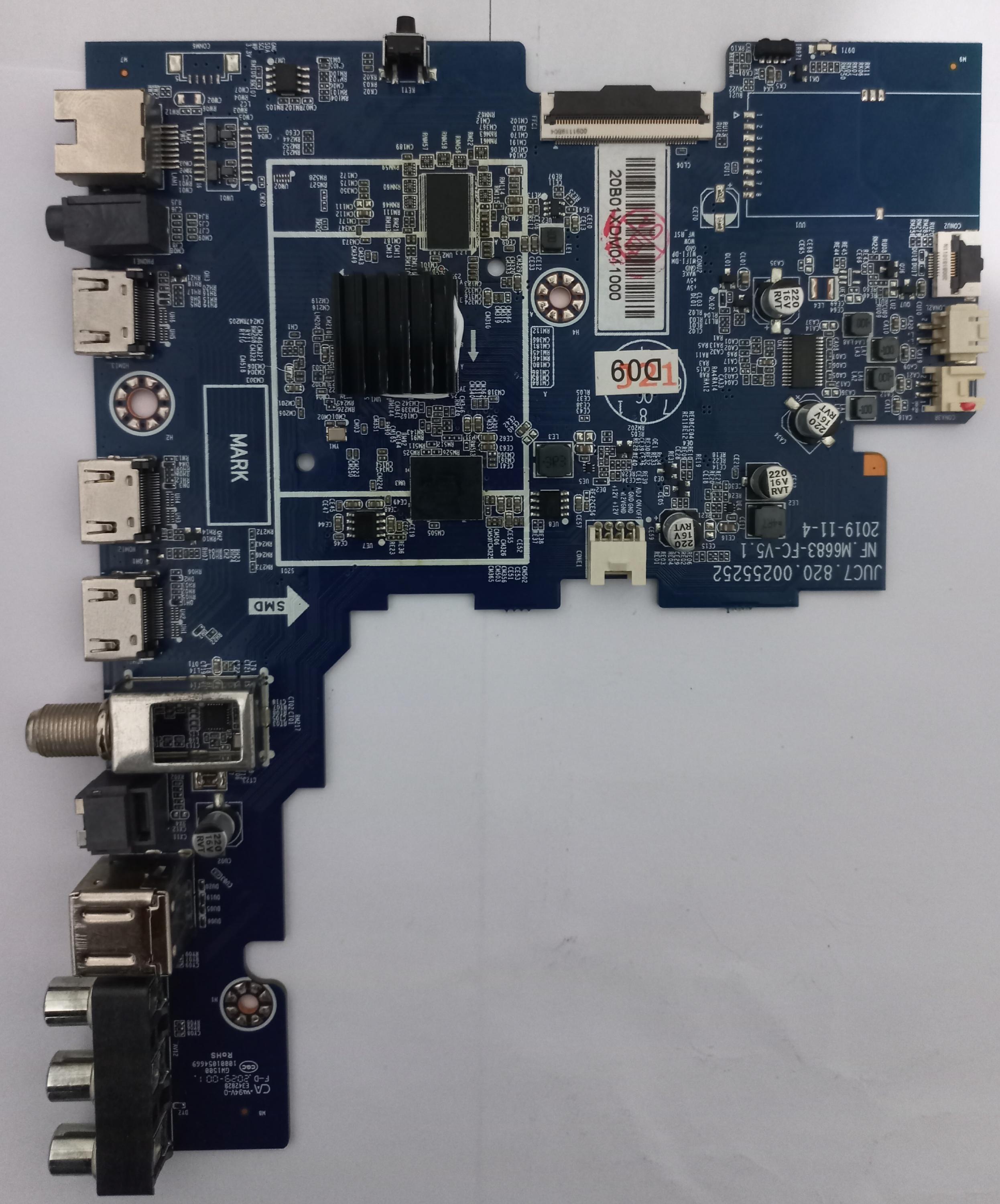

    Hello esteem members,
    I have a JVC Television that fails to turn ON sometimes. The stand-by red light is always on. When the TV turns on the the JVC logo displays then the TV attempts to scan for local channels...it then freezes. If I unplug it, then it refuses to turn on - stand by light on. The power supply input voltages are present - 12V, with the backlight 0.32V when the TV refuses to turn on. Backlight voltage is 2.98V when TV does turns ON. All regulator chip has 3.3V on pin 8. Processor voltage - 1.02V, Ram - 1.5V. I am thinking about reflowing the on-board RAM. When the TV was ON I was able to perform a factory reset but this did not fix the problem. The wifi was connected however youtube, Netflix and the browser did not load - screen went blank (backlight led still ON from the back). The capacitor on the power rail to the Processor has a resistance of 5 ohms which I thought was low but voltage injection at 1V, 2A on the capacitor shows approximately 200mA being drawn. I would like a schematic of this board and any possible guidance in determining the root of hhe problem.

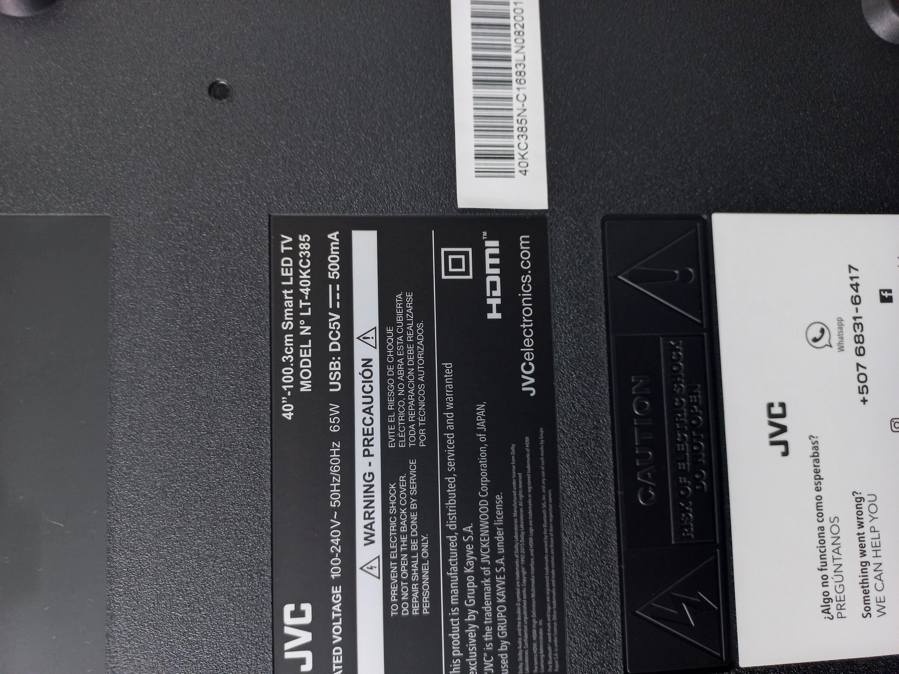

      Is that model number accurate?
      • netgearnetgear
        • Mar 2022
        • 33
        • Trinidad
        Re: JVC 40" LED TV (LT-40KC385) - Turning ON sometimes (stuck on loading, menu etc.)
        Yes.

            Ok..thanks. I measured the caps in diode mode around the eMMC (NAND Chip) but none are shorted, so is it safe to assume that the software is corrupted? Do you th8nk I should still reflow the RAM chip?

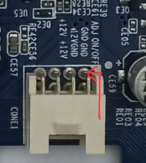

              When it freezes the backlight stays lit? Trying to understand how voltage to backlight is only 2.98. Like a backlight on pin? Or you measuring the voltage from top right connector?(second pic)
                              Hello, the voltage is on the power connector pin. See pic attached. O.32V when the TV is off and 2.98V when the TV is on.
                              Update: I reflowed the NAND chip, however, it made no difference.
