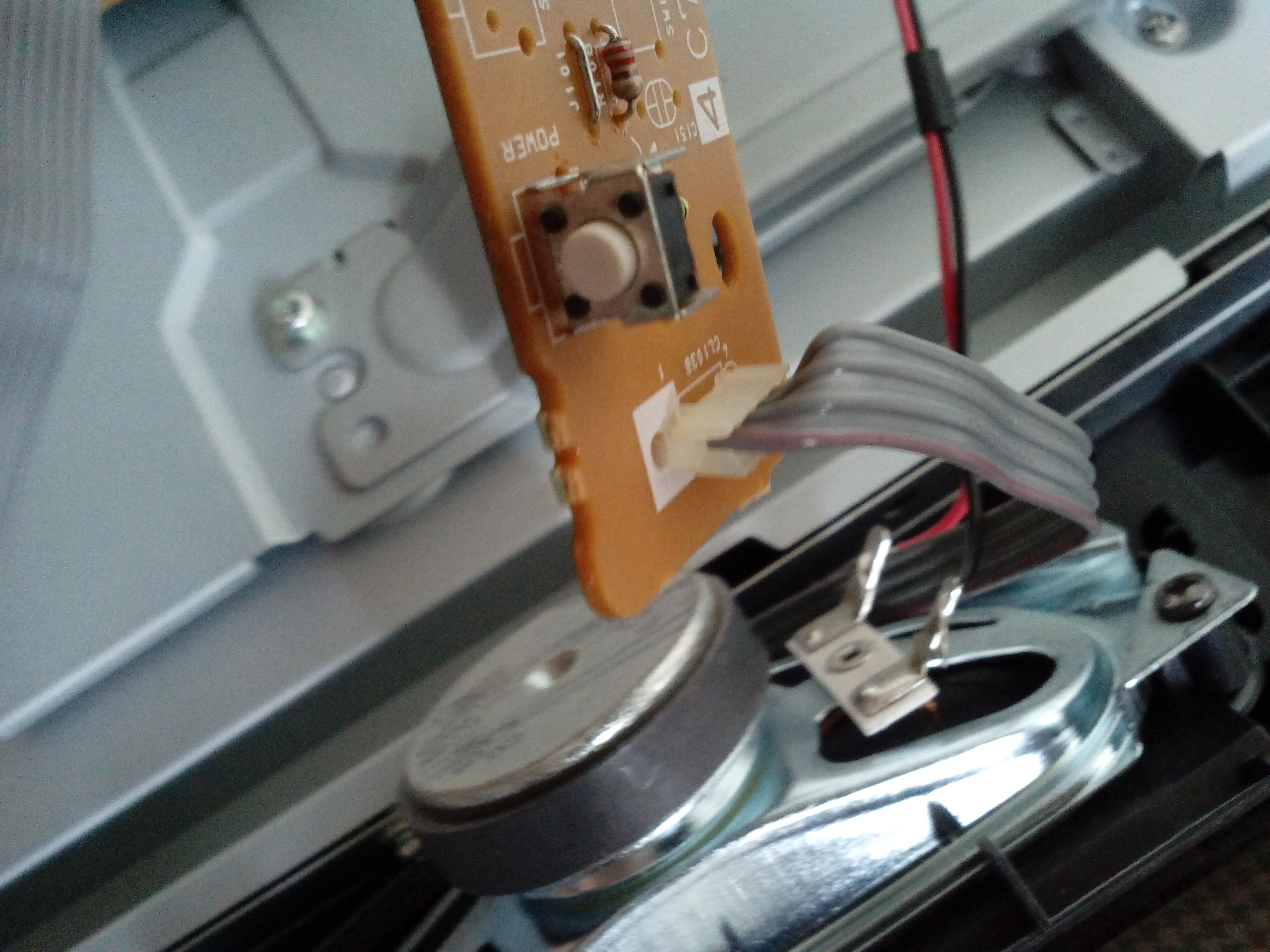

    Magnavox 32MF369B/F7 volume stuck
    2 calls to magnavox and that was a joke.
    Anyway, this tv has a problem there the volume is stuck on 100 and I can't access hardly anything in the menu. It's making it seem like a button is stuck, but the buttons move in and out freely. I was going to just disconnect the menu board and run a new remote, but the plug is soldered in and runs to another board, which runs to the main board, all soldered and not able to be simply disconnected. Like I said I have a new remote that needs to be programmed but I don't think that will work at this point. I have a video here of the menu issue and you can see it's stuck on 100 volume.
    it's been sitting for months so that type of reset is bleak.

                Re: Magnavox 32MF369B/F7 volume stuck
                most boards have a connector on so you can just unclip the board can you take some pictures and upload them so we can see what were dealing with.

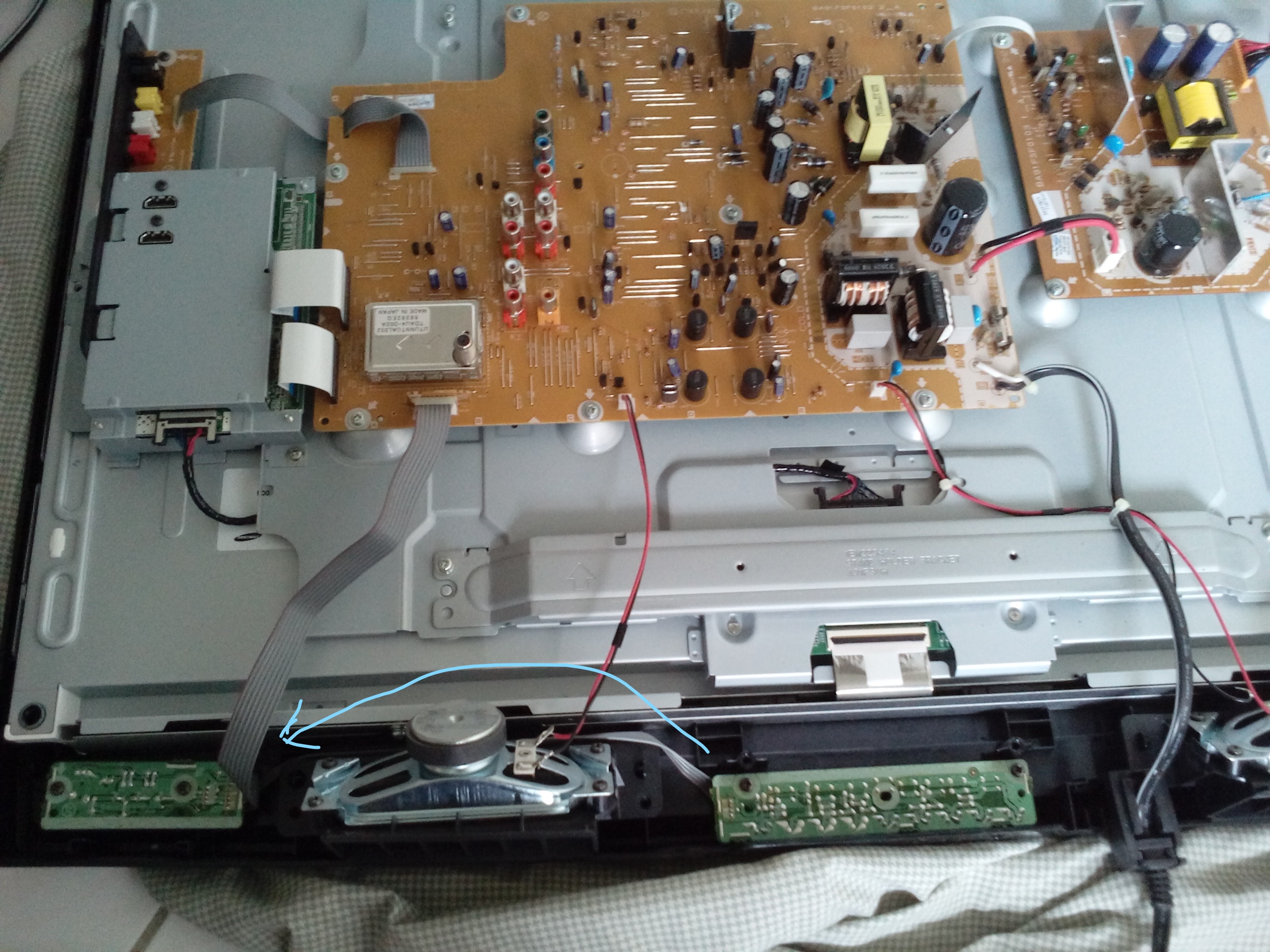

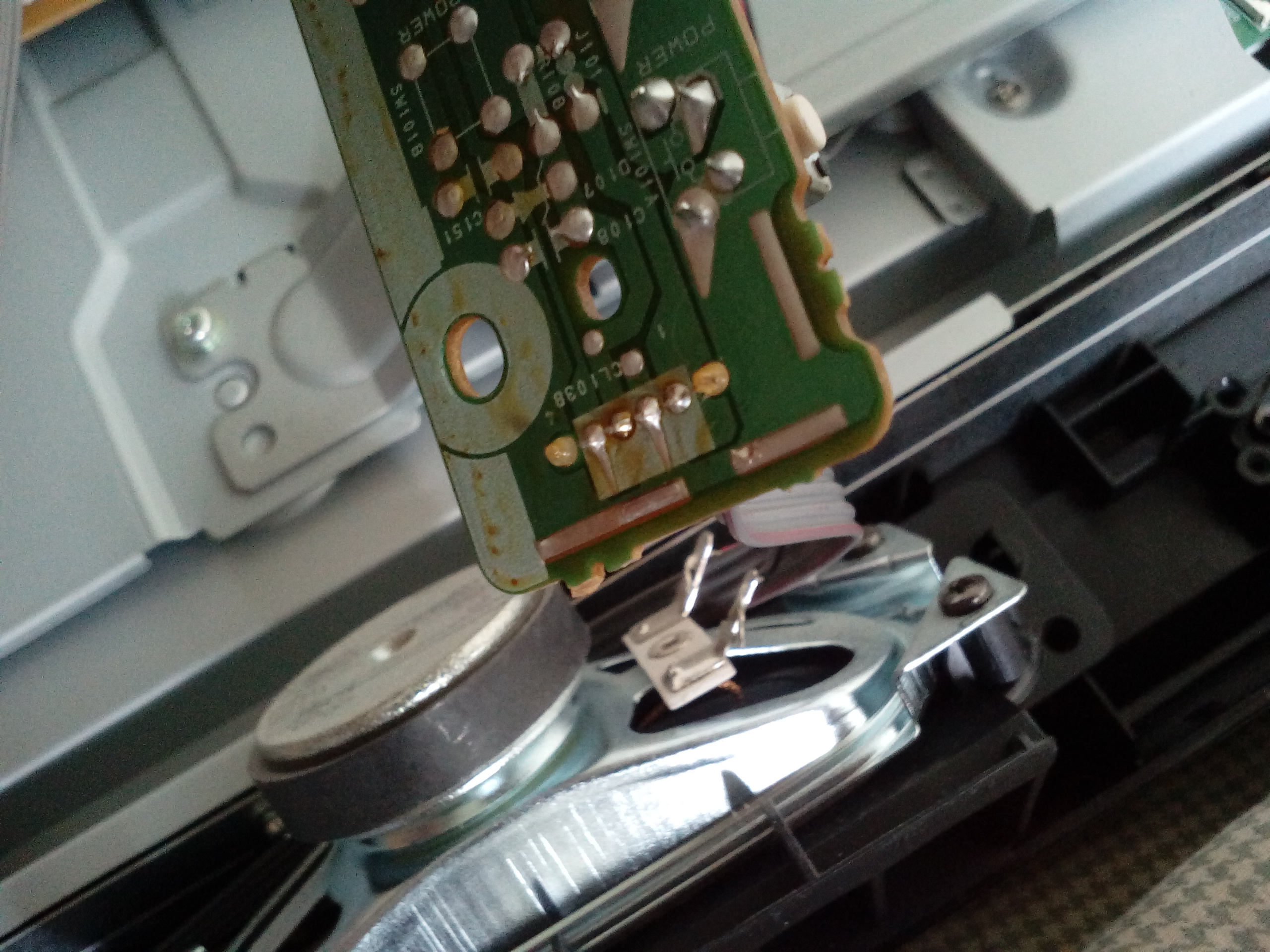

                  here
                    Unsolder the button and test it, may be the quickest way without messing about with the cables.

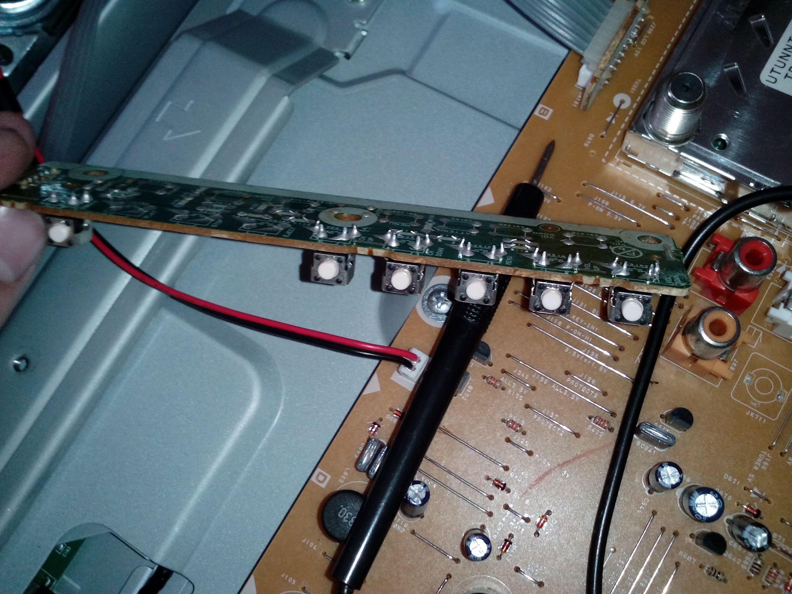

                      maybe test each button with a multimeter see if any are stuck.
                              ok I went and tested this thing just now. here are my findings.
                              volume down .69
                              volume up .69
                              menu .69
                              channel down 1.05
                              channel up 1.40
                              looks like channel up is electrically stuck, but why is channel down in the middle?
                                I don't think you can test it like that. It may be providing a pulse train signal. Better to test each of the button contacts using your meter set to ohms with the set off.
                                  ok I tested ohms 200
                                  volume down 1.3
                                  volume up 1.3
                                  menu 1.4
                                  channel down 1.3
                                  channel up 1.4
                                    Can you post a picture of the buttons as in Post #9 to see if they are all similar to the 2nd photo.
                                      they are
                                        They are tactile buttons and when pressed should read short circuit (0 ohms or just a few ohms) between 2 of the 4 connections and high when not pressed.
