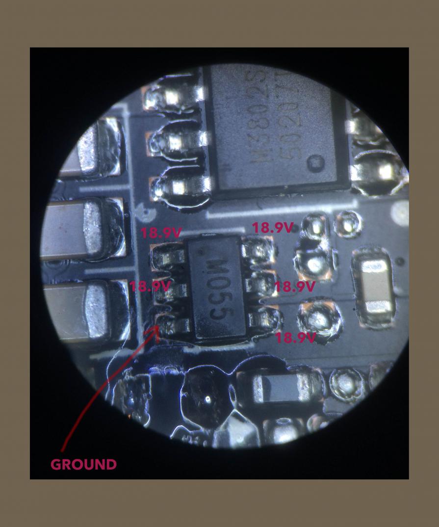

    Nvidia Shield TV, No Power. i've found the culprit. please help ID this chip.
    the markings on this chip is M055 could be Mo55. i think its a MOSFET.
    i've checked against a good known working board.
    Good chip
    pin 1,2,3,4,5 = 18.9v
    pin 6 is ground = 0v
    Bad chip
    Ground pin is giving out 17.5v -- should be zero
    pin 1,2,4,5 = 2.8v
    pin 3 = 18.9v
    can anyone help me ID this chip please?

    Re: Nvidia Shield TV, No Power. i've found the culprit. please help ID this chip.
    To have that much Voltage on the GND pin it means that the GND is not having connection to circuit GND, so you need to check the resistance between GND pin and the circuit GND, it should show <1 Ohm if it is an actual circuit GND.
    So are you sure that pin is connected GND, and it is MOSFET for sure?
    Pin 3 is G (GATE), not GND per your spec of the MOSFET so I doubt that it is connected to circuit GND.
    BTW, I doubt that the sub you link to is correct becuase pin 1, 2, 5, and 6 are directly connected together for the Drain (D) so your reading as shown in your post 1 does not match the MOSFET of the link:
    Good chip
    pin 1, 2,3,4, 5 = 18.9v
    Also, the pin you named GND in the picture is pin 3, not 6.
            Well, great that you made a chart of the voltages. Your conclusion that the chip is bad is incorrect. There is no way that the "ground" part of that circuit could be raised to 18 volts without a pcb break. I'm assuming that your "ground" or black mm probe is placed at the same spot in both cases? If you turn off the set and measure resistance between the circuit "ground" and the Source of the FET, I think you will find it to be open. Possibly the solder pad itself has covertly cracked around the FET pin, or somewhere nearby the pcb has developed a crack. Resistance checks will locate the fault in no time.
              M055 comes up as a Ricoh 5.5v regulator.
                  thats a mosfet switch.
                  it is turned off by the high gate either because it is shot or its control circuit is turning it off.
                            Hello!
                            I have the same problem on a Shield TV 2019...
                            It seems not an easy task to identify this chip.
                            On some boards it is labeld as Q16.
                            My defekt chip is pictured here and has the following description on it.
                            D5CL 14
                            So we have...
                            M055, 1052U and D5CL 14
                            This bastard seems to have multiple identities ;-)
                            Hope someone can identify this culprit...
                            I'm running out of options. :-)
                            • lotas
                              • Jan 2016
                              • 4708
                              • Russia
                              1052U - 105xx - APM2605C
                              D5CL - D5xx - AO6405
                              • gerry1980
                                • Nov 2021
                                • 6
                                Thank you very much !!!
                                Ordered some of those. I will report the result of my repair attempt.
                                kind regards
                                Gerry
                                  Hello again,
                                  I'm back with some results and my learnings, which I will share with you.
                                  The mosfet was indeed damaged,
                                  but it was damaged because of another problem in the circuit.
                                  The real culprit was a shorted ceramic capacitor.
                                  I was able to find it with voltage injection.
                                  1V, 2A. Black wire to GND,
                                  red wire to the drain of the MosFet (soldered a little wire to it).
                                  Then I was able to find the hot capacitor with alcohol, removed it and the Shield was alive again, but not totally fixed.
                                  The mosfet is like a switch to interrupt the powersupply if something in the circuit is shorted. So the mosfet is not conductive if the powercontrolchip recognizes something is wrong. But my mosfet was also damaged because it was conductive all the time.
                                  The dogdy way would be to let the damaged/bridged mosfet, because Shield was working. But the protection mechanism would be disabled. So I replaced the mosfet also.
                                  And I learned something more from Sorins youtube channel.
                                  The mosfet in this case acts like a switch.
                                  So the only important things are:
                                  1. Same type, in this case a P-Channel.
                                  2. Manage the switched power..., in this case 19V, 3A.
                                  3. Same layout, pinout.
                                  With this information it is easy to find a fitting mosfet.
                                  Hope this is helpful for someone !
                                  kind regards,
                                  Gerry

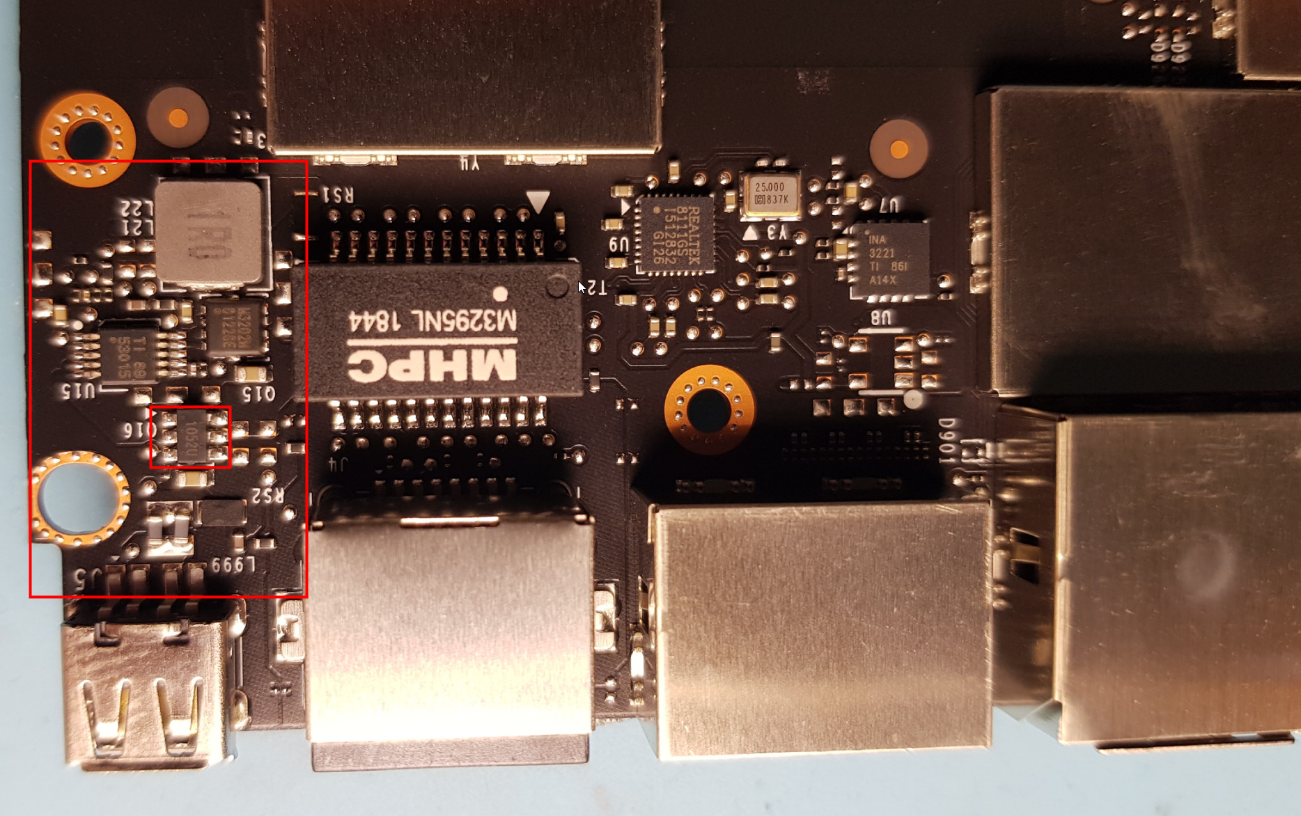

                                  • duder
                                    • Oct 2013
                                    • 26
                                    • canada
                                    I realize this is an old thread. I was hoping you could remember approximately where you found your shorted capacitor on this board. I have a short to ground on the drain of fet. It is taking a maximum of 3a at 1 volt, but I cannot find anything hot. Warm, but not hot. I once found a shorted cap on an xbox board with the temperature probe on a cheap multi-meter that I could not find with my finger or alcohol. Thanks in advance

                                      Gerry,
                                      Just wanted to thank you for sharing your findings. Following your steps, I found the shorted cap. My shield is alive after collecting dust for the last 2 years!
                                      Did you replace the cap as just leave it off?
                                      • soler88
                                        • Sep 2022
                                        • 9
                                        Here's the cap that was shorted on mine.
