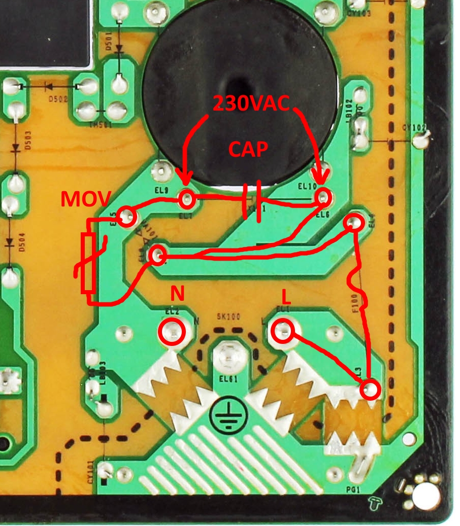

      Originally posted by budm
      Do you mean all these time you do not know where the power switch is? So how in the world you know that the relay is working?
      How about going to LG website and down load the user manual?
      So you telling me i need to coonect the man
      Inboard and everything else and try to pit on 230vac try to set on tv and after thst i need to look for bad part ? I will try to remove the surge protection and i will check the board under voltage again if the voltage will go after because now i have voltage only on main gray filter cap i will replace the surge protection with cable for test

              Someone needs a chill pill
                #47
                Re: LG 42LW4500-LB Need help with repair of PSU
                Well what do you think?
                Post 39: "Where I can found the power switch ? It will be good if you have some scheme for this board ."
                Post 42 "I will try to remove the surge protection" still try to deal with MOV after all the explanation?
                We are over 40 posts now an still no answer on the PWR-ON signal pin. If there is no PWR-ON form main board then the Main board will have to be checked, but at this we do not know if we have that signal or not. May be after he finds the Power switch?

                  #48
                  I just remove the surge protection and TV starts LCD shine i also hear click of rele so maybe i will try to do this with this surge protection again .. and chill man I know Iam dumbass maybe but i made progress and it starts shine before it do nothing just turn off imidietly
                    #49
                    Well, you are not making any sense since as explained, the MOV is connected in parallel with the cap which you have measured 230VAC between the cap's legs, the MOV has nothing to do with the TV functioning, more likely you have disturbed bad connections or connectors that may not be seated properly or loose mounting screws holding the board to make the GND connection to the chassis, etc..
