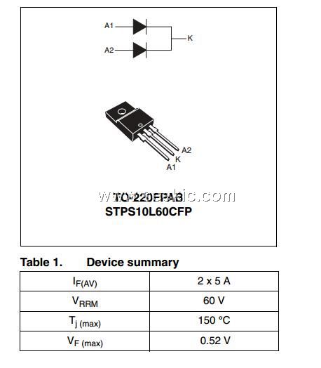

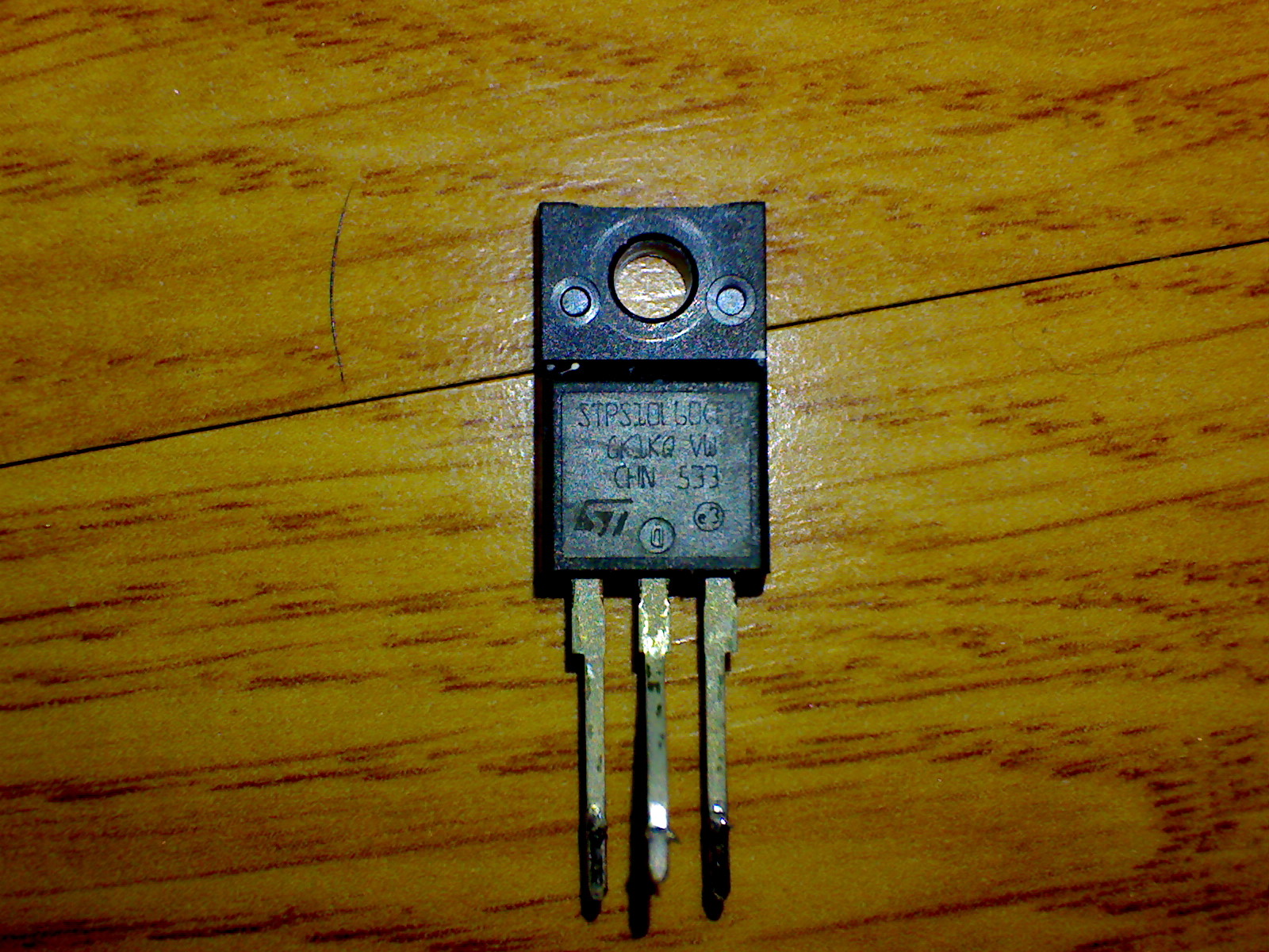

                        Is this a Schottky, as I think?

                            I would expect the STPS1545C to also fail. Which pins were shorted together?
                            The left and the middle pin are shorted together(A1 and K).(when we look at the front side of the shottky).
                            First of all - IS this a shottky, as I think? Please, look at the photo I have uploaded.
                            The second one - I think that the problem is perhaps overheating. Because I dont see any voltage on the secondary, that could exceed 33V
                            The third - Am I correct in my conclusion about the transistor used as diode?

                              The STPS10L60CFP is a Schottky diode
                                So, you confirm that the electronic component on the photo I uploaded is a double shottky diode? And as we saw, it shortcircuited on the side, which is used, not on the side, where the trace is not completed.
                                p.s Will any double shottky with rating of minimum 5Amps at 60V will suffice?

                                  Yes, it is a double Schottky diode as show in the image post #32
                                  If the middle and left pin are in use then it is faulty because you have a short circuit.
                                  Are you certain the right pin is not connected to anything???? Can you post a picture of the underside where it is soldered into the board.

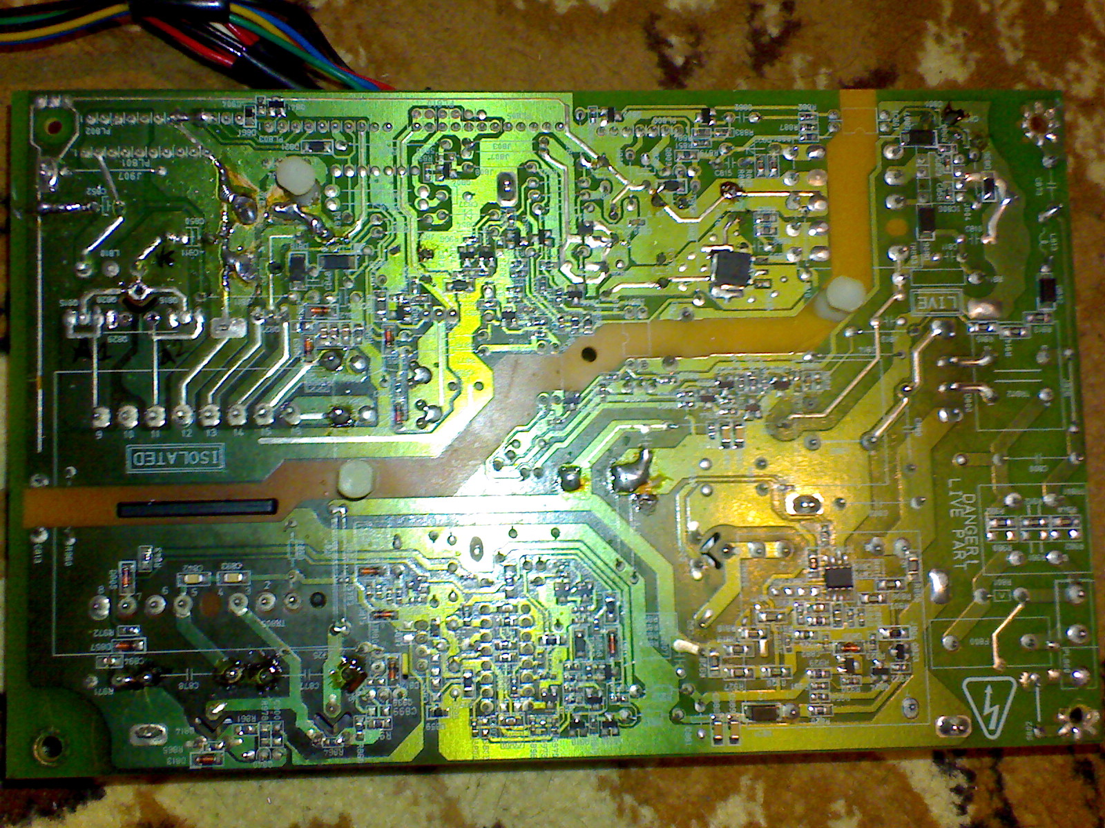

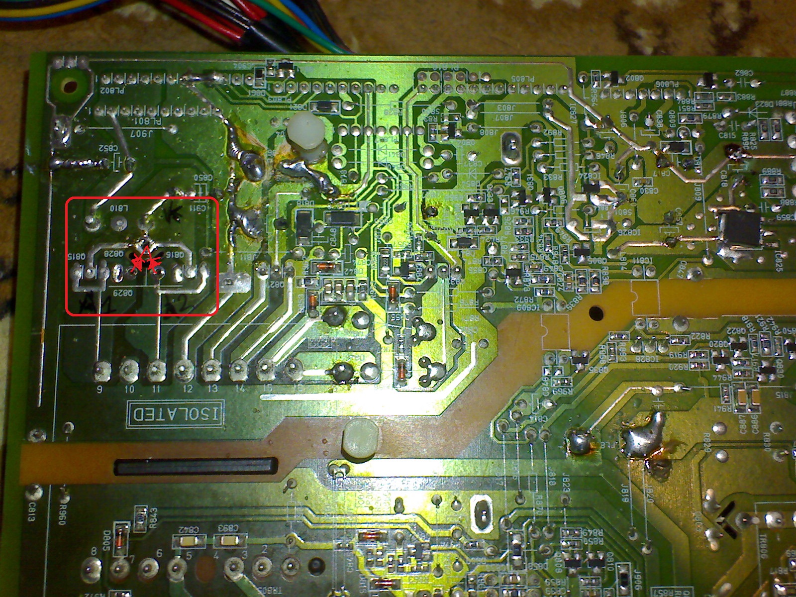

                                      If you post a picture of the underside of the board and mark the diode solder connections then that would help.
                                      It needs to be a clear and sharp picture. I do not know the answer because I cannot tell without the board in front of me or at least a good picture of the board.

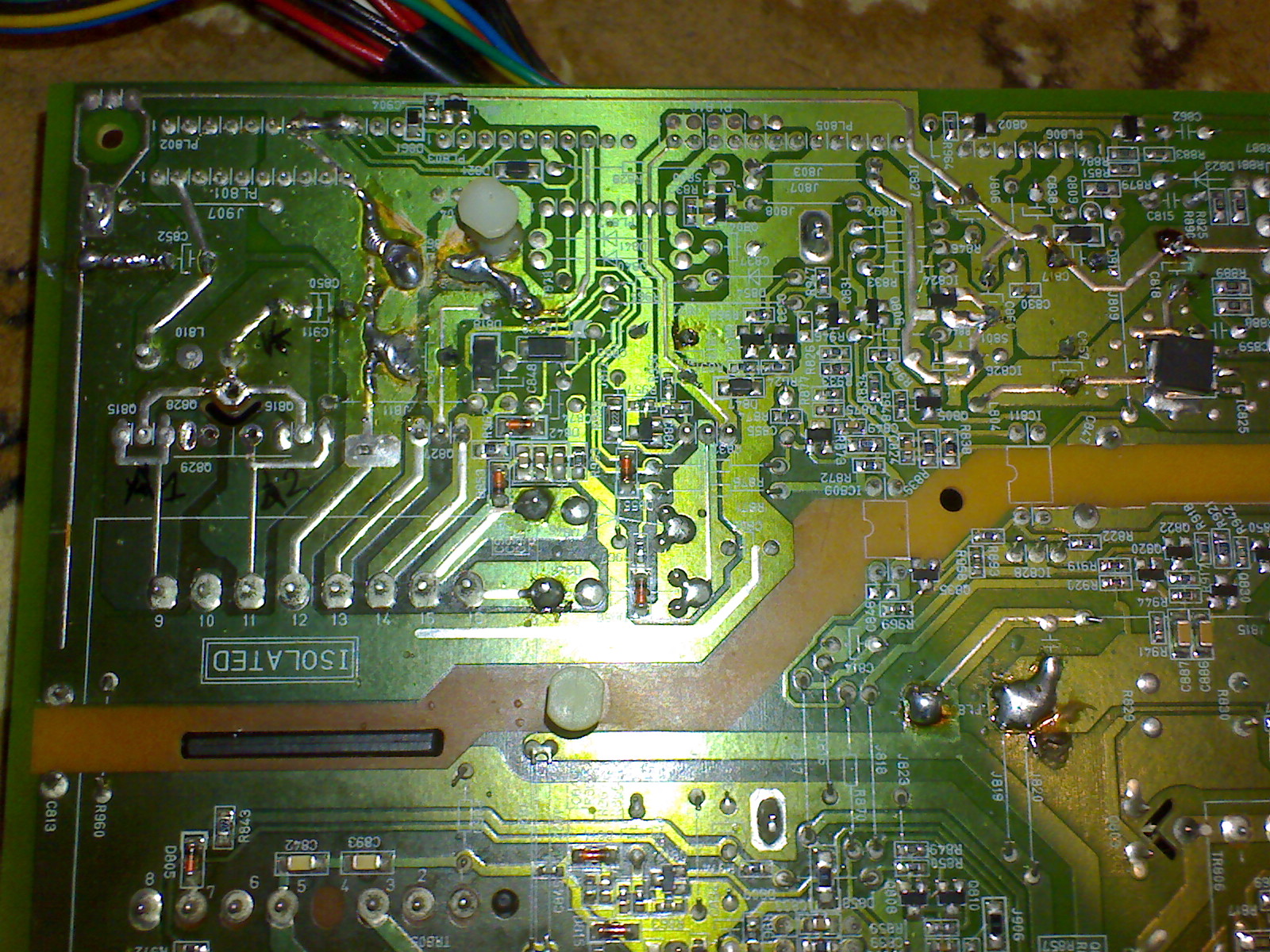

                                        #39
                                        Re: Crown CCT3207W(Vestel 17MB08P-5 chasis) stuck in standby
                                        If you post a picture of the underside of the board and mark the diode solder connections then that would help. .
                                        Okay! Here we go. This is as good as I can get. Just my phone sucks, when it comes to taking photos on artificial light.
                                        p.s better try with the second picture - 71.

                                          #40
                                          Looking at the position of the holes both diodes in that package are required to be working. I've tried to draw it on your photo. It need to be replaced.
