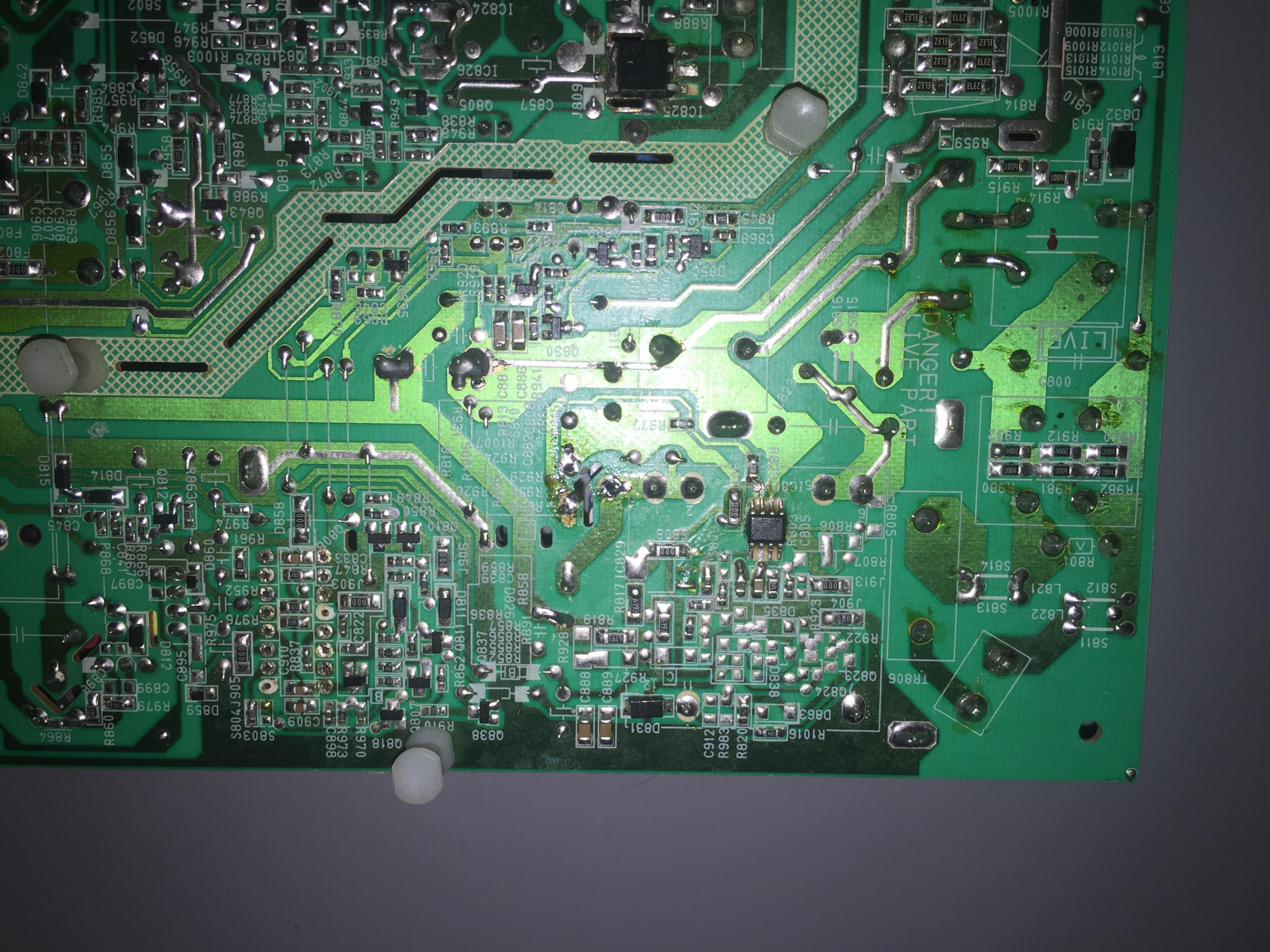

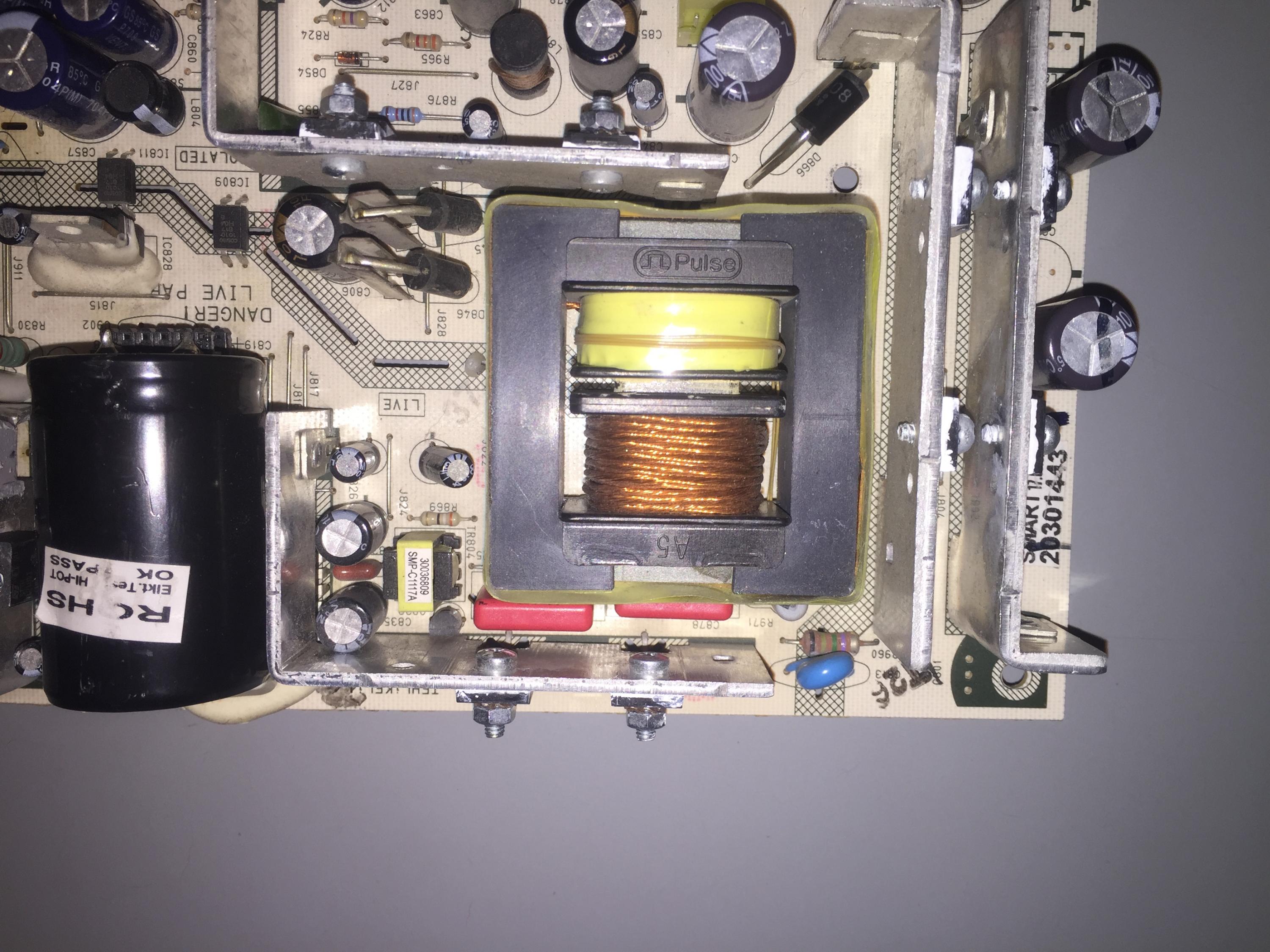

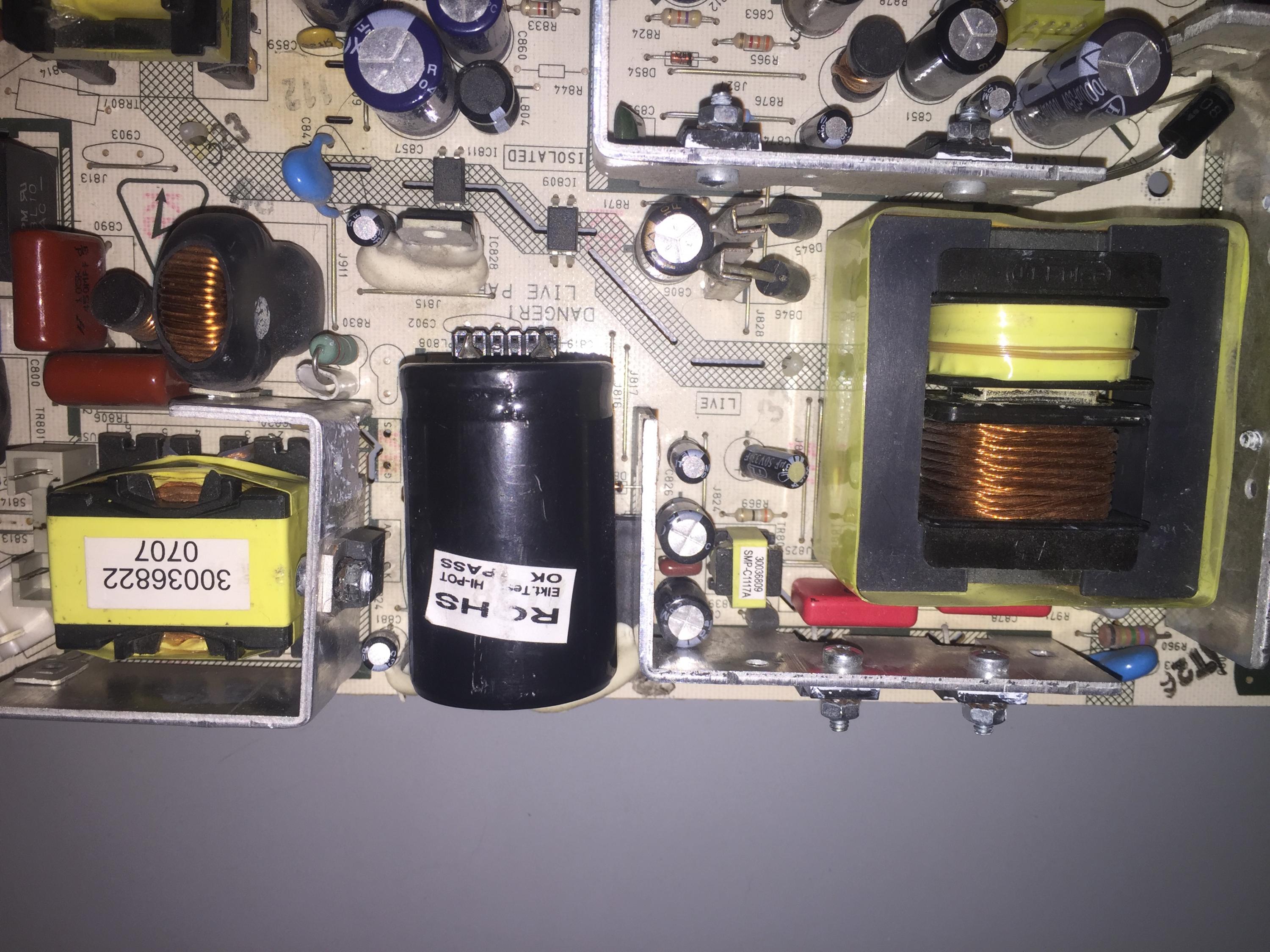

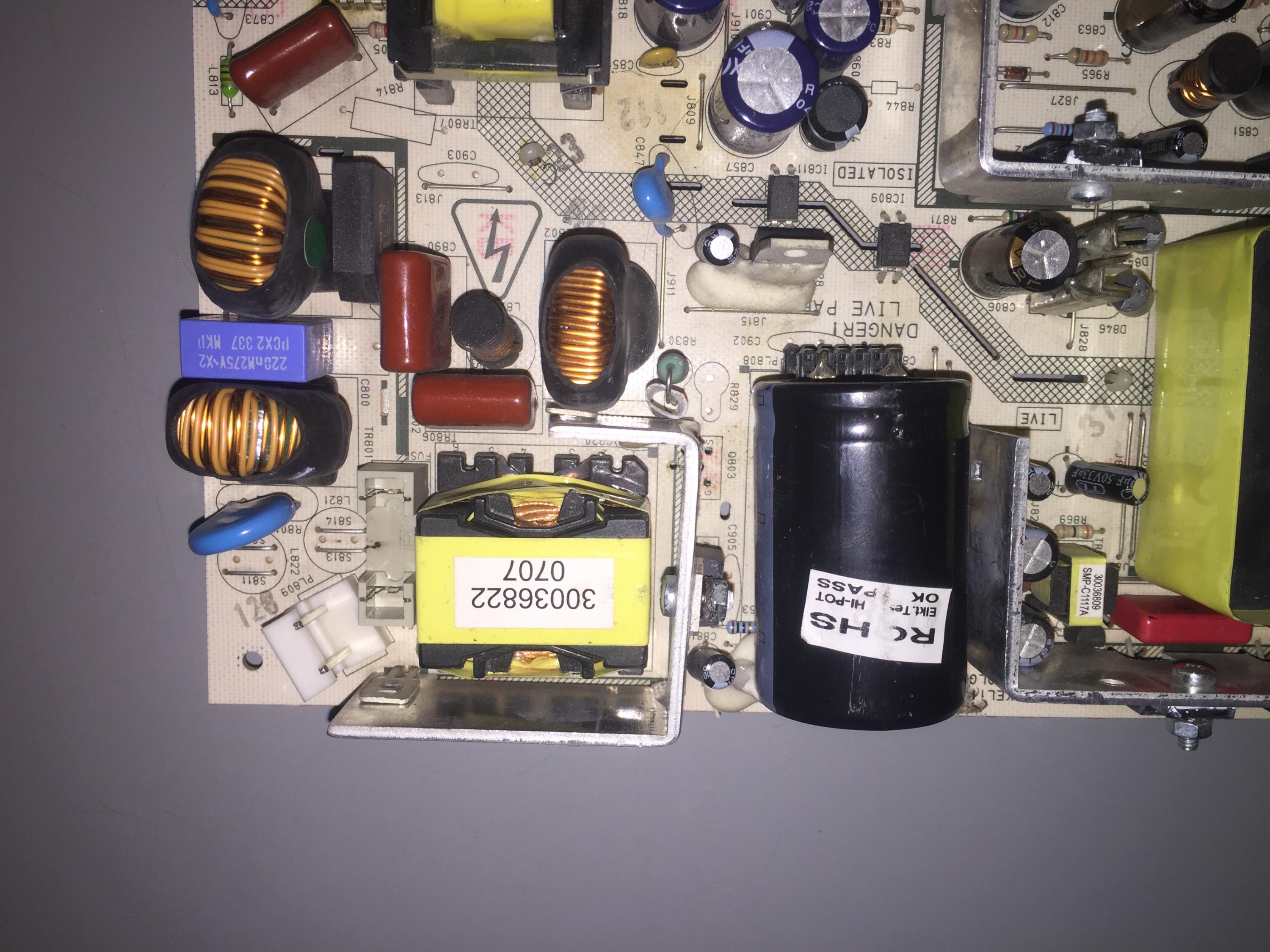

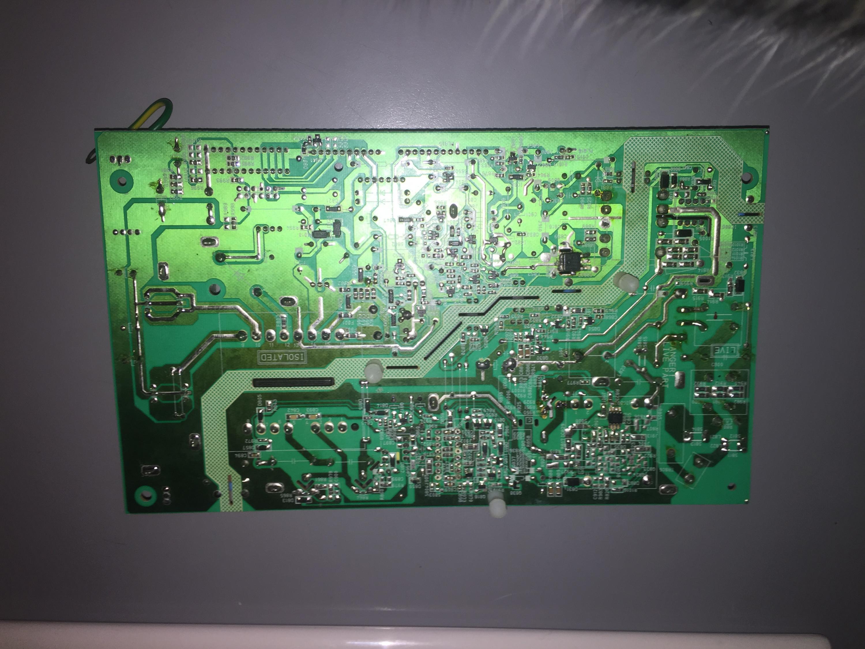

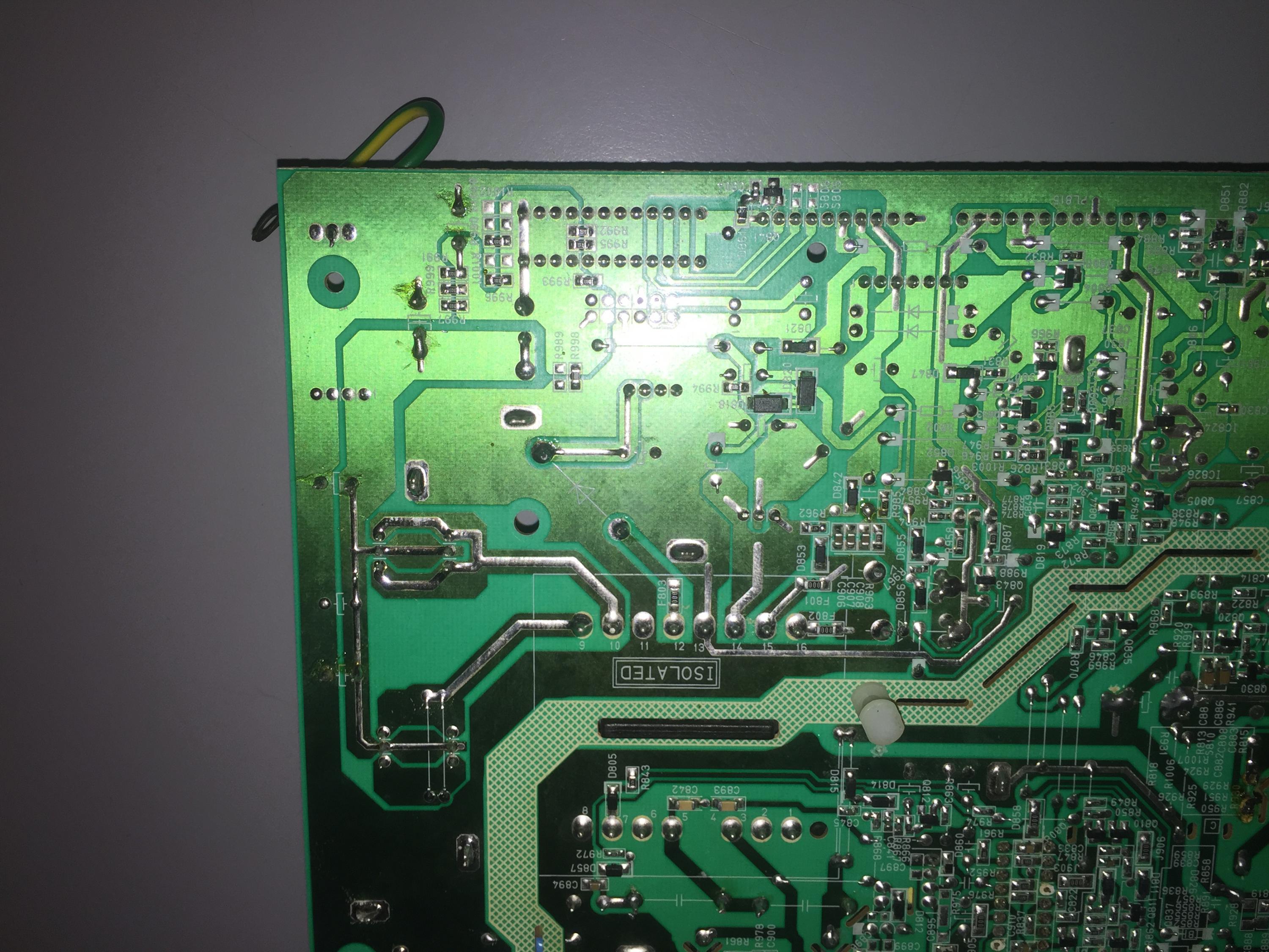

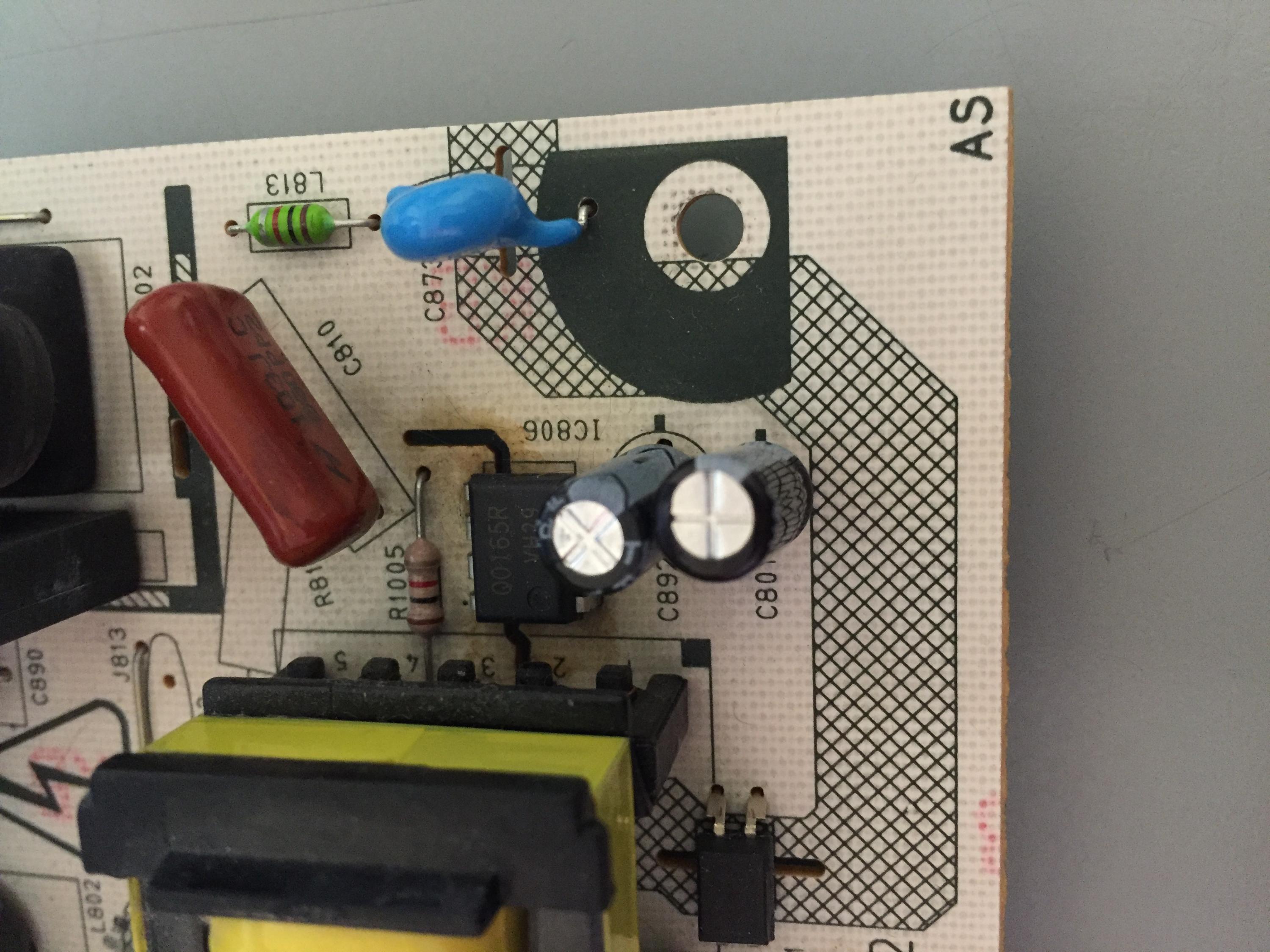

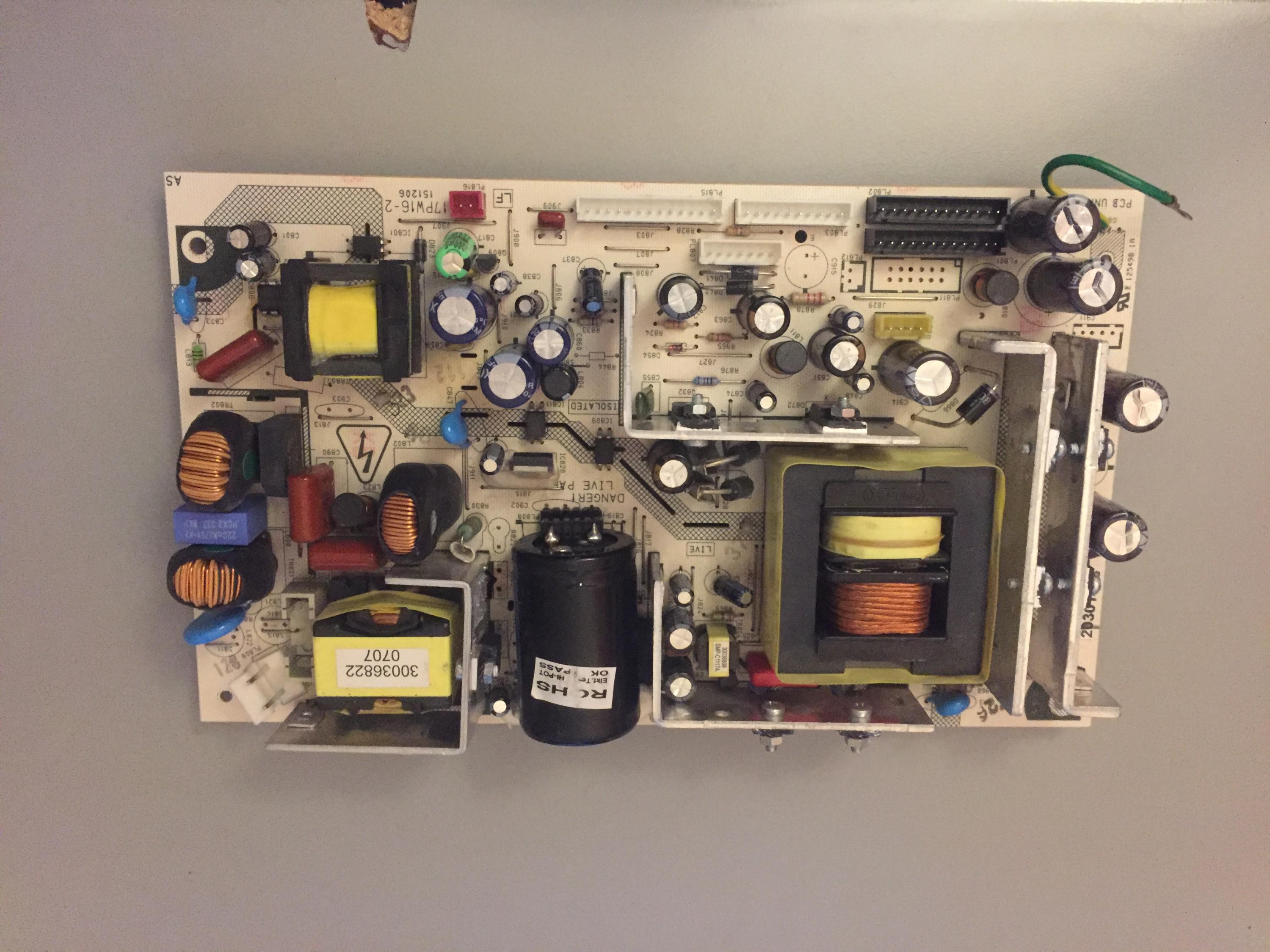

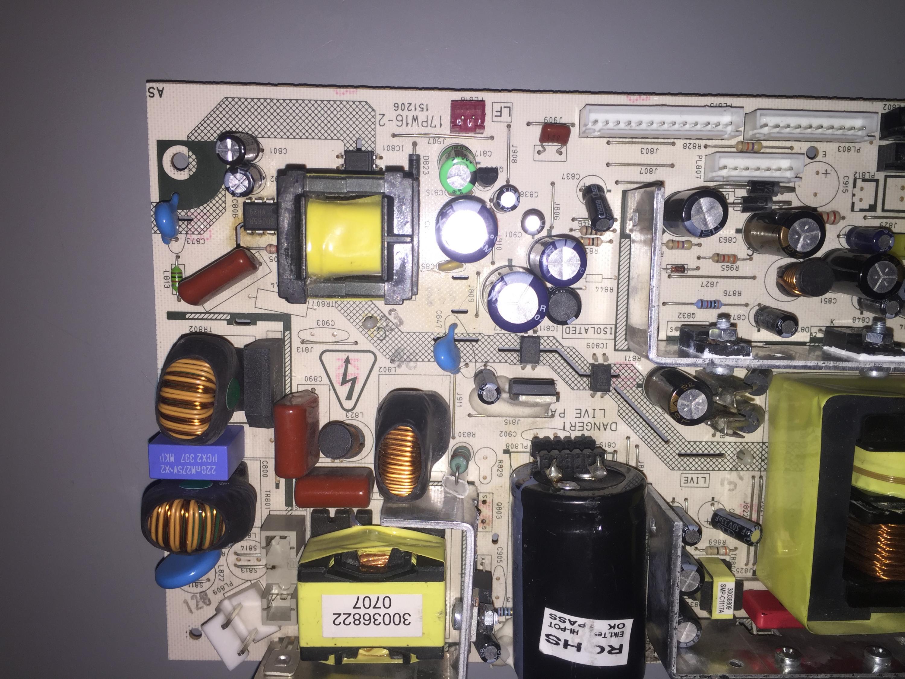

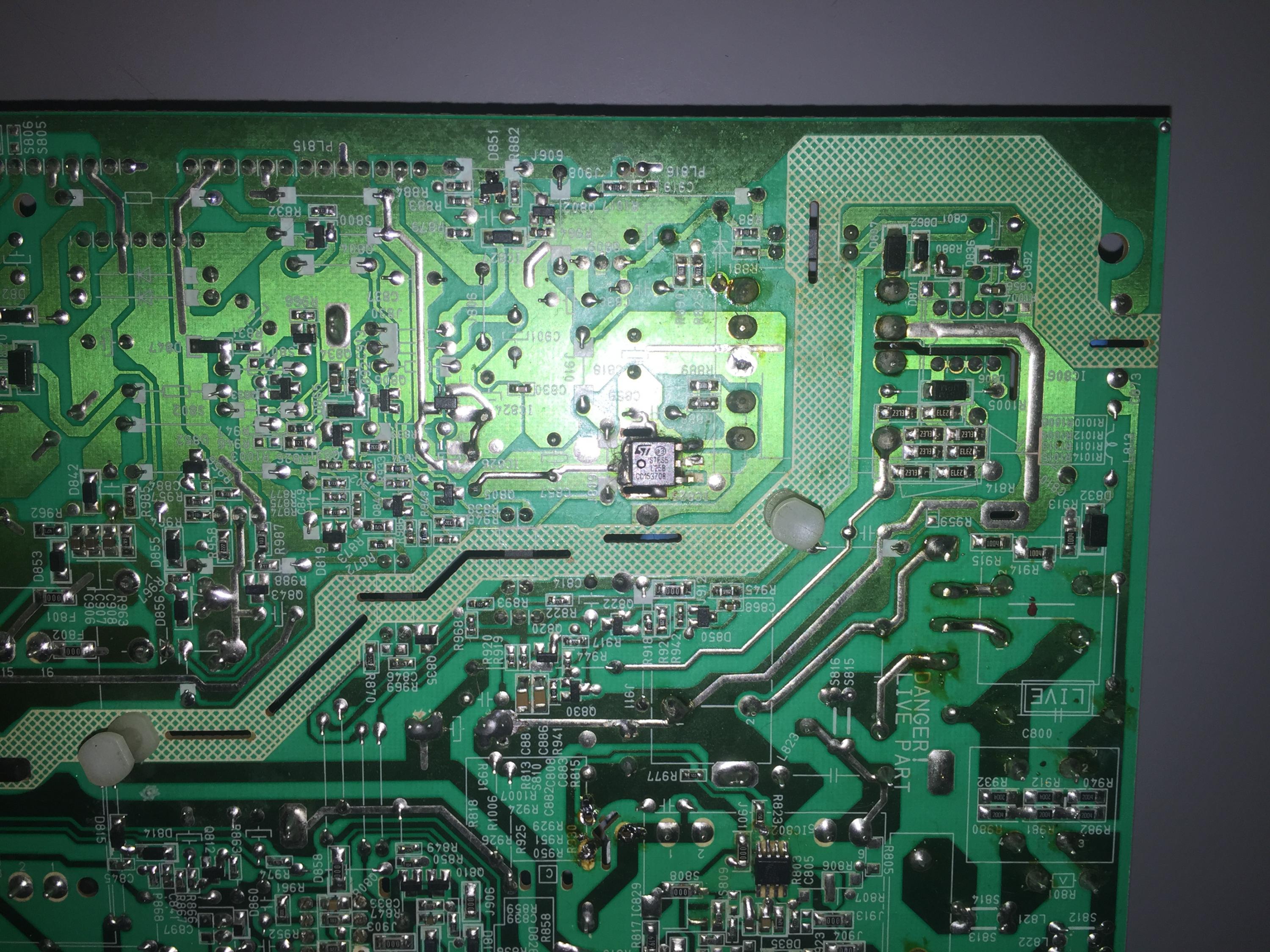

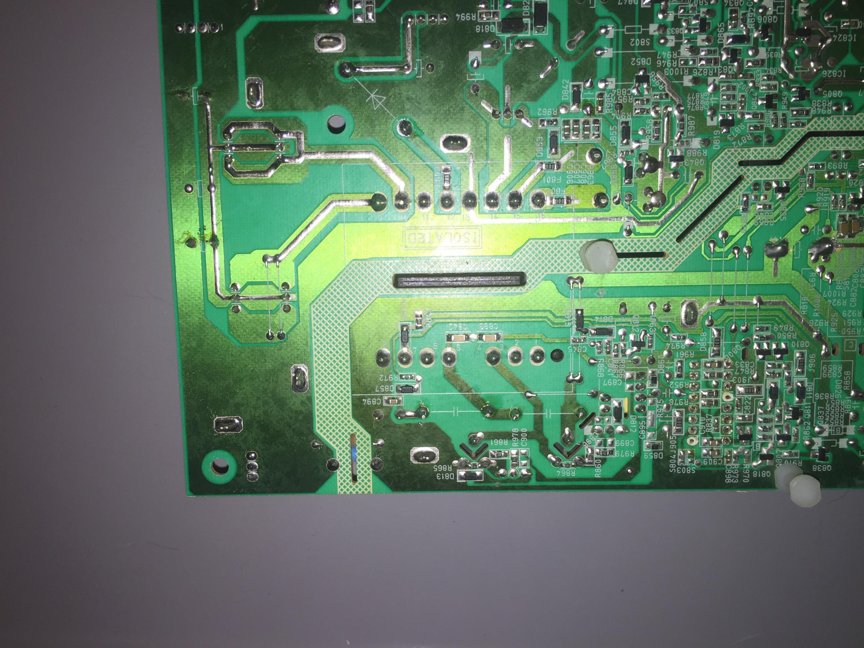

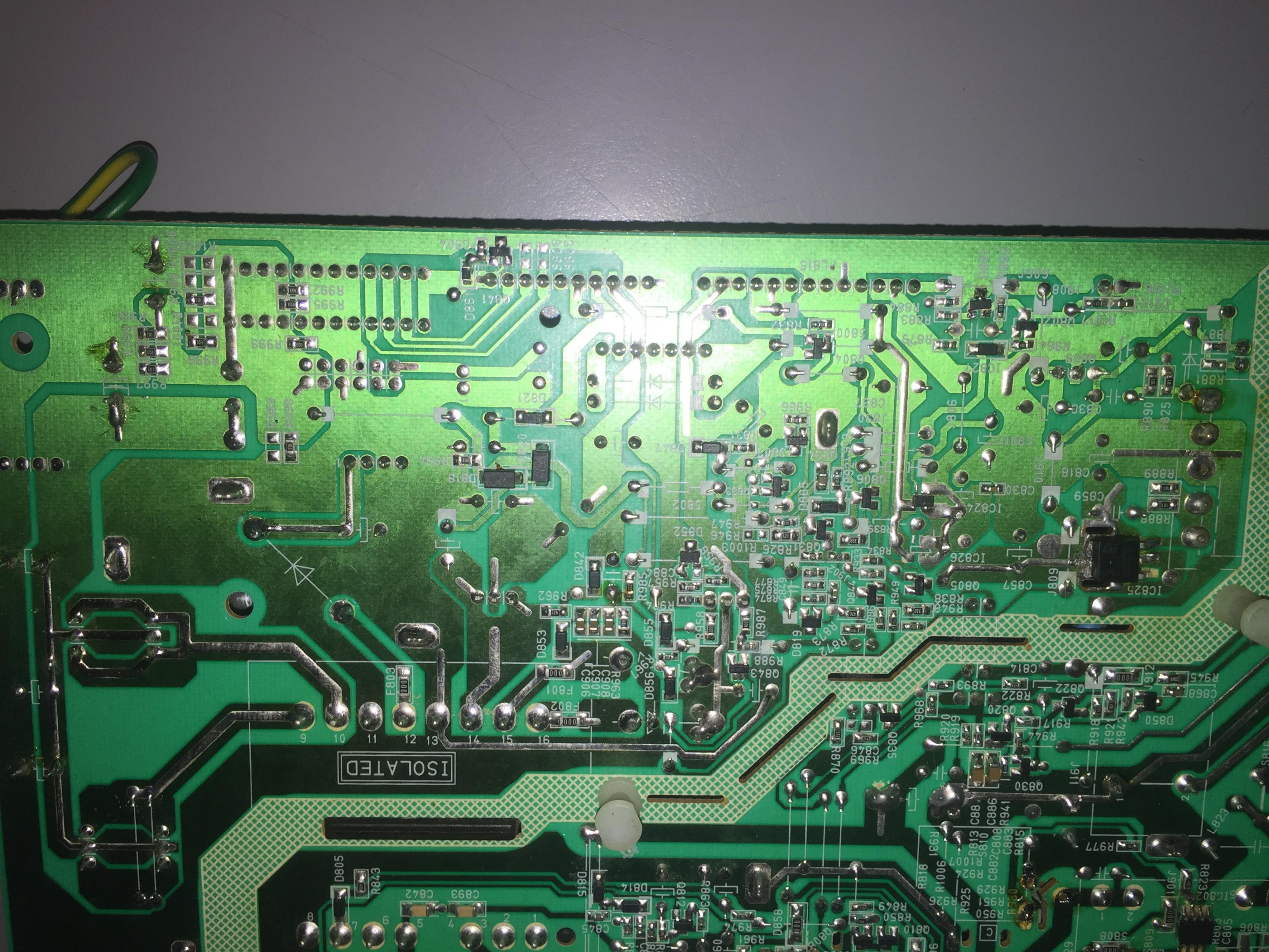

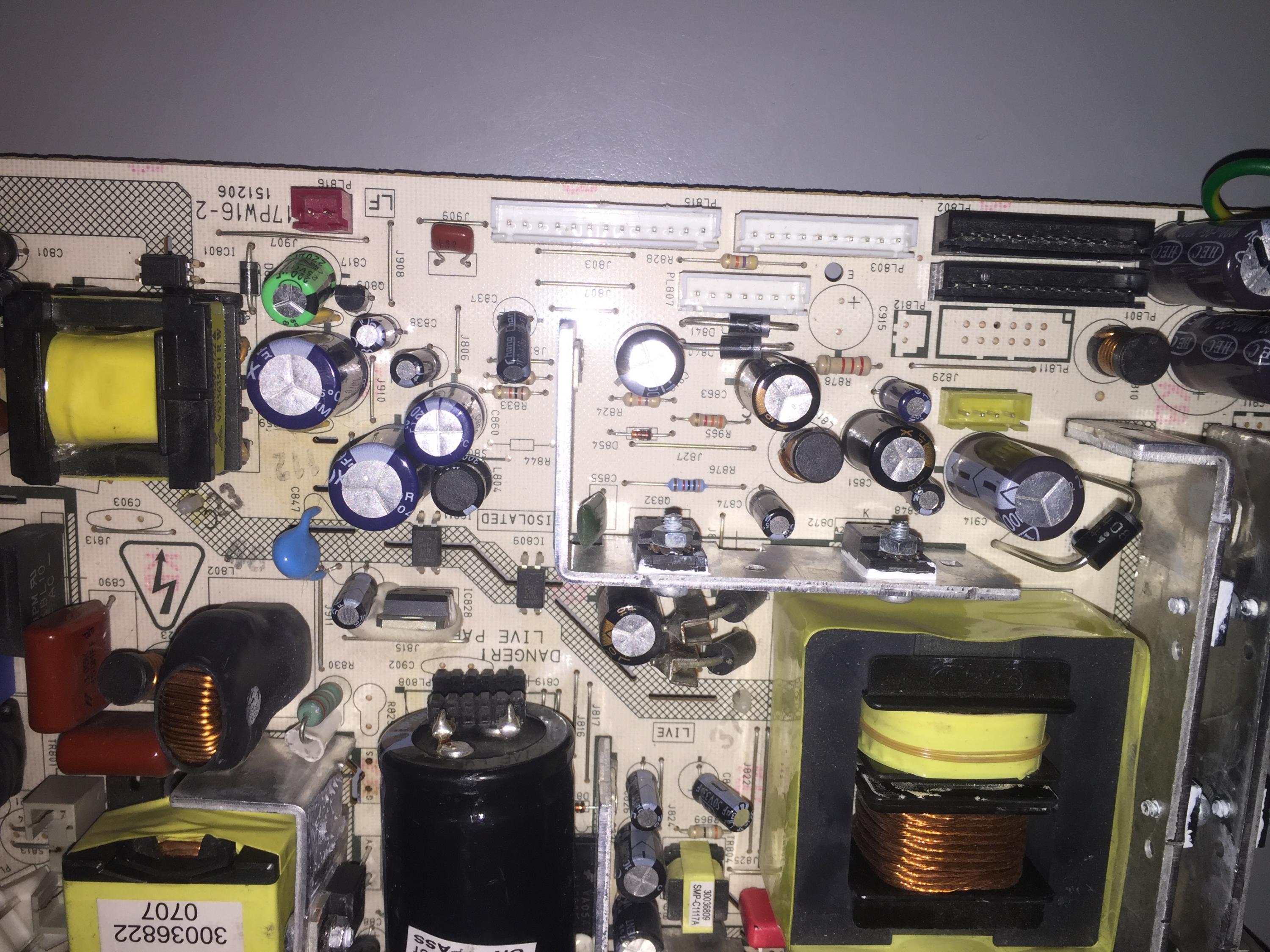

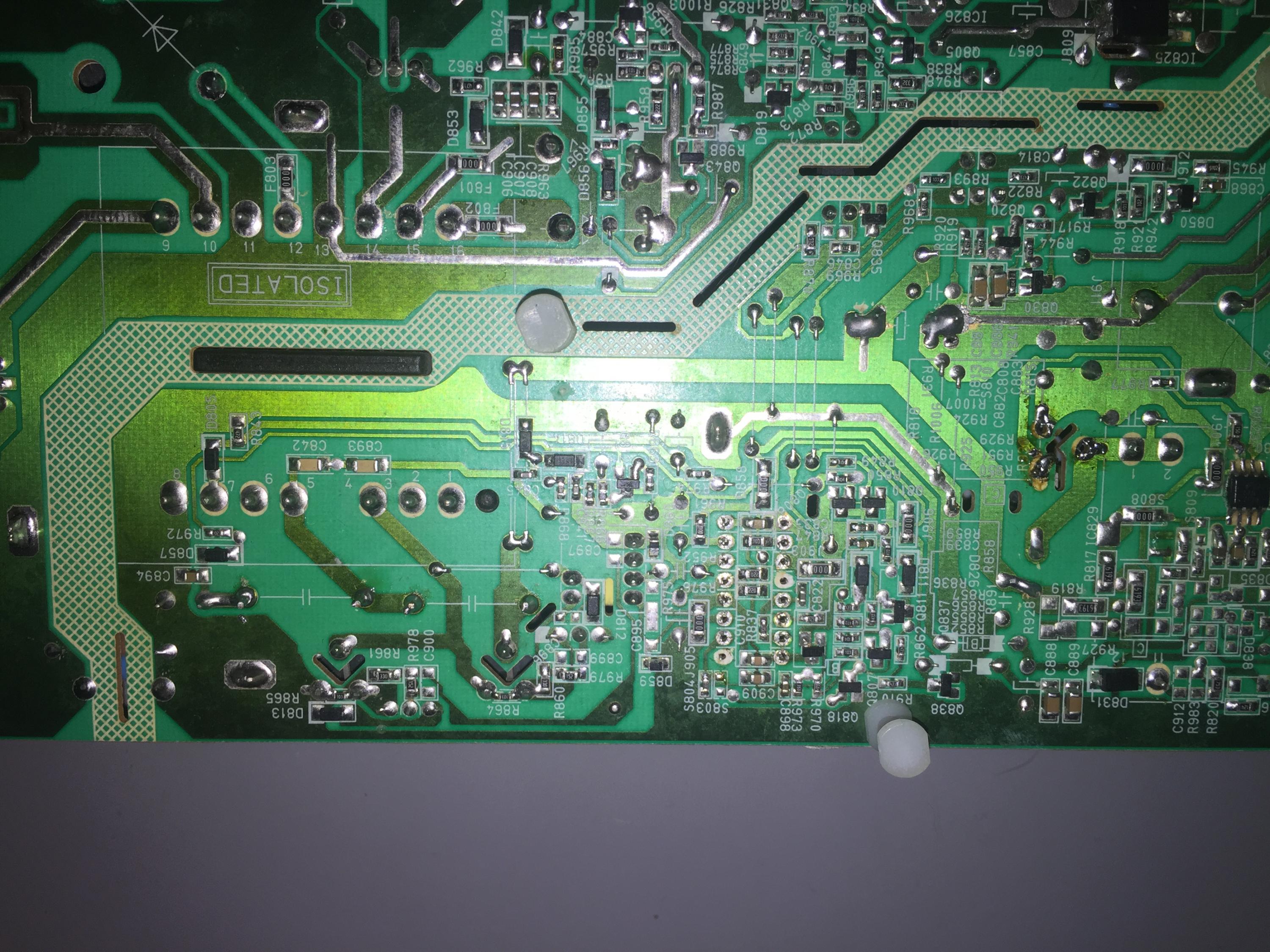

          can you post pictures of the top and bottom of your power supply we may spot something you have missed etc
          • Shotgun25
            • Feb 2014
            • 90
            Re: Vestel 17PW16-2 troubleshooting
            I have left Q803 removed as I will need to do some pad repair on the backside of the board to put this back on.
            Having found a schematic and searched for R801 that is a good shout since it's the first thing after the fuse.
            What type of resistor is it and how should it test? I put multimeter in diode/continuity mode and there were no beeps and there was a reading of 513 with probes connected one way and no reading/ rising reading that turns to infinity after 2000 connected the other way.
            IC825 was done around a year ago and it was a pain to get off because I didn't have a decent hot air station to do it (I still don't, cheap eBay rubbish that's 5 years old). As a result pin 1 is not connected but I'm sure from previous research it wasn't connected to anything after the pad or it doubles with the metal back.
            IC806 looks like the PCB is scorched, I think that was from the poor hot air station having the airflow set too high with a required high temperature. That is the new chip though and that was hand soldered.
            As for all other parts where they look soldered, those will be the parts from the kit I listed above.

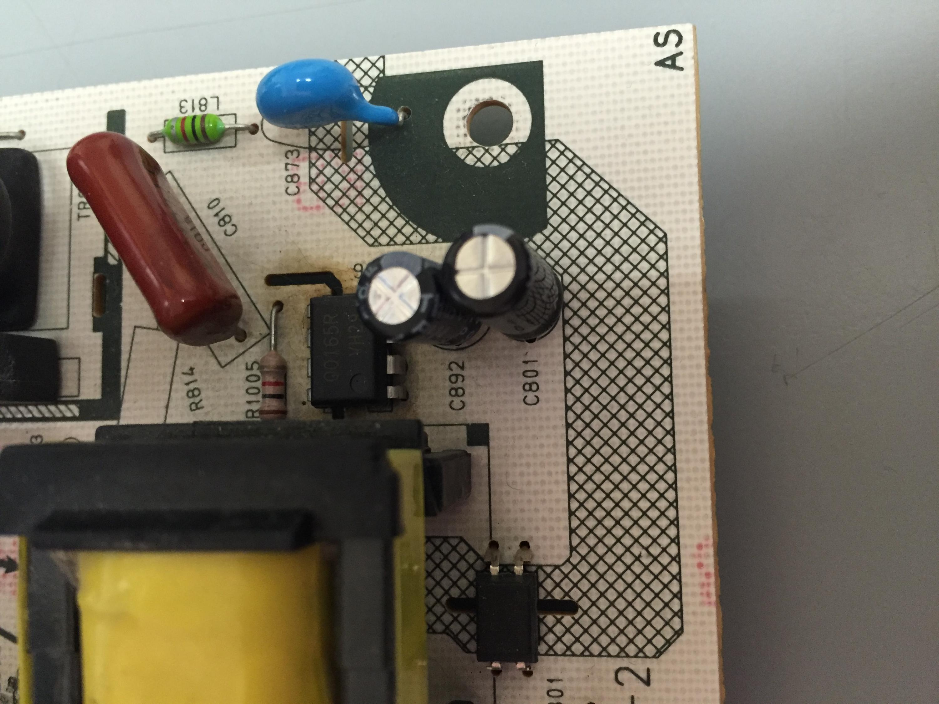

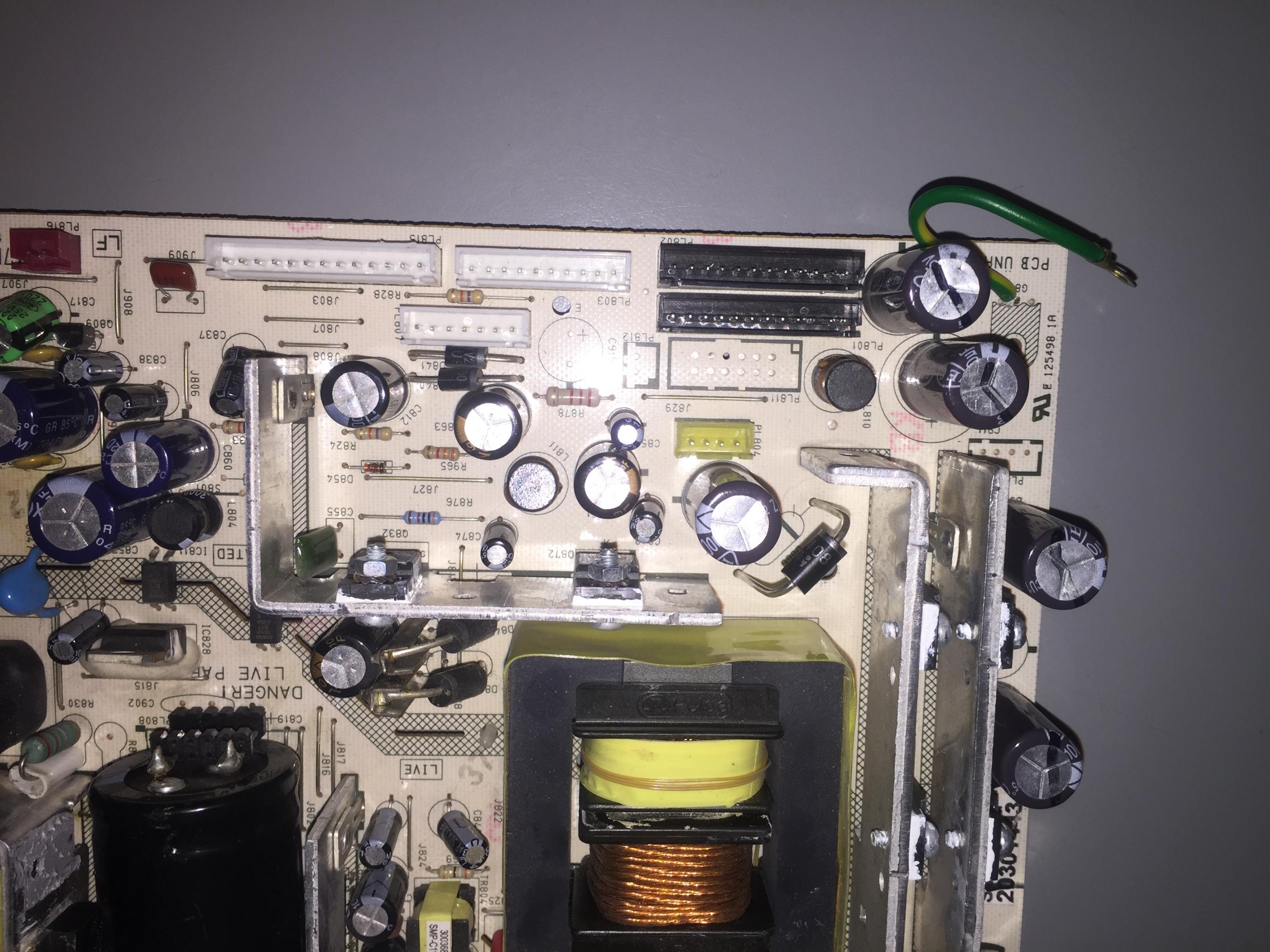

                    D824 - Diode STTH12 +Insulation kit
                    did you fit the insulation kit? as new diode maybe shorting out on the heat sink if you didnt
                    i would also re check all your work ie capacitors and diodes etc fitted the correct way wrong as we have all made the odd mistake
                              The replacement part was provided with a plastic insulating film with some thermal compound, see pic, thanks for the idea though.
                              Also I've checked capacitors which is easy on this board because of the thick line on the -ve side.
                              It's sounding like the bridge rectifier at D800 is to blame.
