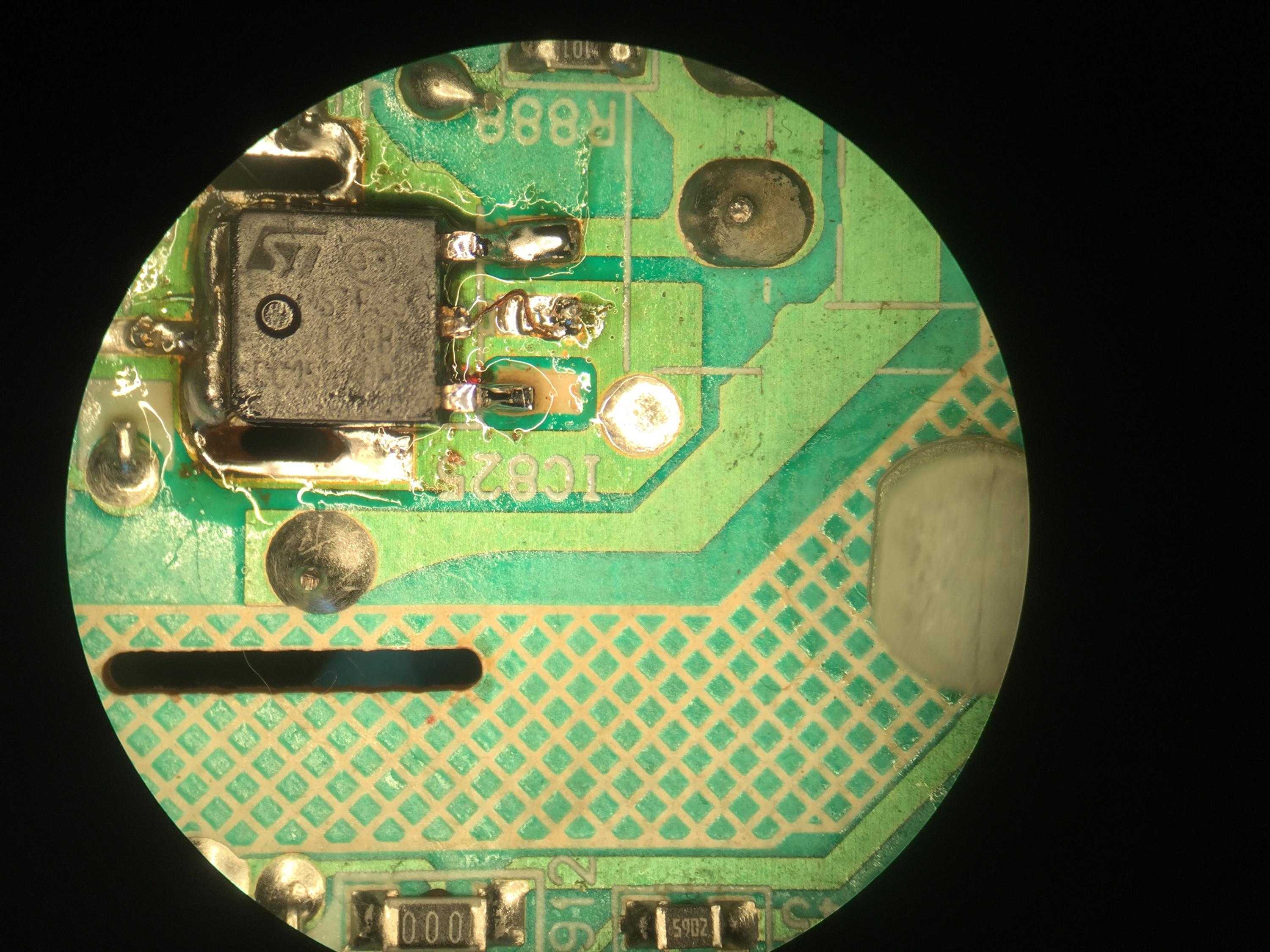

                              On the lead nearest the band on the diode, closest to the board label it reads 2.74v-2.75v fluctuating with the black probe on the ground at the far left of the board.
                              With the black probe nearest the transformer leg and the red nearest the board label (where the diode band is), I accidentally shorted D823 with J907, and now there is more ticking noises at various parts of the board. When I first did it the voltage increased to 3.4v fluctuating but I noticed the burning smell when the noises came so I'm guessing I've just ruined a part somewhere.
                              As for IC825, when I replaced it a long time ago I believe the unconnected left leg is N/C on a schematic I saw and the centre pin was connected on the original part but the schematic I used at the time showed it was the same as the metal tab. I will revisit those pins later and maybe bridge the centre pin at least, the left leg doesn't have a pad to solder to as I think it was for aesthetics and additional anchoring.
                              Thanks for the pointers.
                                #55
                                Re: Vestel 17PW16-2 troubleshooting
                                Re. IC825, probably just need to resolder centre pin, don't bridge it. I would now go over your board and do resistance tests across all electrolytic caps - except large ones, (obviously with board unplugged-no mains). Also all pins of ICs. Just to try and show up any shorts you may now have.
                                  #56
                                  Re: centre pin, I mean the original chip had three legs, the replacement chip had two outer legs and a stub for the centre leg, so by bridge I mean use a small run of 0.16mm enameled wire to bridge the gap.
                                  I'll do measurements later when I've read what J907 attaches to so I have a clue what I burned.
                                    #57
                                    Looking at the picture re. IC825, and datasheet, the tab is connected to pin 2 (middle): http://circuits.datasheetdir.com/299...25B-pinout.jpg. Is the tab shorted to ground?
                                          Pin 1 is not connected and the pad is gone anyway.
                                          Pin 2 has continuity with the tab (Pin4) and I have bridged the small tab of pin 2 to the pad on the board as the previous chip had that leg I believe.
                                          Pin 3 is soldered as expected.
                                          See attached image.
                                          EDIT: Looks like previous chip had no middle leg, but I see no issue in the bridge I created, it's just ground right?
                                          Last edited by Shotgun25; 05-14-2017, 12:15 PM. Reason: Previous chip had no middle leg
