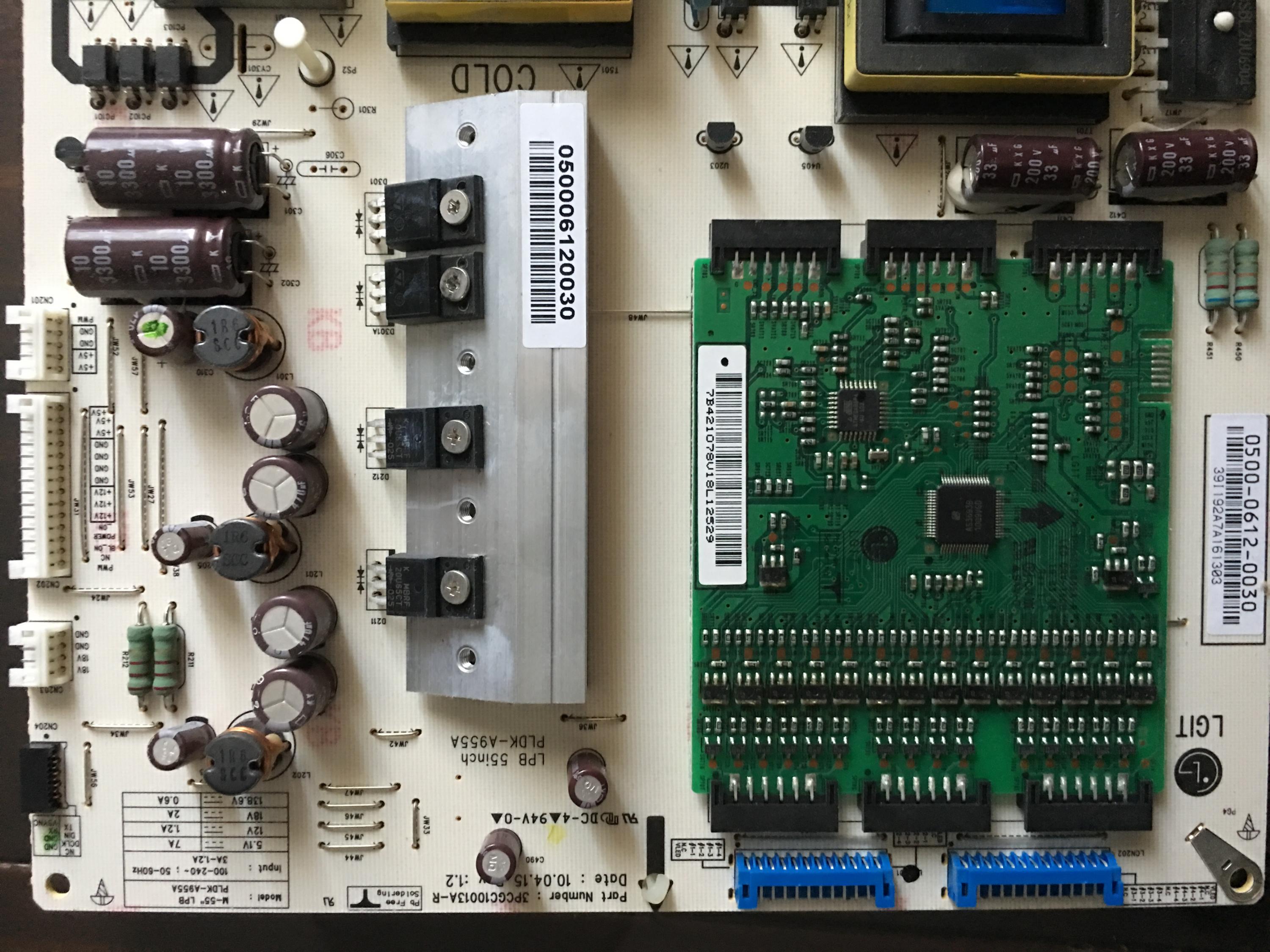

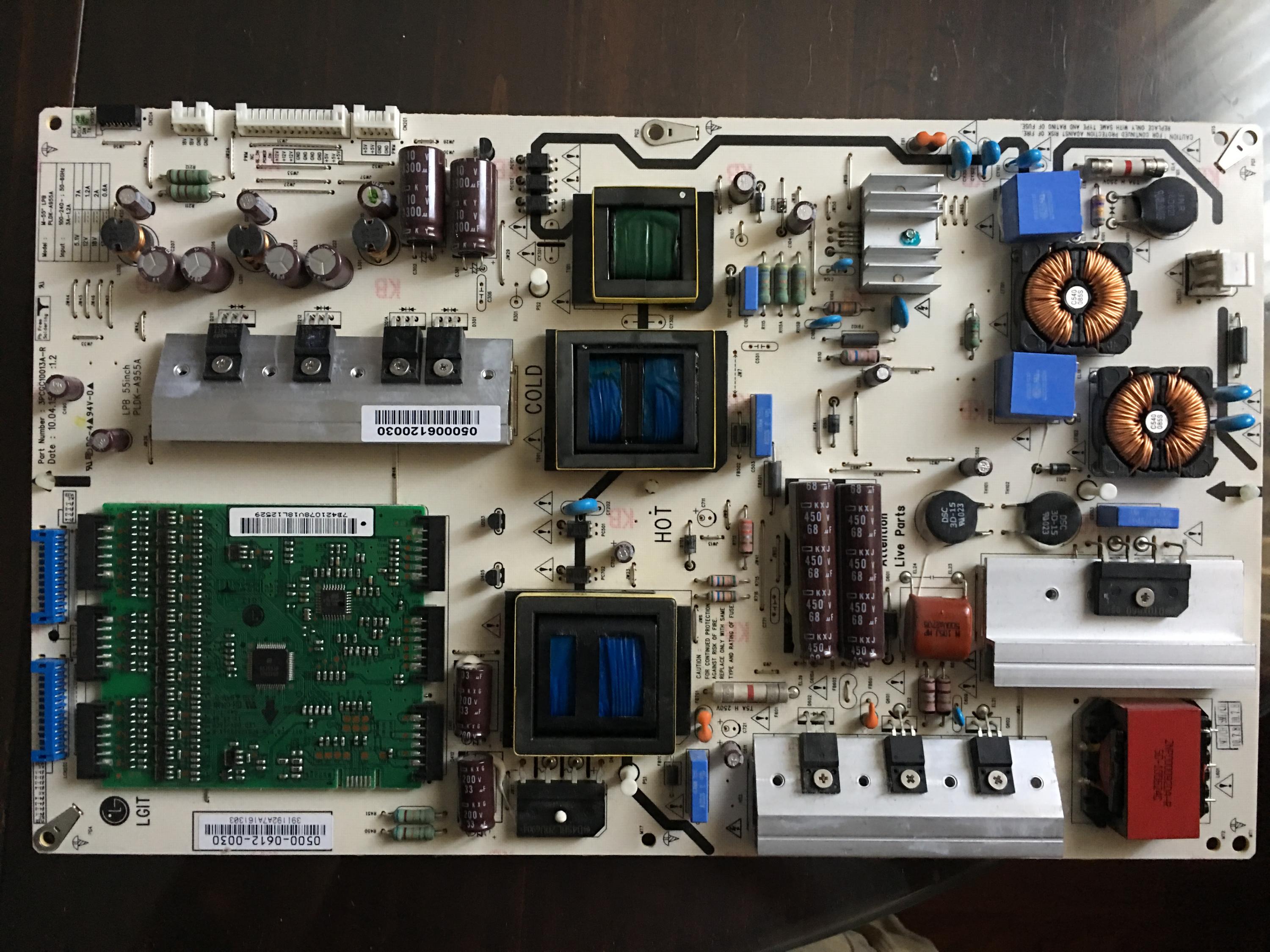

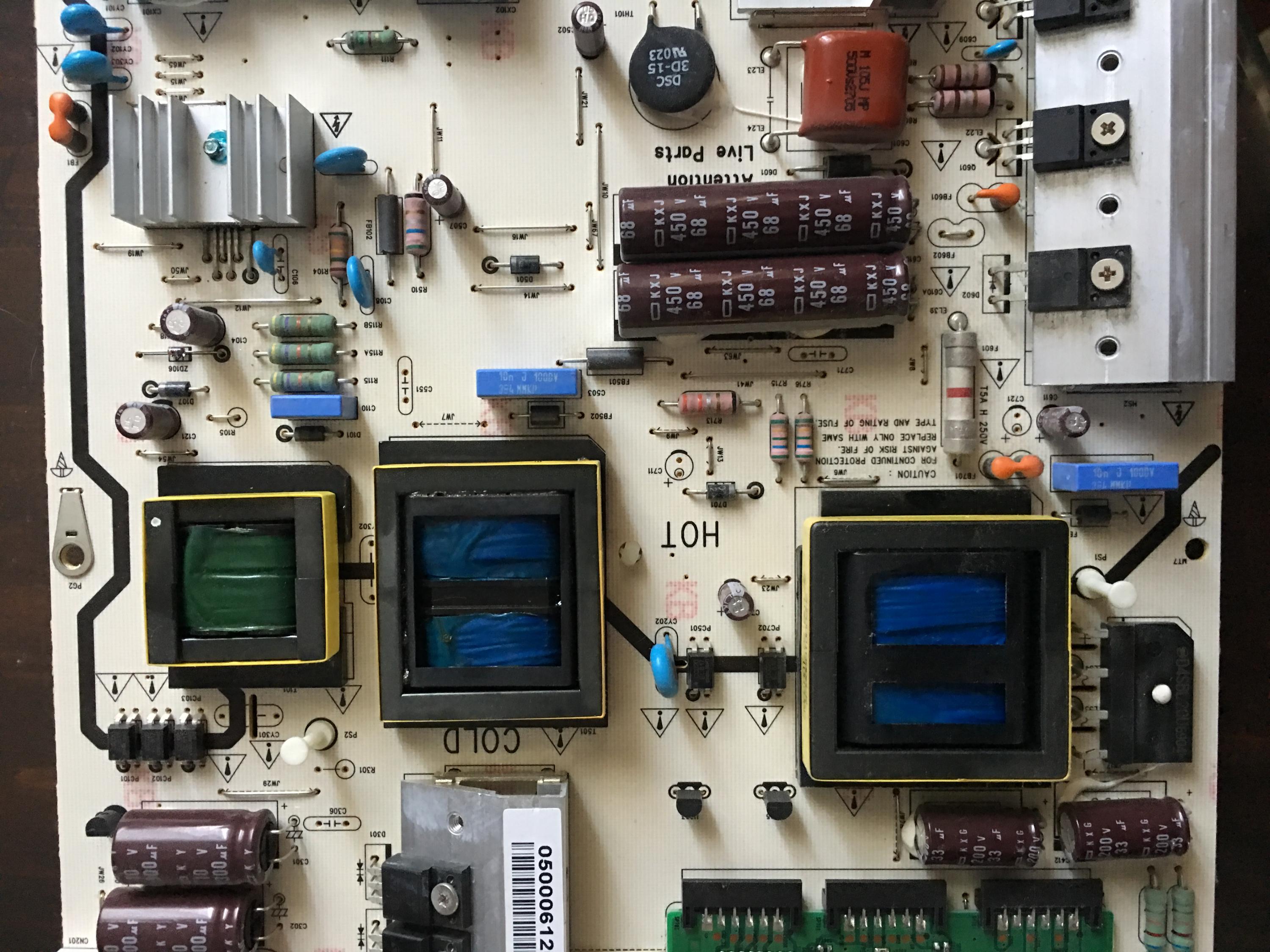

      • Aceofspades16
        • Nov 2016
        • 13
        Re: Vizio m550nv "2 seconds to black" issue
        This is the power board. The original.
        • CapLeaker
          Leaking Member
          • Dec 2014
          • 8146
          Need a hi resolution, straight shot pic, so we can read stuff off the board.
          On the top left there are some connectors that go from the PSU to the main board. Put your DMM into DC mode, turn your TV on. Put the negative lead to chassis GND or on any GND pin on the secondary side of the PSU. Measure the DC V on each of the pins. NOte down the pin name with the voltages measured and post them here.

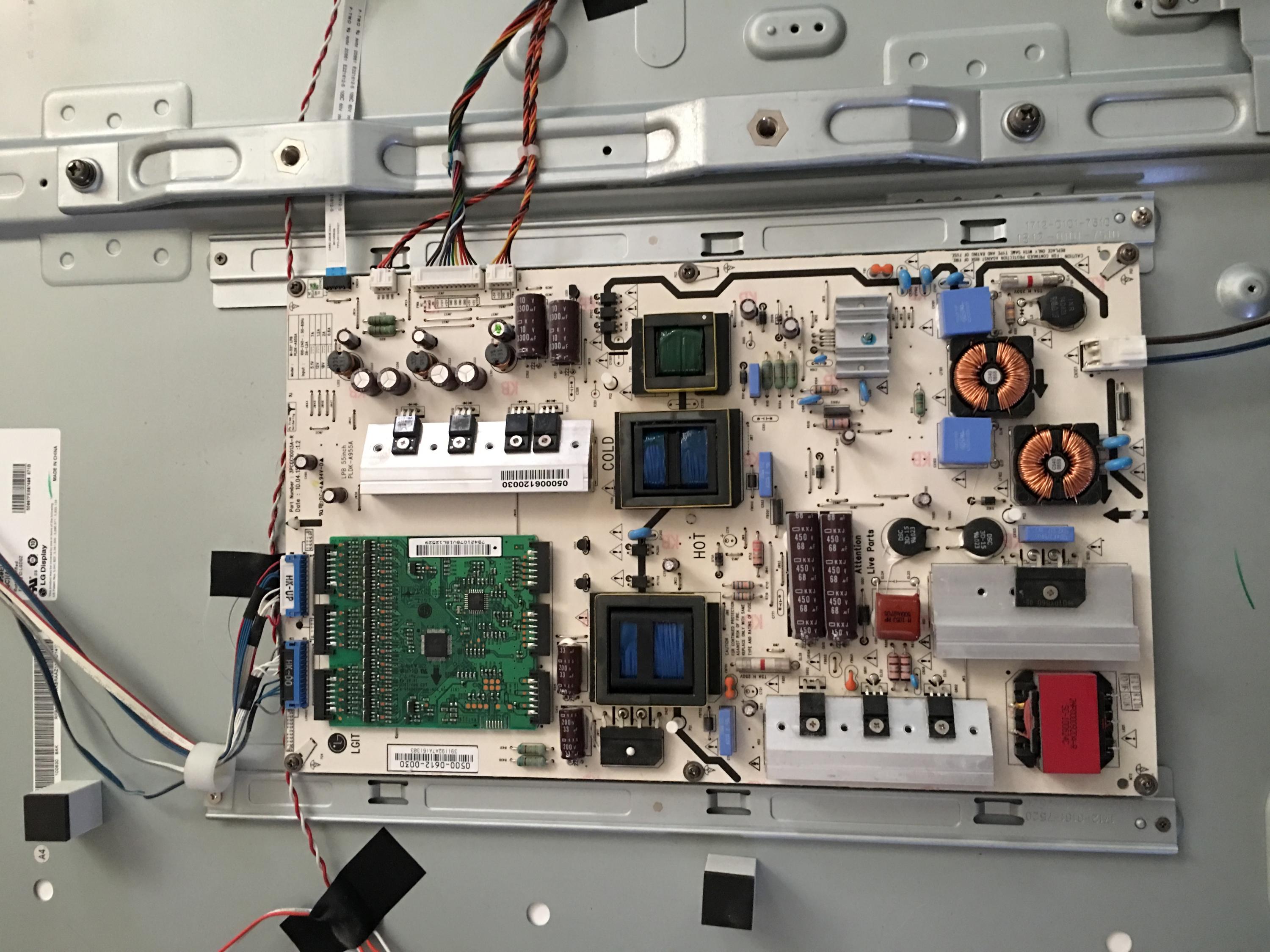

            • Aceofspades16
              • Nov 2016
              • 13

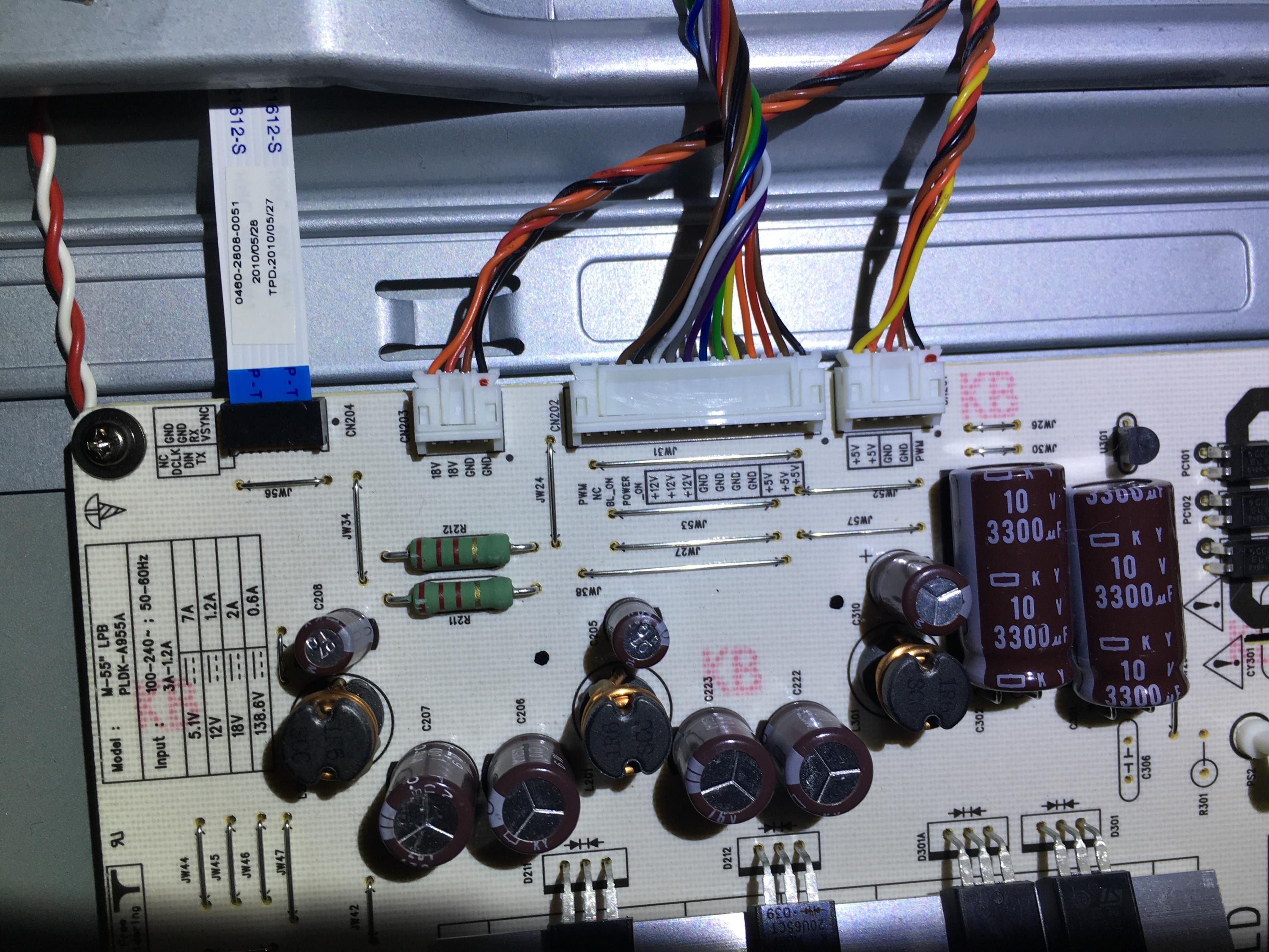

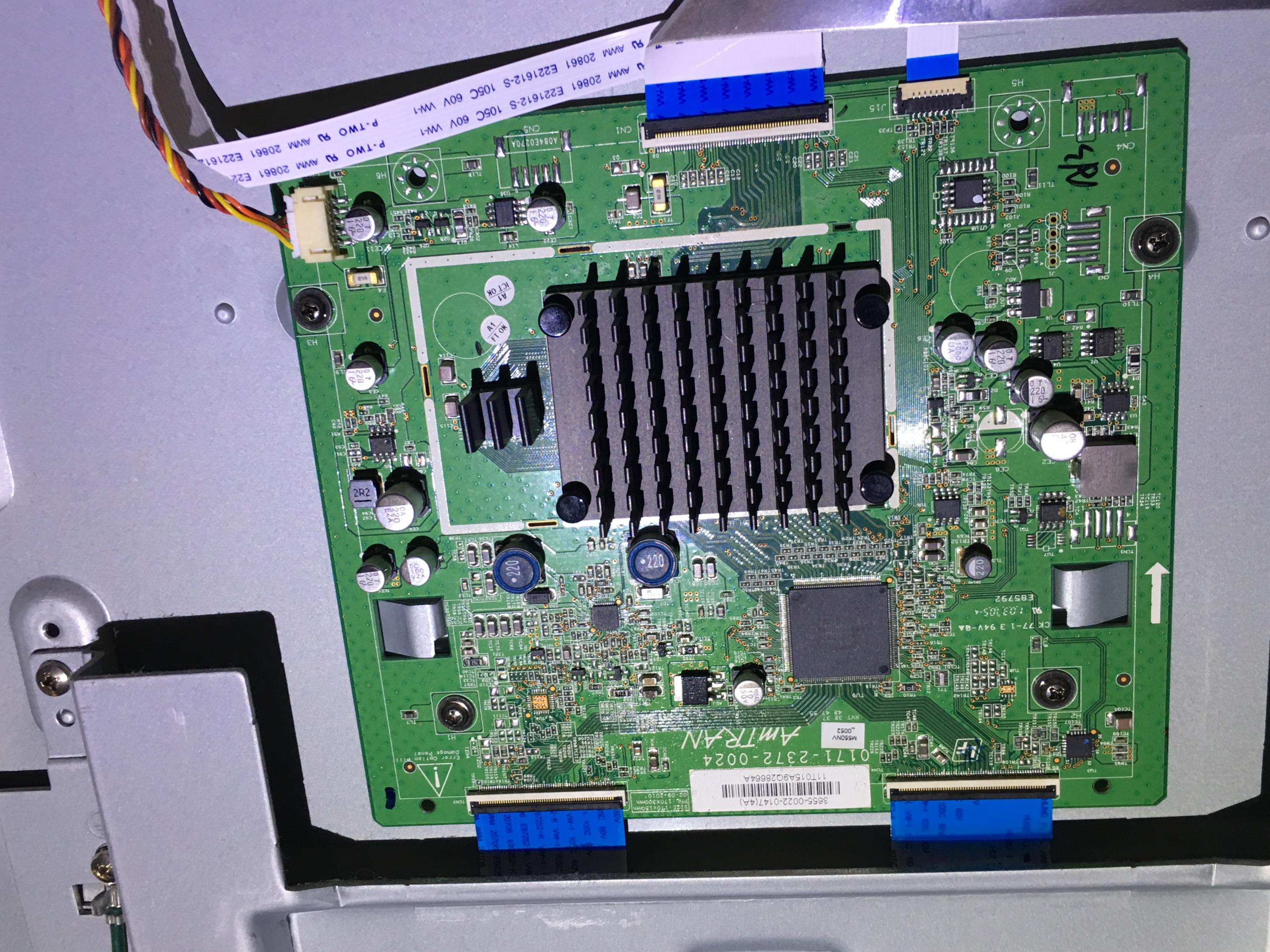

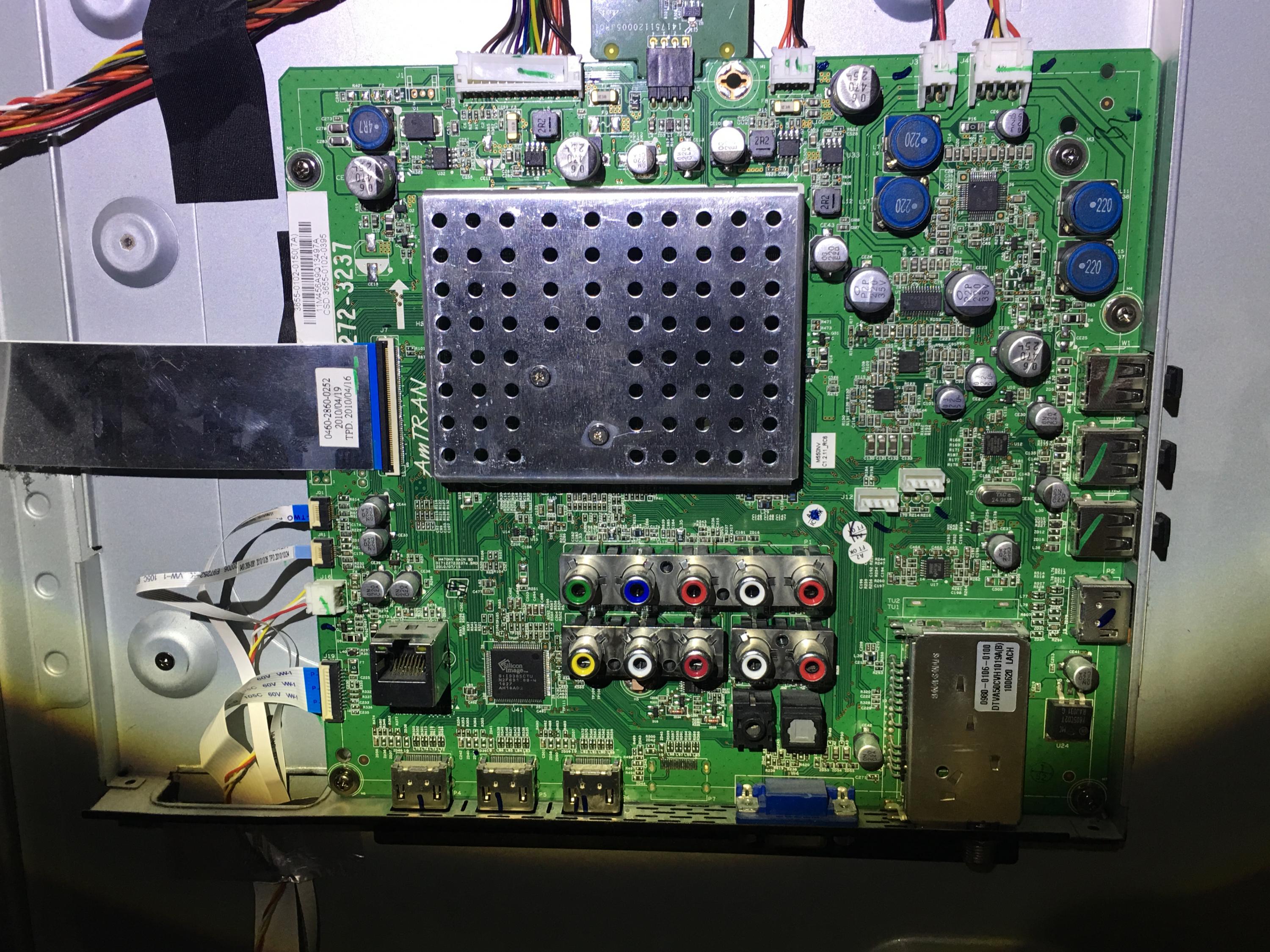

              Ok. I broke down the main board into 4 pictures. Tried to fill my whole viewfinder with the board then close ups of the board.
              Also a snap of the "tcon"? Board and main board

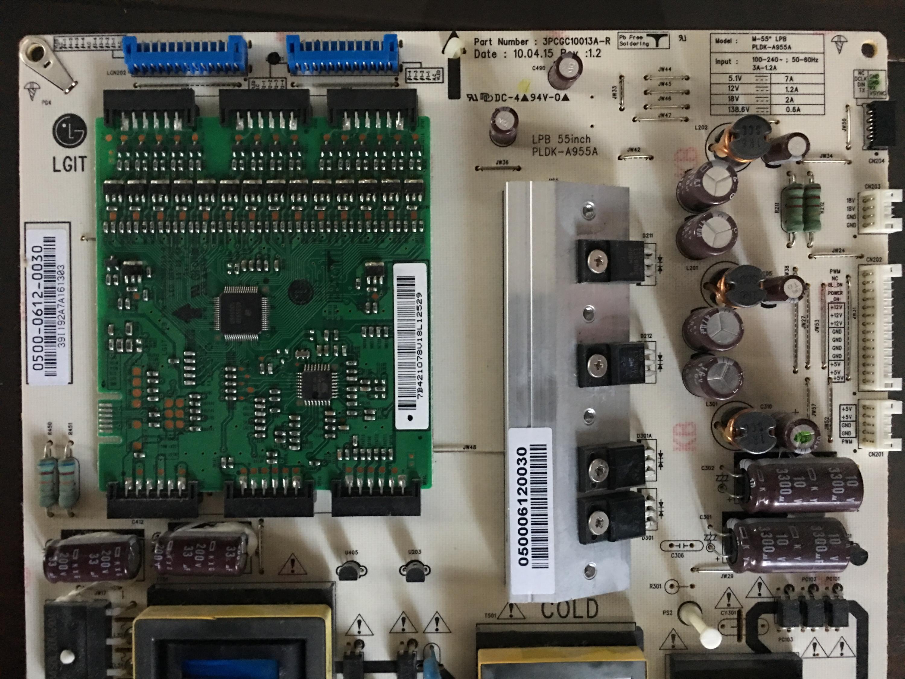

              • Aceofspades16
                • Nov 2016
                • 13
                With the board positioned on the tv the upper right hand side has a few connections
                CN 203 reads:
                18v top 2 pins
                CN 202 reads:
                PWM - 2.8v
                BL_ON - 3.3v
                POWER - 3.1
                Each 12v pin was 11.8v
                Each 5v pin was 5v
                CN 201 reads:
                5v on top 2 pins
                Top left of board for the LEDs
                LCN202
                110v
                empty
                11.6v
                14.0v
                13.0v
                11.0v
                empty
                12.4v
                12.3v
                13.3v
                11.1v
                empty
                110v
                LCN201 ** one lead was quite high
                110v
                Empty
                13.6v
                13.5v
                12.2v
                12.0v
                12.6v
                22.9v**
                13.6v
                13.1v
                Empty
                110v
                ****unplugging clip CN202 and plugging back in will cycle my backlights , for about 3 seconds befor they shut off
                • CapLeaker
                  Leaking Member
                  • Dec 2014
                  • 8146
                  you got a bad led in the backlights. I guess you have to take the panel apart.
                    Per Voltages chart, the LED Voltage with load is 138V:
                    https://www.badcaps.net/forum/attach...8&d=1478291692
                    TV OFF, leave the Black probe on chassis, red probe on the VLED pin and record the DCV reading, keep the probes connected still then turn on the TV to see if it jump higher than 110Vdc.
                    The '22.9v**' looks bad.
