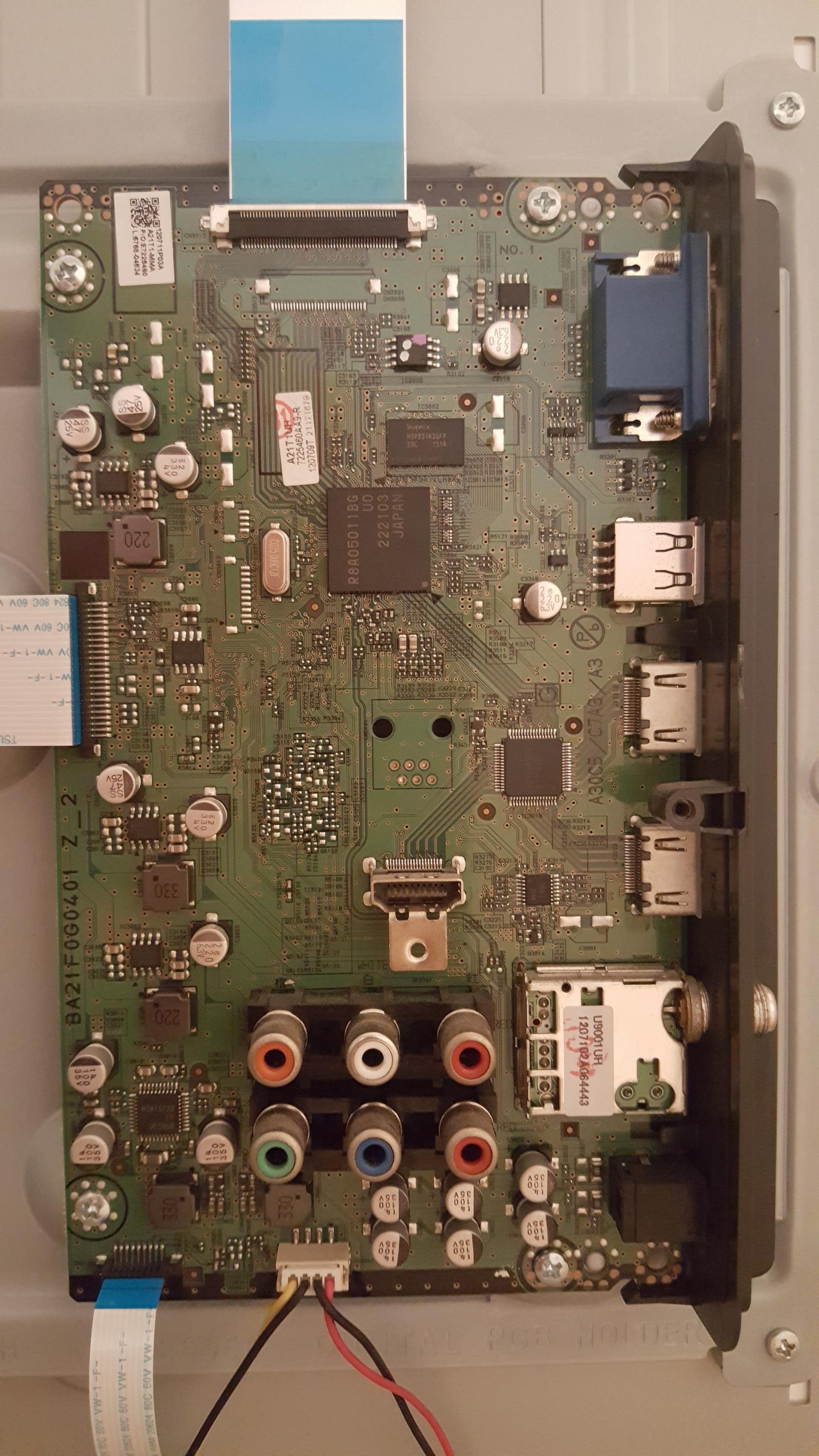

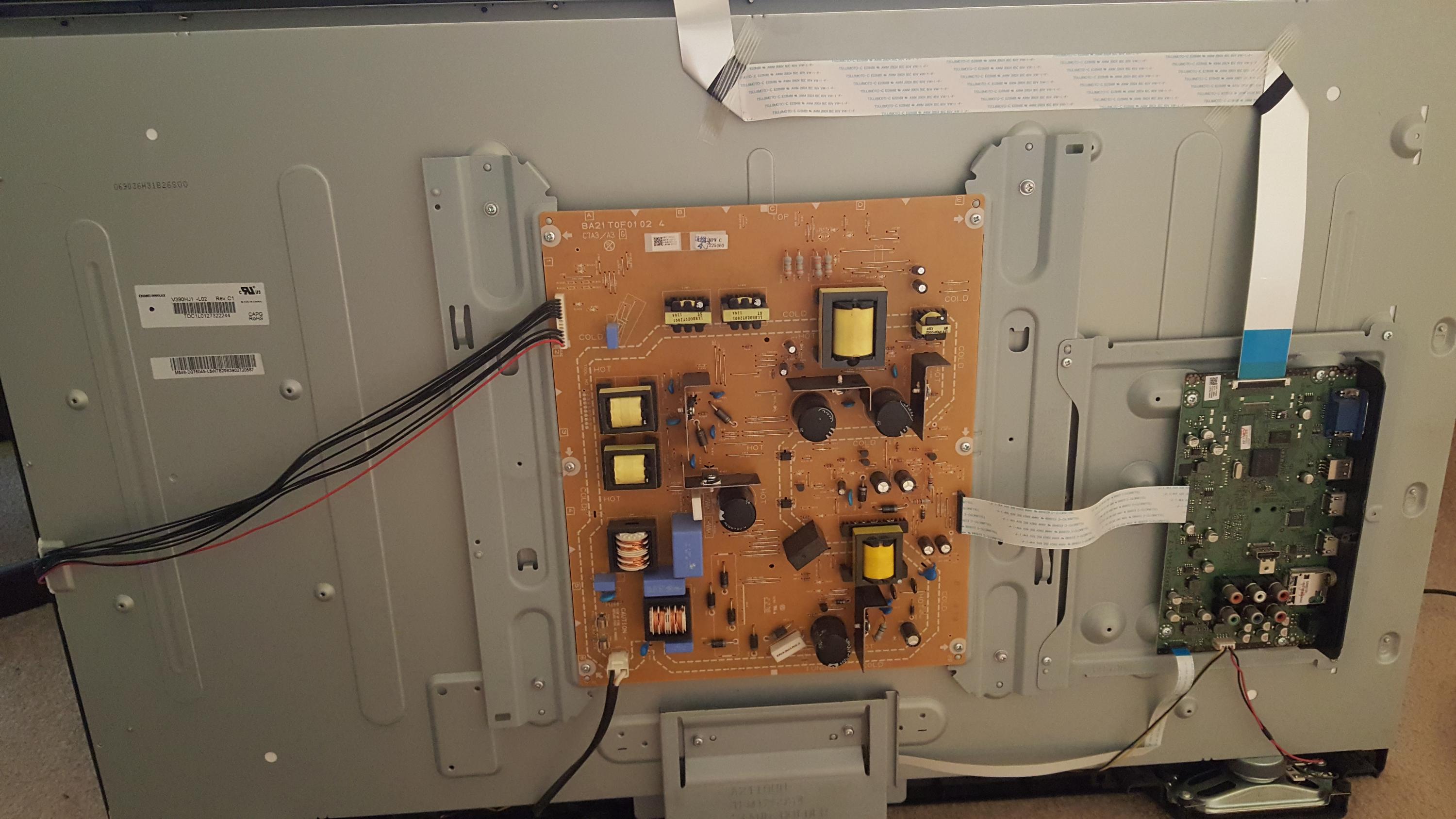

    Hi all!
    So I have an Emerson 39" tv with a model number of: LC391EM3. The problem is the screen will not come on and once plugged in, there is a constant high pitched whine coming from the power board. The area it is coming from is circled in the attached photo.
    Once you unplug the flex going to the main board from the power board the whining stops. I am leaning towards a bad PSU board that is not putting enough power out for the main board, but then again I thought I would ask for some input on this as well.

    Re: Emerson LC391EM3 - Constant High Pitch Sound
    You have shorted circuit that drawing too much current from the power supply.
    You need to check ALL the diodes in the power supply, check the resistance between GND and the Voltage output pins of the power supply to see if any one of them shows very low resistance. Do not try to power up the unit otherwise you may cause more damages.

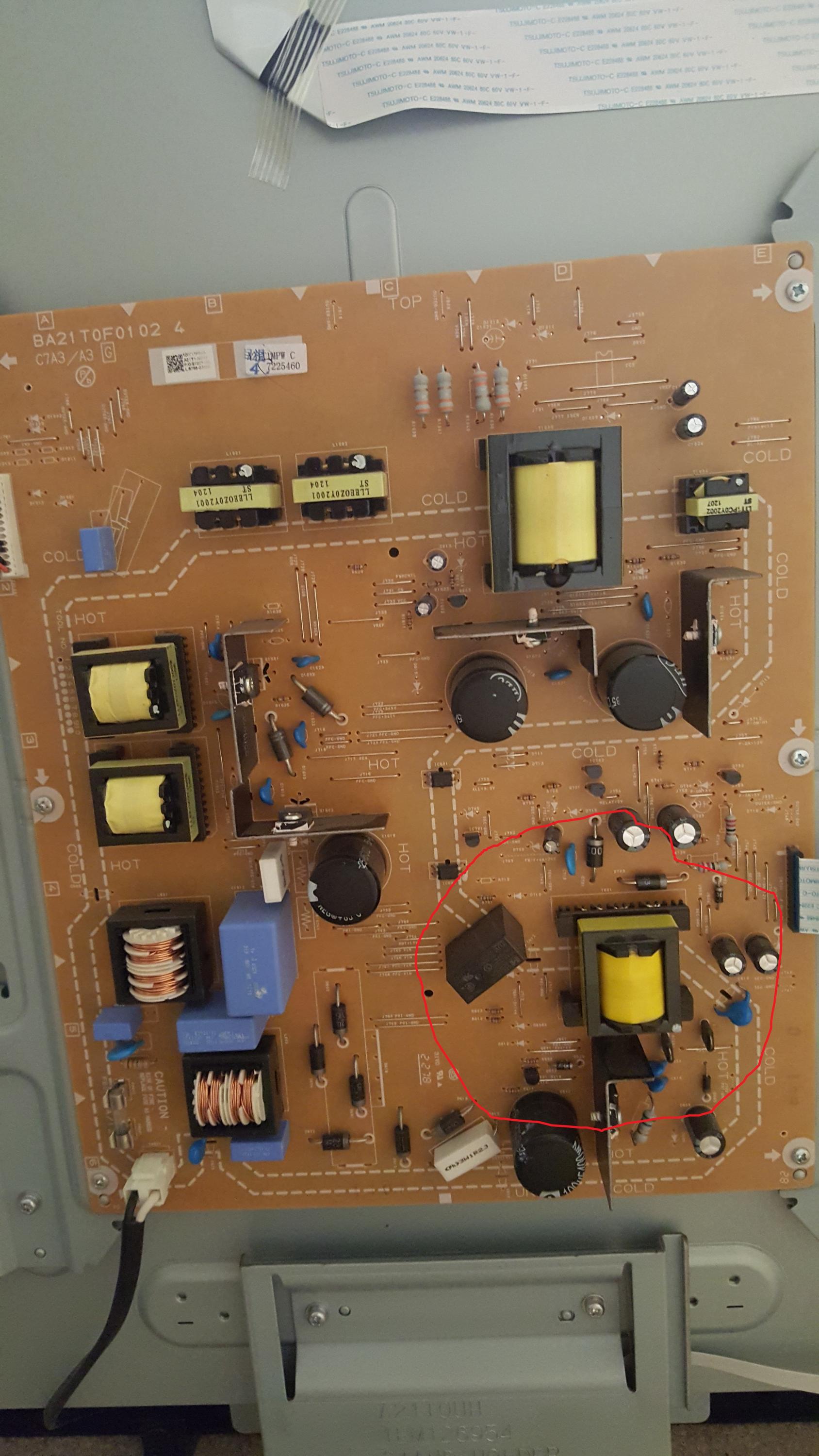

      These are the parts included in the repair kit for this fault so maybe check all these parts too
      Part Number: A21N0MPW-001 Repair Kit
      Kit Includes
      Description Quantity Board Location
      Fuse 1 F601
      Resistor 1 R611
      Transistors 3 Q501, 601, 602
      Diodes 8 D601, 602, 603, 604, 607, 608, 609, 653
      Capacitor 1 C605
            Trying to find my old thread. I recall I found a service manual and there was a shorted chip cap on one of the regulator rails on the main board. You should be able to measure a short on the supply voltage input of the main board to ground.
            Add - found it. Philips and Emerson are the same. https://www.badcaps.net/forum/showthread.php?t=76666
                    I fixed it! I found the service manual/schematic in another post for a different model, but same boards. Without that, it would have ended up in the trash. The problem was on the main board, specifically C3103 (a tiny surface mount capacitor near IC3008) was shorted. I found it by checking the resistances of the various power supplies (or rather their loads) and the P-ON-12V was 10 ohms. Pulled 2 other caps before finding the bad one.
                    I'm reposting the service manual in case anyone else is looking for it.
                    A question for the experts: I don't have a replacement capacitor and it powers up fine without it. The question is, is it necessary for long term reliability? It is 4.7uF and is in parallel to a 47uF electrolytic on the Vin line supplying a voltage regulator. There is another 4.7uF cap in parallel, but is 2-3" away.
                    Thanks!
                      The caps are for filtering noise on the supply voltage rails for each regulator and are placed next to each IC. Will work without it but if you want to replace it, Digikey ships USPS to US with no min or Ebay may have sellers that ship small volumes.
                        T
                        This cap is at input of buck regulator.
                        Without it:
                        - regulator operation may be unstable
                        - electrolytic cap next to it will be stressed
                        - unwanted electromagnetic (radio) interference is created
                        If possible, use larger size (physically bigger, not capacitance) capacitor with voltage rating of 25V or more.
                        There are some not populated caps in parallel, you can install those too, more is better.
                          Thanks for the info and explanations! I found a 6.7uF SMD cap that is a little bigger physically, but was able to solder it in. All back together and ready for duty. Hopefully the difference in capacitance isn't going to be a problem...if so, should I just remove it and go without?
                          Ya'll are great!
