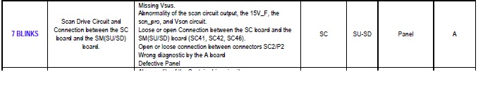

TCP55ST30 SU/SD board test needed (7 blinks)
  • Truncatedhose
    • Oct 2014
    • 343
    I have the service manual for this TV, but not the training manual and the S/M doesn't show how to isolate or test the SU/SD boards. Does anyone have the procedure or the training manual? I have training manuals for other models, but I don't think I can use the same procedure. Also, can you test Panasonic buffers the same as any other buffer with the standard buffer IC ground test?
    Thanks!

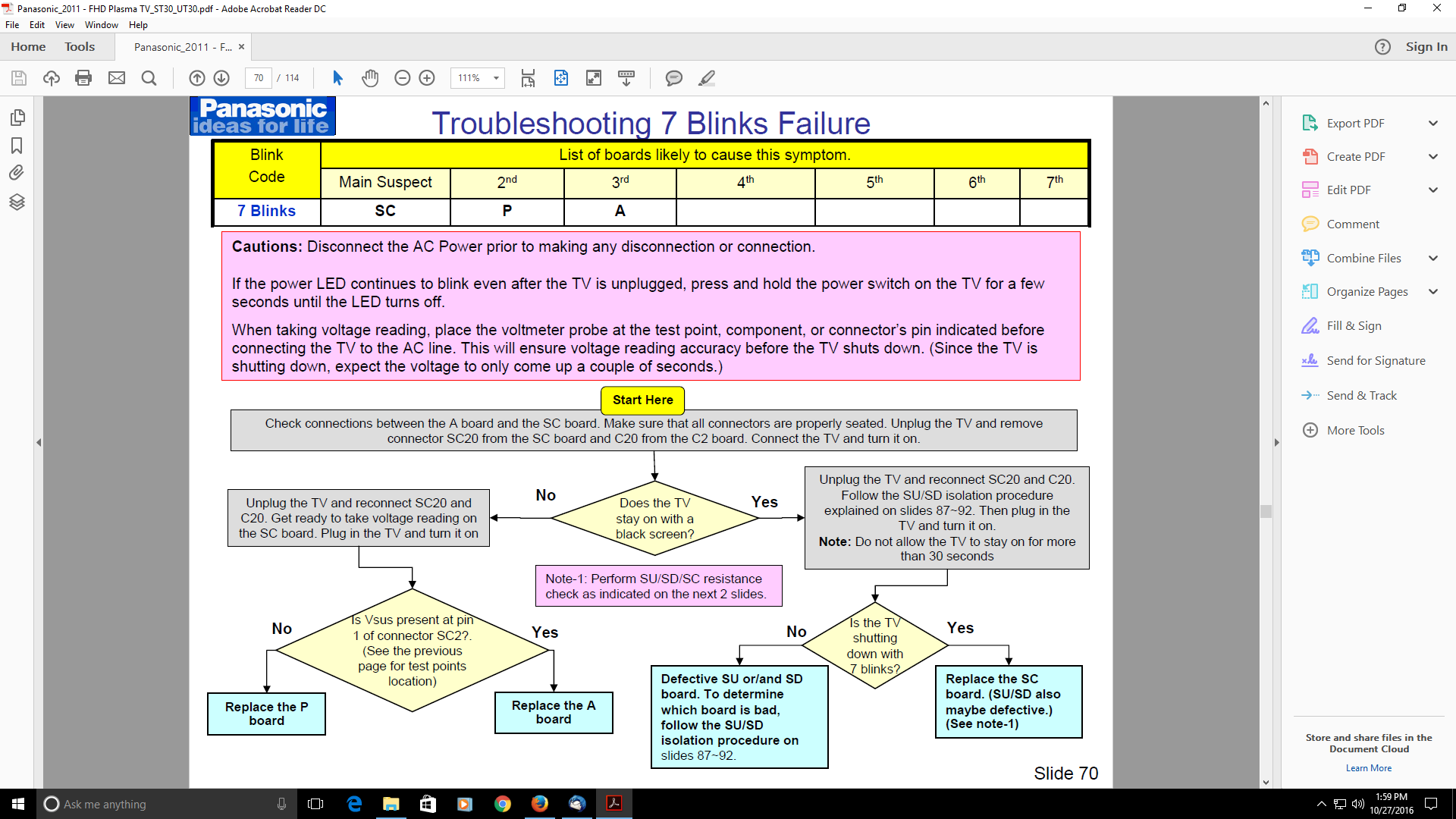

              Re: TCP55ST30 SU/SD board test needed (7 blinks)
              Okay, see the screenshot below of the training manual (thank you so much for providing it btw!). I followed the steps for troubleshooting 7 blinks and since the TV doesn't stay on with a blank picture when I unplug the plugs that it directs me to, I don't even go down the path of testing or isolating the SU/SD. Instead, it wants me to see if VSUS comes up and it doesn't (strangely, when I 1st tested it, it came up, but immediately was dropping to zero, and the 2nd time, it didn't come up at all.), Then it says, as you can see, to replace the P board.
              My question is: does this make sense and/or should I test the SU/SD anyway?
              • tw2005
                • Oct 2011
                • 6458
                yeah, ok I see where you're at. I thought you'd already figured bad SC and just wanted to do the SD/SU test.
                Sounds like SC2 could be short circuit. This generation major cause is SC failure.
                Here's some options.
                1. yes , do the SD ,SU checks, need too regardless.
                2. you could check the resistance across SC2, if it's shorted or low ohms it's cactus.
                3. you could check all 30F131 and RJP30H2 transistors and again check if shorted across any 2 legs, chances are they will be Q401-403 and Q421-423 are the most common. You just place the probes one on each
                4. isolate the sd/su by removing 4 Vfg bolts and the 3 white connectors, on the SC jumper the 2 pins at SC50, now turn it on. If it turns on with no display i.e. no shutdown and error blinks then the SC is good and most likely sd/su.
                If you find shorts at 2 or 3 don't bother with 4
                I would not go down the A or P board path at this point, that's less likely.
                    Okay, yeah I checked SC2 right away when starting on this TV; it's not shorted. Do you think I should still check all the parts on the SC board? And for your step #1, can you spell out what you mean by these tests in detail? Sorry, but I want to be clear on the best way to test the SU/SD. Yes, then I will also isolate them, unless you think isolating them is enough to determine if they are the problem? And then if they're not, the A or P board might be where the issue is as the flow chart indicates?
                    I just realised something. Your 55ST30 is different to ours and uses TNPA5351 SC board, is that right?
                    So some of my info is off slightly especially what transistors may fail on the SC.
                    Coppell TV has done a 3 part video. Part 2 shows him testing the buffers as I suggested leaving them in , lifting the latch and sliding the pins on the back.
                    Rather than risking confusing this more for you, I'd have a look at these videos and see what results you can achieve.
                    I don't know that exact revision of board But I've done several 50U30 TVs here with 5351 version boards and it's 50/50 for 7 blinks, either blown SC or I've found the remainder were shorted SU normally the top ICs.
                    https://www.youtube.com/watch?v=gSDDenXeRm4
                    https://www.youtube.com/watch?v=jFv7jmDUBm8
                    https://www.youtube.com/watch?v=q1GpwoI1py8
