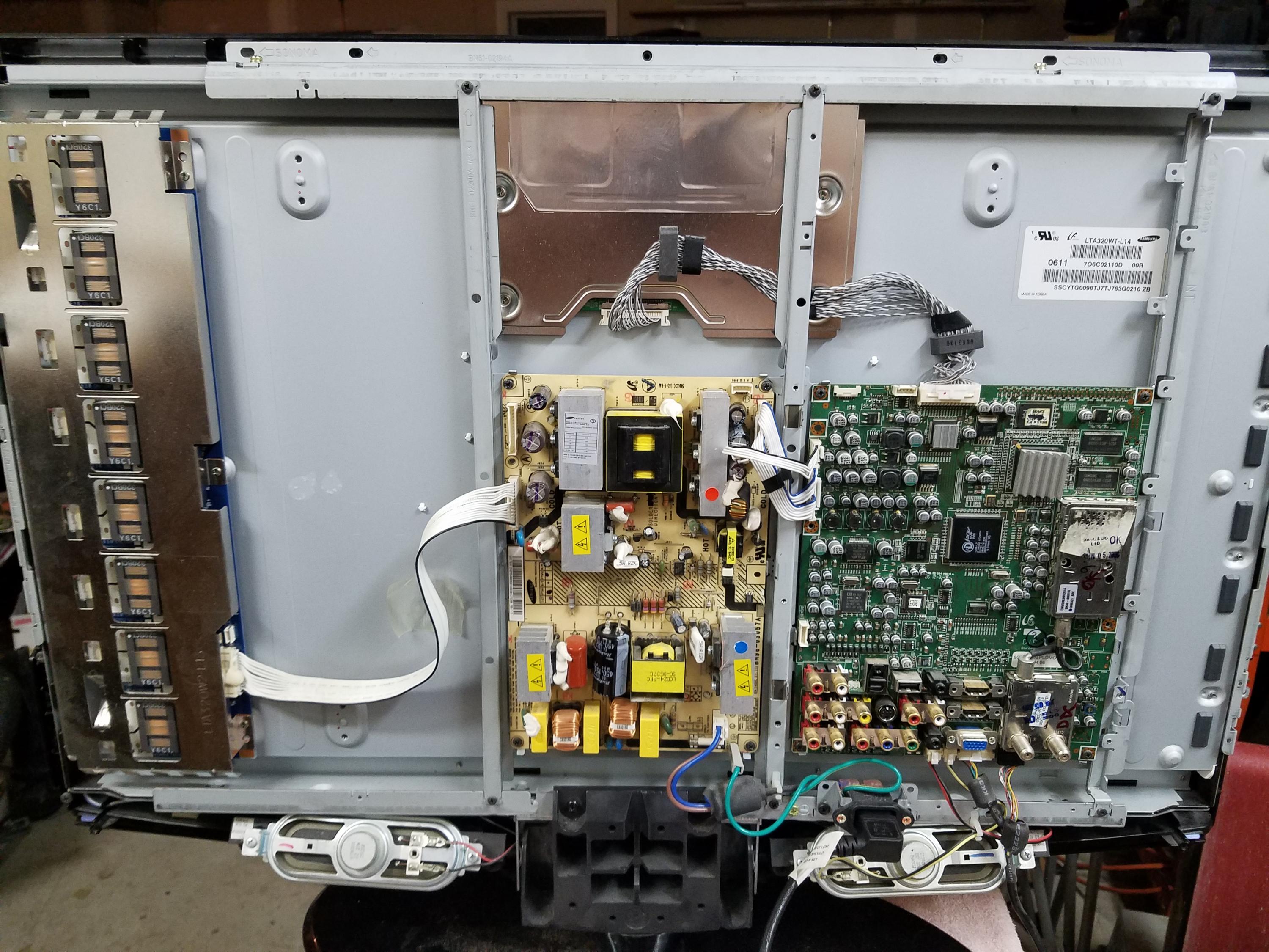

    Samsung ln-s3251d power cycling

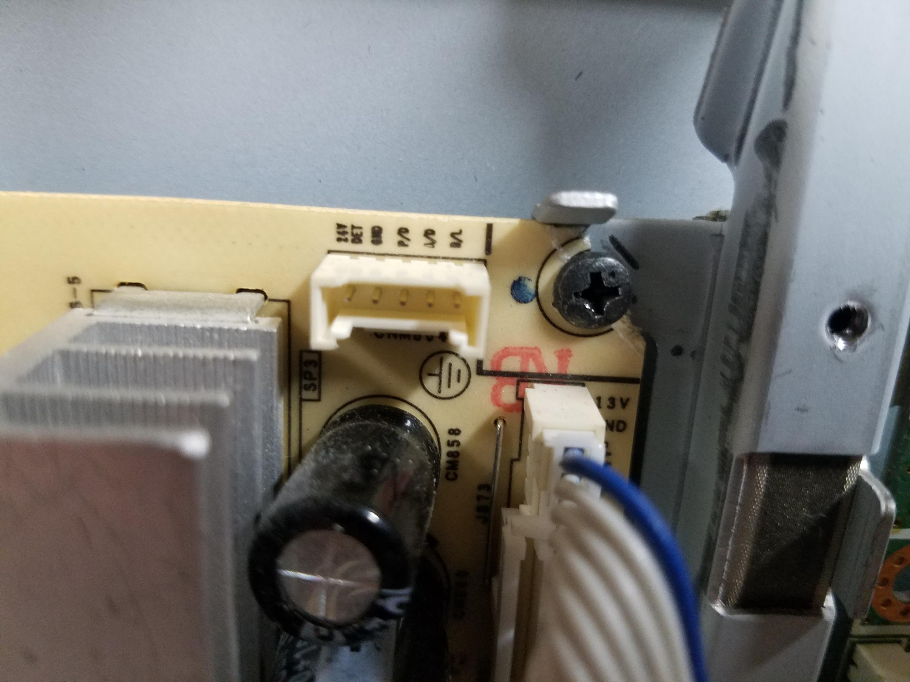

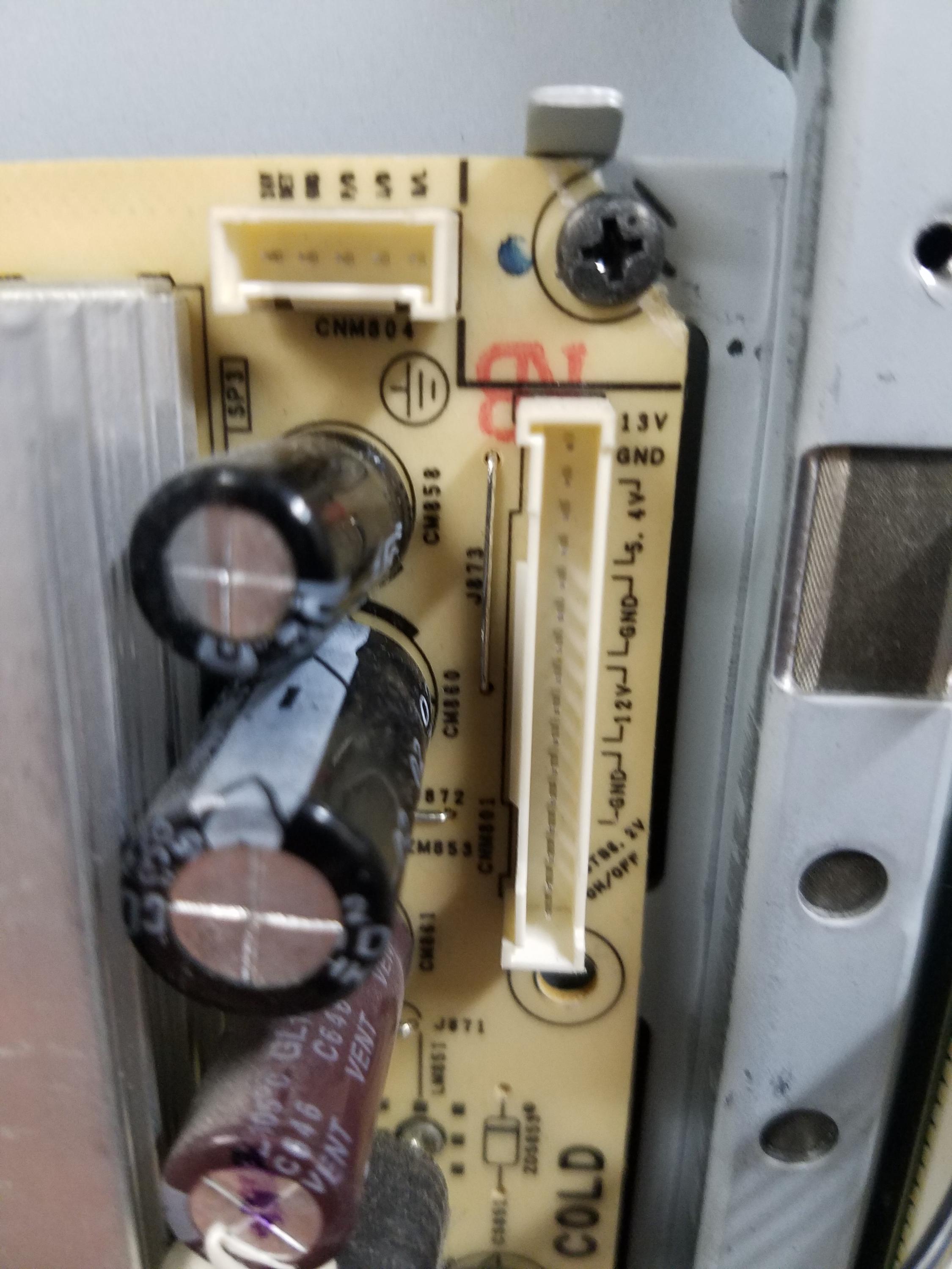

    I just picked up this tv. The power light flashed 4 times and waits 13 seconds and does it again. You can hear it power down. The inverter has all the correct voltages. The main input wire has all the correct voltages. There is a second wire going to the main board from the power board. I do not know if the voltages are correct.
    24v det 5.3 v
    gnd 1.9 mv
    pwm 5 v
    adim 3.4 v
    b/l on/off 1.4 mv
    I think I am looking at an input board problem. Can anyone confirm?

    You do not have BL ON/OFF signal to turn on the backlights circuits.
    ON = >2 Vdc
    OFF = <1 VDC.

      Is that supposed to come from the Input board or the power supply?
      • dick_barton
        • Aug 2015
        • 6642
        • Wales
        Re: Samsung ln-s3251d power cycling
        From the main board (input board)

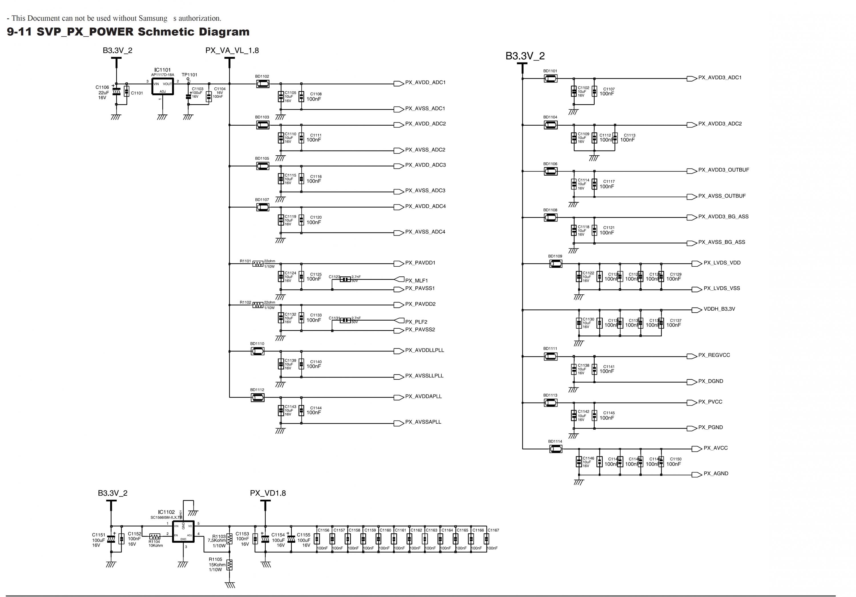

          I can't find a board schematic for this board. bn97-00810a or bn41-00679b
          • fredaelsadany
            • Jan 2016
            • 66
            • EGYPT
            hi
            inside service manual you will find schematic of the main board
            this the link
            http://elektrotanya.com/samsung_ln-s.../download.html
            good luck

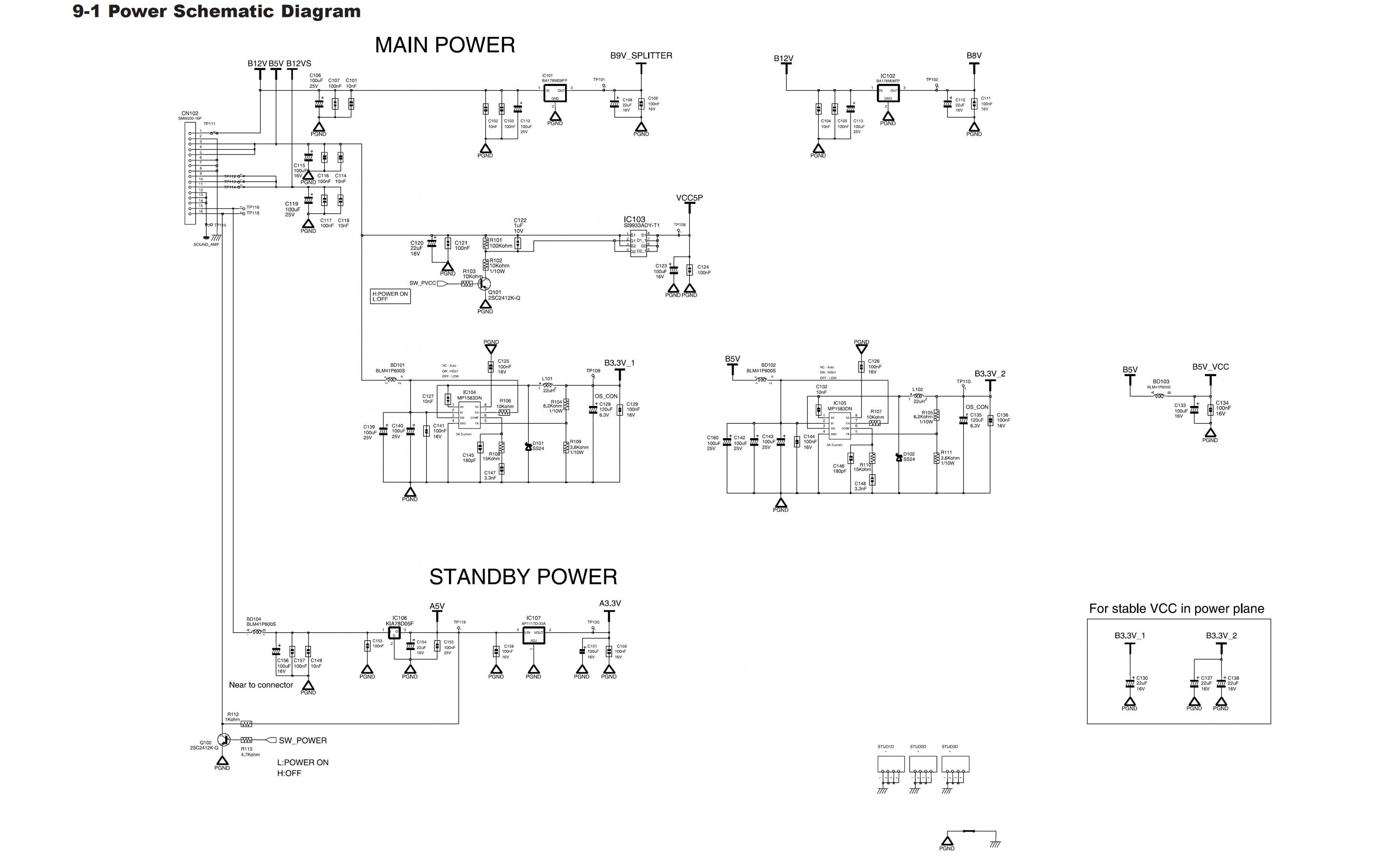

                hi
                these 2 pic for the power of samsung tv taken from the service manual .
                I think will help you
                thanks
                  hi
                  link to service manual
                  good luck
