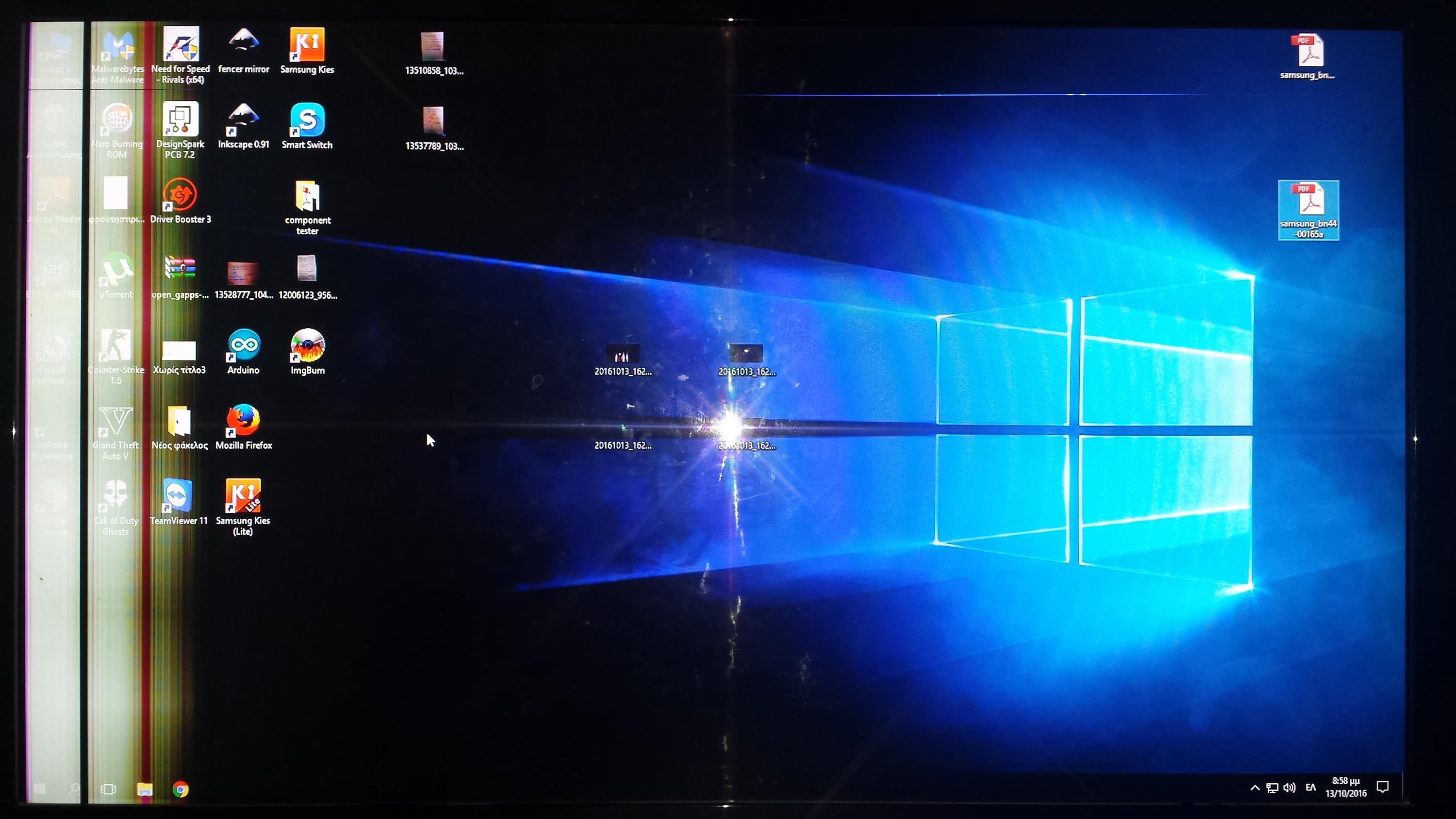

    Hello all and sorry for my english. I have the tv above and the problem is that when i open the tv i hane no picture at all. The half picture is blue and the other is black and gradually in seconds go to black. The sound play without problem. When i coonect via vga or hdmi cable i have picture but with vertical lines in the left and some black shadows.
    I measured the voltages of power suply and are 5.6V(i think is good) and for 12 and 13V i have both 11,5V. I replace the electrolytics capacitors in the psu output but didnt change anything. I see from the schematic that the 13V goes to the inverter board which is working fine, the lamps goes on and stay on altough the 13V are 11,5V to my measurement.
    Also i must say than i replaced the t-con board of the tv and the problem remains exactly the same as before. i thought to buy another mainboard(AVboard) but because is a little expensive i would like to be sure where is the broblem before i buy.
    So, could anyone help me? Is possible to have psu or panel issue or my problem is in the mainboard? Thanks in advance!

      Is it possible to be lcd panel problem and when i conect vga or hdmi the picture is "clear" with lines and when i conect the TV source the picture is completely black? If its the panel the picture should not be the same in both cases?

        Need images of fault.

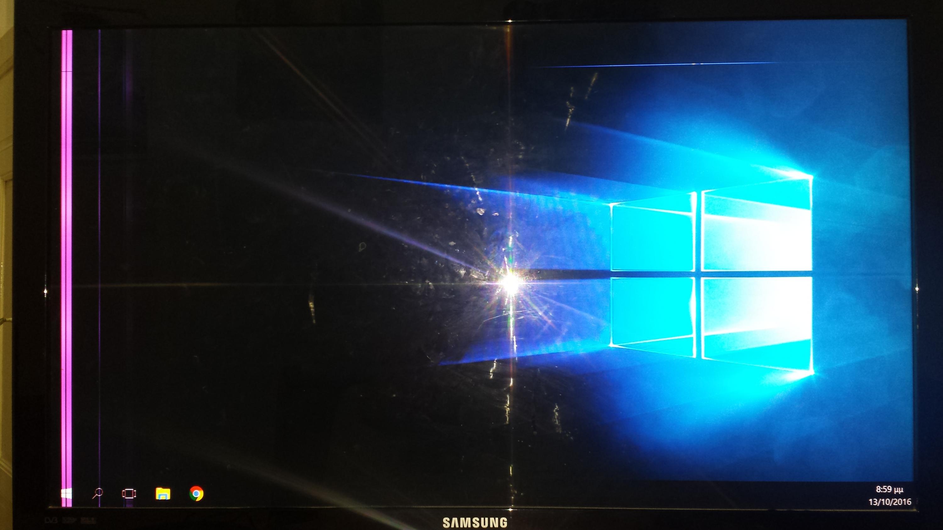

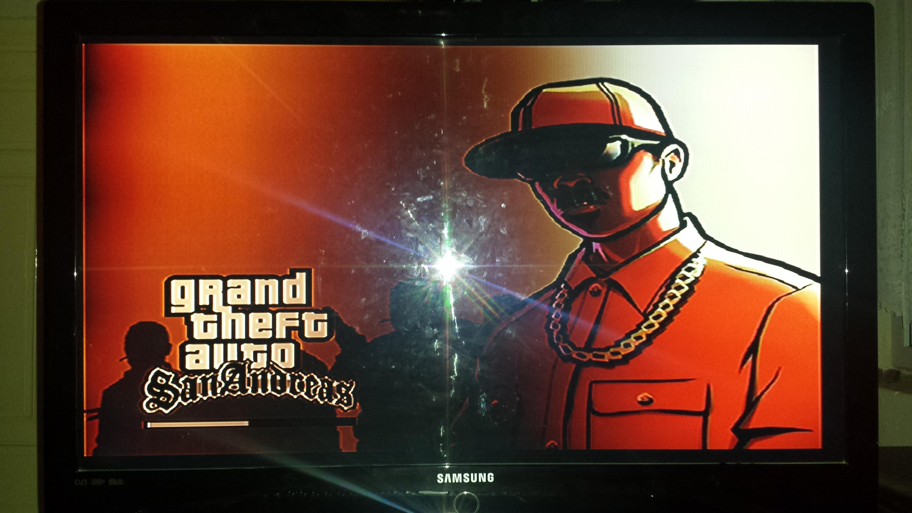

          Re: Samsung LE40M87bdx picture problem
          The first picture is with vga, the second with hdmi, the third with AV conection.
          With the tv tuner as i say i have a half picture blue and in seconds goes and stay to black, only sound play.
          Sometimes when i change the source stays an idol behind from previous source for few seconds. Is tha possible to be faulty panel?

            When using the AV input (photo 3) does the picture on screen remain clear of lines and display correctly when playing.
            • vagos_89
              • Apr 2014
              • 61
              • Greece
              When i connect the AV the picture have some black shadows but for a few seconds only, therln clear and its ok. But only in AV mode.
              • dick_barton
                • Aug 2015
                • 6642
                • Wales
                I would have thought that if you have a decent picture when connected through the AV input that it would be a mainboard problem. Best to see what others think.

                  Also if i try without source. I have black picture in the tuner mode again. And to hdmi, vga the picture is blue with vertical lines. I don't know sometimes i can see shadow idols from previous source that remains to the picture for a while when i change the source and make me wonder that there is a possibility to be lcd panel problem.
