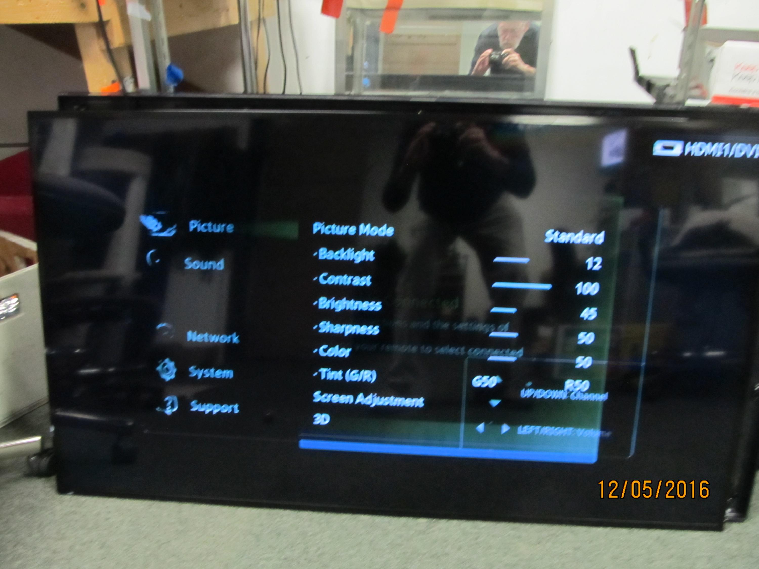

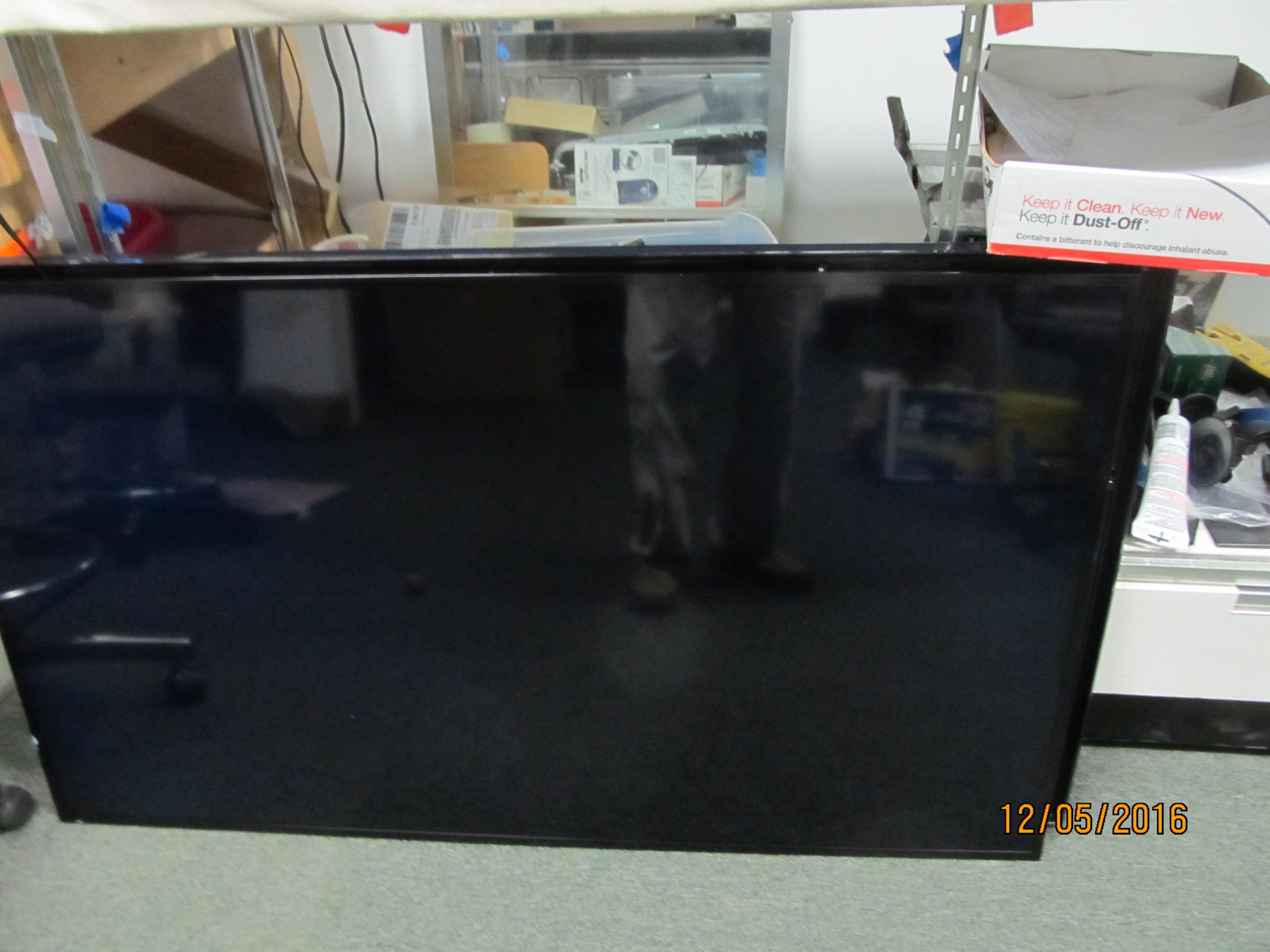

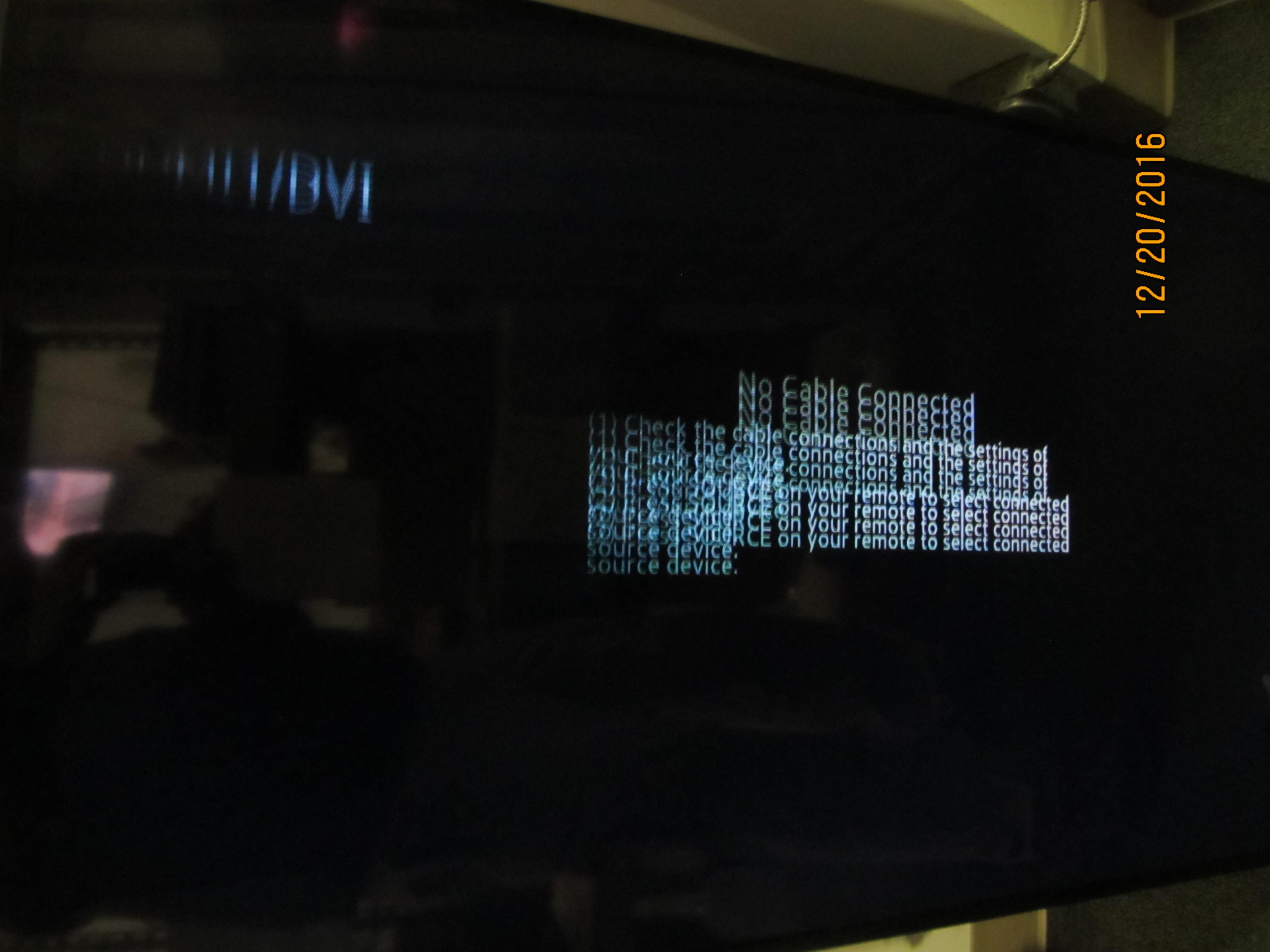

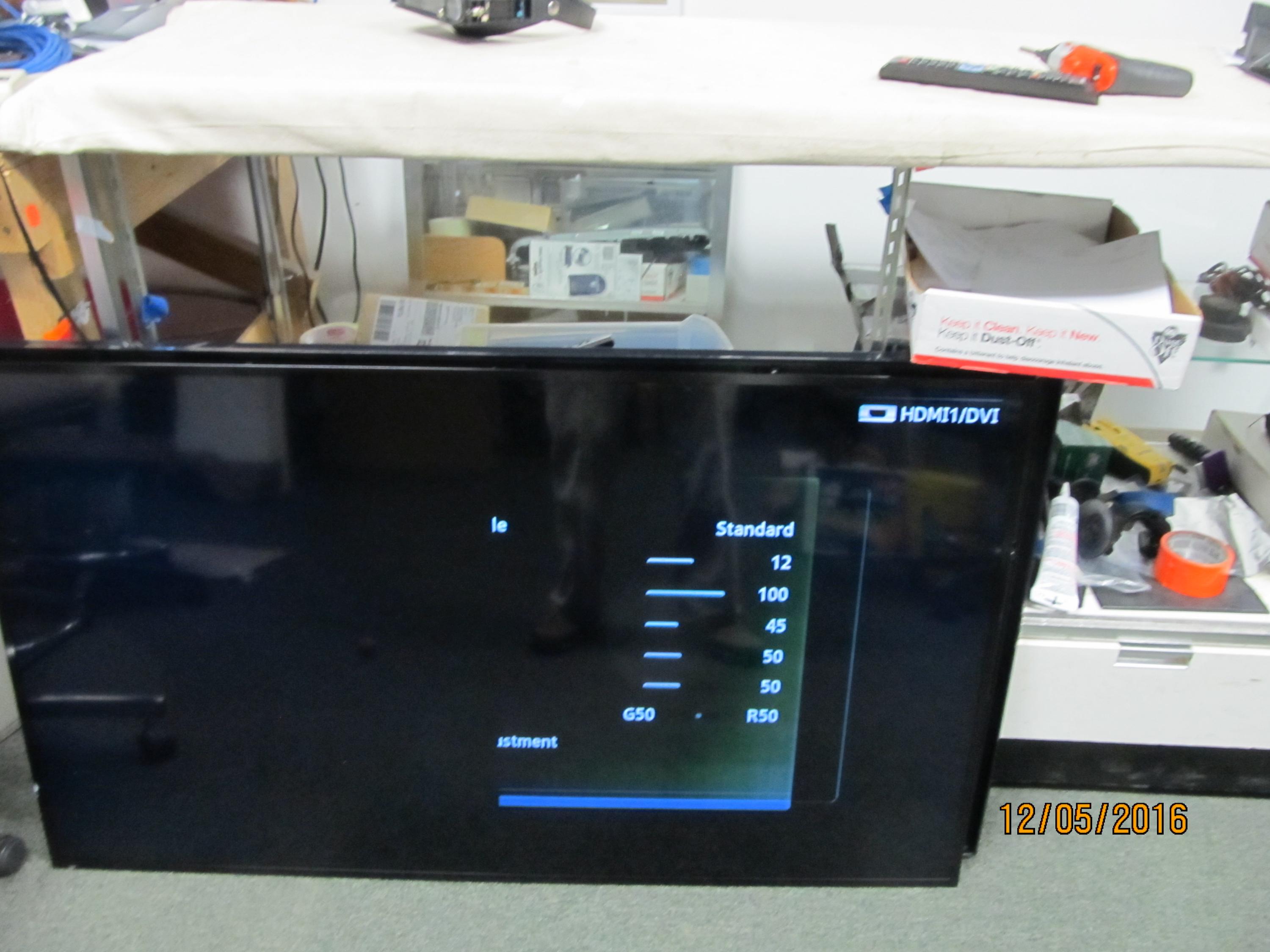

        first picture is with both ribbons on tcon hooked up the second one is the right side unhooked as you look at the back and the third is the left side unhooked.

          I would say panel failure sorry.

              Since removing one side of T-CON ribbon causes the whole screen to show dark it says that your panel/screen is definitely defective.

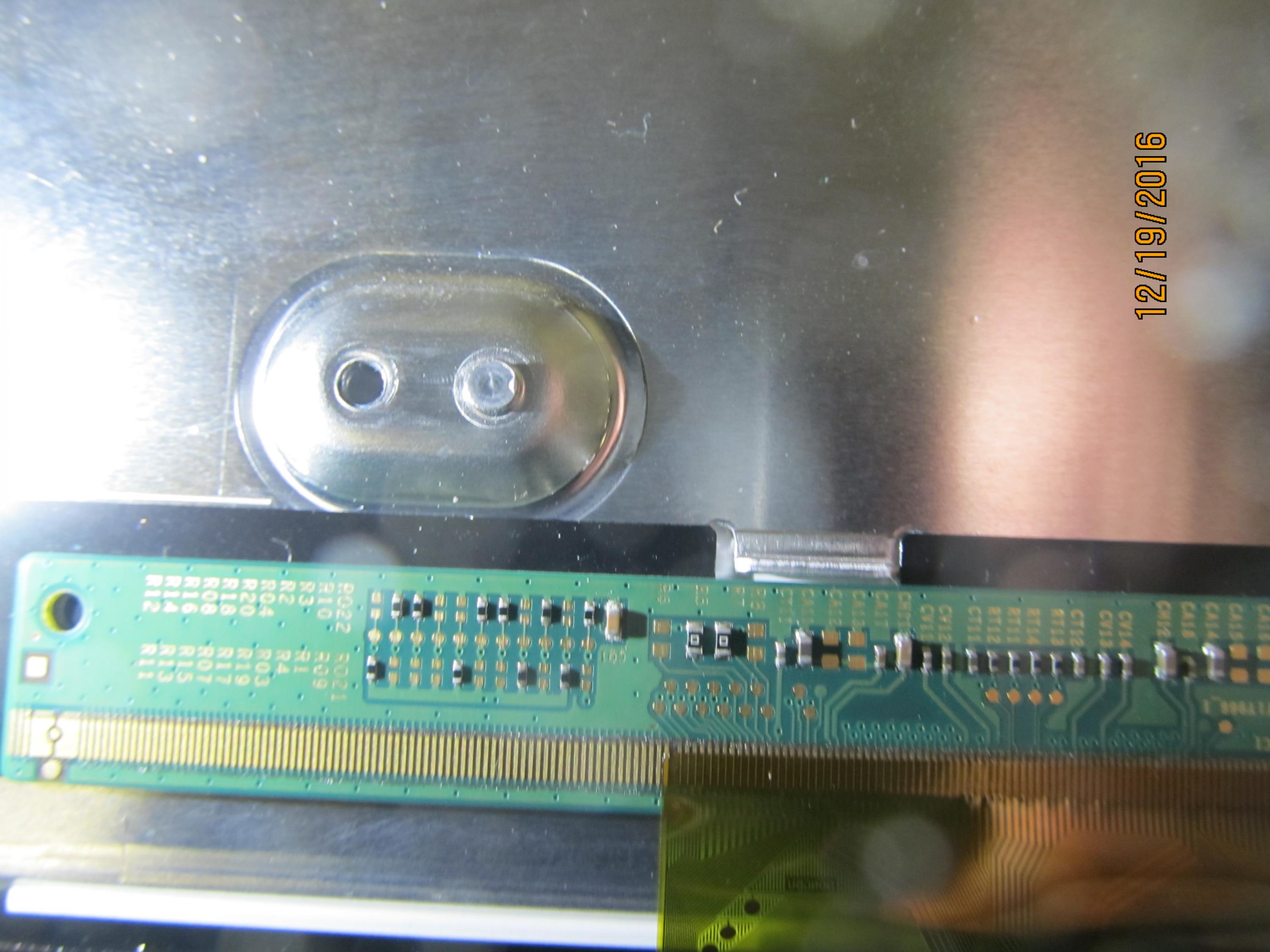

                        Is there a small print board on the panel where the tcon tabs go into? If so might be worth while to measure for a shorted cap on that?

                            Well found one capacitor shorted c01 on the right hand side tab but I have no idea what the value of it is.

                              first just remove the cap and see if short is gone on the board,then turn on tv and try it?

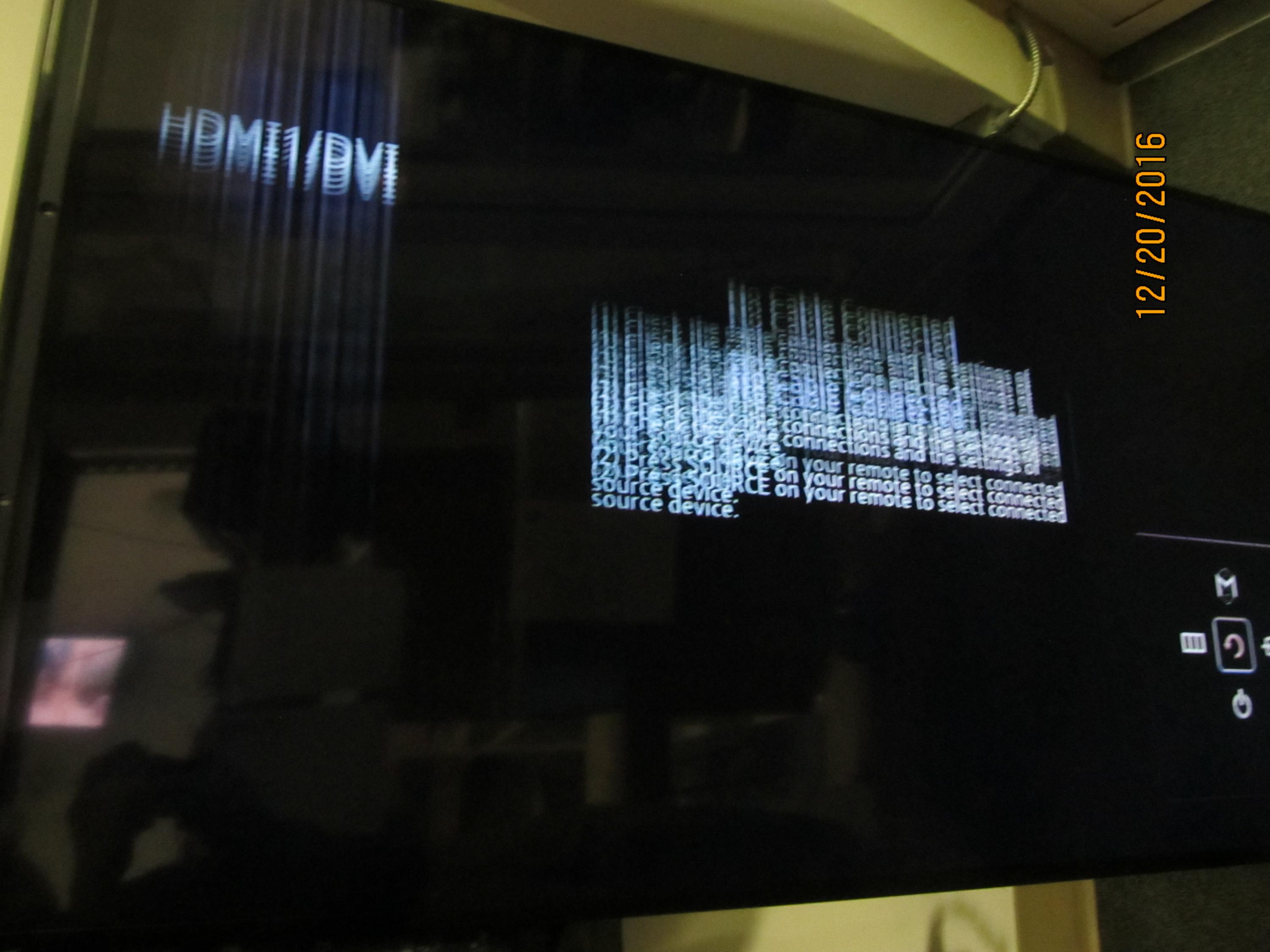

                                    Pulled the capacitor and the short was still there and promptly lost the capacitor. Problem changed, now I only have lines in video on about 1/4 of the side and video is tripled.
