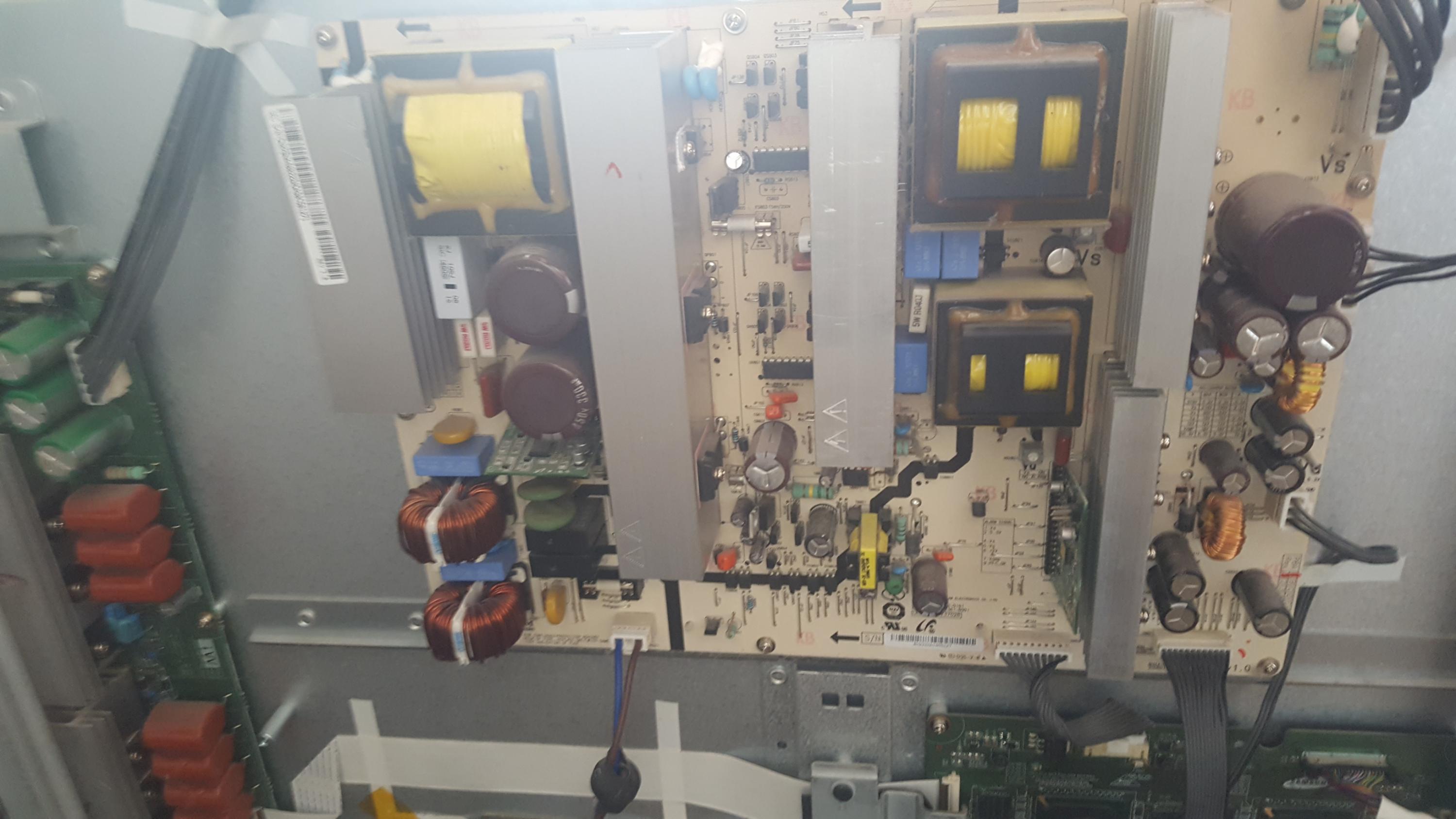

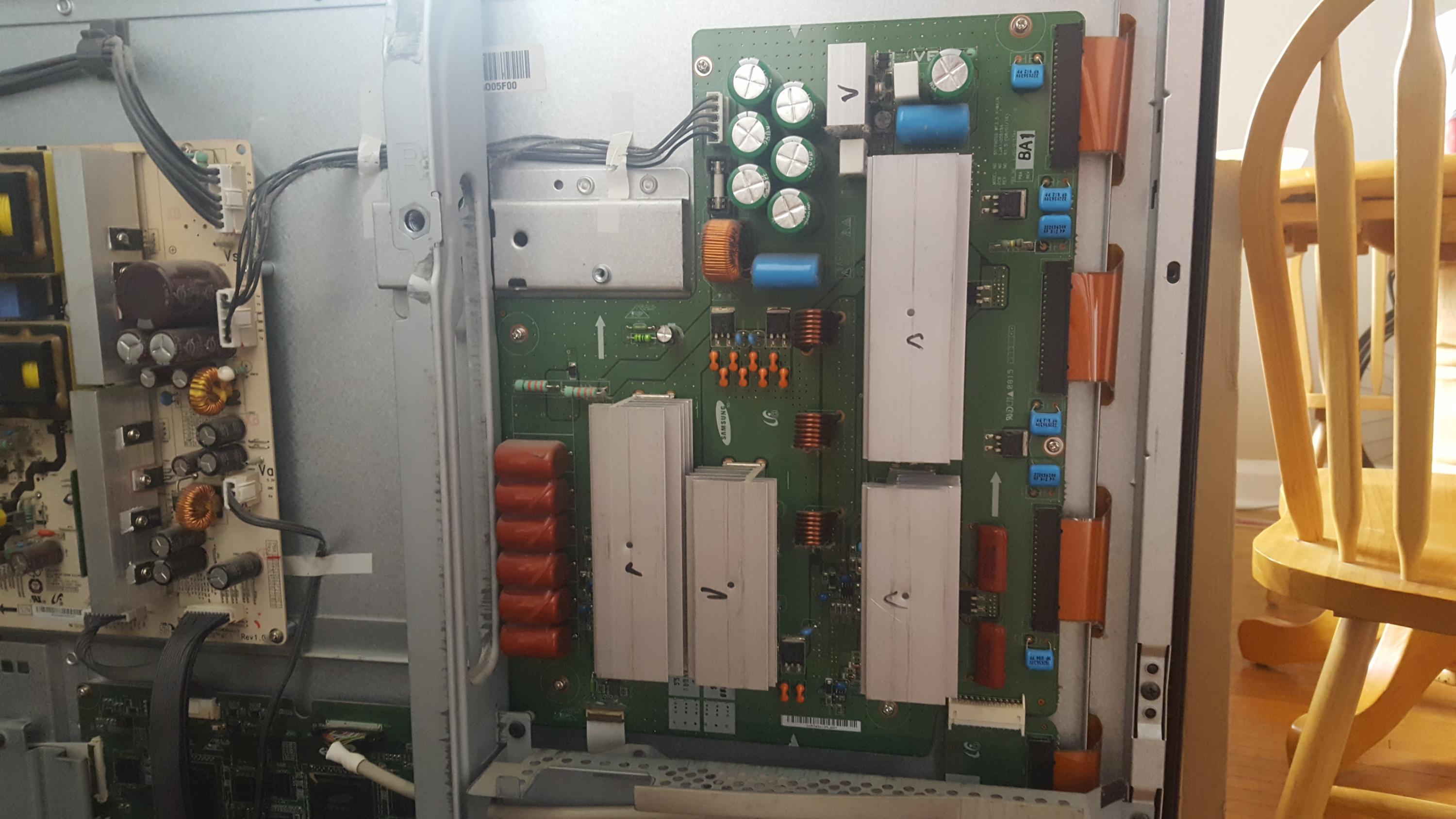

      • thatguy988
        • Oct 2016
        • 19
        Re: Samsung PN50A530S2f Power Cycling

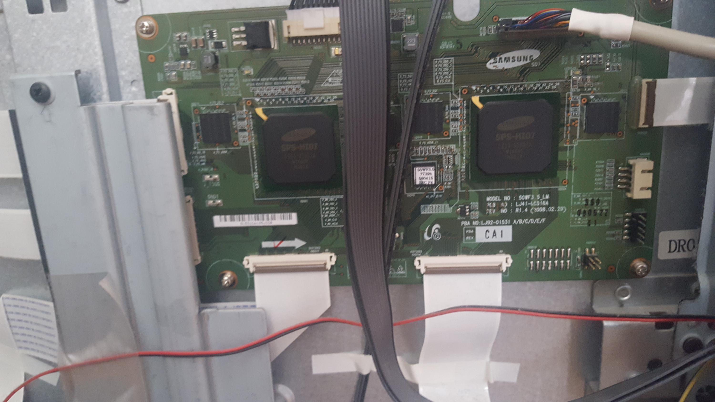

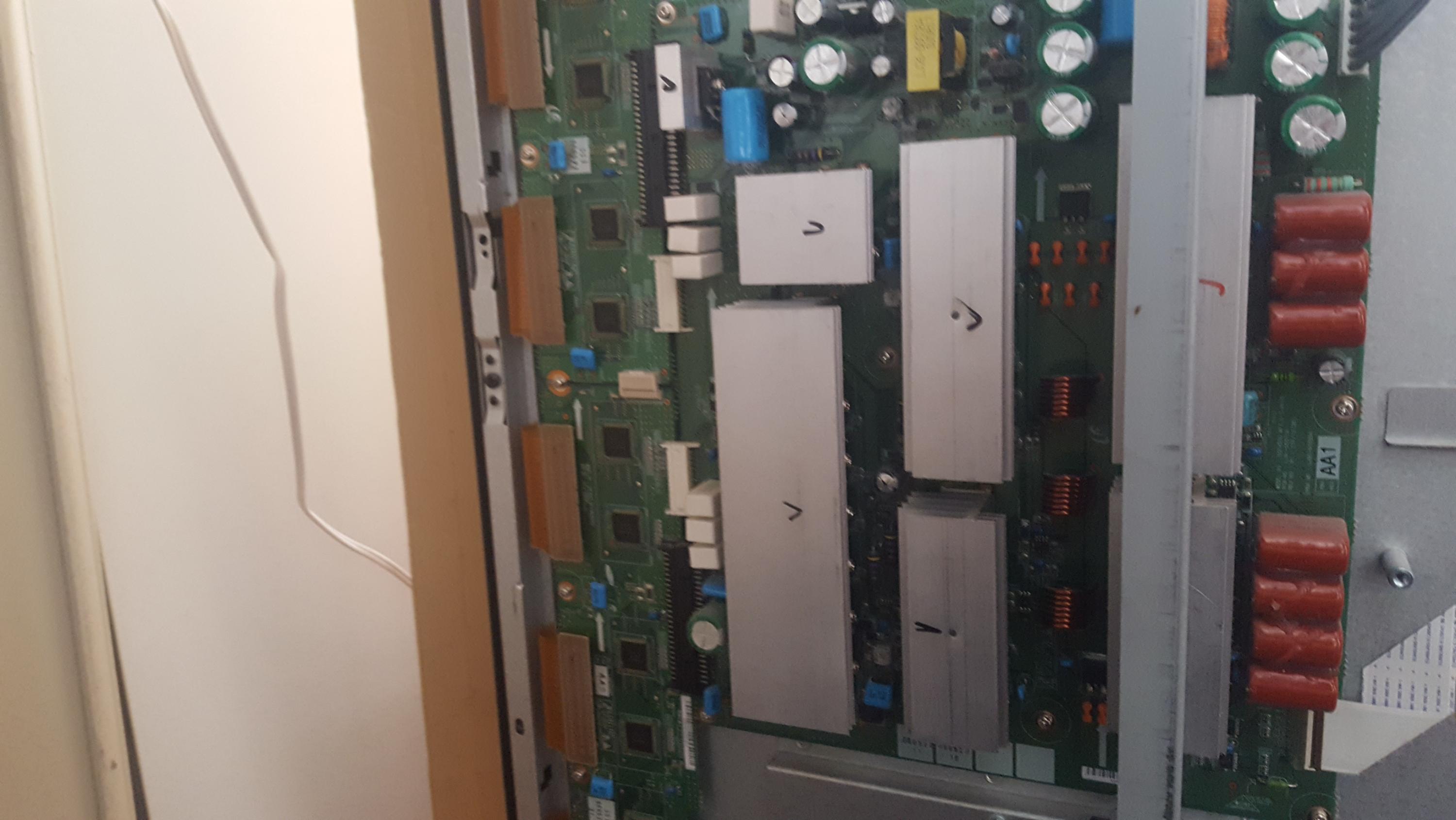

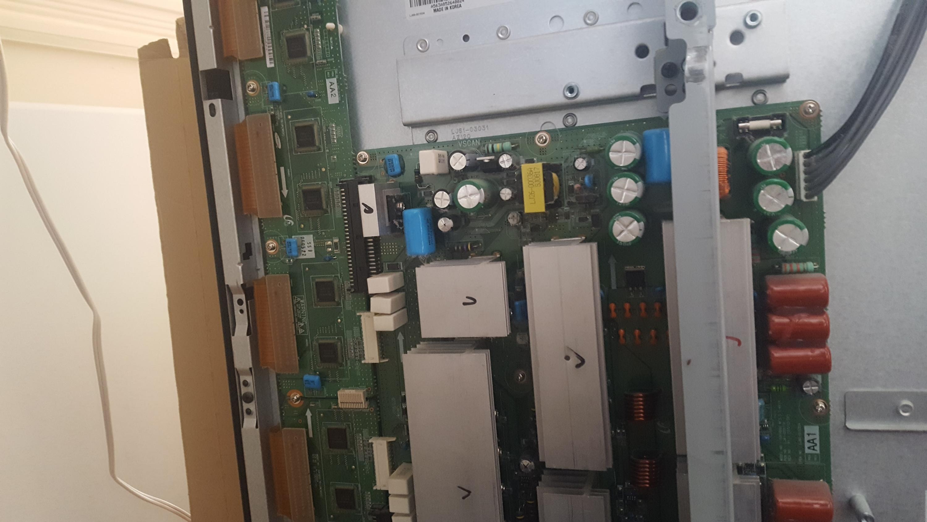

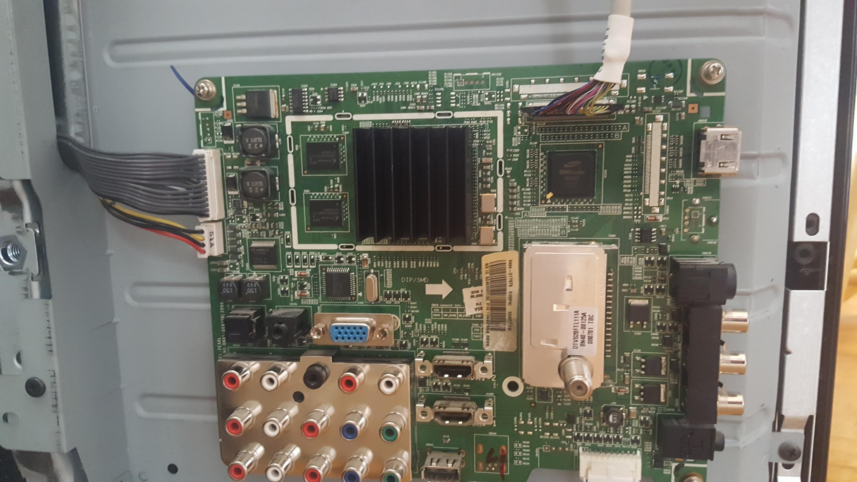

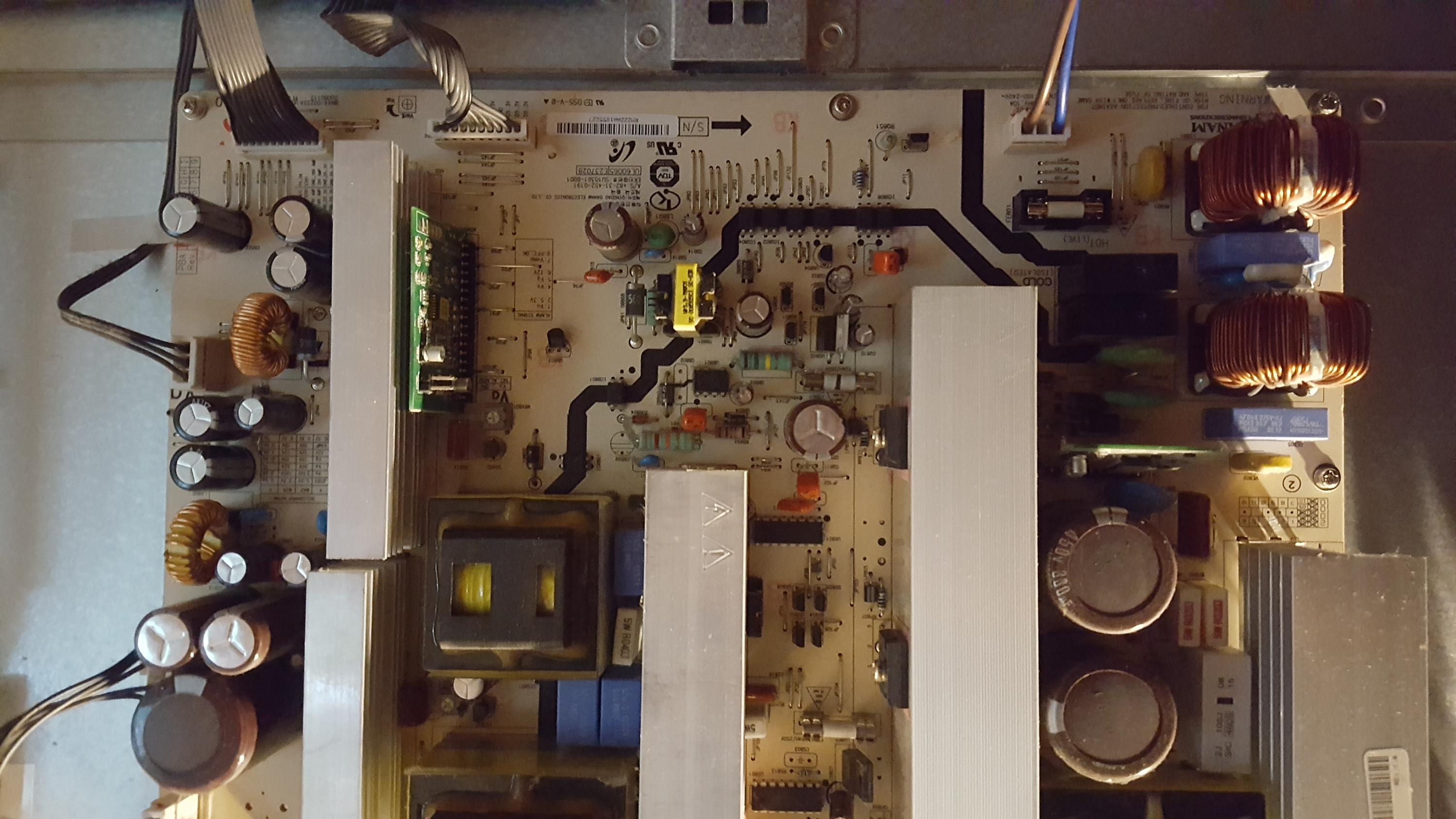

        Here are photos of the different boards on the Plasma TV. I took the main photo from the thread I linked before as my TV is the same. All other photos are the boards located on my TV. Sorry that I did not put them in my original post, I do not know how to edit my posts and I did not think to put any photos in until I read the pinned post at the top.
        Thank you

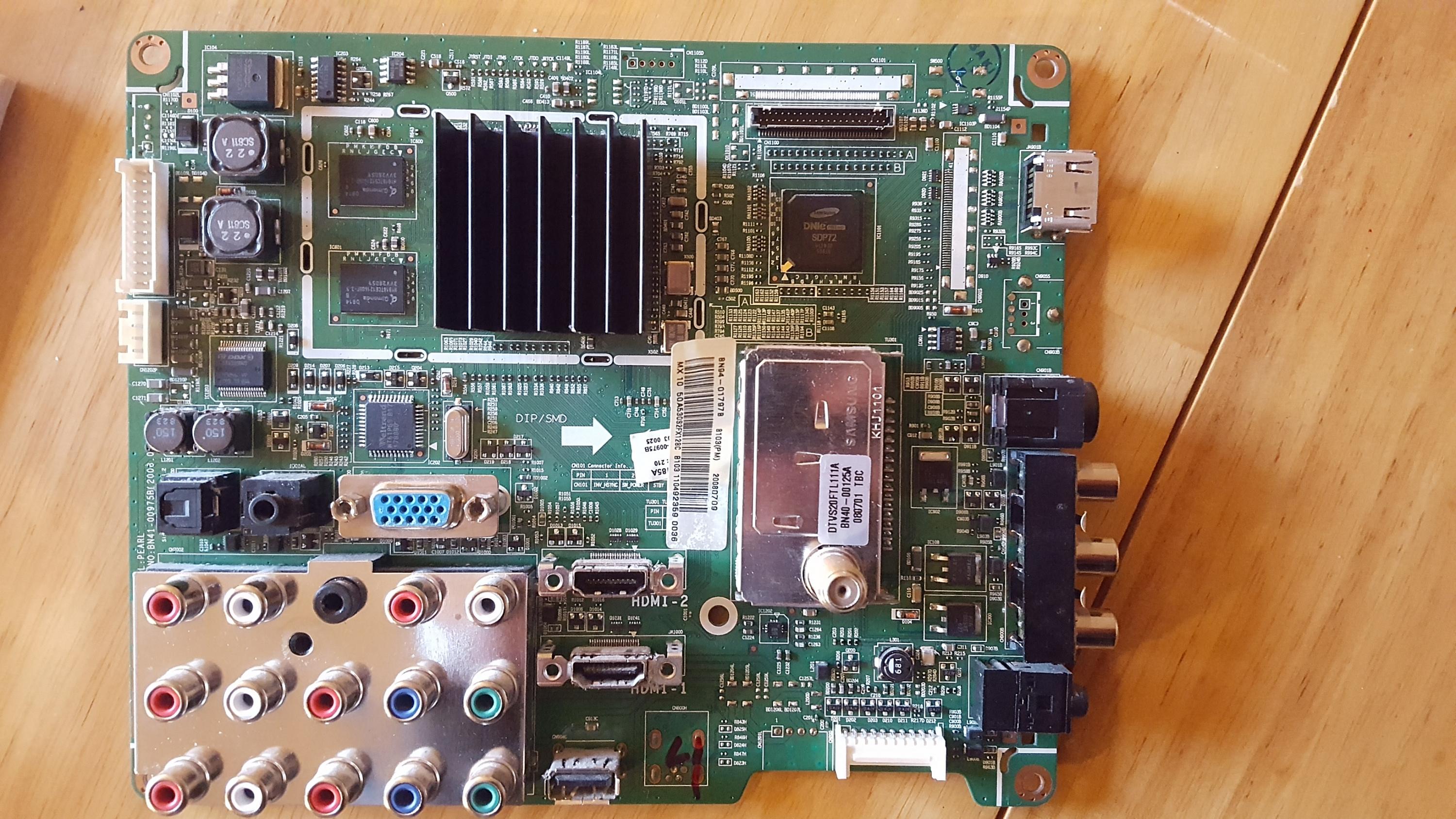

          • thatguy988
            • Oct 2016
            • 19
            Originally posted by cliff_hootarski
            Could you post a clear picture of the bottom of your main board? This may be a "C102" fix.
            Do a forum search for "C102".

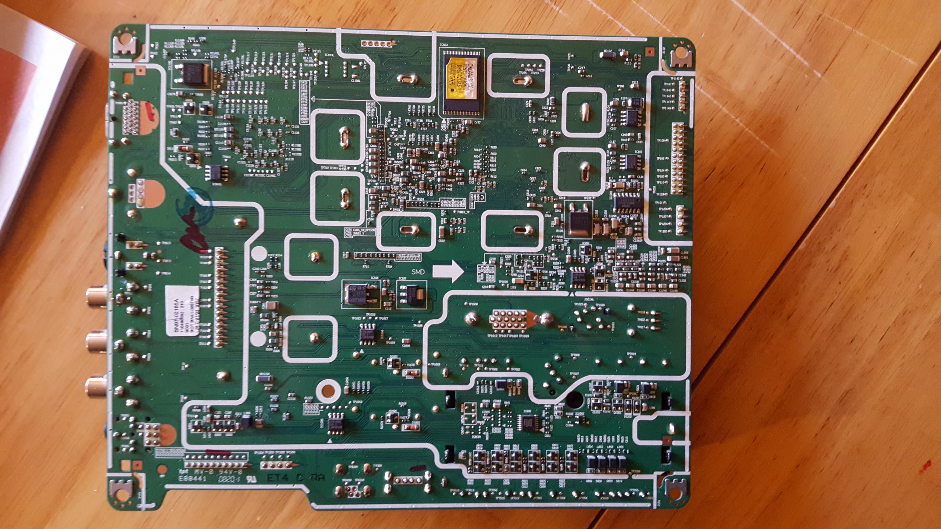

            Hello Cliff here are some photos of the Main board. I was unsure what you meant by main board so I took one of the bottom of the power supply board and two of the main board that has the inputs on it. Sorry that the one of of the Power supply is upside down, I am unsure on how to rotate it as it shows up correctly on my computer.
            • cliff_hootarski
              • Jul 2006
              • 411
              2nd picture, upper right portion. Do you see C102?
              Did you search the forum for "C102"?
              Check this thread:
              https://www.badcaps.net/forum/showth...highlight=c102
              post 21 and beyond.

                  I replaced the capacitor with no luck. I did a voltage check using the Va and Vs test posts on the Power board and was showing no voltage. What would my next steps be to verify that there is something wrong on the Power board and not the main board or logic board not turning on the Va or Vs.
                    On the power board you will see a smaller board bottom right, this board has a fault code led that should be alight when in Stby. and will flash a code if there is a fault on this board (relays click then code is given on start up), you will see a list of codes. are you geting a code? what is it ?

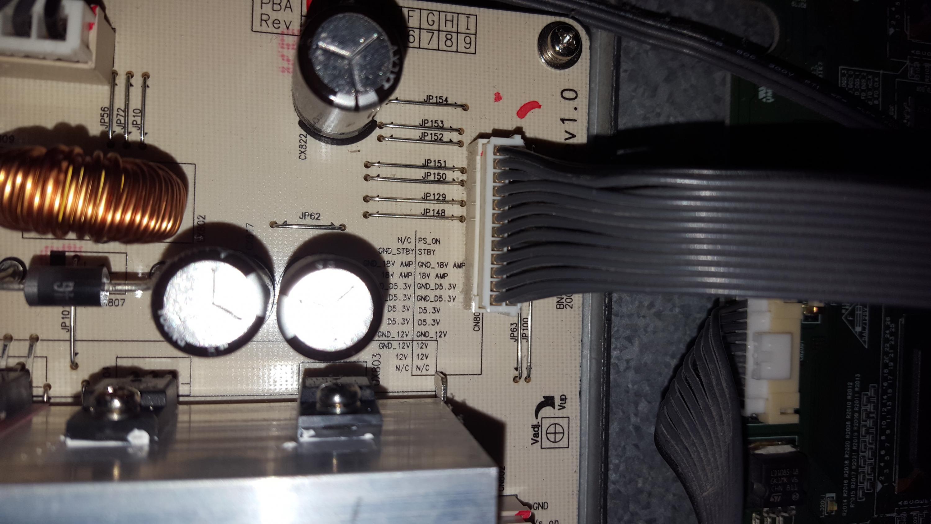

                            • thatguy988
                              • Oct 2016
                              • 19
                              Hello Flocko,
                              When putting a resistor between the PS_on, and a ground the power board clicks on and stays on. When all boards are connected to the power board and the PS_on is connected to the ground the relay clicks and stays on. The connector I did this on I could not find the +Vson and 5vsby you were talking about. I have attached a photo of the connector I used.

                                    • flocko
                                      • Nov 2012
                                      • 1121
                                      • uk
                                      one step at a time. with PSon to ground (no need for a resistor) check all the small voltages 5.3v/12/18v+Va should all be there now, so check these and get back after, then I will tell you how to get the VS to come up . Packard93 these powerboard do not work with PS.on to standby
                                      • thatguy988
                                        • Oct 2016
                                        • 19
                                        Hello flocko,
                                        After turning on the Power board I checked the main board connector voltages. The only two that are showing a voltage are the PS_on and the Standby pin.
