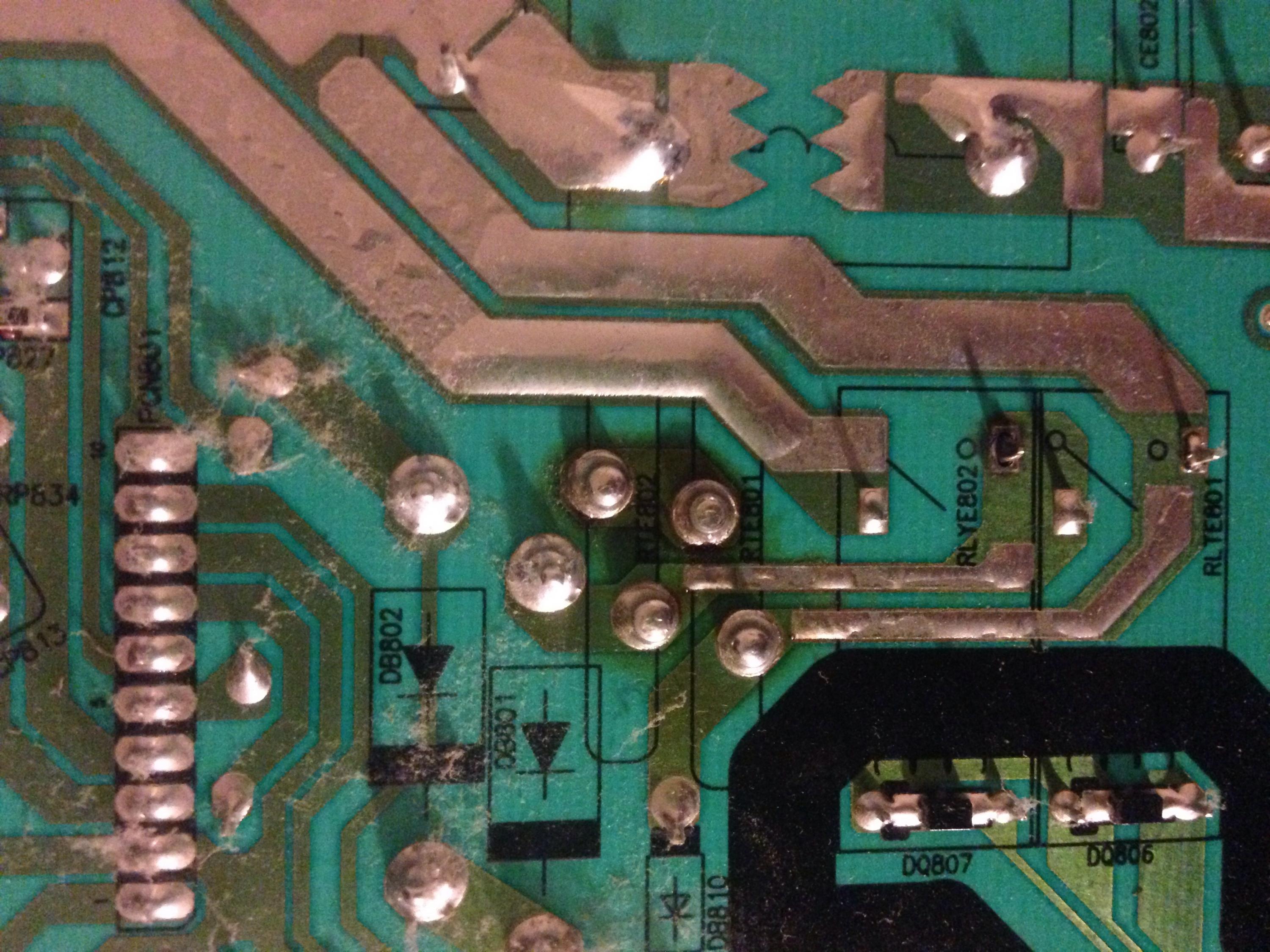

                      I have checked the voltages of all of the metal strips located on the board. I have attached a excel sheet that has all of the JB numbers that were reading anything besides zero. If you would like I can create a photo over top of a schematic with the voltages corresponding to the JB number. When doing this I found some discoloration on the board, I have attached a photo to this post. Sorry for the delay in reply, the last two weeks have been very crazy!

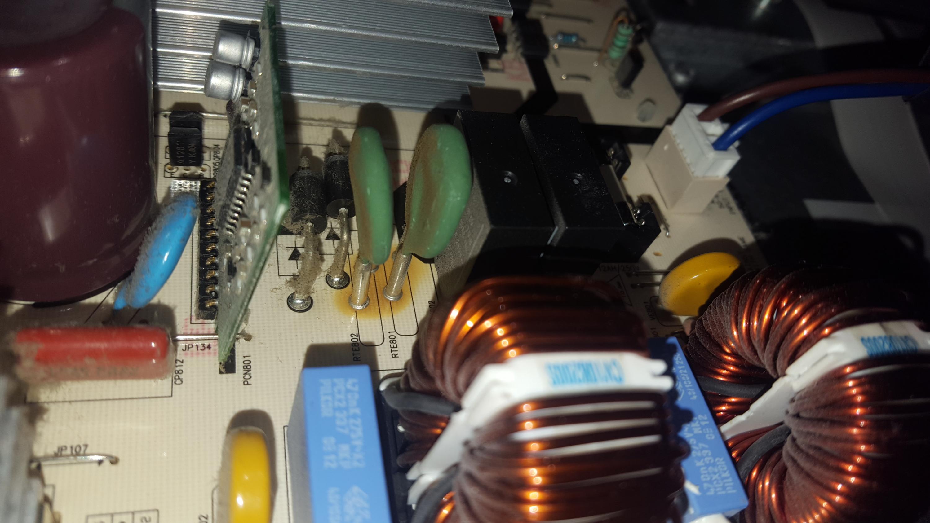

                        Does anyone know how to tell if the RTE801/802 are still working? As well as what the part number is for them. When replacing them do I have to take any precautions for the board as the backside seems to be a little burnt. I have attached a photo of the front and back of the board where the RTE801/802 are attached. Any help will be super appreciated. Thank you in advance.

                            I replaced C102 as well as the IC with no luck. When doing low voltage checks on the power board when the power board is turned on there is no voltages to any of the connectors going to the main board. This makes me believe that something on the power board is fried. I also noticed that there is some discoloration on the power board around RTE801 and RTE802, which makes me believe that that is the problem on the power board. What do you thing?

                              The TV turned on last night and has been working good since then. There was two pins on the two relays that were not soldered. After soldering them to the board the TV fired right up and the picture is good! Hopefully it is fixed for a while! I want to thank everyone for helping me with my TV and putting up with my confusion.

                                BTW, the RTExxx is NTC for current inrush limiter and they are bypassed by the relay contacts when the TV is turned on, if the relays fail to bypass them then they will run hot, they are not supposed to be in the circuit once TV is turned on.
                                They are usually around 5 Ohms at 25c.
