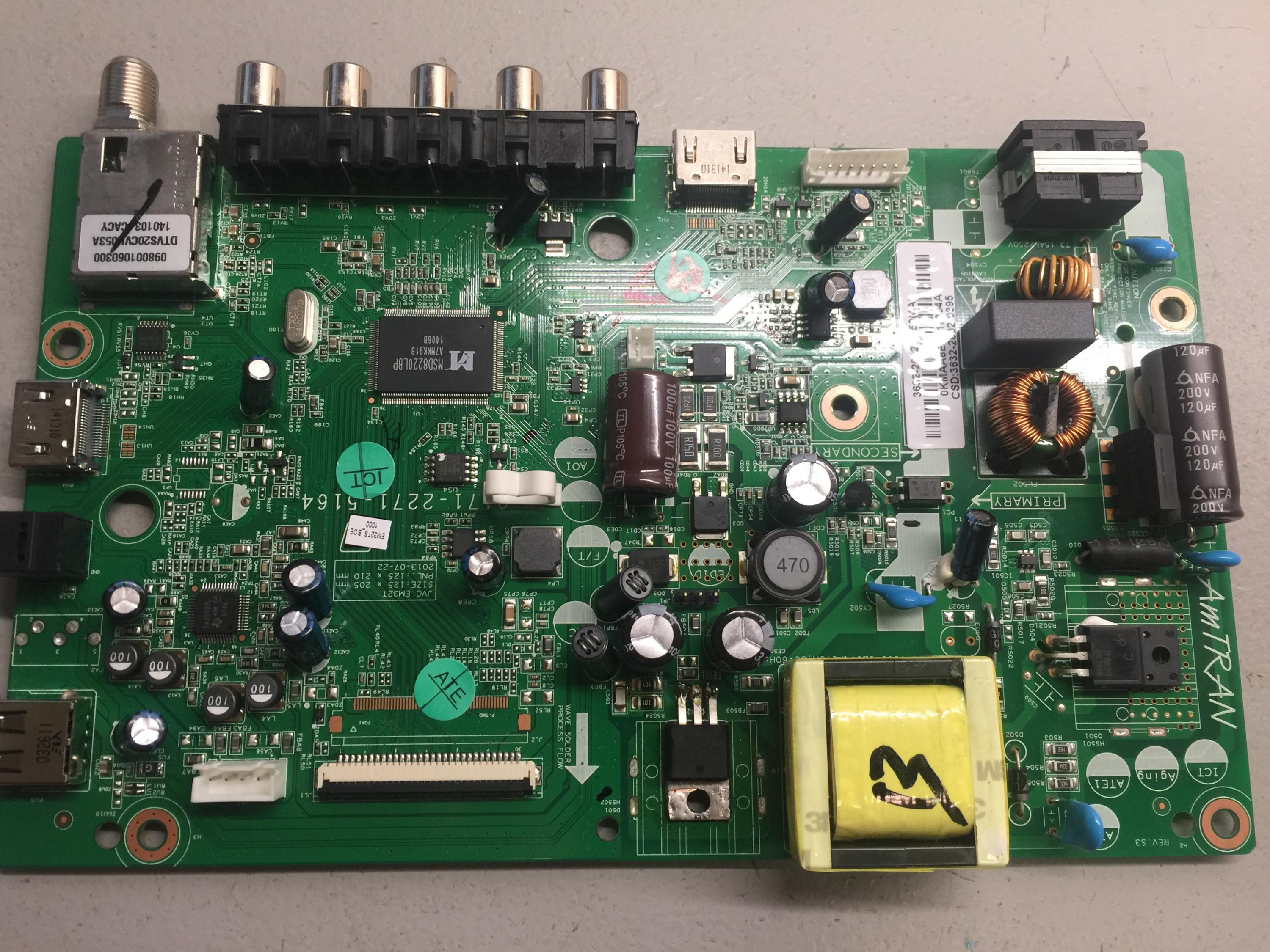

    I'm new to TV repair. Thanks for any and all help.
    I have this LED TV that lights up, but the screen stays black. I can tell the backlight or leds come on though, but no image. I can't find a service manual for it. Any help or direction on this one?
  • mikeyd
    • Jun 2016
    • 21
    Re: JVC EM32TS LED - No Display, yes backlight
    at J14 (connector next to the input)
    pins
    1: 5v
    2: 0
    3: 0
    4: 0
    5: 3.3v
    6: 5v
    7: 0
    8: 1.5v
    i'm sure one of those is my PS on but nothing is labeled.

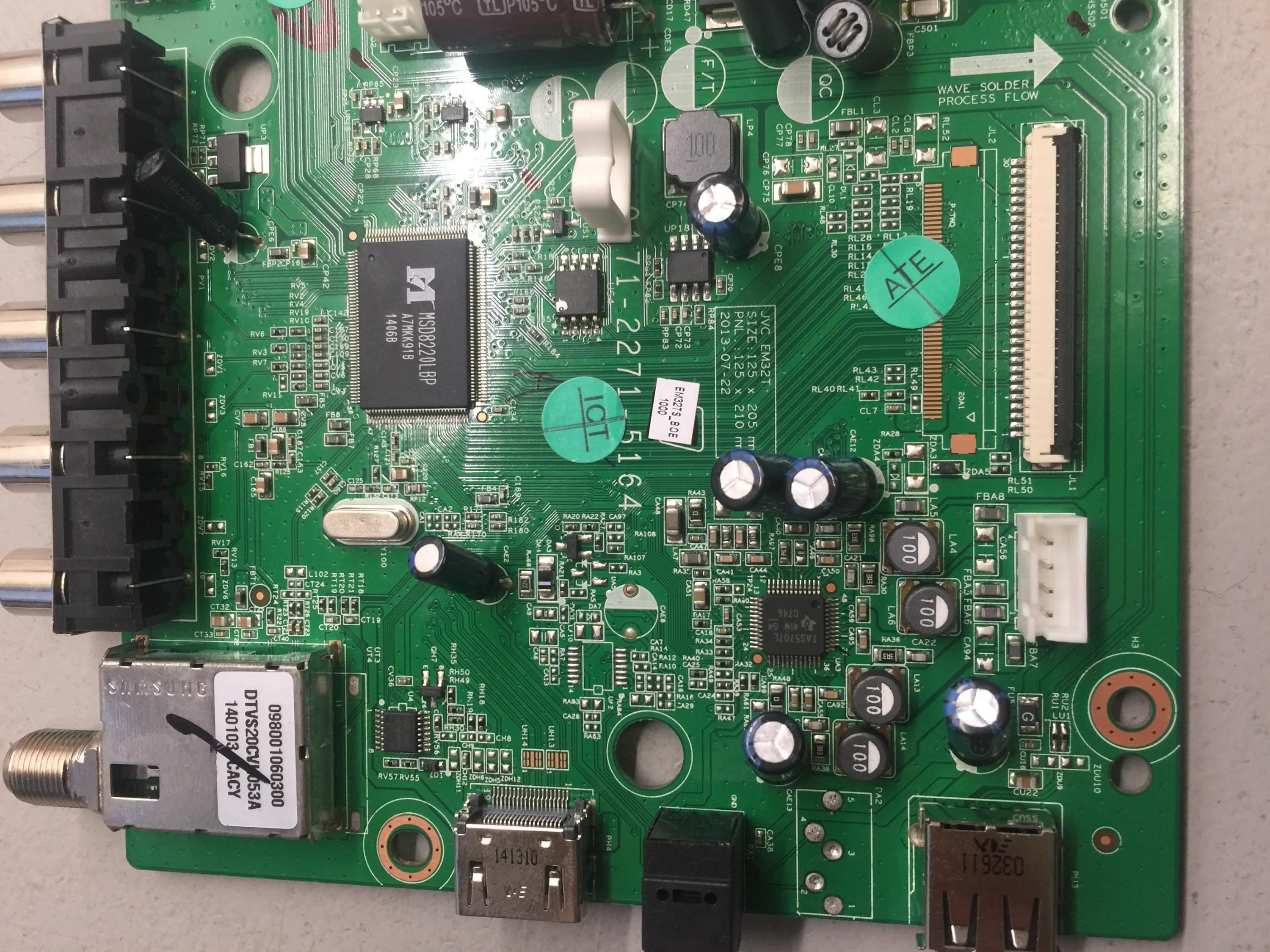

      did you have sound ?
      BTW you need to seated the LVDS cable which go out from Boards to LCD, its wrong show on the photo

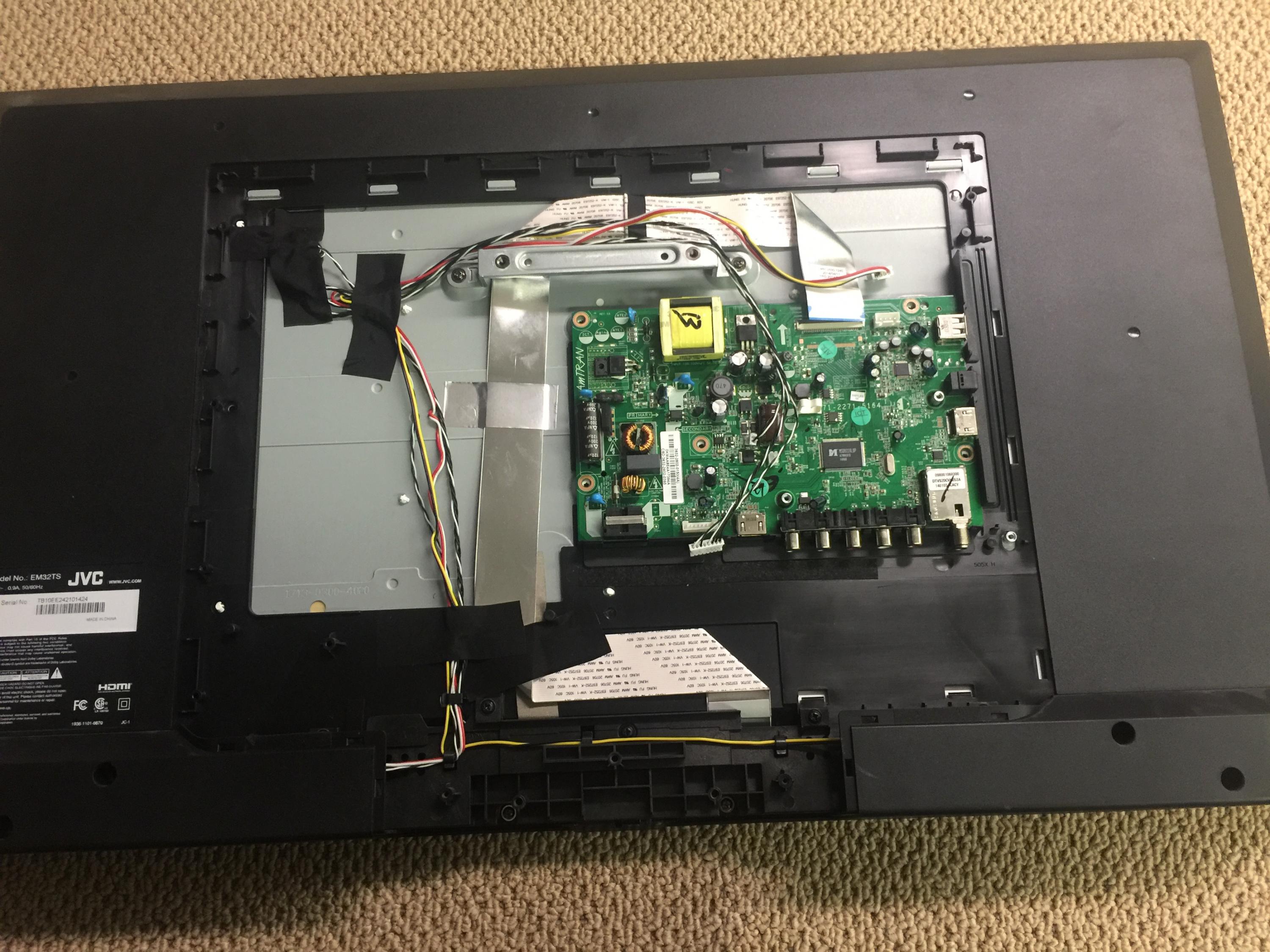

        on the photos i didn't have any of the cables connected. i had already unplugged everything before remembering to take photos lol.
        i did not test sound. i can hook something up real quick to play a movie so sound comes through. let me go check

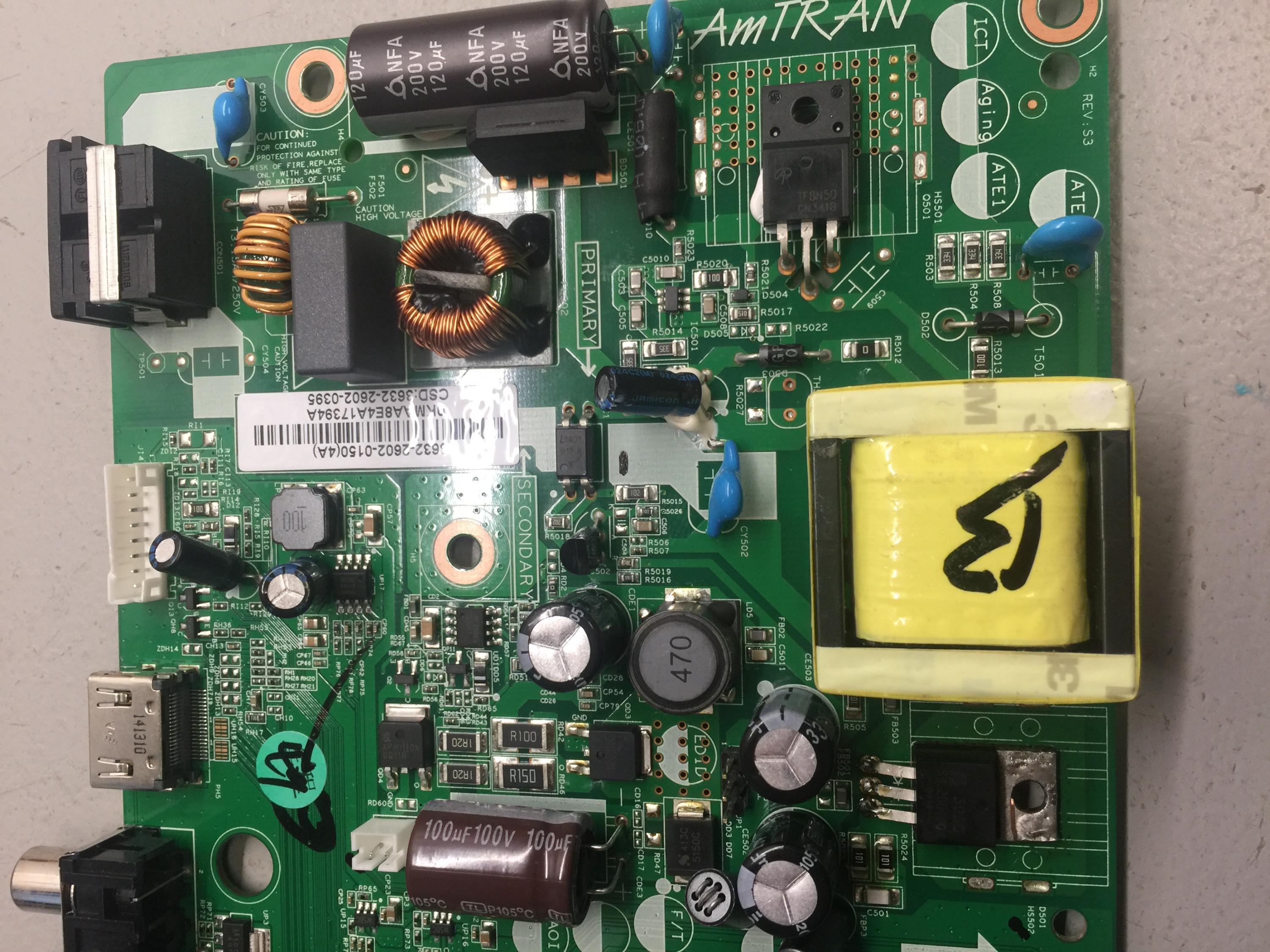

          on photo no 5 the LVDS siting just one side... this will make more damage
            yes, that was just because i laid the board in there just for a photo. i unhooked the cable.
            and i cannot test sound because I cannot change the input on the tv because I cannot see the display.
              its complex to trouble shoot ,, as the boards all in one. but one things you can do,, take the boards out.. and with yours DMM on Diode peep ton method check all SMD component No started with FB they are fuseable SMD parts.
