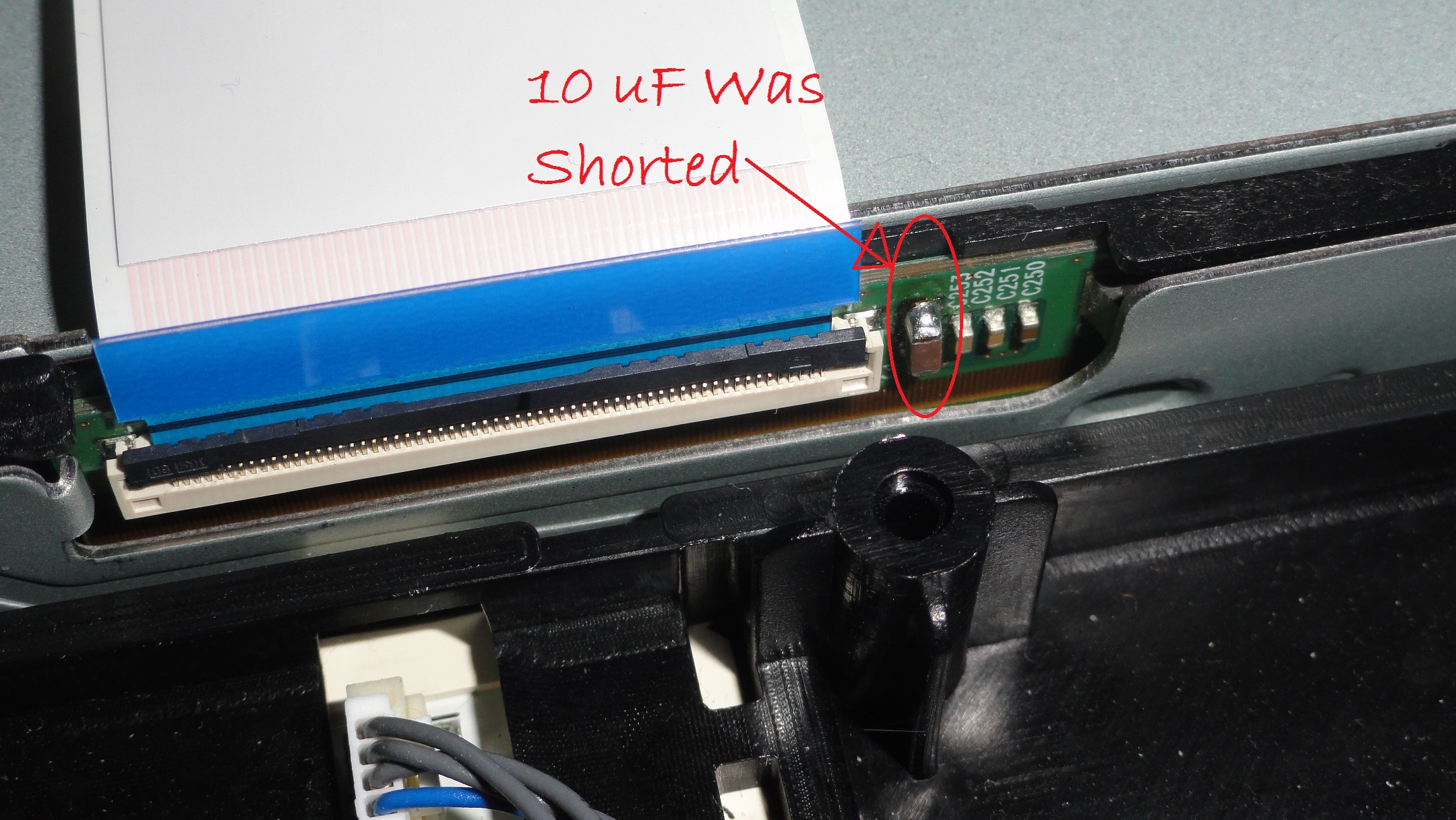

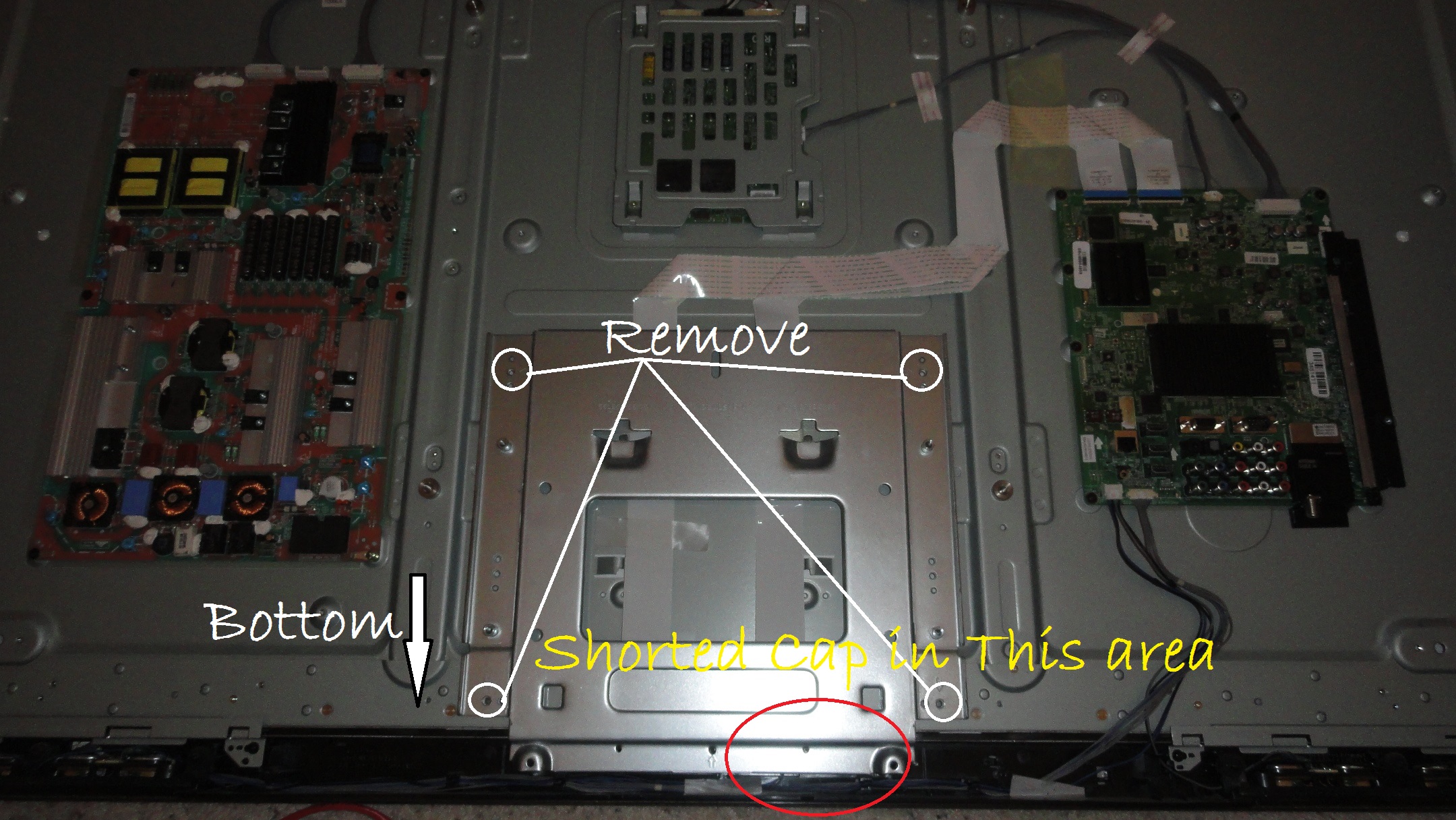

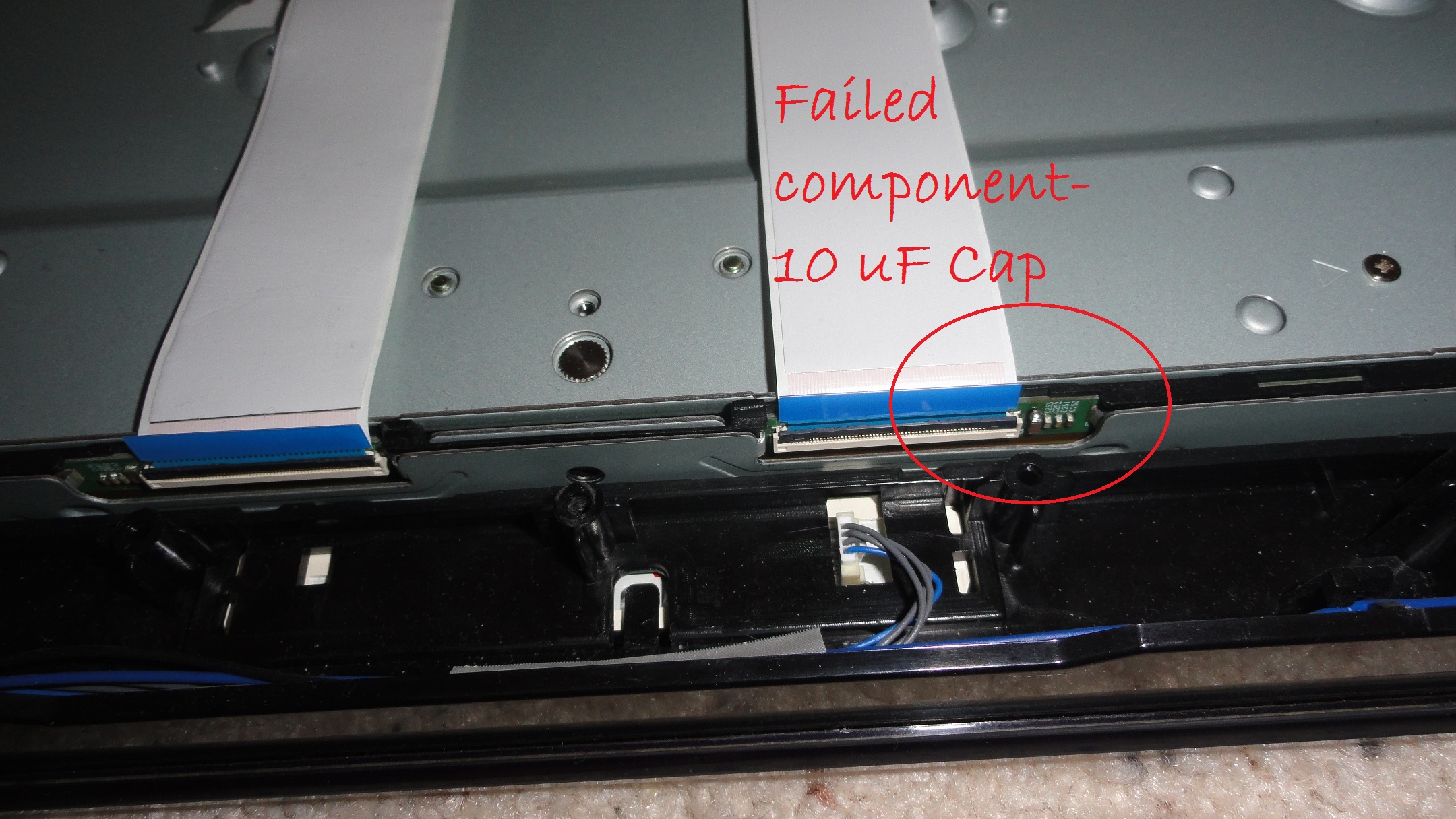

          Just a quick update.. I know this is something rare, but it turned out there is a ceramic capacitor (10 uF) on the panel boards (the skinny boards that the LVDS cables from Tcon / Main card connect to) that was shorted.
          Replacing that, took care of the problem.

                Re: LG 55LE5500 with main board EBU60904803
                Sorry it took a while.. but here are some photos that will show the bad component. Replaced with a 10 uF X7R @ 16 V
