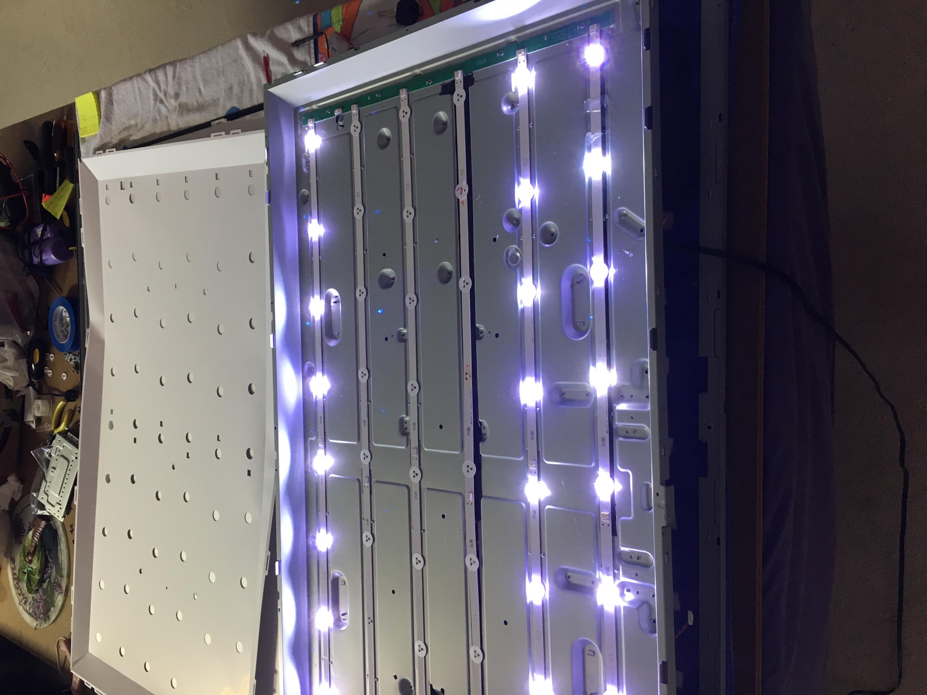

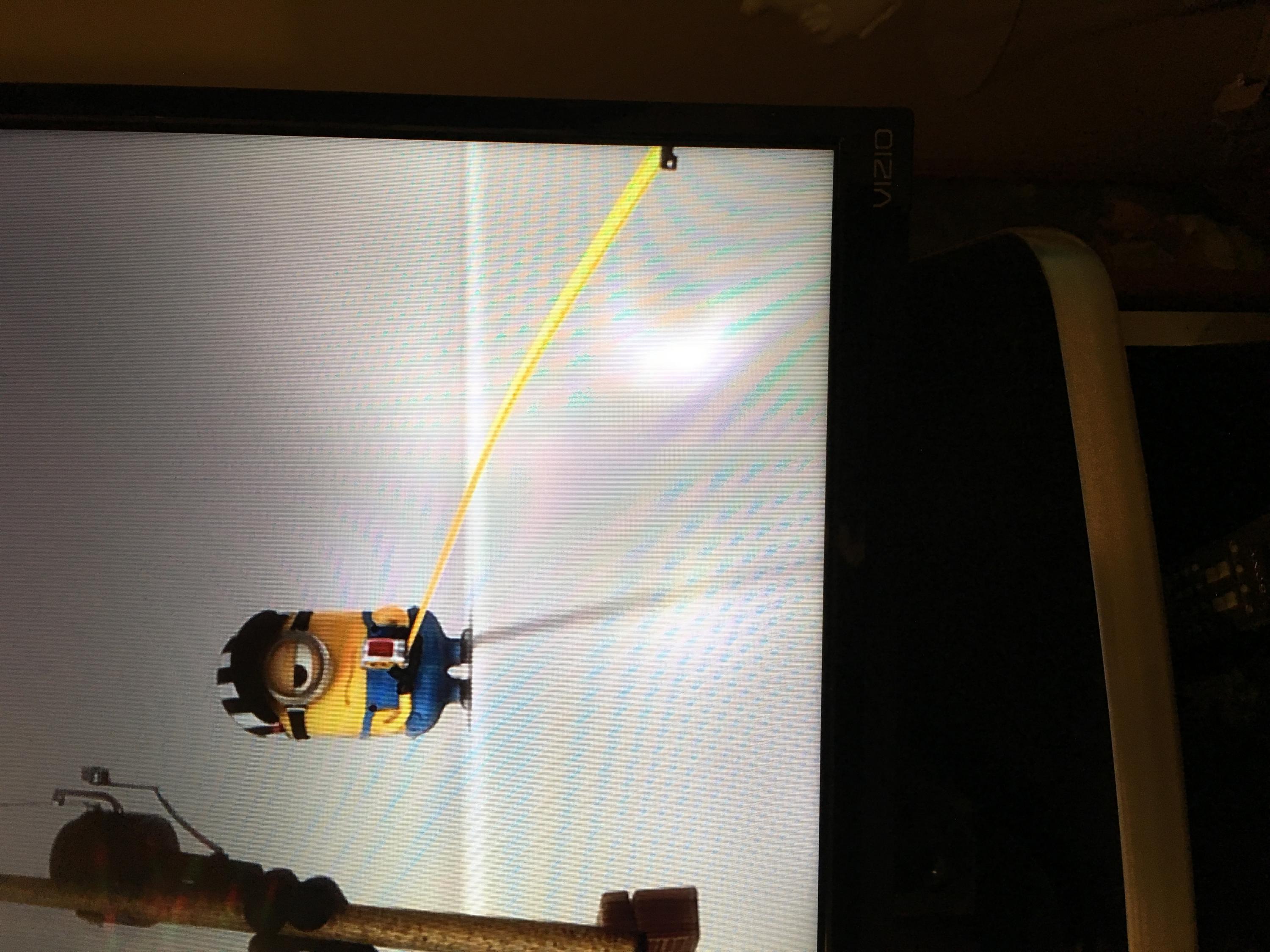

    I picked up a Vizio A470i-A0 that was told has a power on issue. After taking a look at it turned out to be a LED backlight problem because it had sound and picture using the flashlight test. So I took the screen off and removed each of the round plastic diffusers that sit over the leds in order to test them. I found 3 that were out. So I soldered on 3 good ones from an extra led strip that I had. I went ahead and put the round diffusers back on and now have picture but it has sort of a spot light effect to it. I wonder if this is due to the led light diffusers that sit over the leds?

    the diffusers need to be sitting perfectly flush to the strip and in the same orientation as when they were removed.

        Ok went and took screen off again and powered it on. Looks like I have 3 rows of leds out in the middles section and 3 rows that work. Testing voltages I have 104v and 20v. The other bank reads 125v and 2.2v. I tested each led again individually on the strips that do not light and they all lit. So is this a power supply issue or could it be the board that all the leds plug into?

          There a possibility that there's a poor connection at the end of one or all of the 3 led strips that do not power up. Use your meter to check for continuity on ohms with set off. If there is a continuity problem then use a small piece of wire and solder the led strips to the connecting (T) strip.

            Found out what the problem was. It was one of the new leds I soldered on. It was a poor solder connection. All LED strips now work. Right now I am painstankeling adjusting each individual led diffuser cover lens.

              Wow this is starting to be a real pain putting these led diffusers covers back on. I just can not get them right. I have maybe 12 or so left that just do not want to work right. I went as far as lining sheets of white paper in between the screens and it helped take away the spots but i could see where the edges of the paper were.

                another thing to pay attention to when replacing led's is making sure that you secure the strips back down with double sided tape, as if they are slightly warped, they will throw the light around unevenly as well.

                  Went ahead and redid all the led plastic covers. Took me about an hour to do but it was worth it. The picture looks great and there is no noticeable spotlighting.
