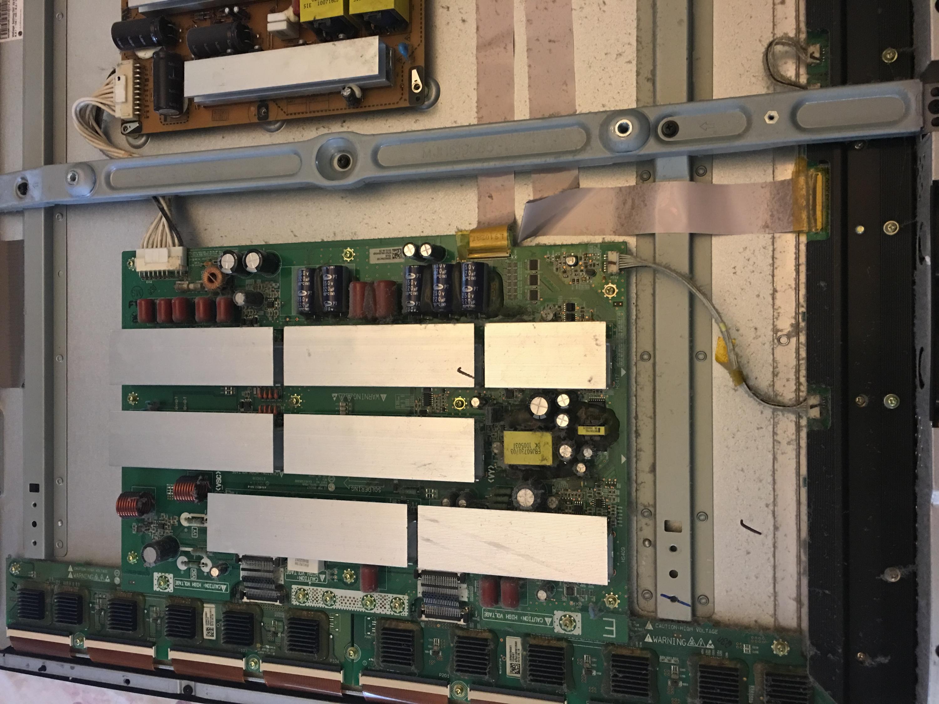

    When turning in the tv it will turn on then off after turning it on again and again the tv will finally stay on..
    Anyone have any ideas or know of a common problem with these tv's?

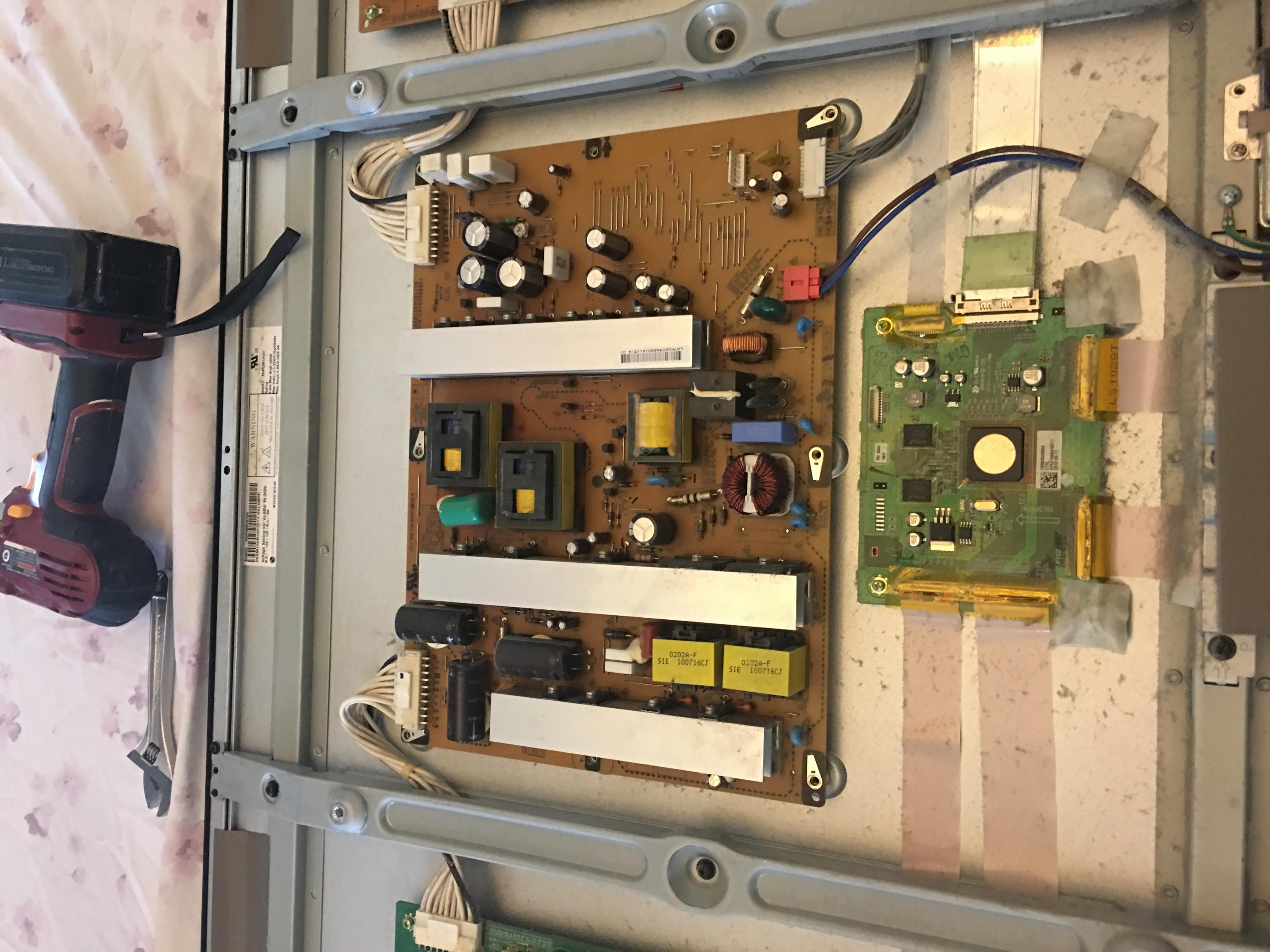

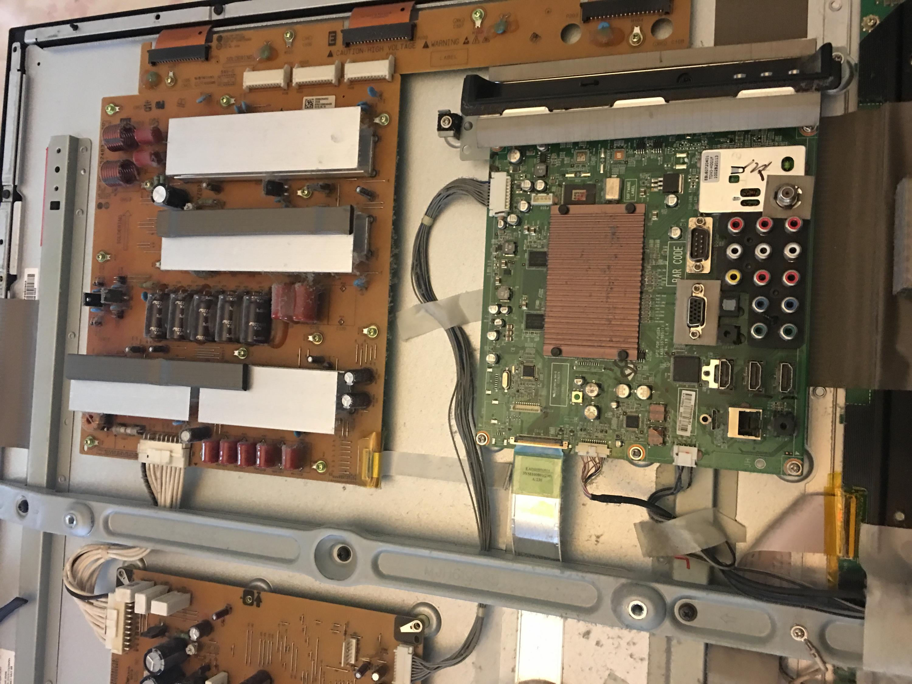

    Sounds like bad caps in the power supply. Do you have a multimeter, and can we see some pictures of the boards inside the TV?

      Yes I have a multi meter ..
      Here's some pics of the boards

        So I should start by testing the caps on the power supply board correct?

          Little reseach wouldn't harm you, run the test patterns first rule out mb.

            I could be the main power supply. There is also a regulator on the heatsink that seems to fail a lot.
