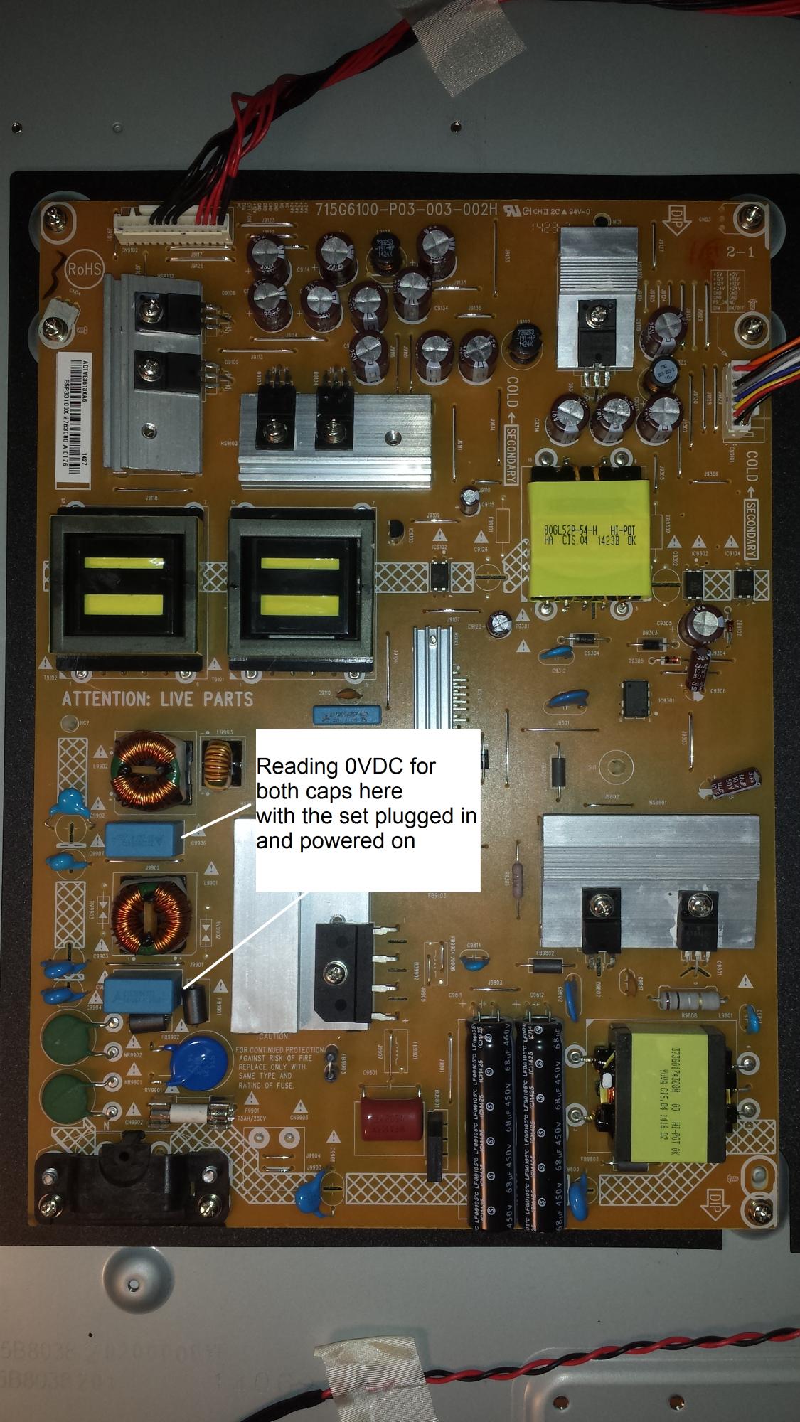

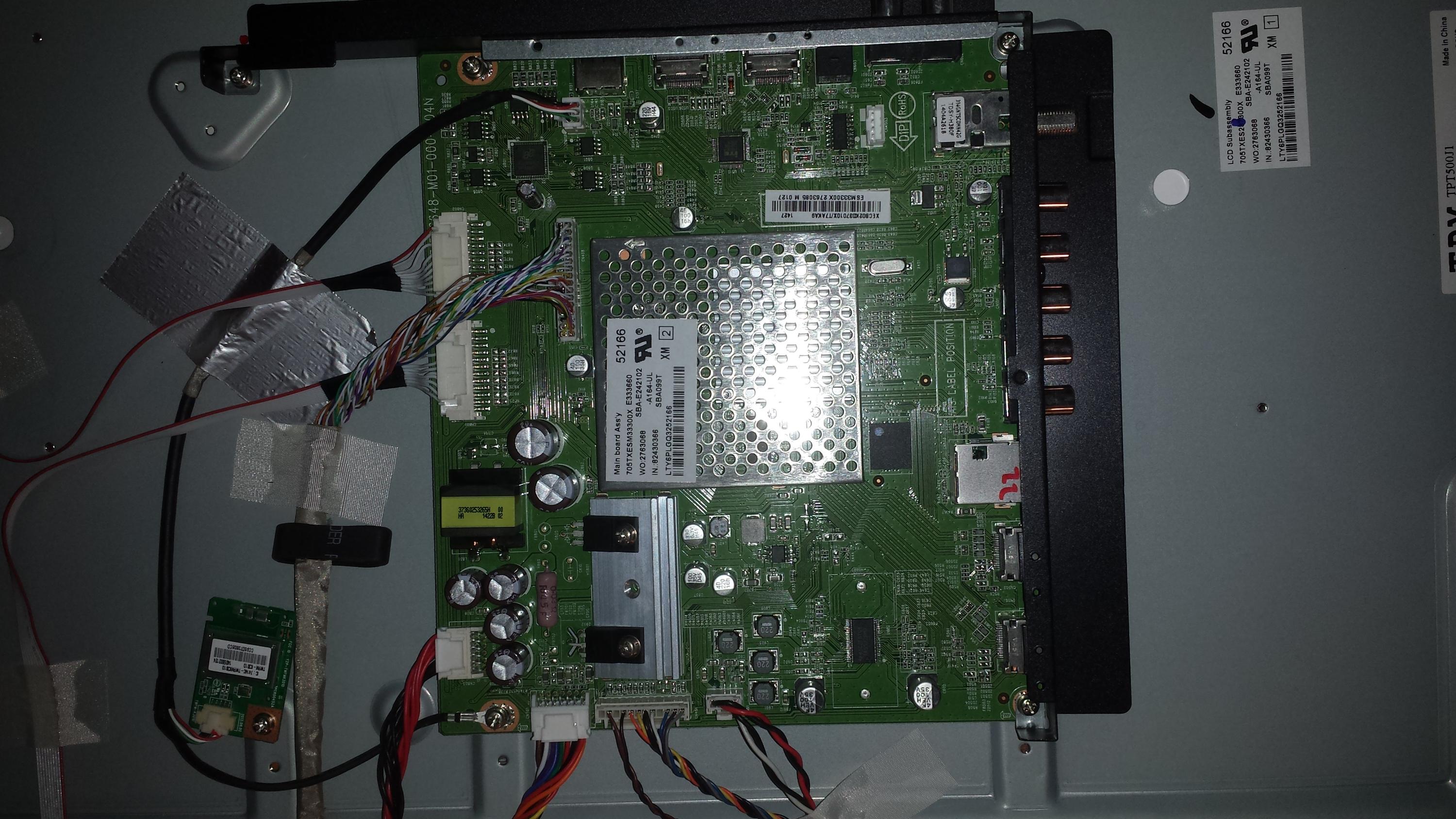

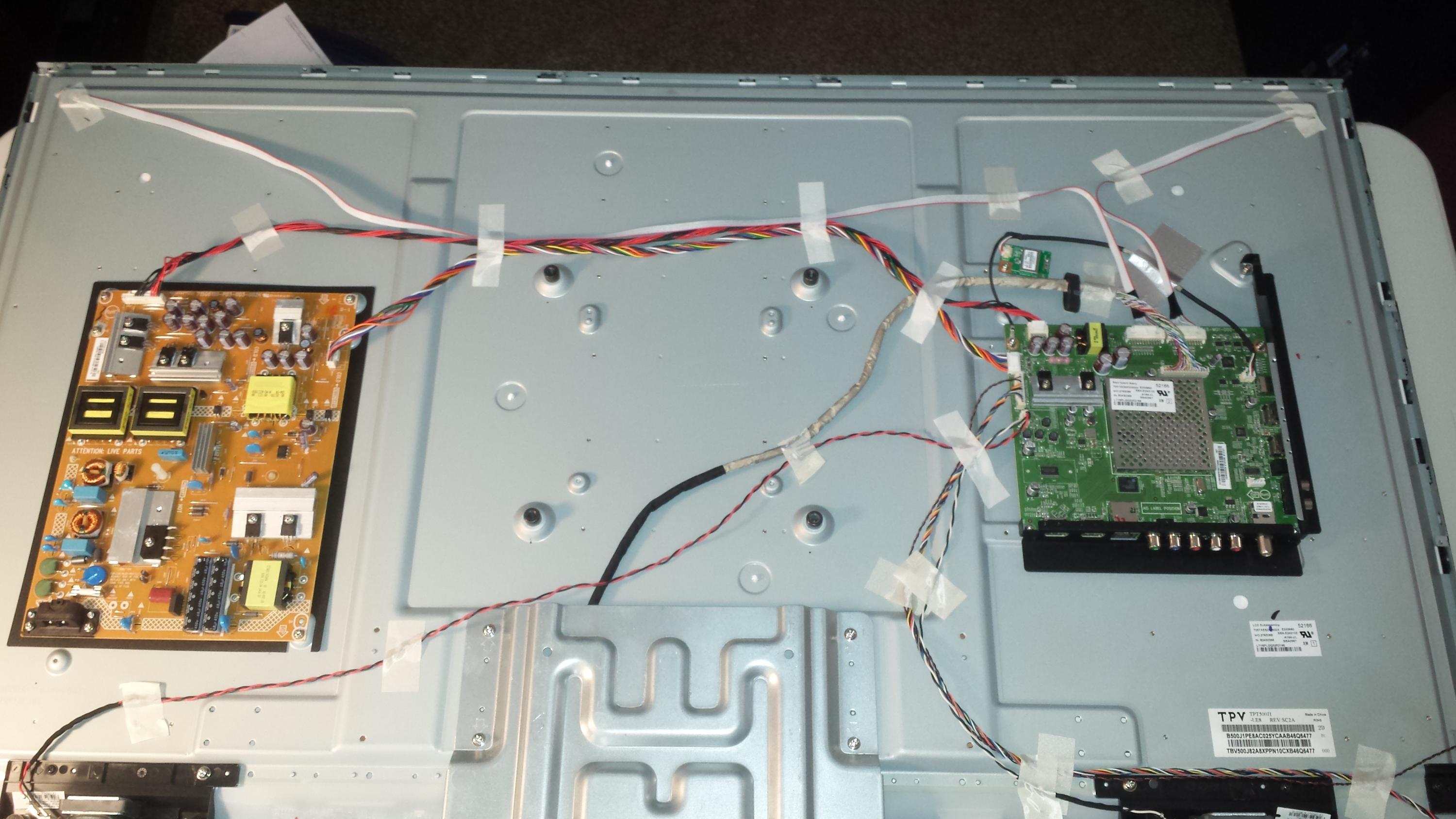

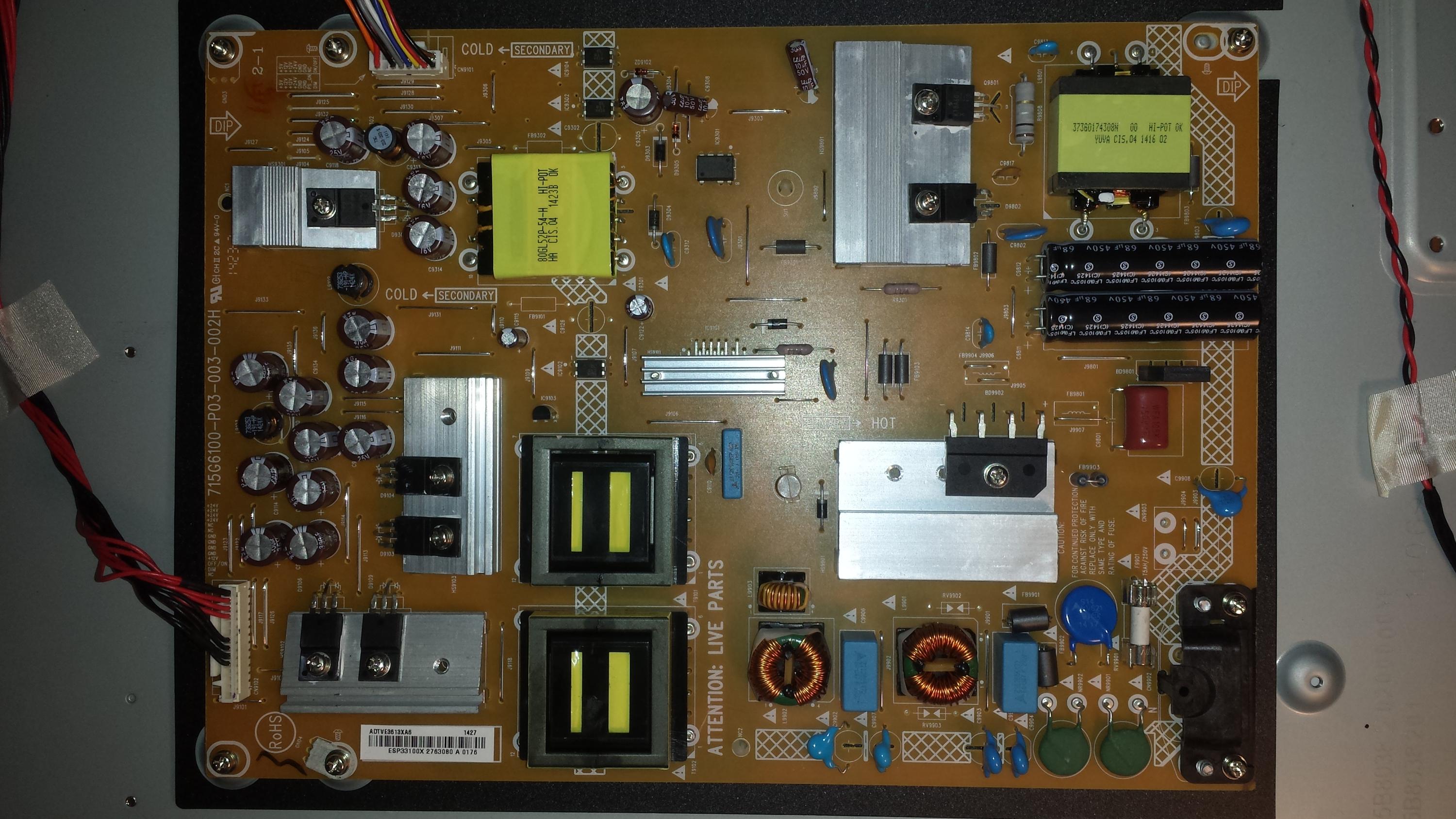

    Hello folks, I have a set here that I need some advice on.
    It was brought to me with this story.
    Big thunderstorm, lightning strike hit house next door, TV wouldn't work after that. The backlight is failed. It does not come on at all.
    I have shined a flashlight on the display and see the No Signal text, so the panel is good and it's powering on.
    I checked voltages on the power supply board going to the main board. All check out fine, aside from every 24V output, it is coming up as 15.5-16V.
    Pictures are attached of the whole back opened up, the main & network boards, and the power board.
    The power board part number is ADTVE3613XA6.

    Check the voltage on the main filter cap (the two 450V caps on the PSU) with the tv on. If you only have 170V DC with the TV on, the PFC isn't working. Be careful, as you are in the primary section of the PSU. No boosted voltage, no 24V.
    • 0S1R1S
      • Mar 2014
      • 48
      Re: Vizio E500i-B1 Backlight
      Would those be the block style capacitors? I see two coil filters with two block caps right near the power input, but they are stamped 275V. I assume that's what I should be checking, just wanted to make sure.
      I powered up the set and tested voltage on those two block style 275V caps and had 0V on my meter. See attachment.
        The main filter caps are the two long caps laying on its side on the bottom right next to the Yellow PFC inductor.

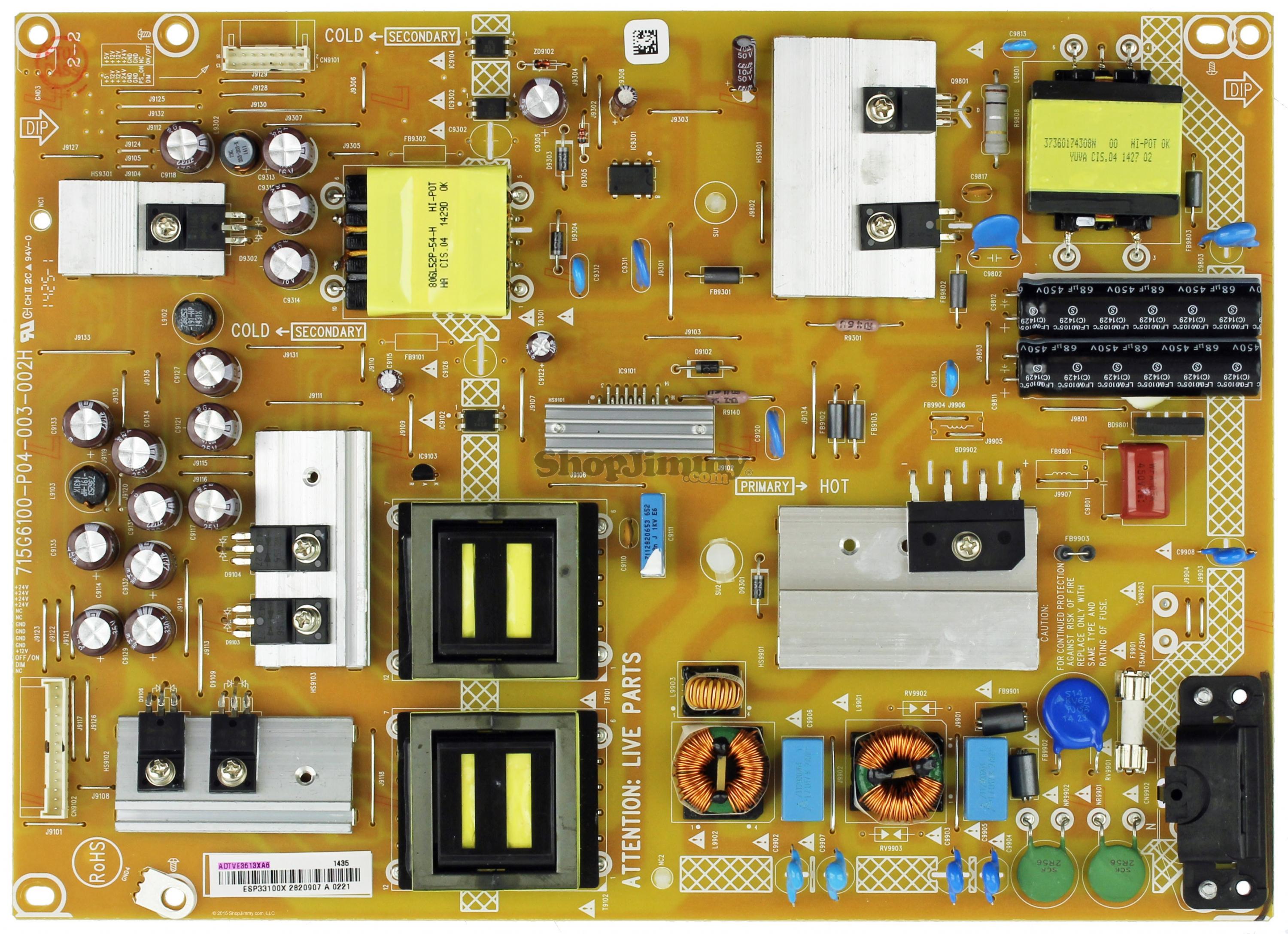

            So the PFC Voltage booster is working, which means the PS-ON command signal from the main board OK.
            Vizio ADTVE3613XA6 Power Supply Unit
            http://www.shopjimmy.com/vizio-adtve...upply-unit.htm
            Pictures provided by shopjimmy.
            It is going to need to do mare in-depth board tracing to find out why the 24V output is not 24V.
