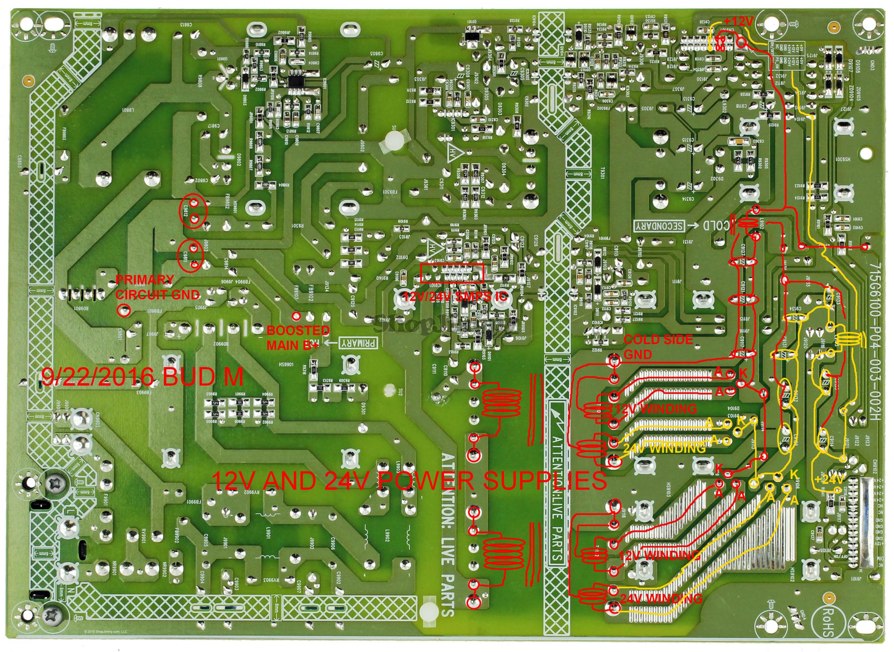

      The 12V and the 24V is doubled up. Each transformer has one 12V and one 24V rail. Then they parallel the 2x 12V and the 2x 24V together. How about you are taking one diode on the 24V rail out let her run. See what gives. Then do the same thing with the other diode on that rail.
      Something else: Unhook everything from the PSU and force the PSU on without the main board.
      Take two 1k resistors and jump STBY 5V to PSon and the other resistor from STBY 5V to on/off. Plug the PSU in and it should be fully turned on.
      If the 24V rail is up as it supposed to be, unplug the PSU, plug in the inverter board, then plug the PSU back in and see if the backlights are on.

          I did notice that the 24V also goes to the main board. Maybe it is loading it down?
            Re: Vizio E500i-B1 Backlight
            That 24V goes to the LED Backlights booster circuit on the main board. I did tell him to disconnect that connector to see if the Voltage will go up to 24VDC again, but it did per his report.
            It has two transformers that have the output after the rectifier connected in parallel, so it can not be that the 24V winding of both transformer are bad when the 12V is OK.

                        Here is the marking to show how 12V and the 24V are generated.
                        As you can see, it is very simple, so it has to be something is being overlooked or measurement error.

                          If there would be something bad on the feedback circuit, I'd expect the 12V to be low too.
                          what if c9116 is shorted from 24v to GND, it should get a bit toasty.

                              Lift out the jumper J9113 (lift on end) and measure the Cathode voltage of D9103 and of D9016 for 24V at each point

                                  Here's an update. The owner of the TV was impatient and told me to just order a power board. It arrived today (quick shipping) after ordering Friday. Plugged it in, plugged in AC power, and boom, it was working.
                                  HOWEVER. The LEDs were flickering. Then steady. Then a little flicker. Then, now, they're gone. Completely. And we're back to 15.5V on the 24V rail on this new power board.
                                  My only guess is something on the main board is back feeding to the power board and killing it.
                                    I tried this and the voltages were still 15.5V on the center legs. On the outer legs, it showed 0V.

                                      Also, I tested voltages as I was powering up, and the 24V rail would hit 16.8V, then drop.

                                        Should have made measurements and compared the old board to the new board to see what's going on... too late for that now...
                                        I am thinking too that there is something not right with the LED driver to start with, or even a bad LED. That doesn't fix the 24V rail on the PSU yet.

                                          I'm giving up and I'm just going to wire in an internal/external 24V power supply to the LEDs and see how that works.
