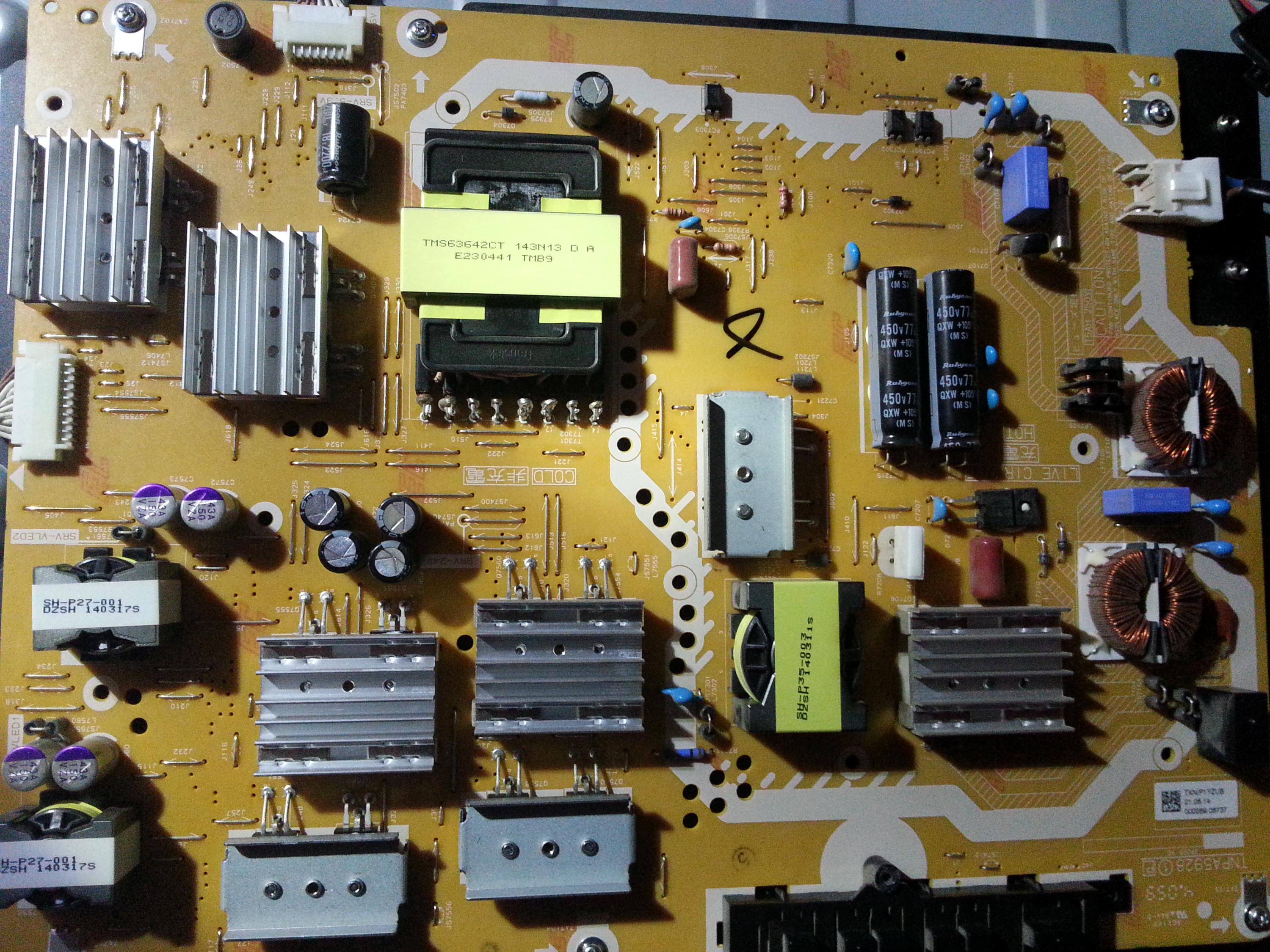

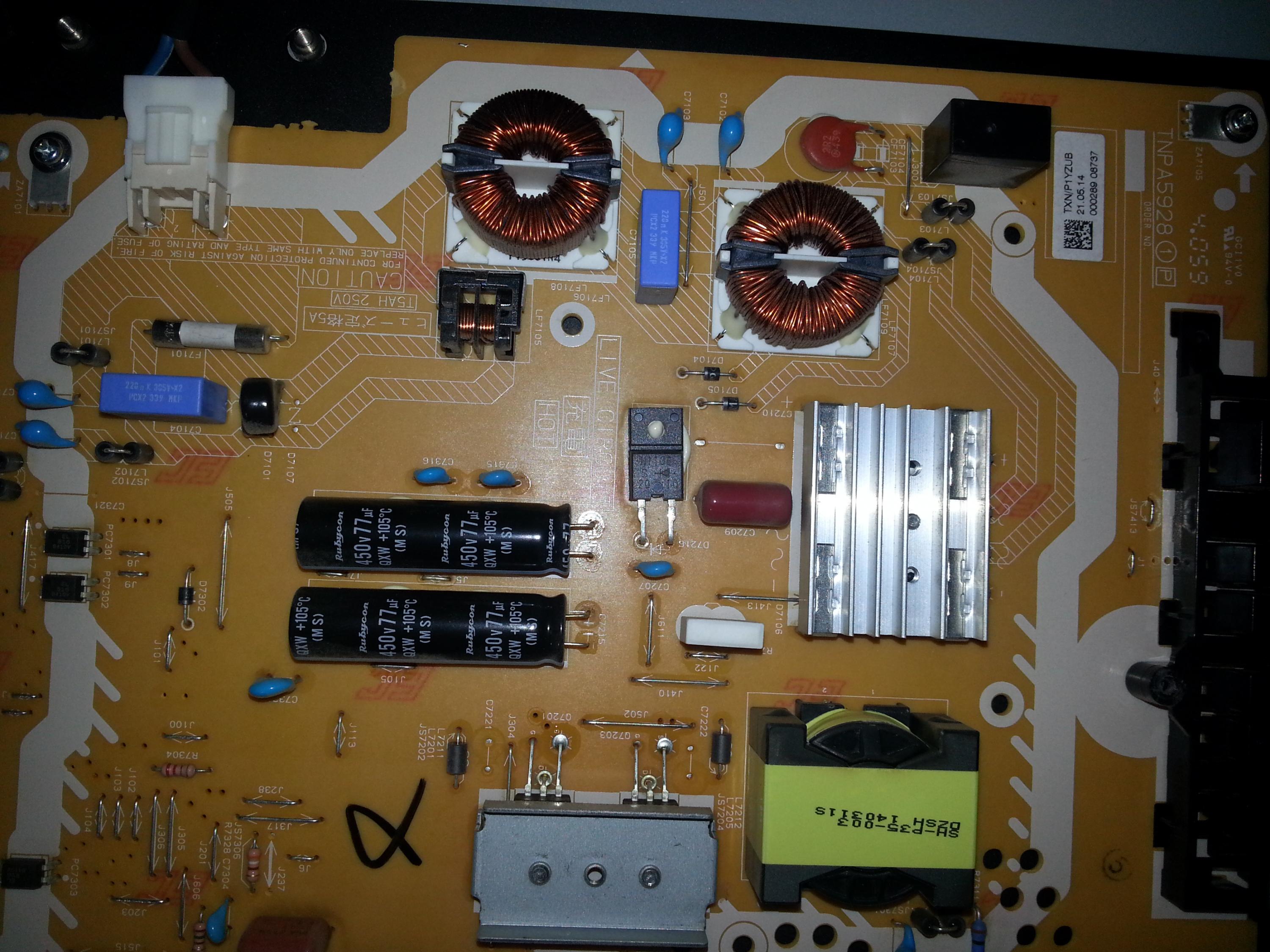

                                • Dave b
                                  • Sep 2016
                                  • 15
                                  • uk
                                  Re: panasonic viera lcd tx55as802b
                                  HI here is the pictures of the power board from the television does anyone know what parts to check and can you please explain how to do this.
                                    have you tried whats mentioned in post 15 first?
                                    • Dave b
                                      • Sep 2016
                                      • 15
                                      • uk
                                      yeah vinceroger69 the tv will not switch on just shuts down been trying the sequence in post 15 and nothing.
