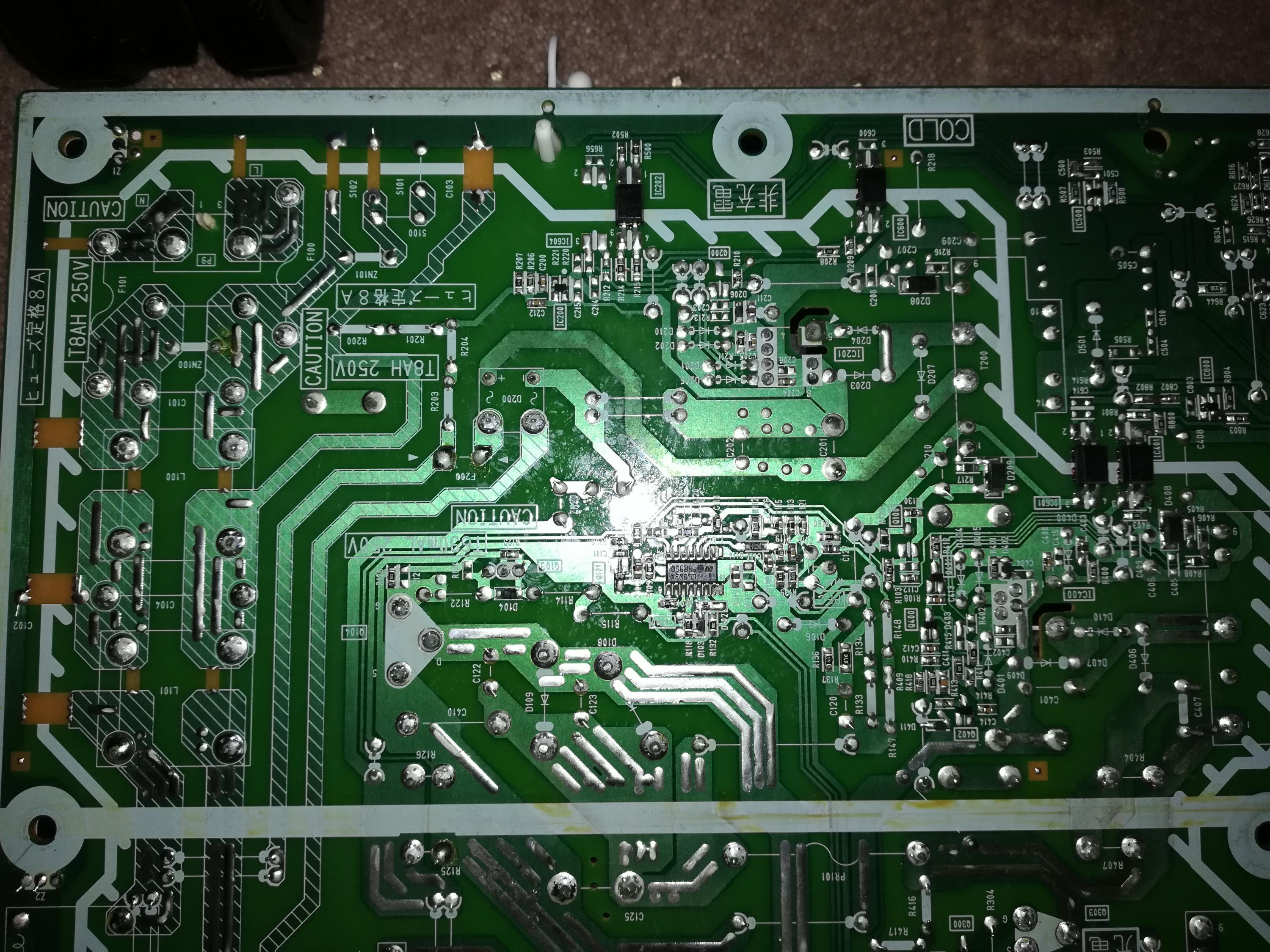

    T200 looks as though it has soot around it. What is the underside of it like. (underside of the board).
    There's not alot you can do without a meter available.
    Use your new meter when it arrives set to diode mode to check D207

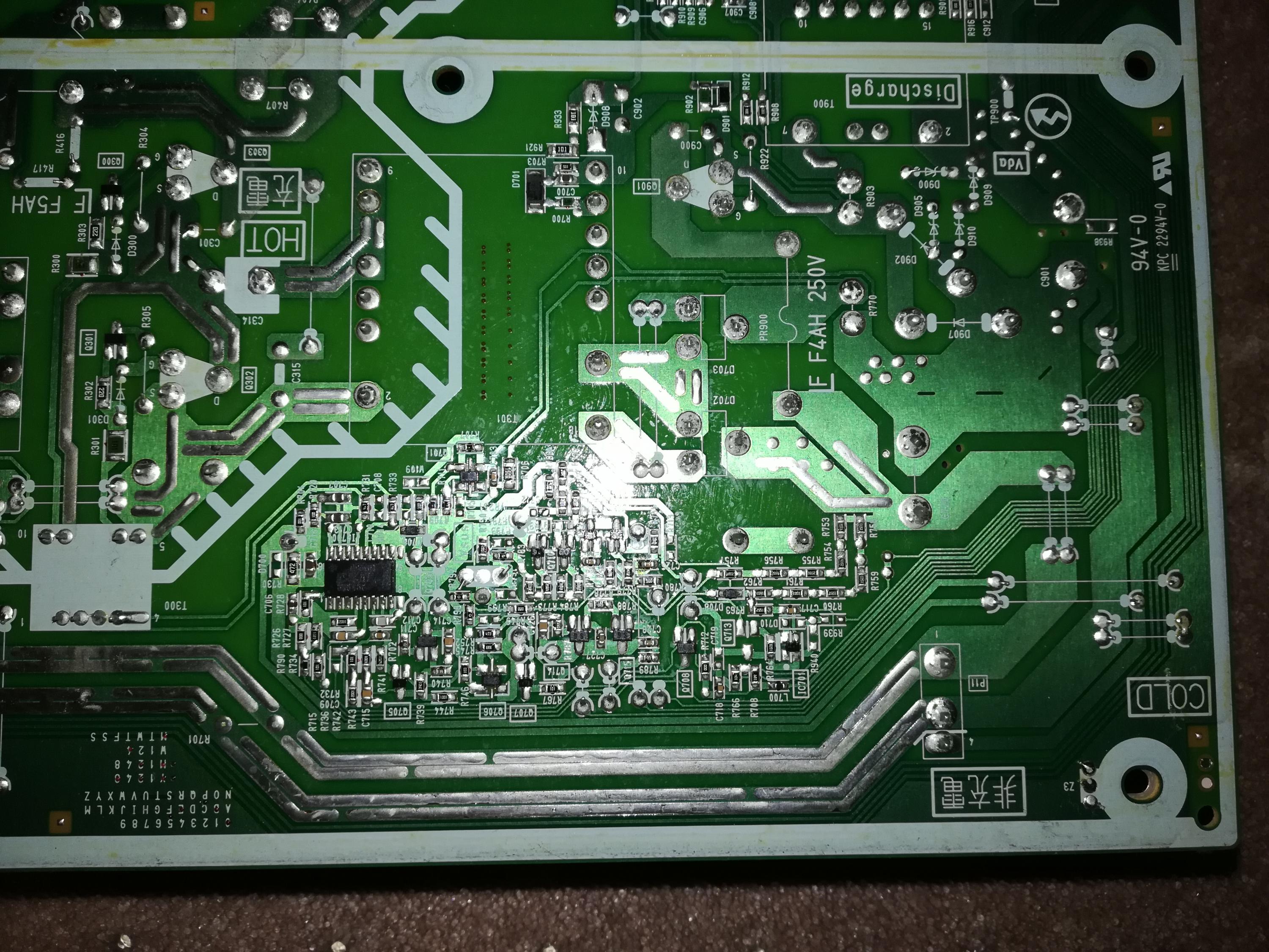

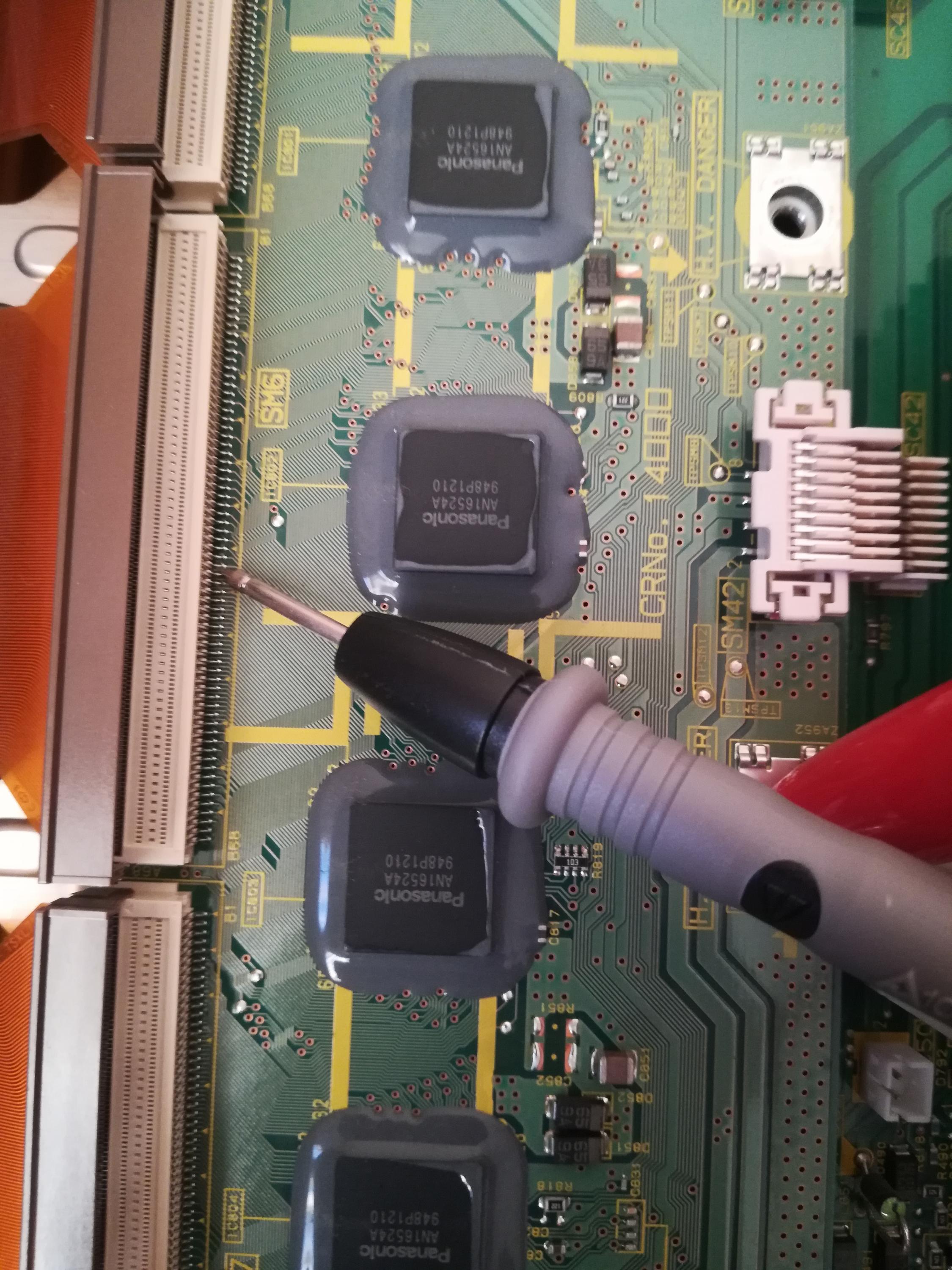

      • Paft
        • Mar 2020
        • 21

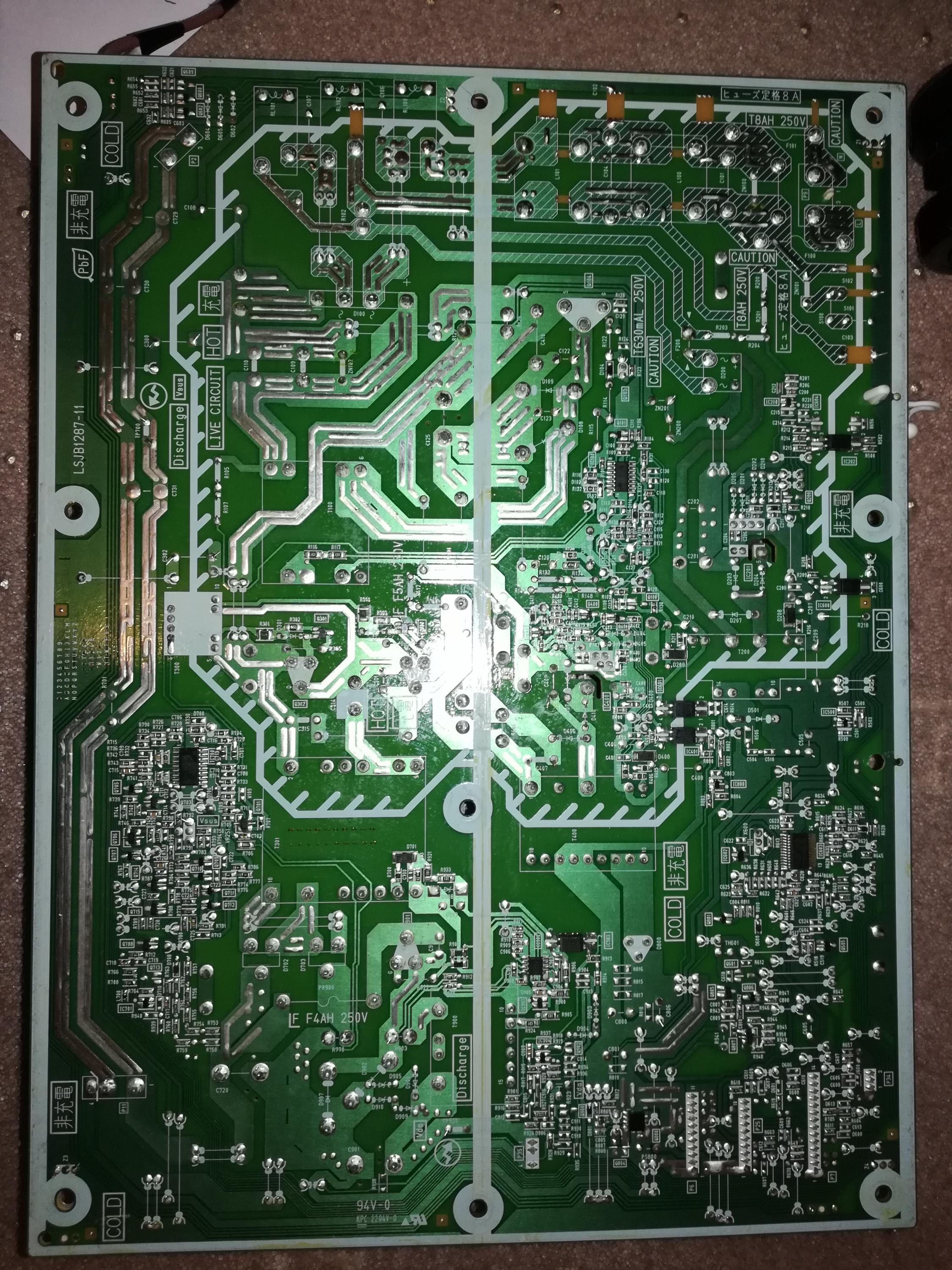

        Re: Panasonic Viera TX-P42S21B - 7 Red Flashes
        Thanks for the replies.
        -How do I correctly test the SC board?

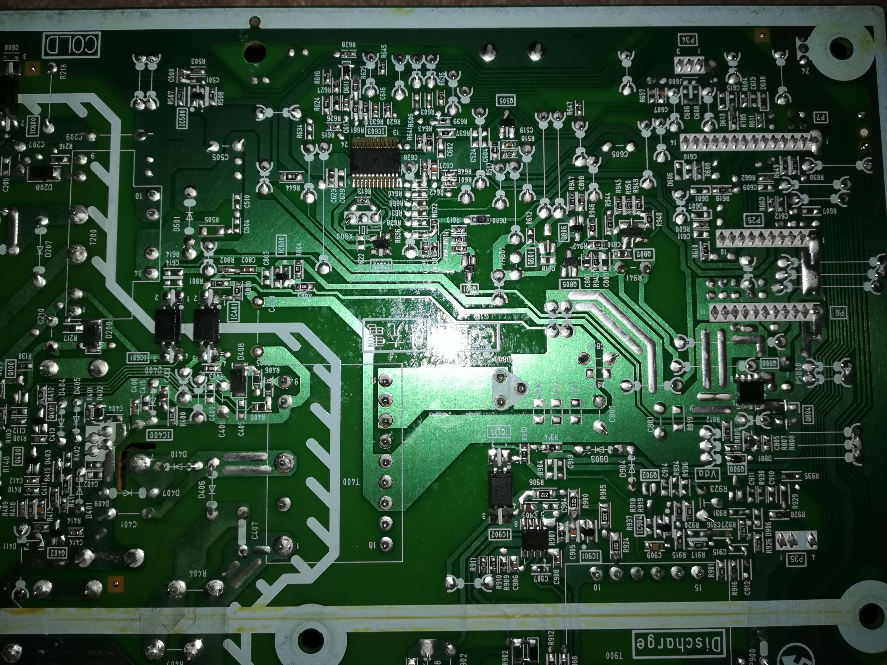

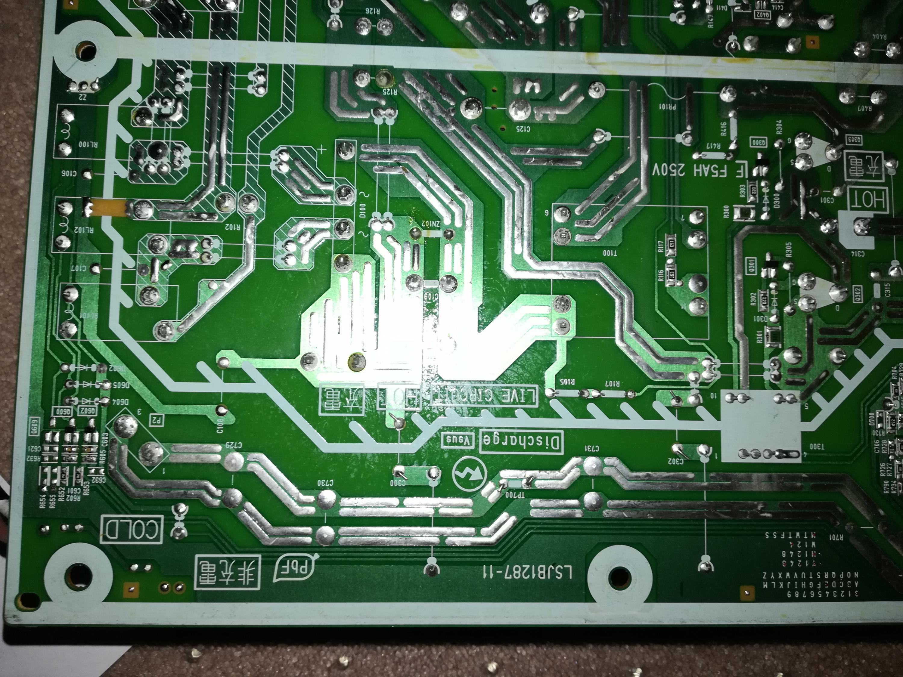

        -I get a continuous beep on the SM board on several of the SM6 ribbon pins. They look like they go to the fourth IC(?) chip from the left.
        -I get a continuous beep on D207 on the power supply where the black marks are. I don't see anything obvious underneath. (But it's rather grey in England and getting dark. I had to use flash. I'll take some again tomorrow)
        Attached are images of the bottom of the PSU and the SM or: https://imgur.com/a/vI5Geh9
        • dick_barton
          • Aug 2015
          • 6643
          • Wales
          D207 looks as tough it could be across a transformer winding so would need to be checked by lifting one end of the diode from the board.
          • tvtimmy
            • Mar 2015
            • 1160
            • usa

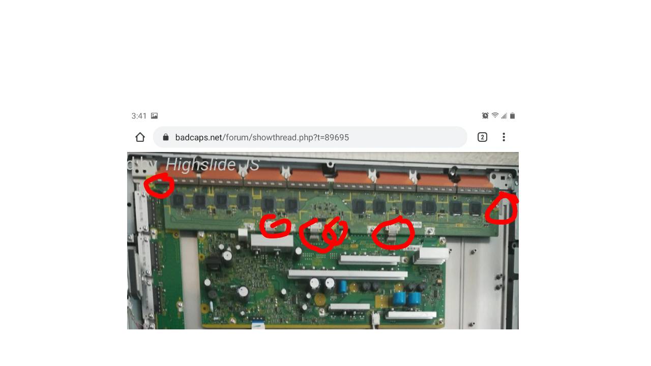

            Your SM board is bad. Take out the 3 screws that hold it in and unlatch the 3 connectors going to the SC board Flip it over, with the ribbon connectors still attached to the panel, over to the outside of the tv. On the SC board you have to short the 2 pins of SC50. I use a thick paperclip. Turn on the tv and check if the green led on the SC is lit. Don't run the tv for more than 20 seconds! Green led means the SC is good. Do this test before messing with the power supply diode.

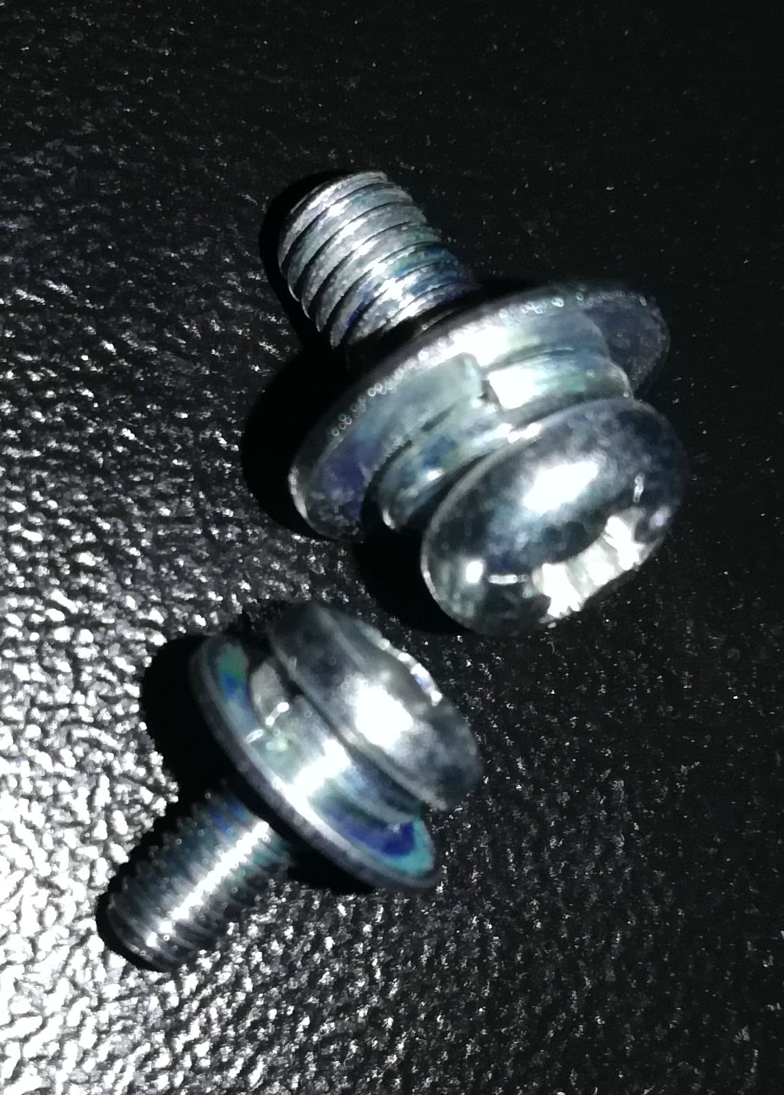

                    Shopjimmy.com sells them. The old ones don't have lock washers and they loosen up over time.
                    That's what caused your tv to go out.

                      Board failure from the screws? That's ridiculous. Edit: Just an FYI all the screws I've removed have been have had lock washers as fair as I can tell.

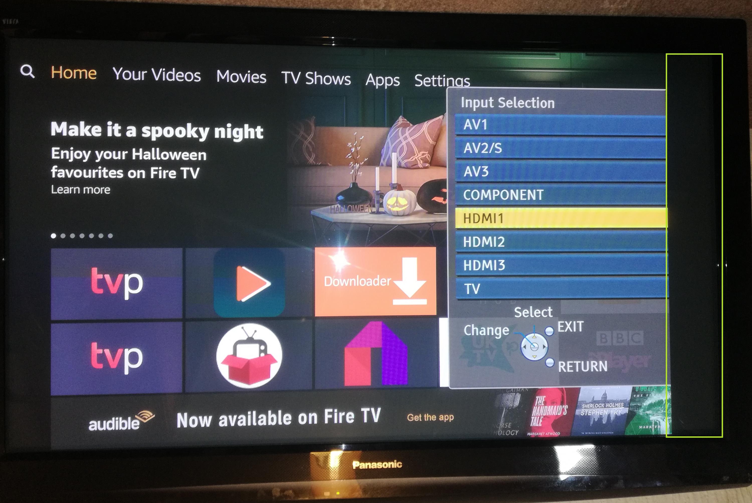

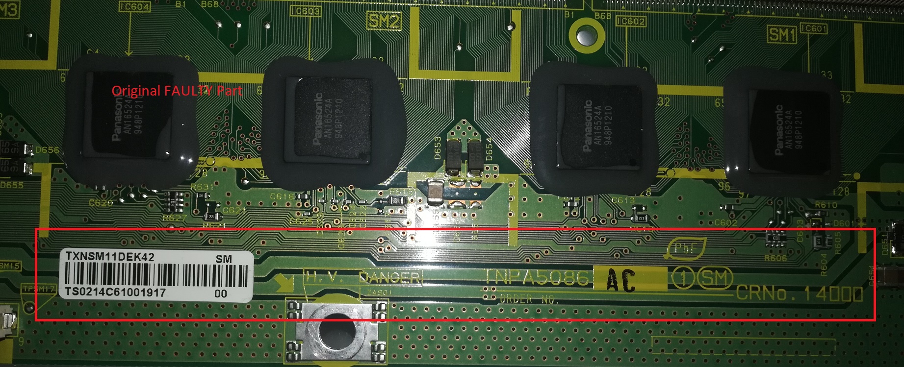

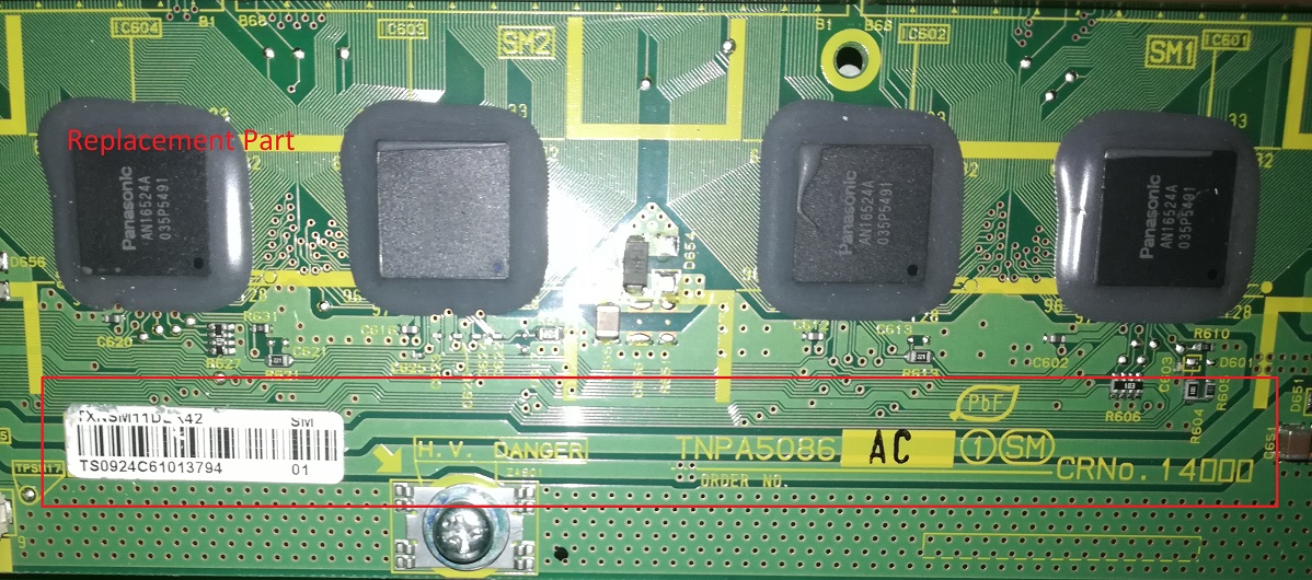

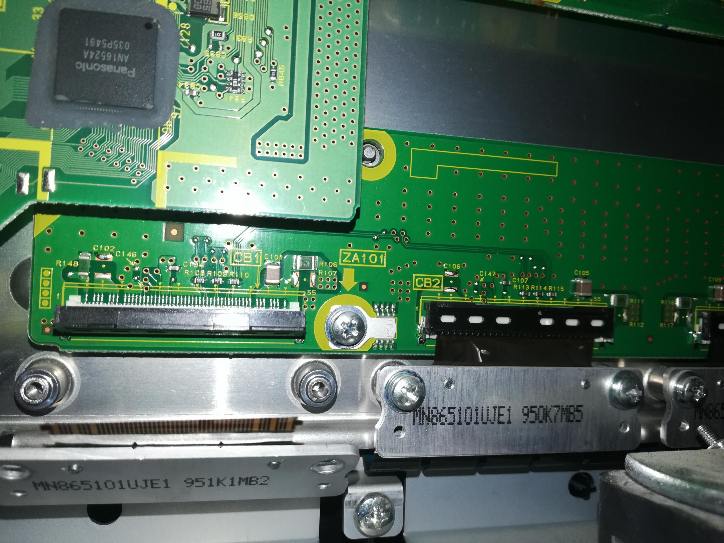

                          Well, it was definitely the SM board.
                          Sadly part of the right side of the screen is blank/missing.
                          I will point out that the part I got was "identical" part number wise but it was from a TX-P42S20BA instead of TX-P42S21B. I chanced it thinking a part is a part. Is that the problem? If that's the case I guess I am one of those annoying customers on eBay. I'll keep it and sell it dearer.
                          Edit: I've ordered Panasonic 42" TX-P42S21B TNPA5086 AC 1 SM Buffer Board Free Tracked P&P

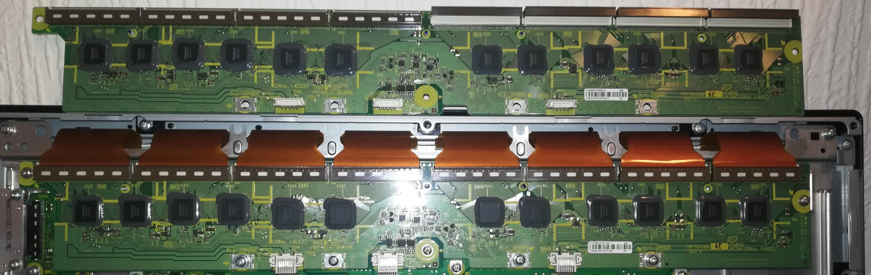

                          • Paft
                            • Mar 2020
                            • 21

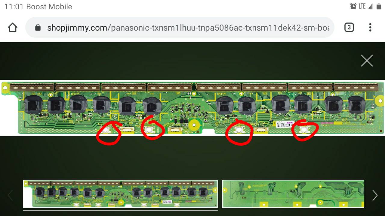

                            Appologies if double posting isn't allowed but editing has a time limit.
                            Attached are images.
                            I noticed they do differ slightly-- extra or missing components. I assume I've answered my own question?
                            Am I alone in thinking it's an odd way to work? Same part numbers but they're not...

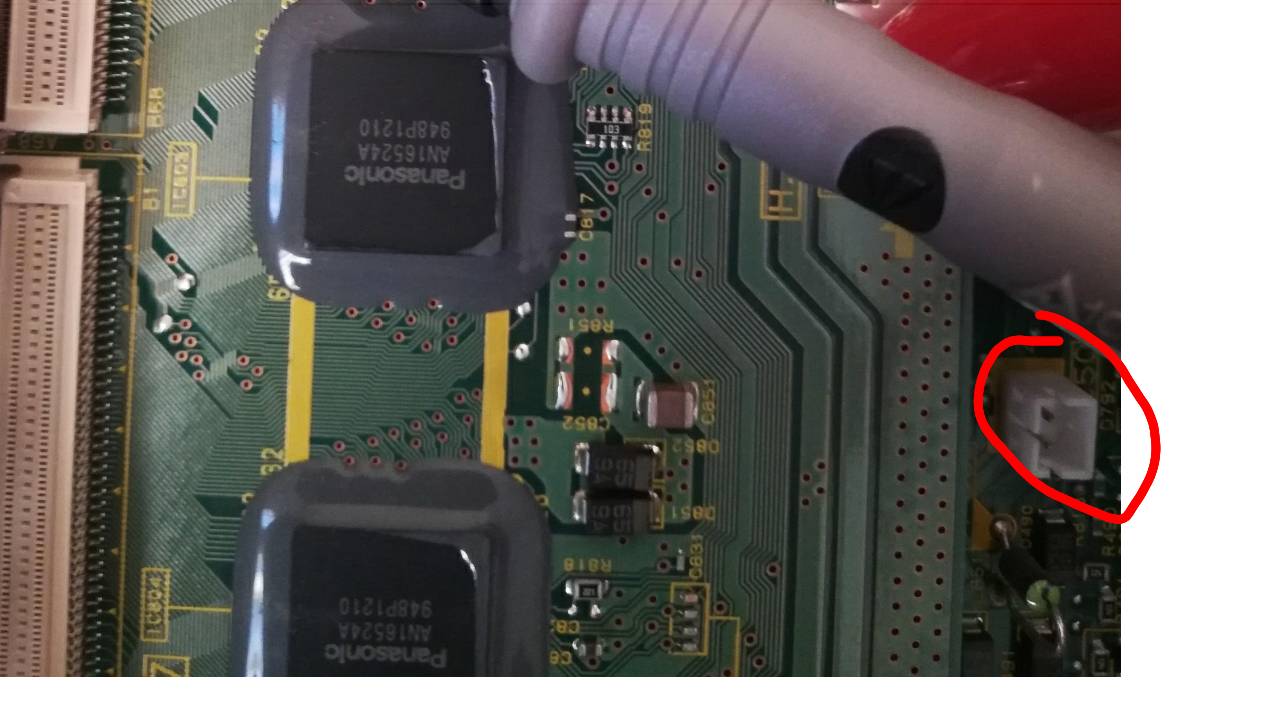

                            • tvtimmy
                              • Mar 2015
                              • 1160
                              • usa

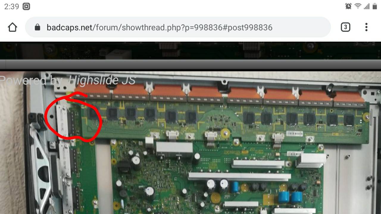

                              That board controls horizontal lines across the screen. Check the ribbon latch on the bottom buffer board directly under the SM board. Those bottom buffers control vertical lines of the screen.
                              • tvtimmy
                                • Mar 2015
                                • 1160
                                • usa

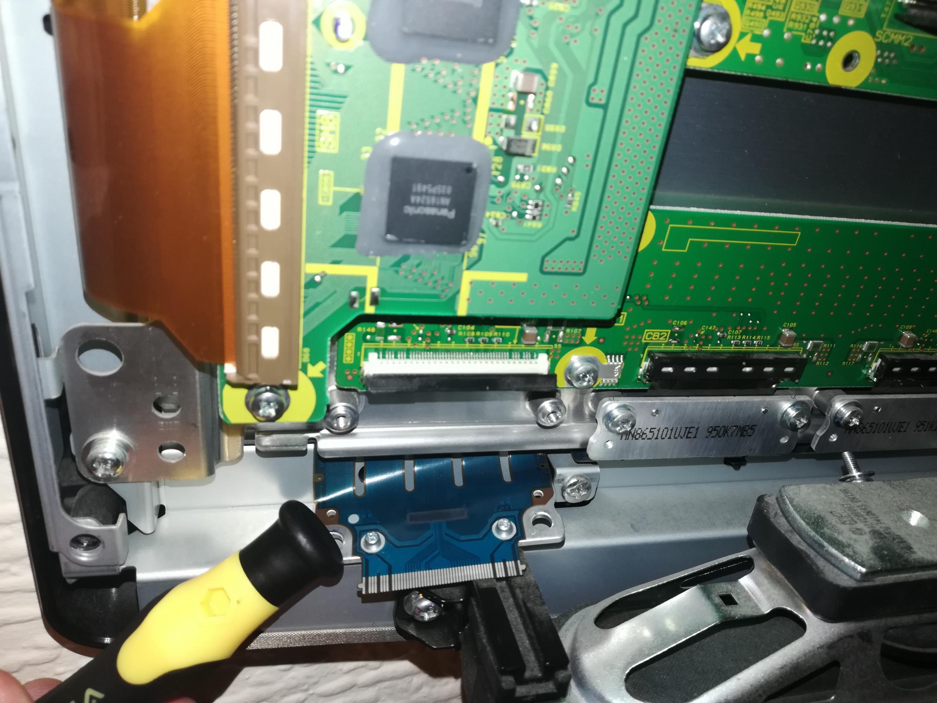

                                Check this ribbon latch.
                                • Paft
                                  • Mar 2020
                                  • 21
                                  Thanks. I already cancelled that order, after finding a £6.38 SM board. That hasn't been dispatched yet. Should I cancel it?
                                  Is there a specific method to test the bottom buffer boards? I assume that's a faulty bottom buffer too?
                                  I reseated the ribbon you mentioned twice. Although that's the first time I've touched it. No change.

                                      • Paft
                                        • Mar 2020
                                        • 21
                                        Well, I call tell without anything actually connected because the AV source option box is cut off for example. As are any other screen or menu that takes up that area. I'll test all inputs for the hell of it though.
                                        Thanks for your help so far.
                                        edit: Didn't see you post Biruslapio--looking now. I will point out that nothing has been touched before besides the power supply and buffer board(s.)
