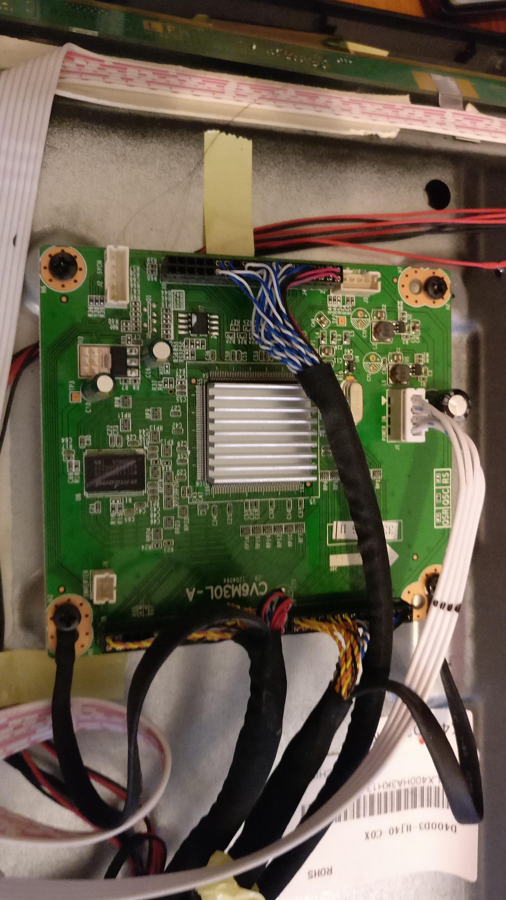

    Hi! I'm hoping someone can help me diagnose this.
    I have an Element "eleft406". The red power light comes on when it's plugged in, and switches to blue, but there's no logo/video.
    What's the most likely culprit? I've opened up the back panel, but I don't see any obviously blown caps.

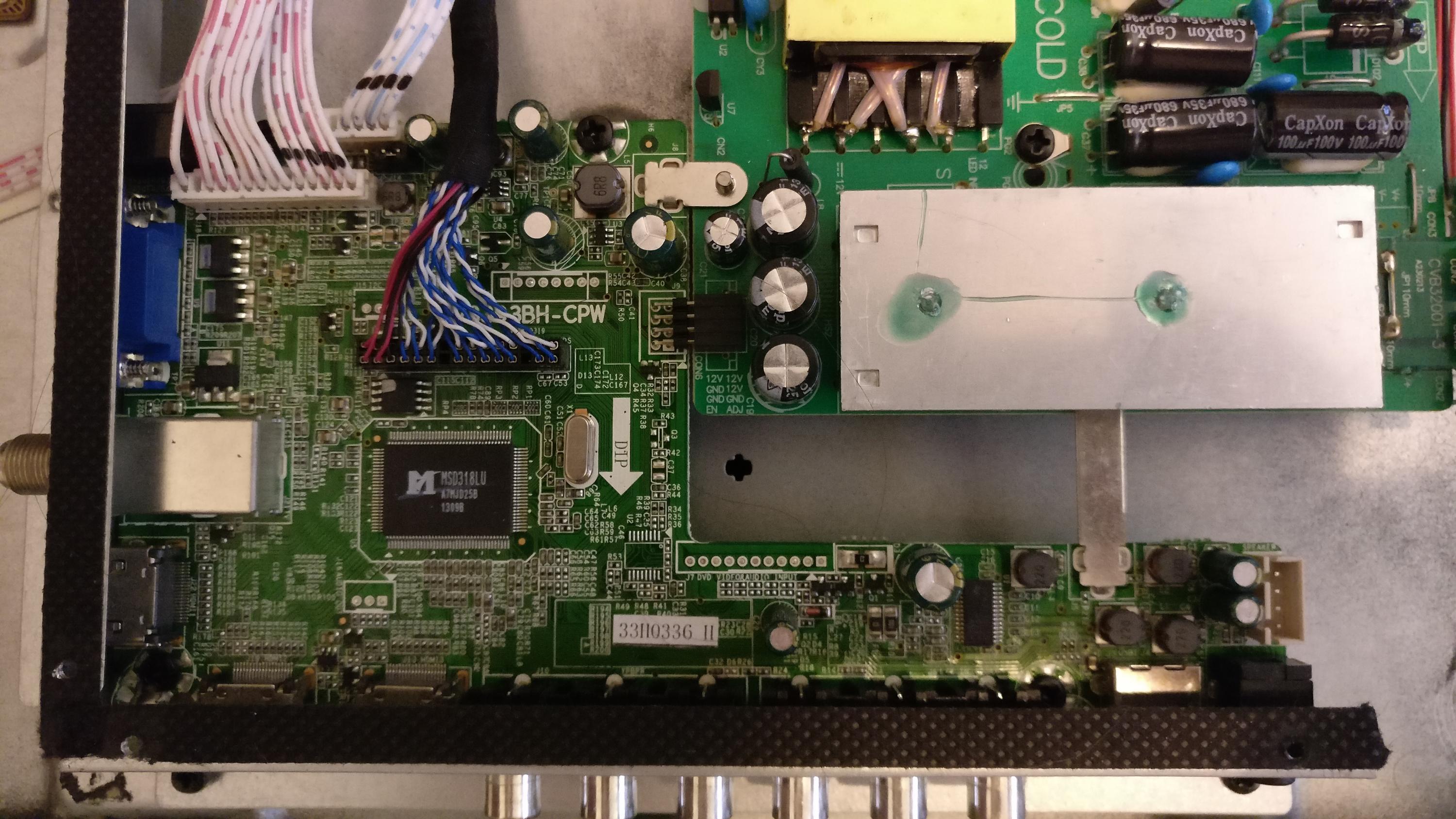

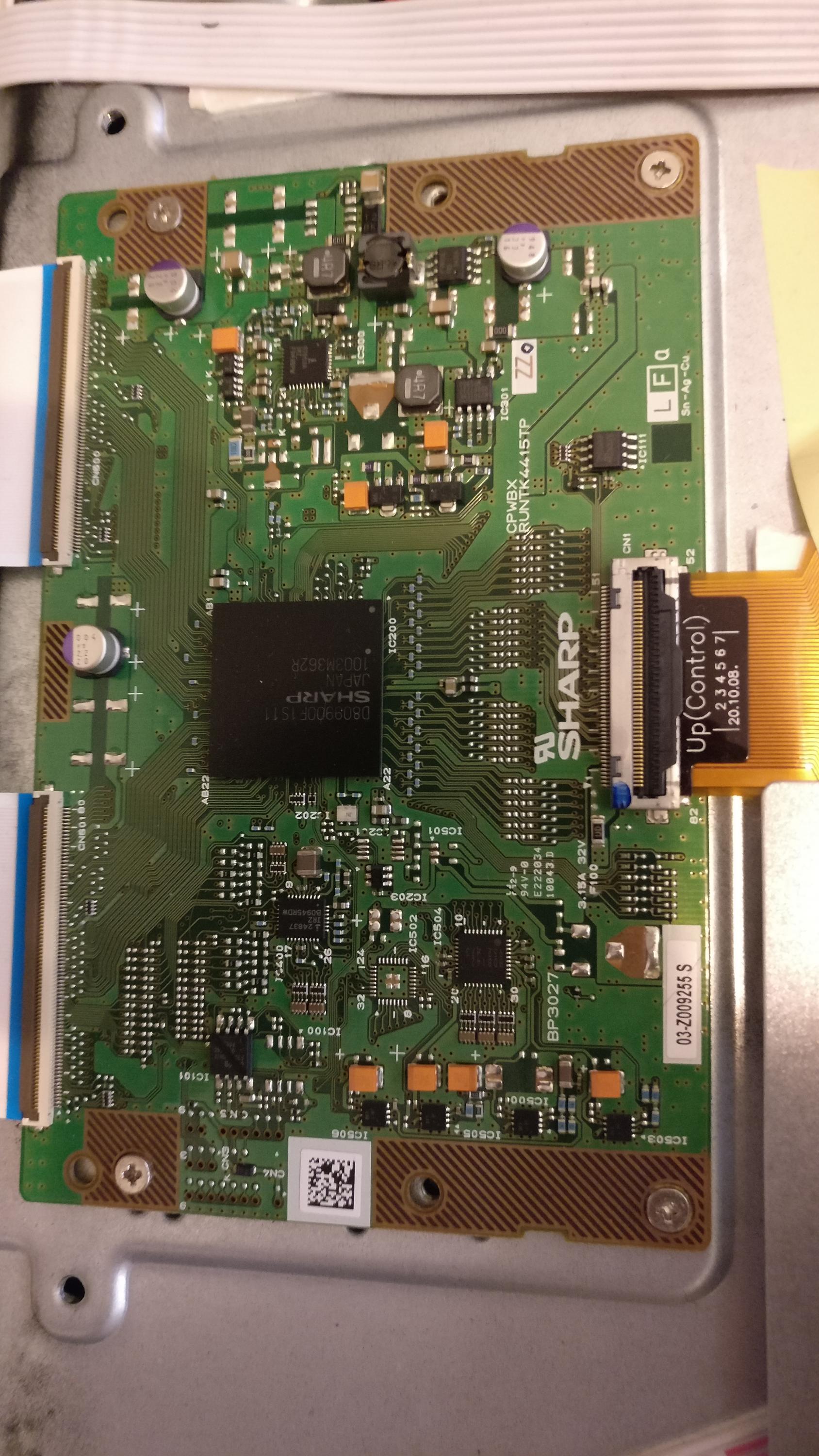

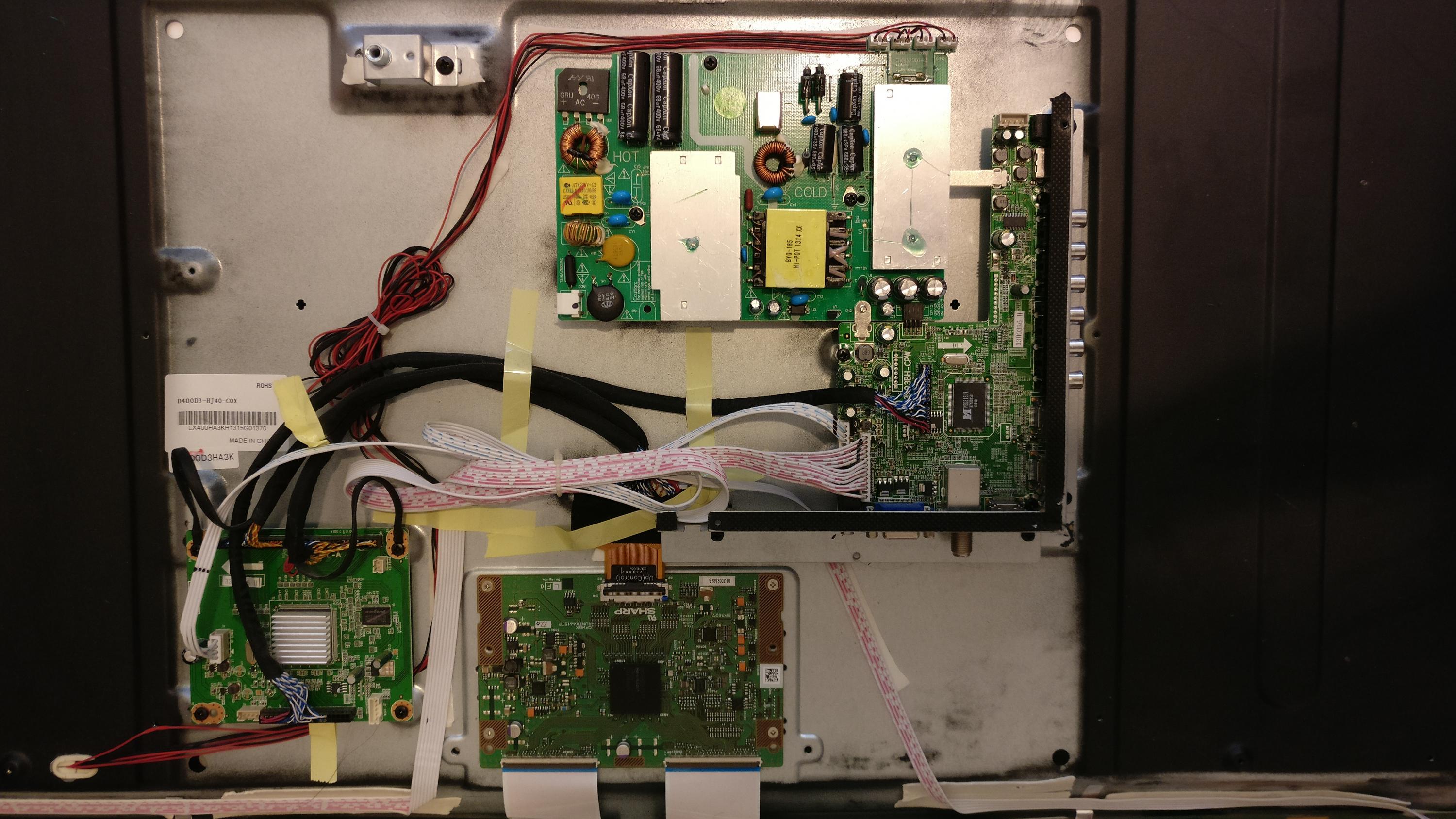

    For starter, we need GOOD CLEAR pictures of the whole backside of the TV so we can see all the boards first.

      Re: Element LCD, power light on but no picture
      Here's a gallery of all the boards and an overview shot of the panel.
      Thank you!

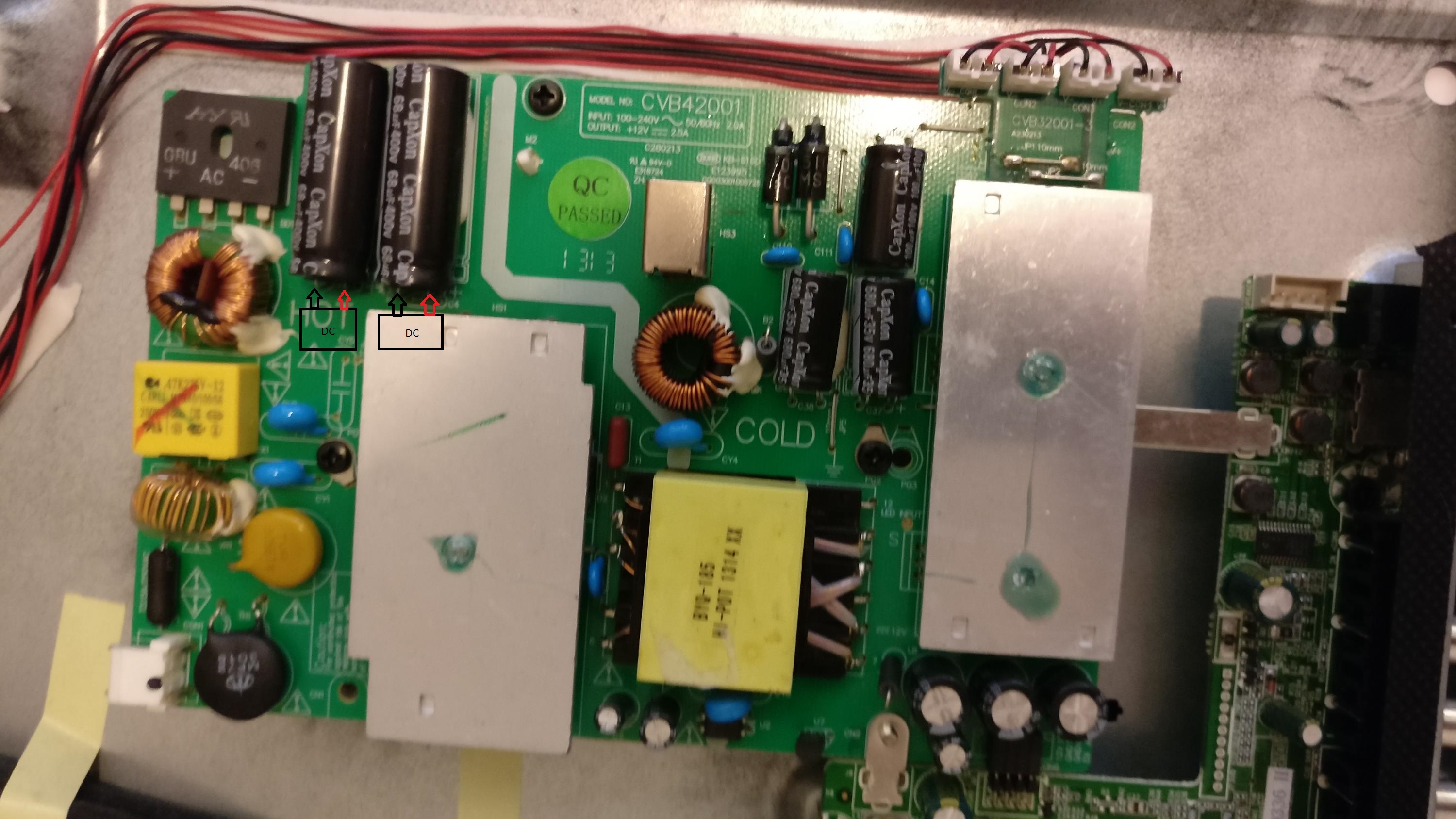

          Can you explain better what the tv is and is not doing? Do the backlights come on? TUrn the TV on and check the voltage on the 400v capacitors on the PSU.
              The backlights don't come on. There is 2.7v across each of the 400v capacitors.

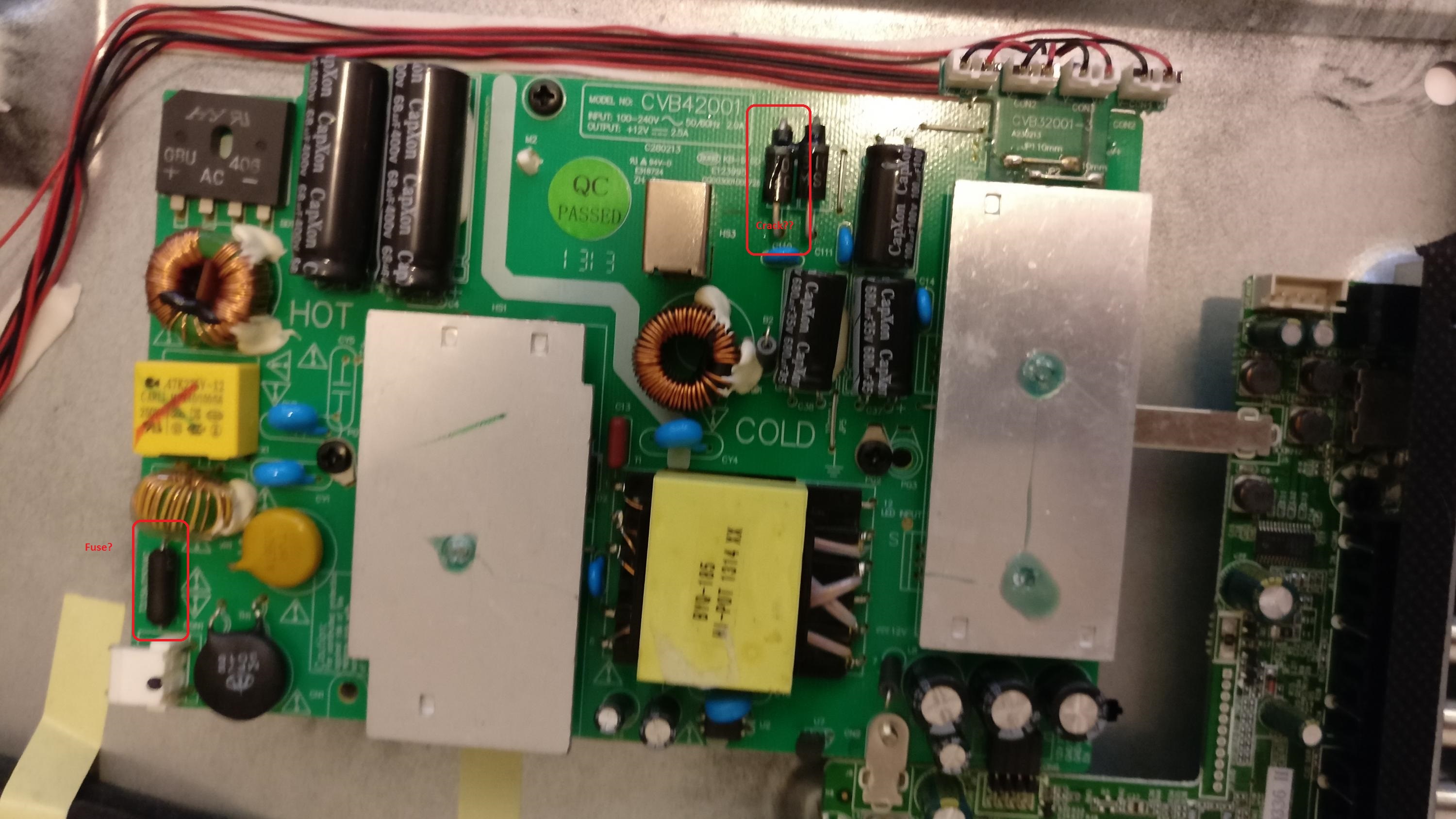

                Is that diode cracked or is it the light on it and is that a fuse in the second red box by the mains input terminals and if it is have you checked it for continuity?
                  The diode isn't really cracked, it's just a reflection.
                  How do I test for fuse continuity? Sorry, bit of a newbie here.
                      With the set unplugged set your meter to ohms and place the leads either side of the fuse making good contact and it should read close to 0 ohms. OL is a blown fuse. You need to check first that it is a fuse because I can't really tell from your photo.

                        That isn't right. Did you put both probes to the 400V cap and set the meter to read DC volts?
                          I tested it again, making sure to put the black probe on the side with the white stripe. I got a 3.0V reading on those caps with the power on.
                            It has to be measurement error, no way you can have 3.0VDC on the main filter caps and still get the LED power light to be on.
                            Please show us how you test the DCV on those 68uF 400vdc CAP (2 of them).
                              With the set switched on can you carefully measure the voltage on each of the capacitors with the red lead on the + side of the capacitor and black on the other side and what do you read on each of them?
                                Another problem, if I remember correctly, other people in other thread that have similar boards as yours they found bad solder joints on the black connector between the power supply board and the main board.
