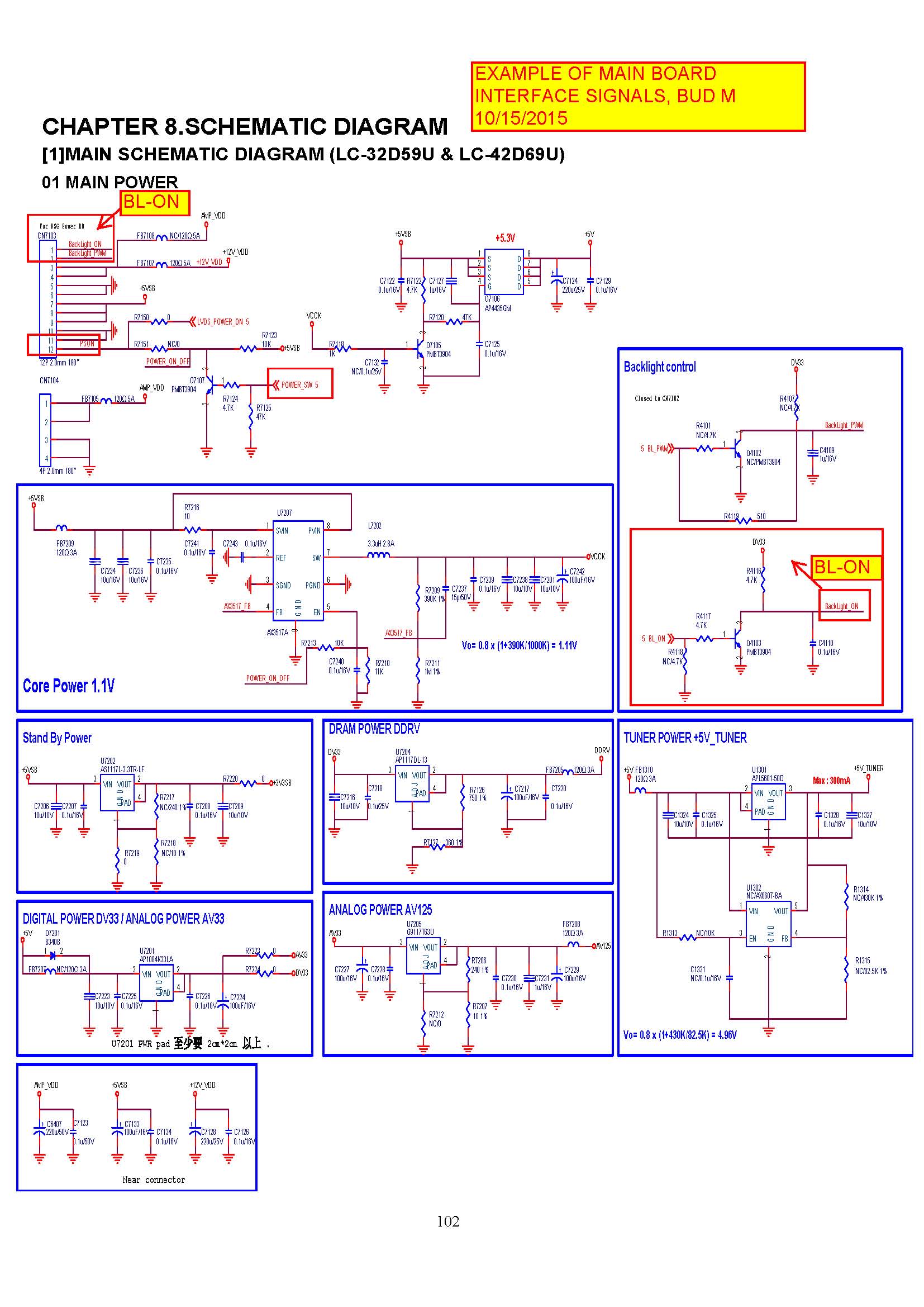

                      You will have to get the schematic of the main board or you can try tracing the PS-ON pin to see where it goes to on the board.
                        #31
                        Re: Anyone familiar with the Akai LCD3701AD?
                        BTW, if you can force on the power supply with the PS-ON wire is disconnected but the connector is back in place so the main board will get the power to run the main board, if everything else is OK then you should have all other the functions of the TV and have sound and pictures on the screen, if not then you have more than just bad PS-ON signal.

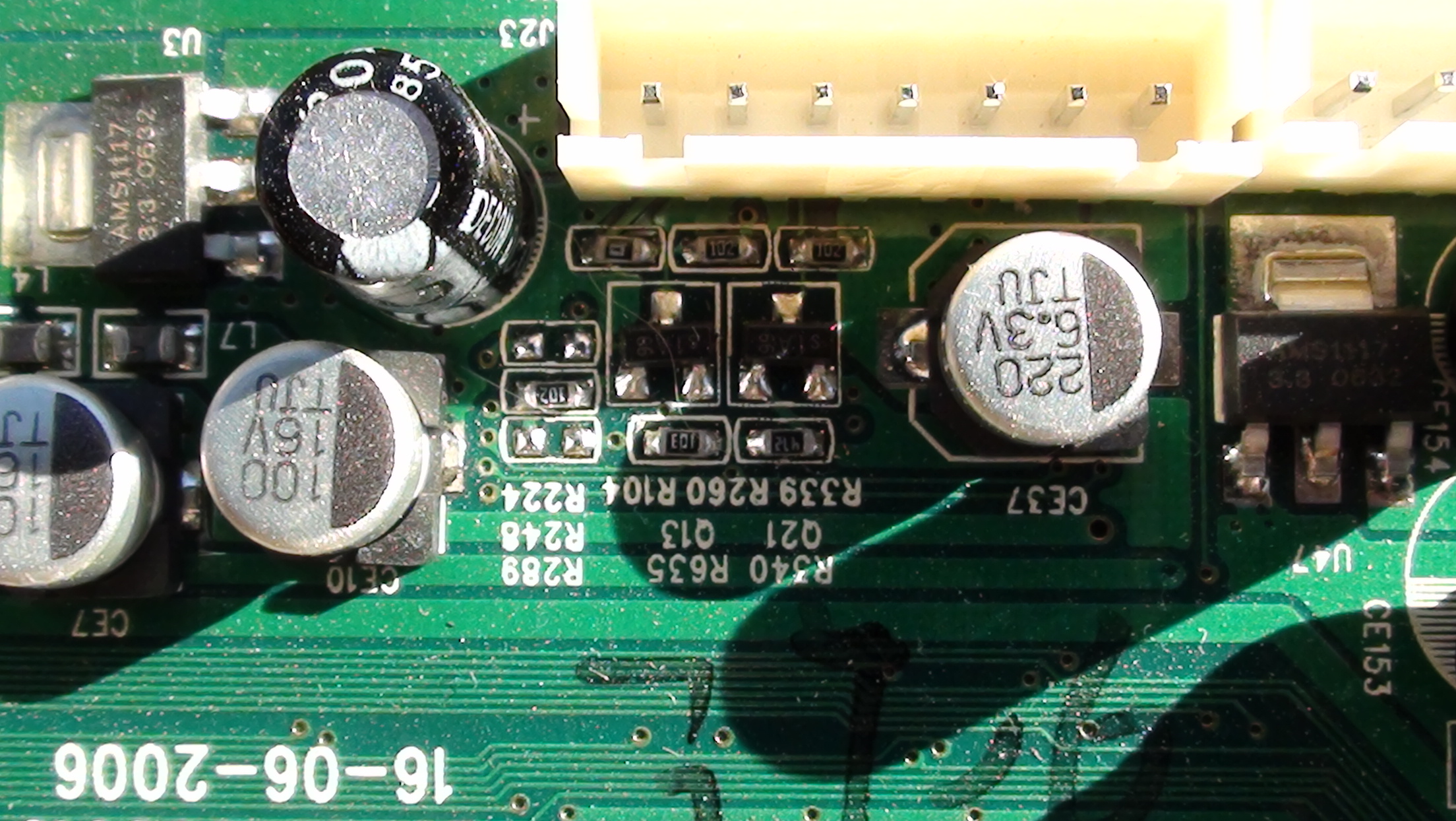

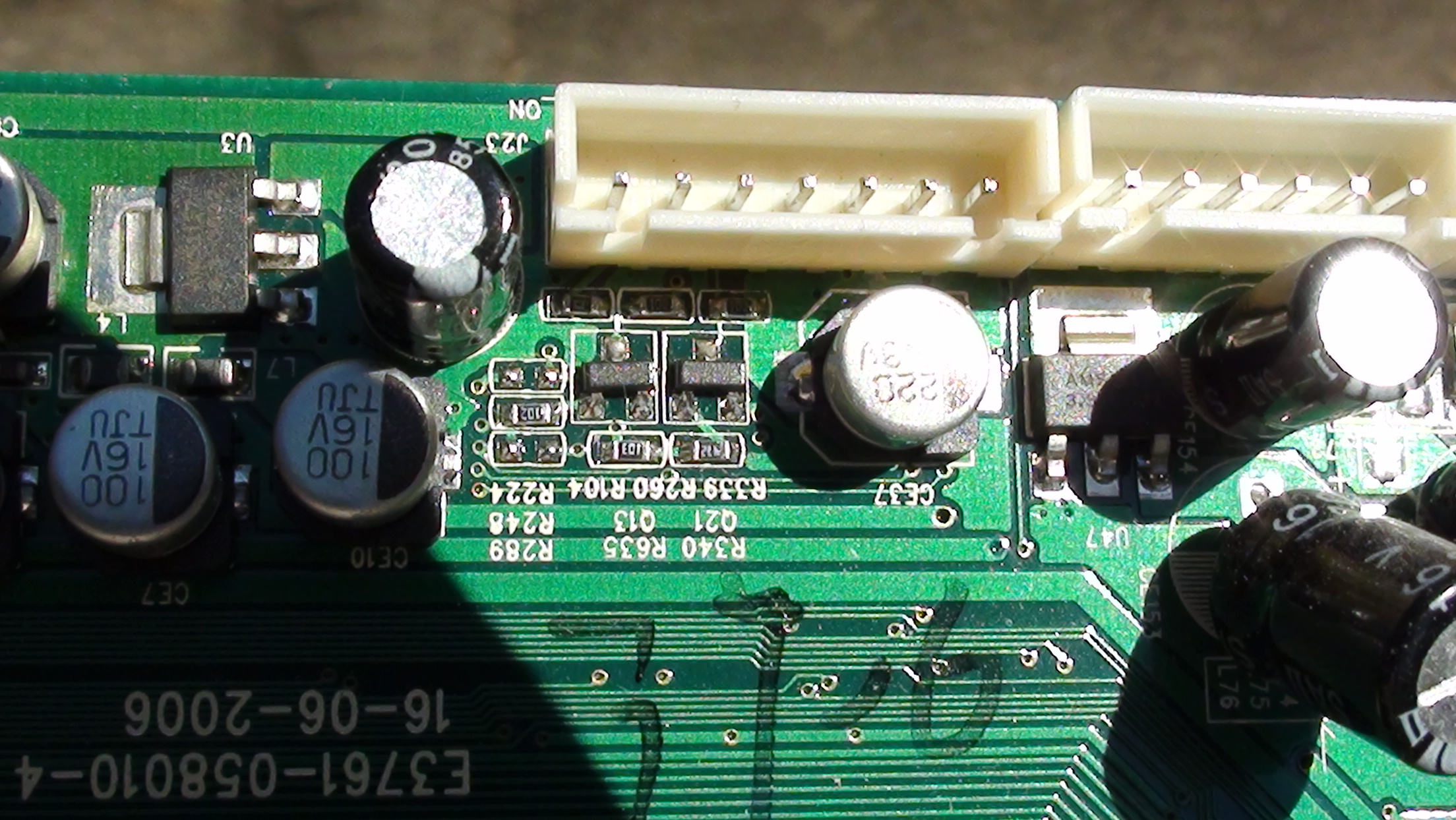

                          Here's pictures of those transistors. There's two of them on the board. Not sure which one is used for the PS_ON. Any suggestions on how I should test them?
                          They both appear to have s1A then a sideways 66. They're a bit hard to read in the two pictures.
                          -- Law of Expanding Memory: Applications Will Also Expand Until RAM Is Full

                            I didn't refresh the page before reading your post. I don't think I can remove just those pins and use my jumper. It'd be a bit hard to test. I can try, but there's a chance I might break the connector...

                                        Here's a copy of the service manual. The schematics start on page 17 I believe (16 is written on the bottom page, but in Adobe, it says page 17).
                                        On that page, on the right hand side, I can see:
                                        Code:
                                        8202UP3_1 HIGH :POWER OFF
                                        8202UP3_1 LOW :POWER ON
                                        In that section, I see the transistor Q21. I should see if voltage is getting to Q21, right? But it seems there's something else going on with it blinking the way it blinked. I guess it could have been a bad connection, the way I had it hooked up....but to blink the way it did, that would be one weird bad connection. Good connection for a second, bad connection for a second, good connection for a second, bad for a second, etc. I doubt it was a bad connection.
