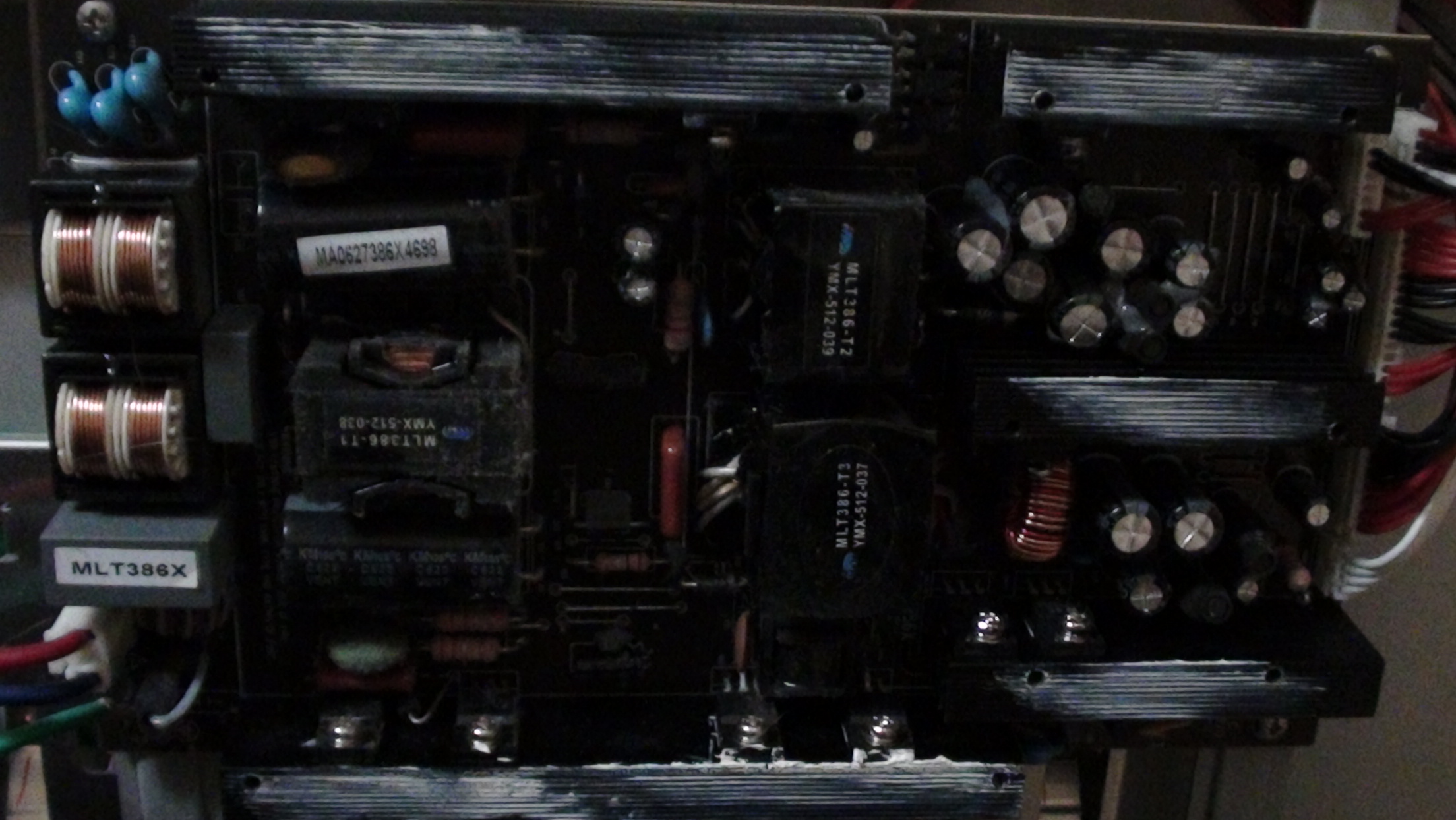

        Images of the boards ?
        • Spork Schivago
          • Mar 2012
          • 4734
          • United States of America

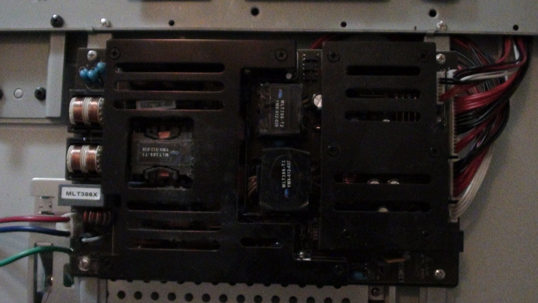

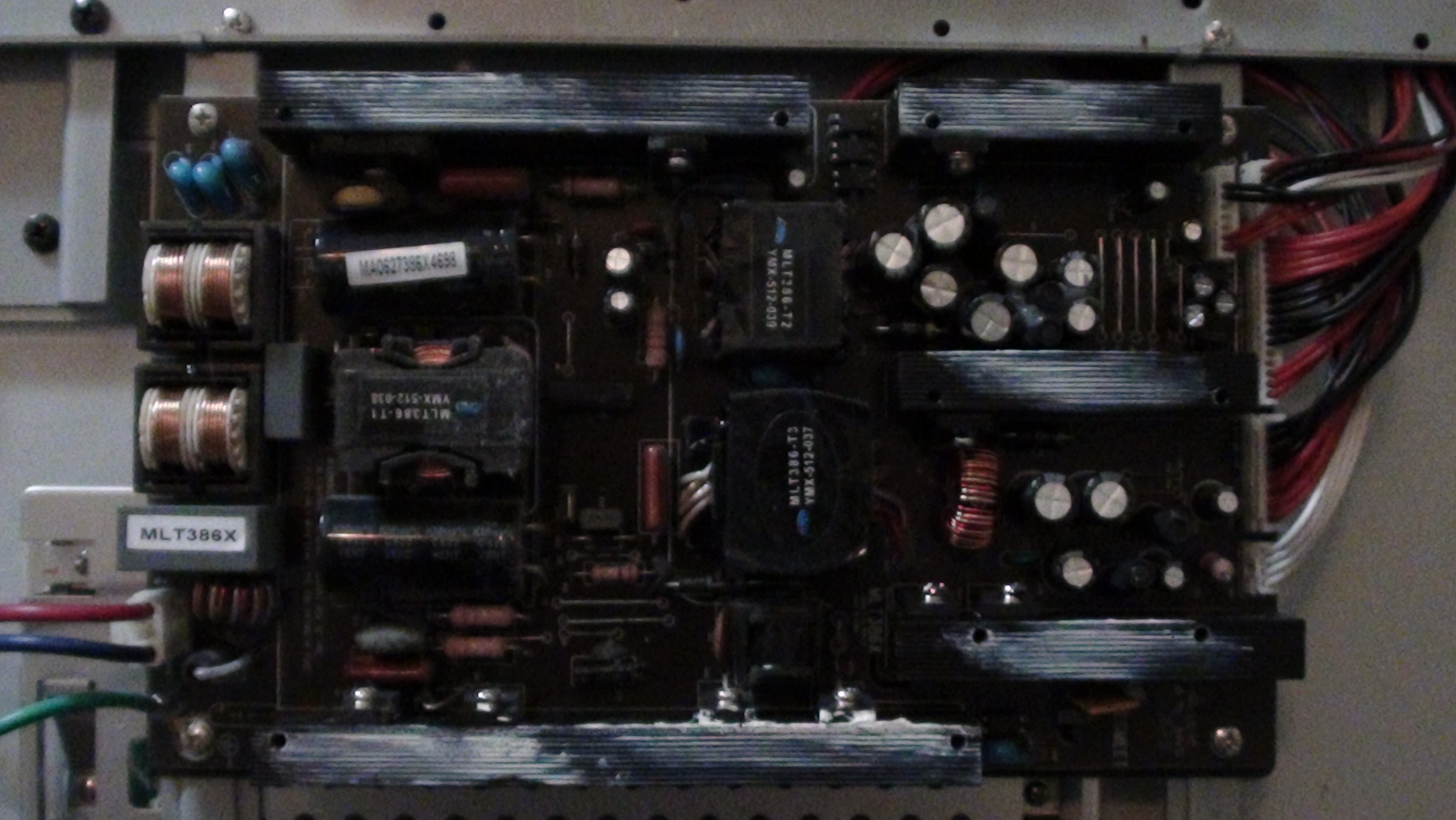

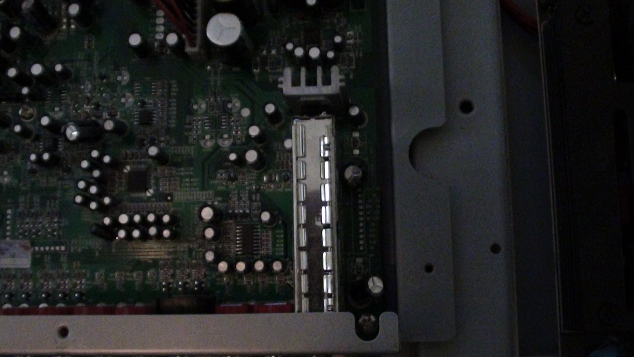

          Re: Anyone familiar with the Akai LCD3701AD?
          I'll post them.

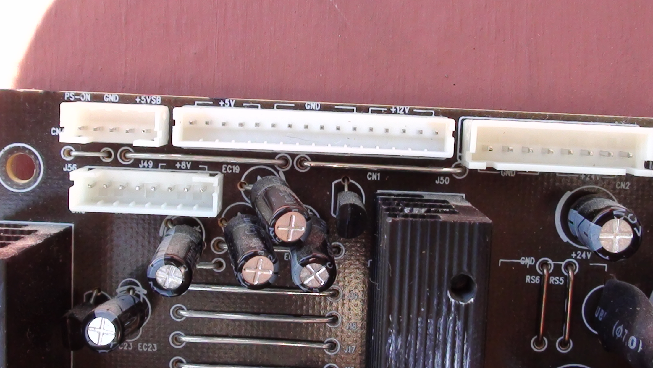

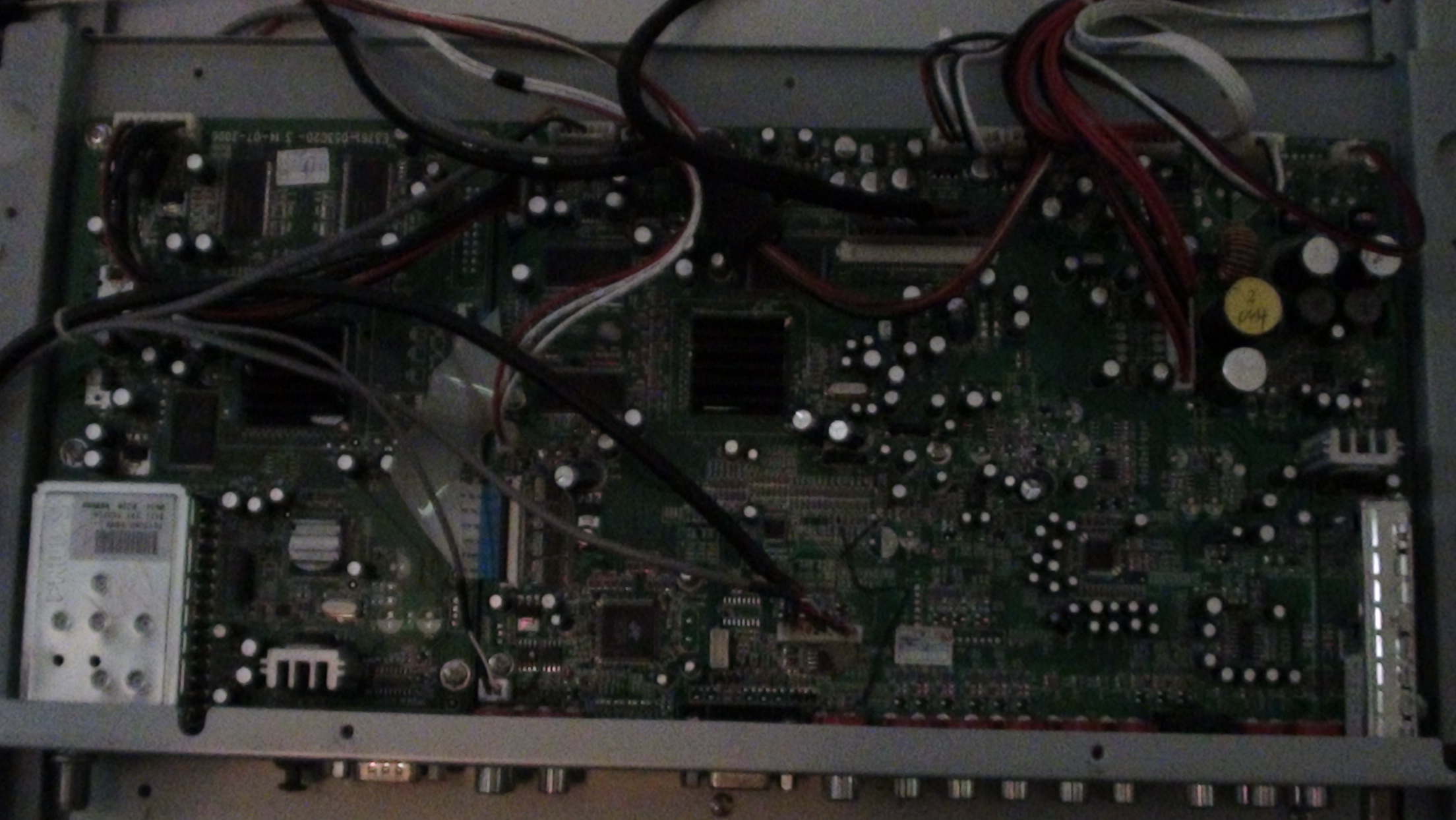

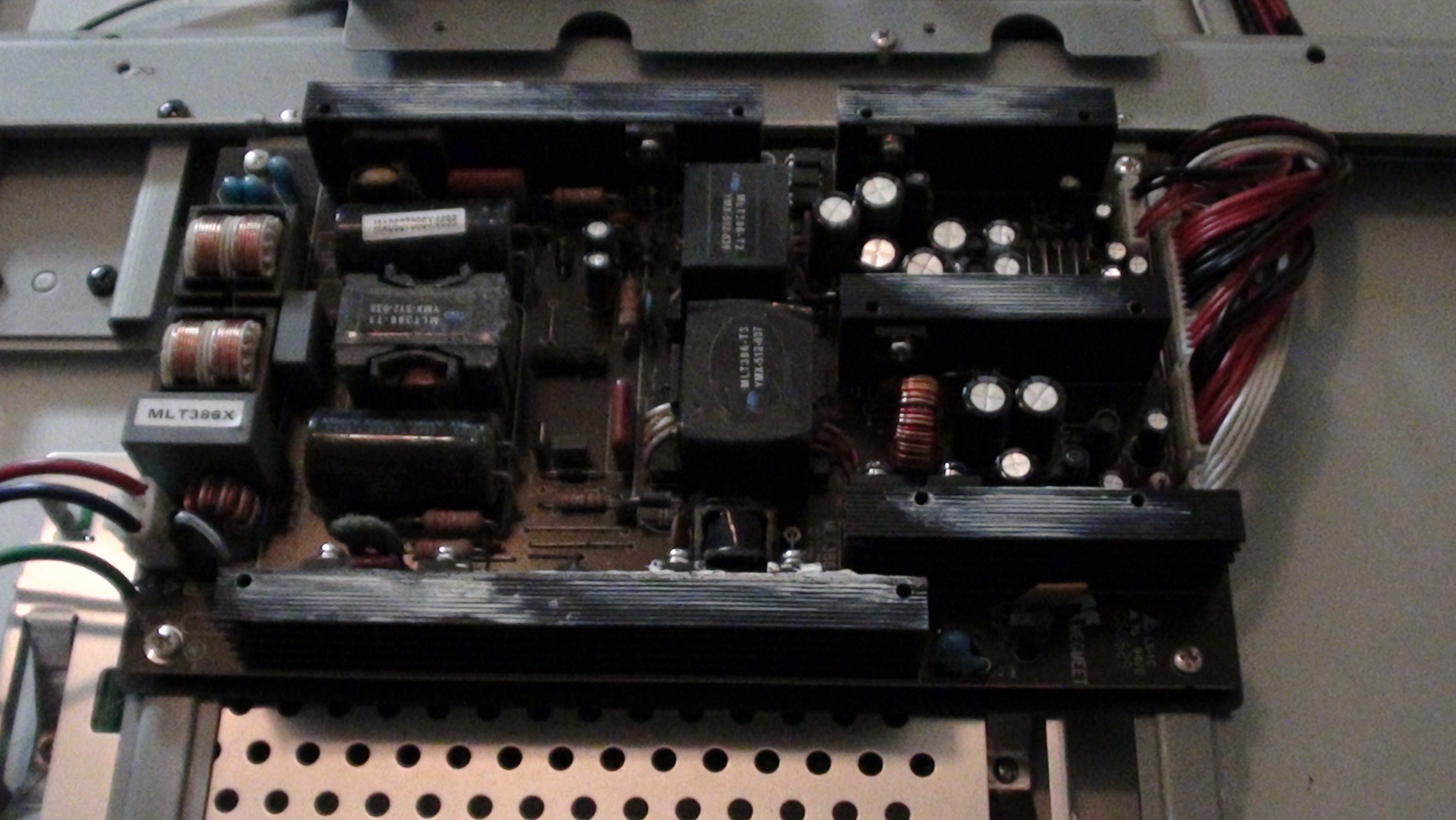

          These are the best I can get right now. It's still a bit dark here. We're still unpacking and haven't found the flashlights yet. They're not the brightest.
          My wife found my ESR meter last night, so I can finally test caps again. I'm going to replace the 470uF 16V with a used (but good) 470uF 16v electrolytic cap on the main board, just to see if the TV powers on. I doubt it though. I think that bad cap next to the one tuner (there's two tuners) won't affect whether the TV powers on or not, but maybe.
          The PSU looks fancy but none of the connectors are really labeled like they usually are. I don't see an PS_ON or STDBY like I normally do. A few have some volts written next to them, like 5v and 24v, so I can check those. What sucks also is almost every connector is glued. And on the power supply board, a lot of the caps are glued to each other. What a mess!

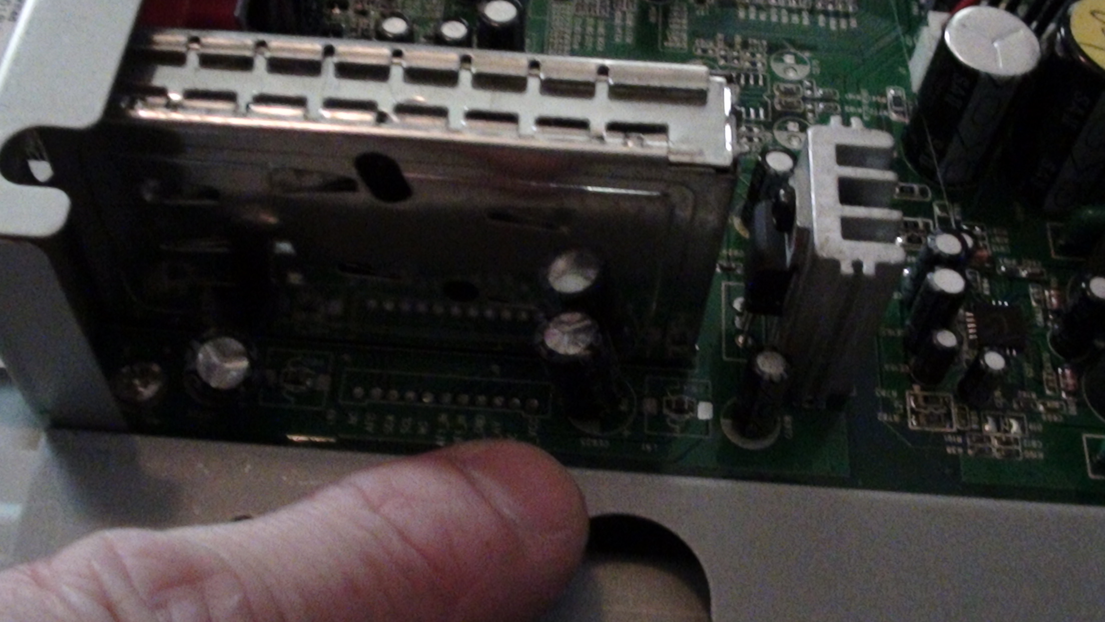

            very hard to say in those pictures but by the tuner theres a small heat sink then a large capacitor it looks like the outer plastic sleaving has shrunk so certainly worth testing all the capacitors for correct uf and esr.If this was my set and i was working on it for a customer i would certainly fully re cap the psu too.
              I know the caps you're talking about with the shrunken plastic sleeves. I've never seen that before. I pulled them and tested but they're good. I replaced the bad 470uF and I'm gonna see if it powers on, if not, I'll probe the PSU with my multimeter and see if I'm missing any voltages (at least where they're labeled). If I'm missing them, I'll start pulling caps on the PSU and testing them.
              It's definitely an odd TV. I've never seen one from the factory that had jumper cables wired onto it. This main board has two. One on the front side, one on the back.

                As I suspected, the 470uF 16v cap didn't fix the issue. The caps on the power supply are CapXon. At this point, I'm not even sure one of the caps on the power supply unit is bad. Maybe it's one of the six transformers? Or maybe one of those 3 pin chips on the heatsinks. There's 9 of those 3-pin chips.

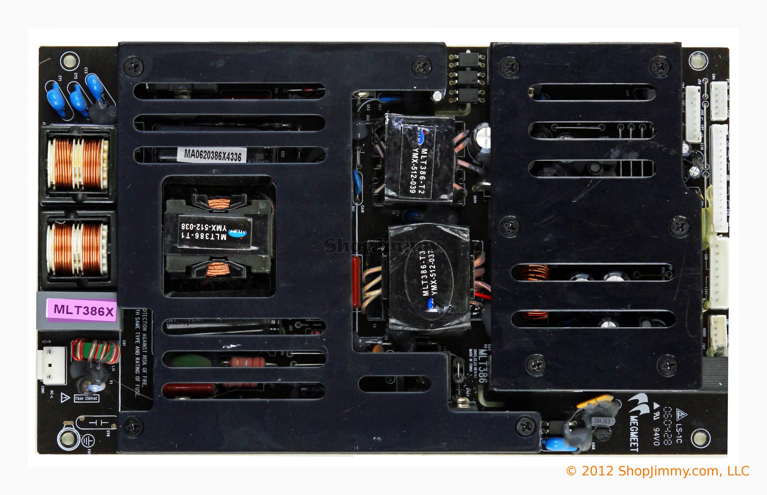

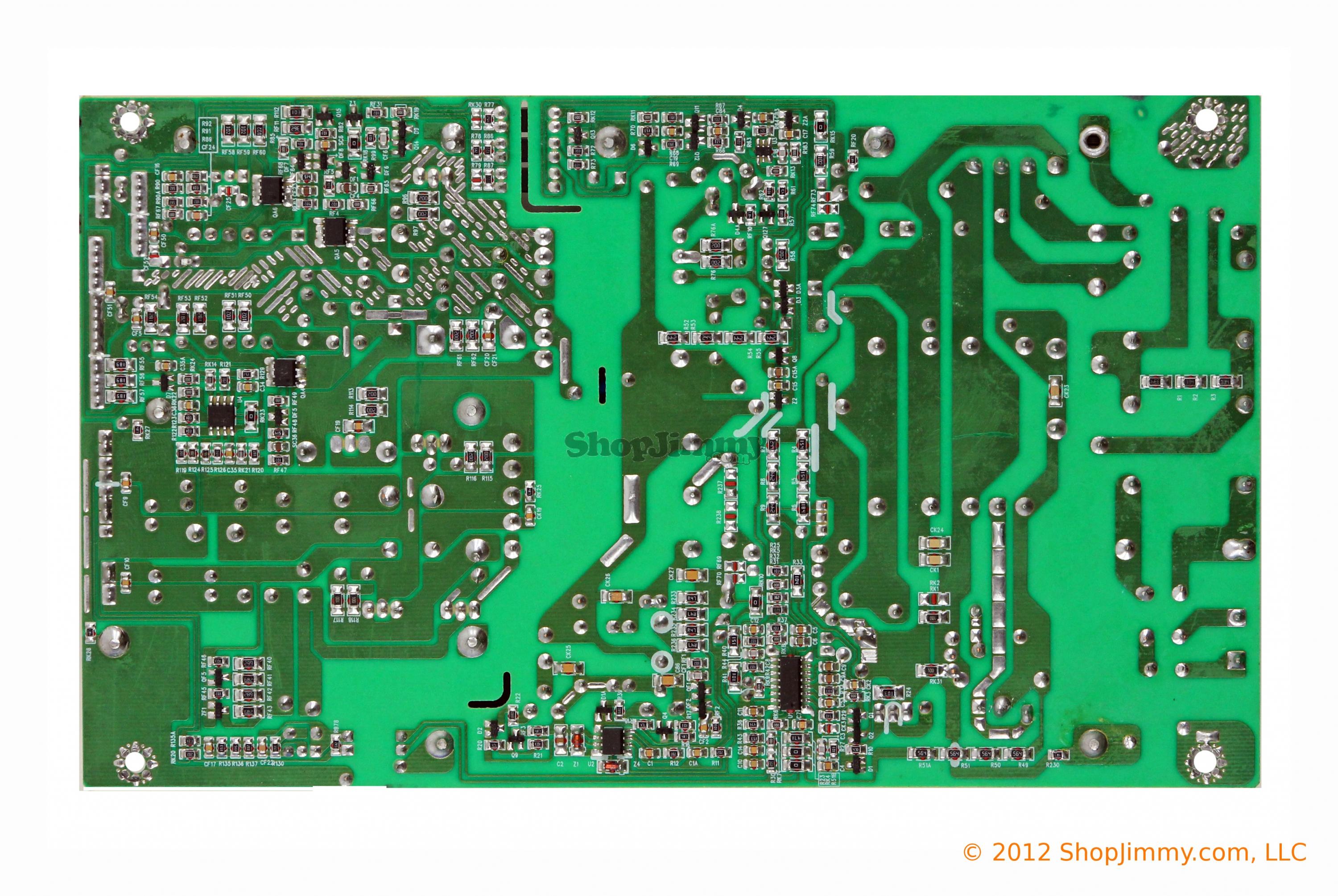

                  Megmeet MLT386X (MLT386Y) Power Supply Unit.
                  http://www.shopjimmy.com/megmeet-mlt...pply-unit.htm#
                  Pictures provided by shojimmy.
                  So what dcv did you test on the power supply output connectors so far?

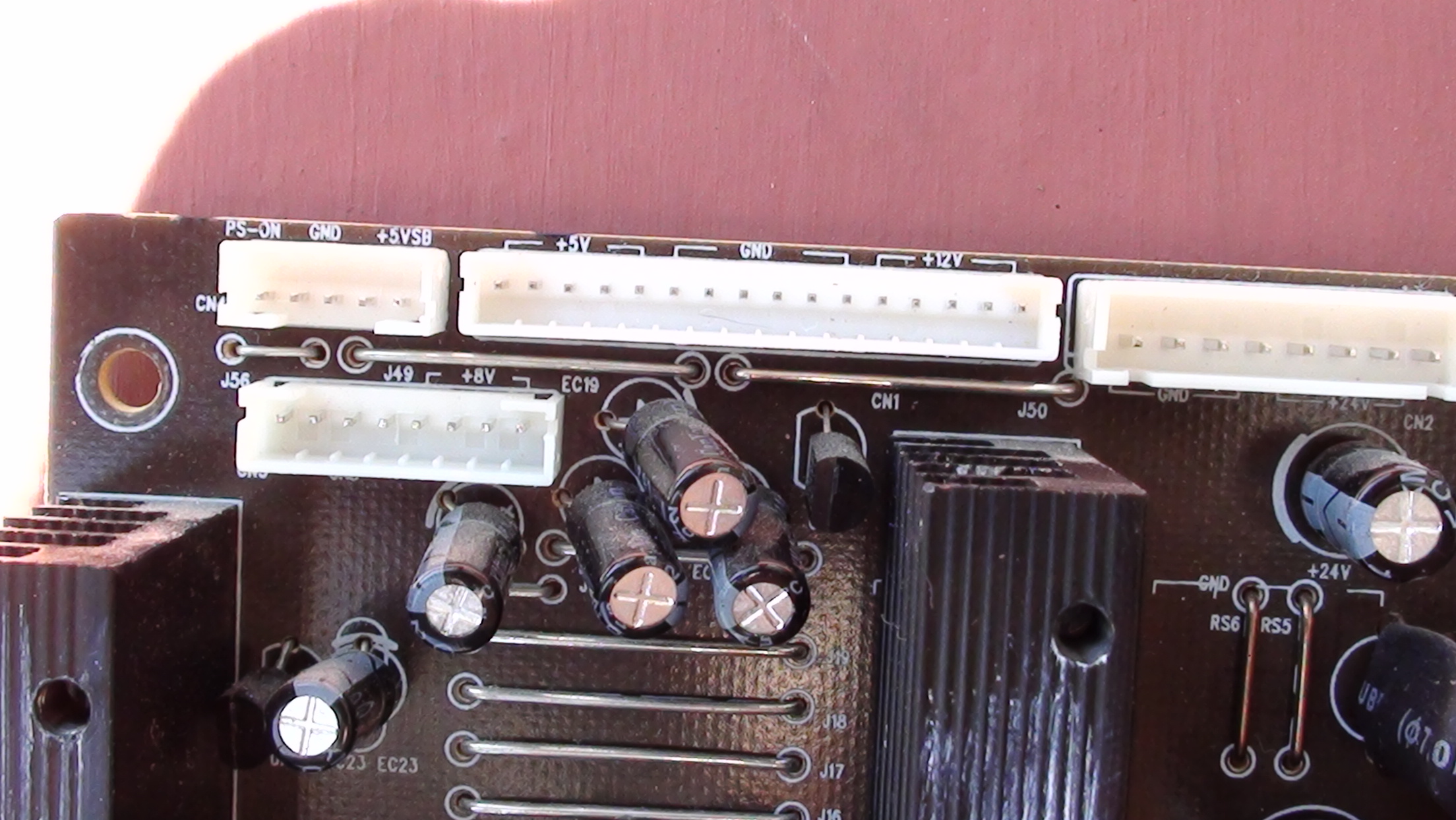

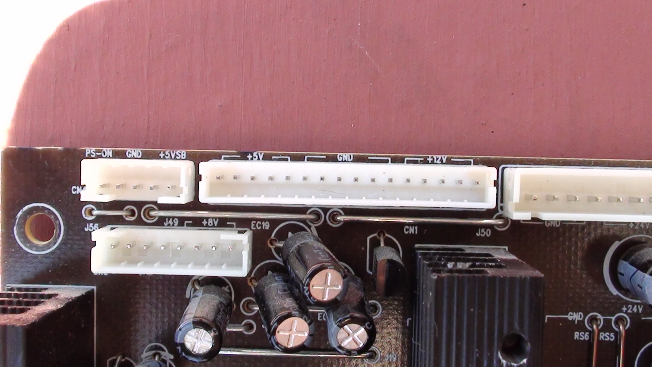

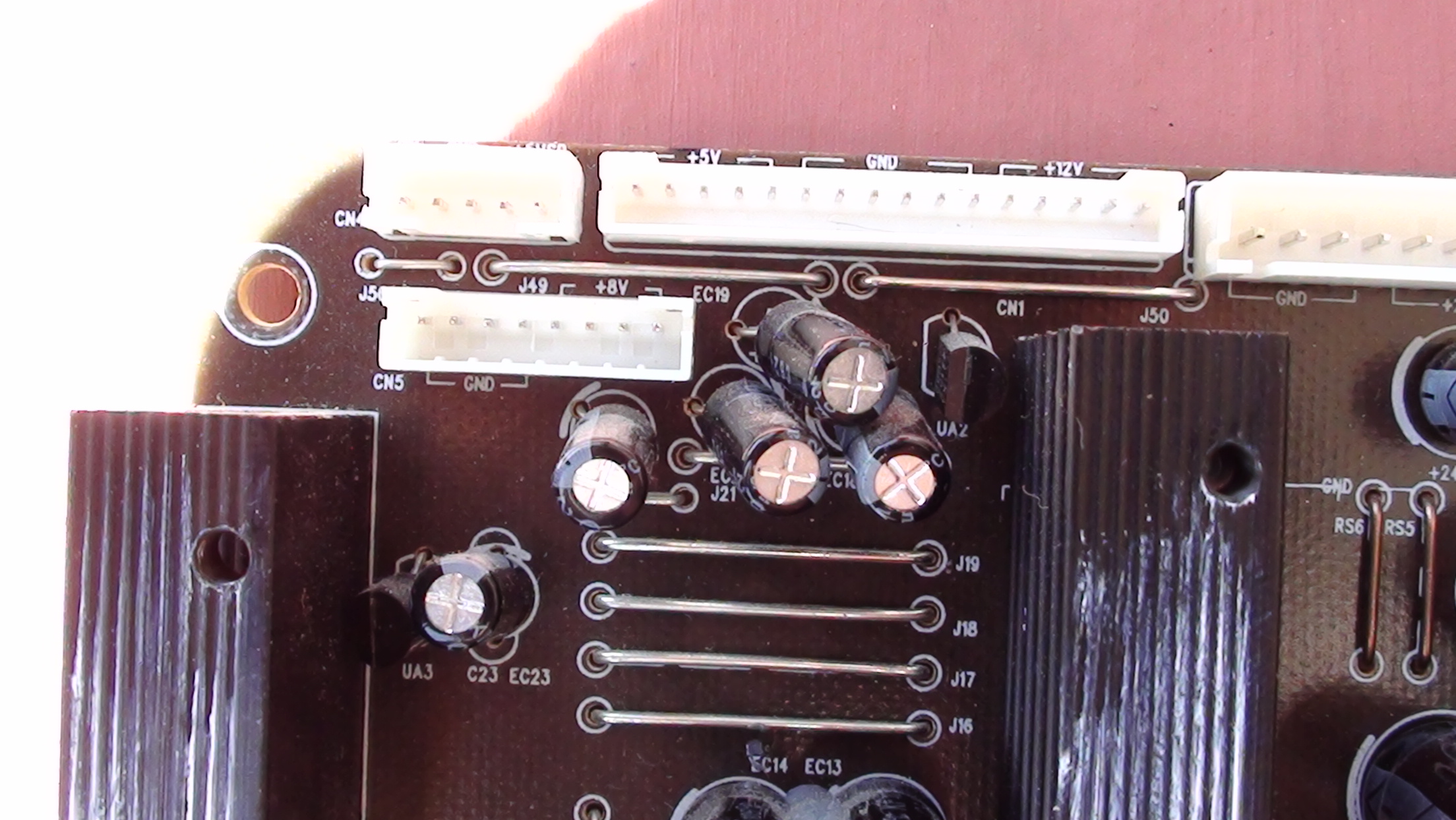

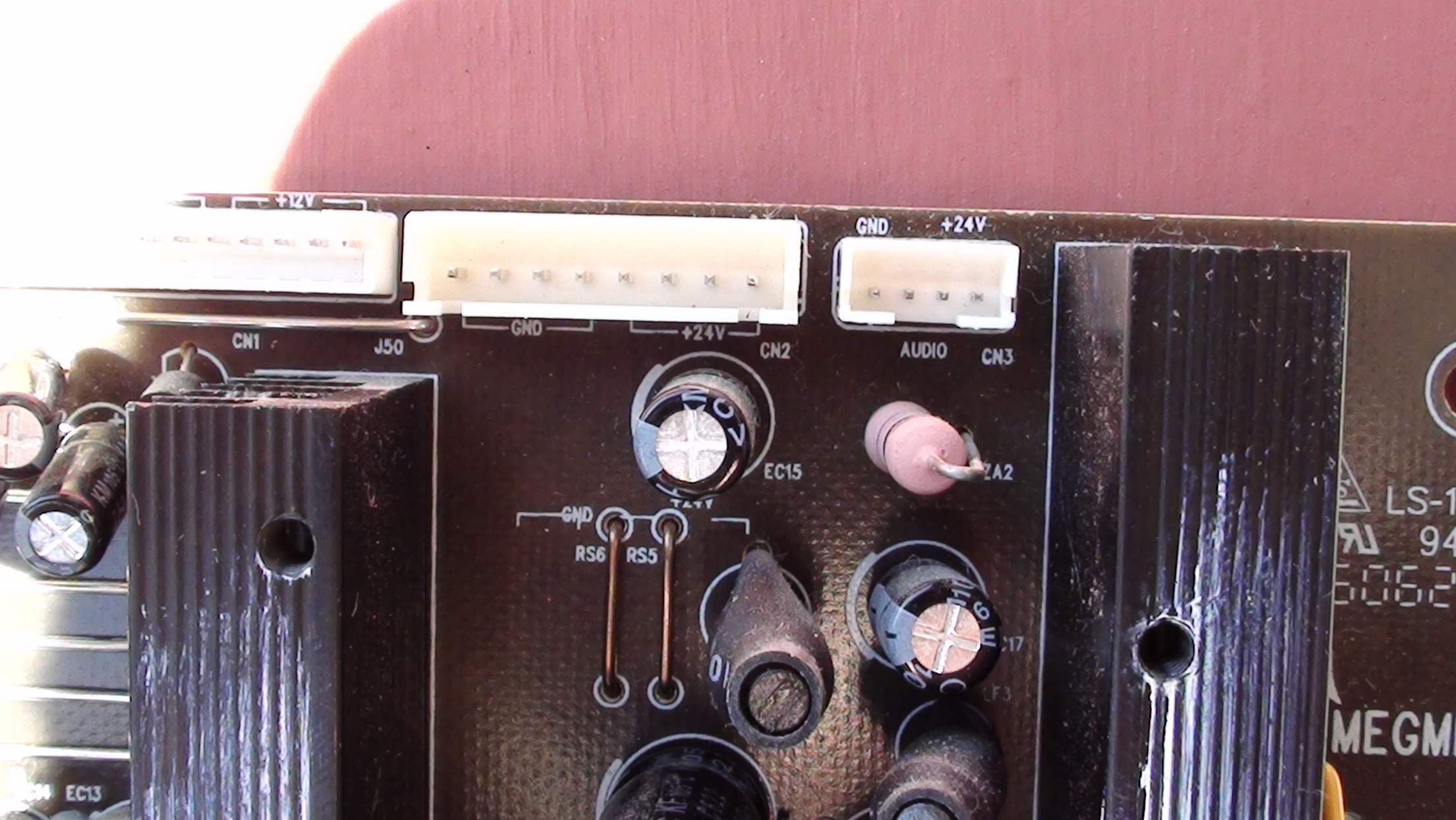

                          Now that it's brighter outside, I got better pictures. Also, after removing the cables, I noticed they are labeled (thankfully!). Here's new up-close images of the connectors with their various labels.
                                        Okay, I got the voltages.
                                        Code:
                                        (left most connector in pic one)
                                        GND -> PS_ON: 0.084VDC
                                        GND -> +5VSB: 5.18VDC and 5.19VDC (more than one hot)
                                        (left most bottom connector in pic one)
                                        GND -> 8V: 0VDC
                                        (2nd to left most connector in pic one)
                                        GND -> 5V: 0.35VDC
                                        GND -> 12V: 0.25VDC
                                        (last two remaining right connectors)
                                        all GND -> 24V: 0VDC
