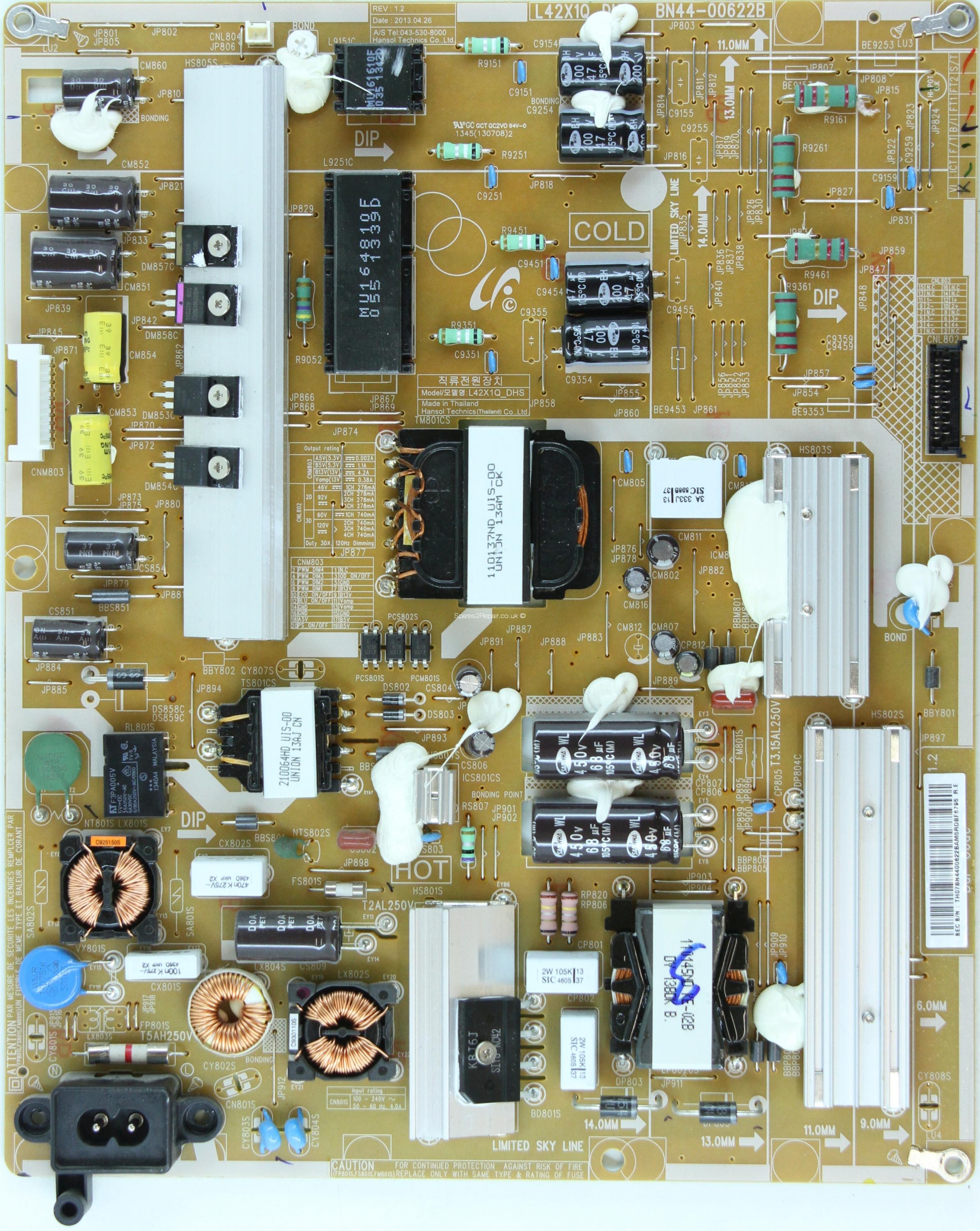

    hi there,
    i have an issue with my 2,5 years old Samsung UE40F6400 TV.
    it's power cycling and clicking.

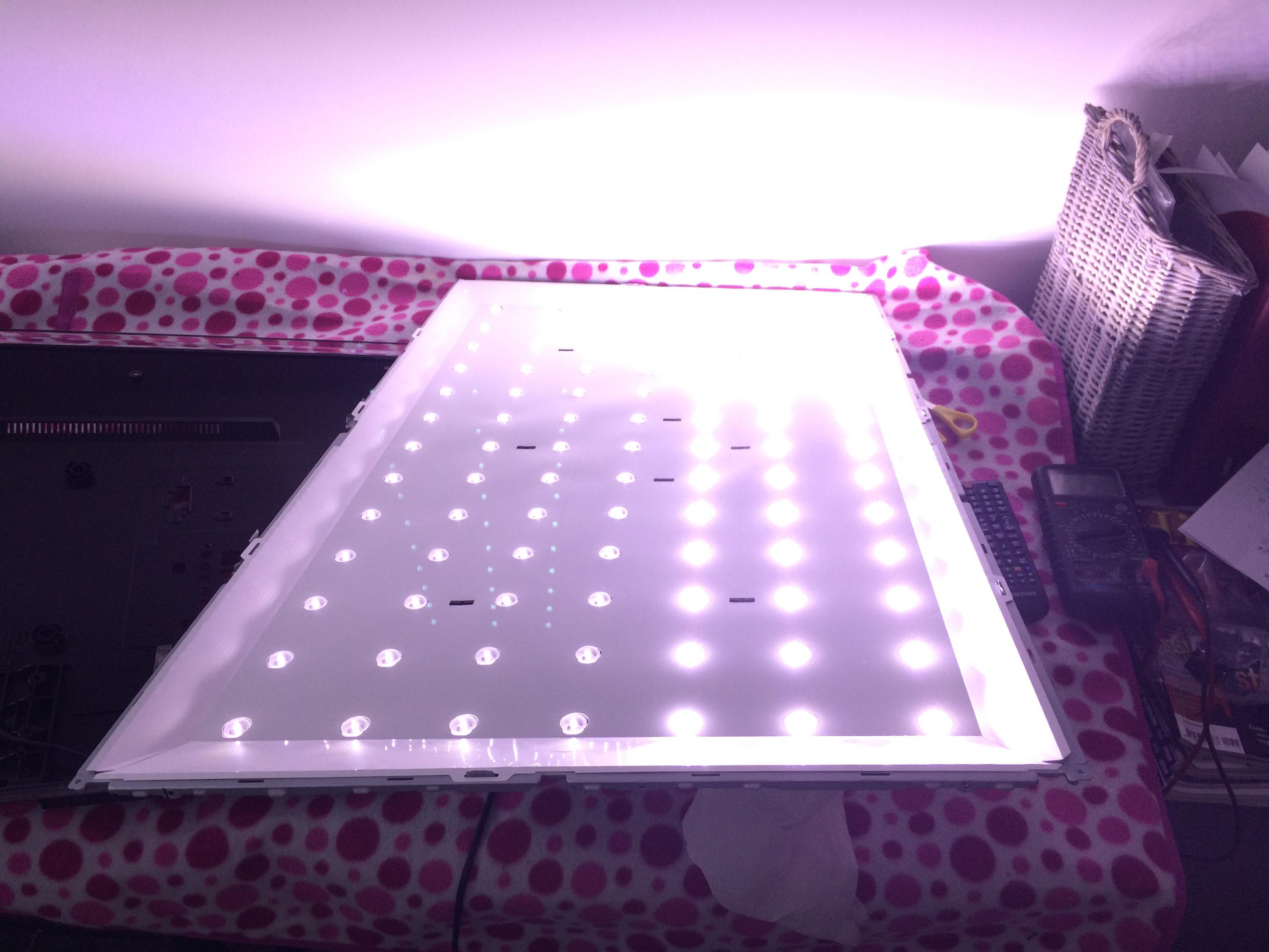

    with the help of this forum i tried the basic troubleshooting tips and i noticed that when i disconnect the cable from PSU to mainbord the power cycle becomes faster, but the backlights don't stay on.
    thought it may be the LED's and stripped the TV down and inspected the LED's, but they're all working and there is nothing obvious to see, such as burnmarks etc.
    when i connected the PSU and mainbord and powered up the TV i noticed the upper 3 bars light up fine, but the lower 4 bars are dimmed.
    checked the 'distributor' strip on which the LED bars are connected, but again nothing obvious.
    note: inspected while still powercycling. (took picture with burst and uploaded the most clear one)
    now i'm stuck a little, because i haven't seen another case similar to mine on this forum.
    i'm leaning towards a bad PSU board, but want to be as sure as possible before ordering a new one...
    checked the front an back of the board, but again, nothing to see.... no bulged capacitors, bad components of signs of cracked or bad solderings.
    i attached a picture of the LED situation when power cycling.
    also a (internet) picture of PSU board, i have exactly the same one and also included a repair manual i found an used to this point.
    any help would be much appreciated!

    Re: Samsung EU40F6400 power cycling
    I would first resolder the transformer legs and the legs of the devices mounted on the heatsink, specially those legs that soldered to the rivet through hole.
    The backlights should come on and stay on when the cable between the main board and the power supply board is not connected.
    BTW, this TV has 4 LED strings and 4 driver circuit for each string.

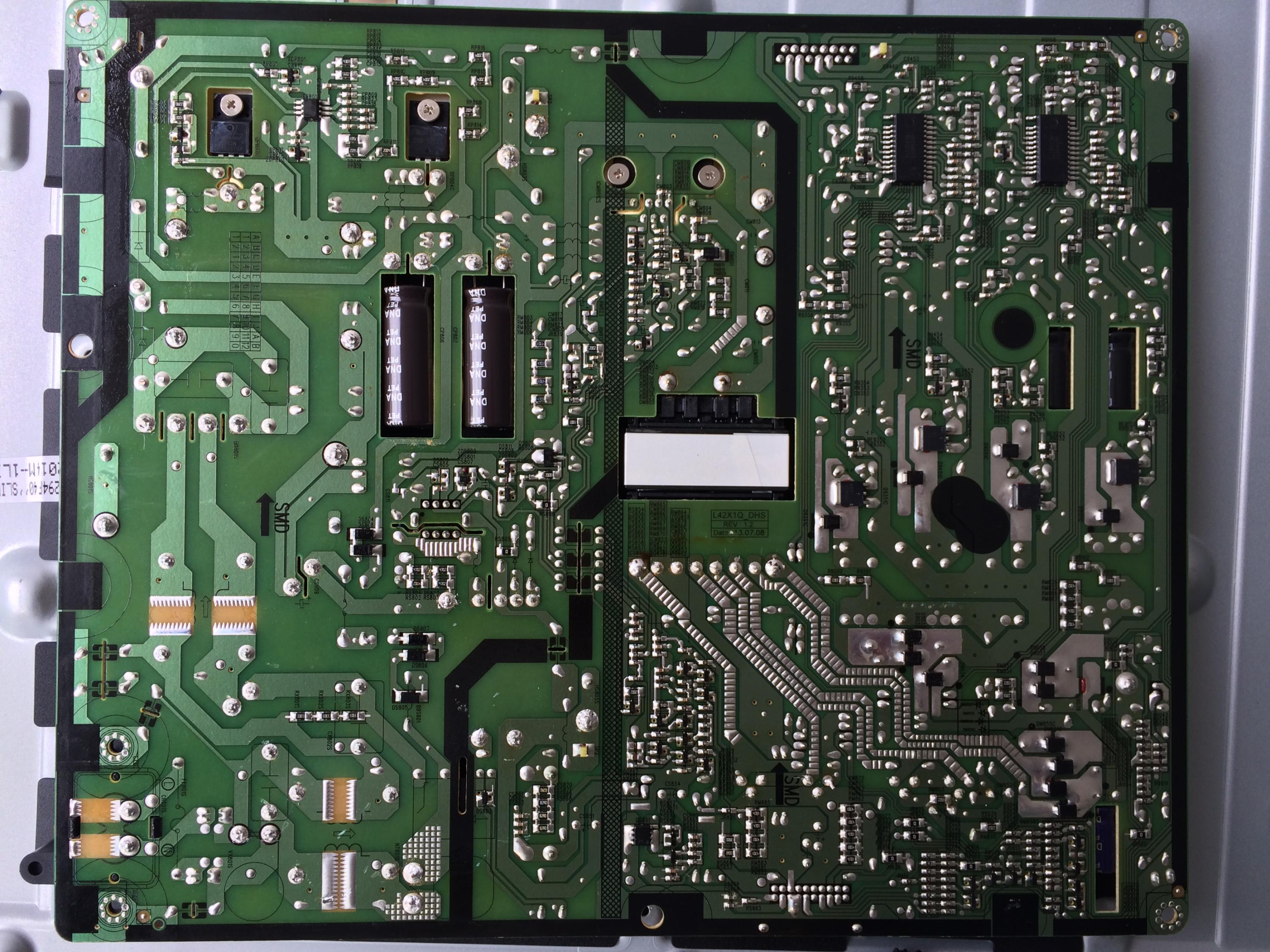

                  i did some measuring and noticed that cap C9154 does about 40 Volts and his neighbour C9254 does about 80 volts. is something wrong here?
                    Originally posted by pvl87
                    reflowed again, no luck.
                    That means the Boosted Voltage for the C9154 is not working.
                    So the C9254, 9454, and 9354 all have about 80VDC?
                    I will have to trace out the circuit of that Power supply board BN44-00622B to see how it works.
                    shopjimmy does not have any pictures of the BN44-00622B so I will need the good clear pictures of the whole bottom side of the board for me to be able to trace out the circuit.
                      here is a picture of the underside.
                      i think the forum is compressing it though.
                      hope it's viewable!
                      there are 2 rectangular holes in the right of the picture, the mentioned caps are located there.
                      i'll do some more measuring this evening.

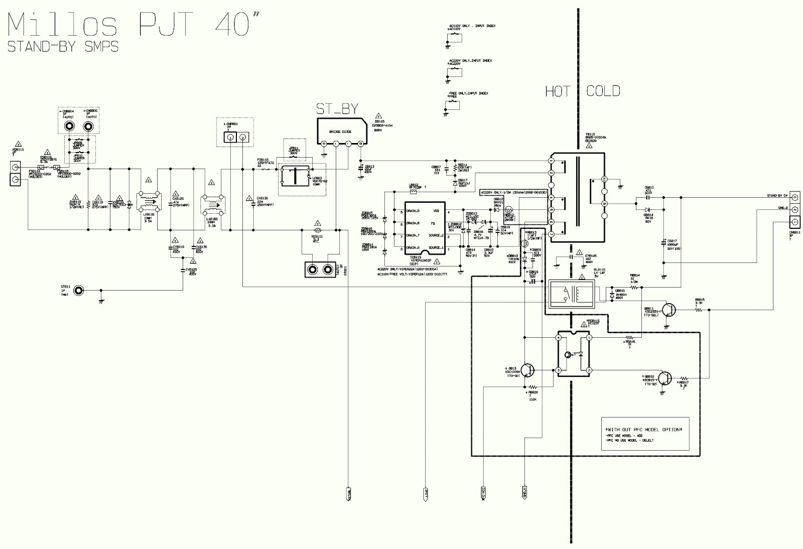

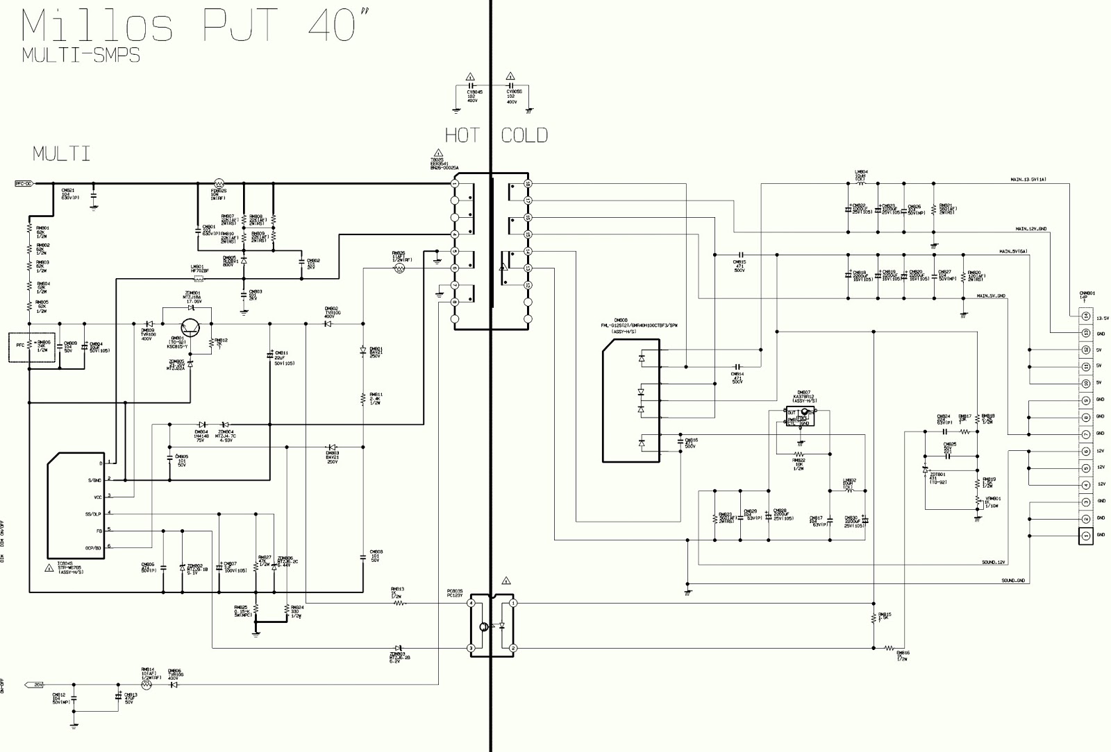

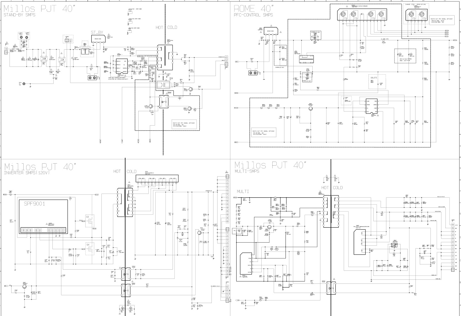

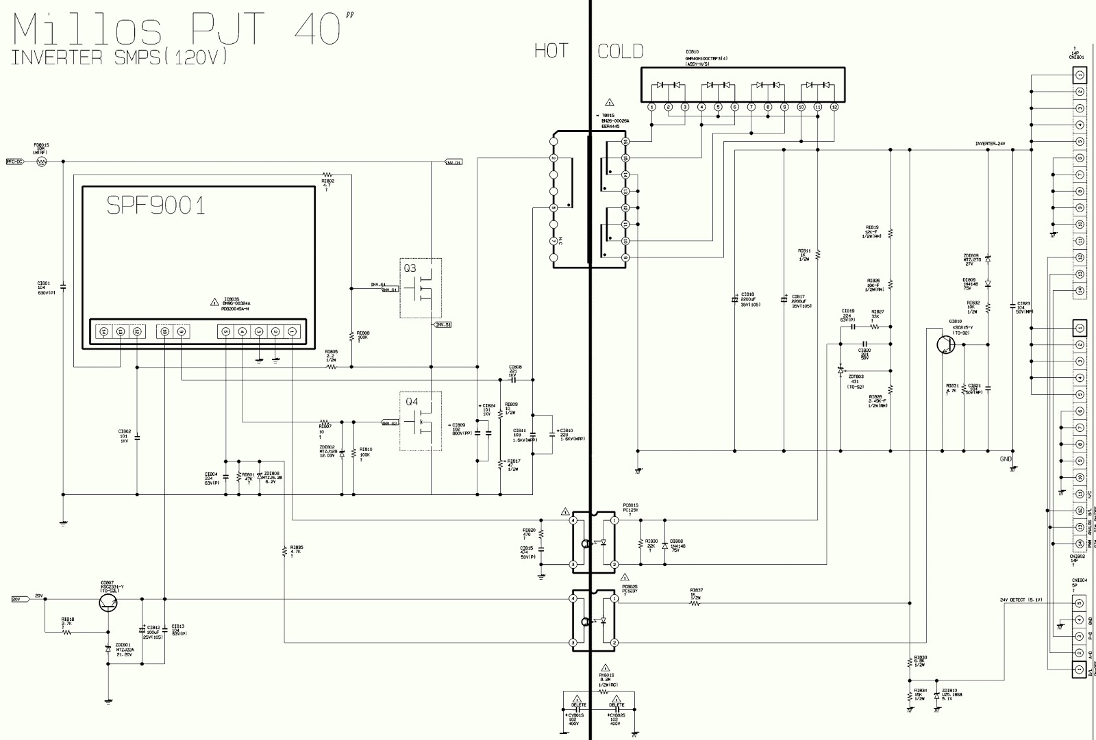

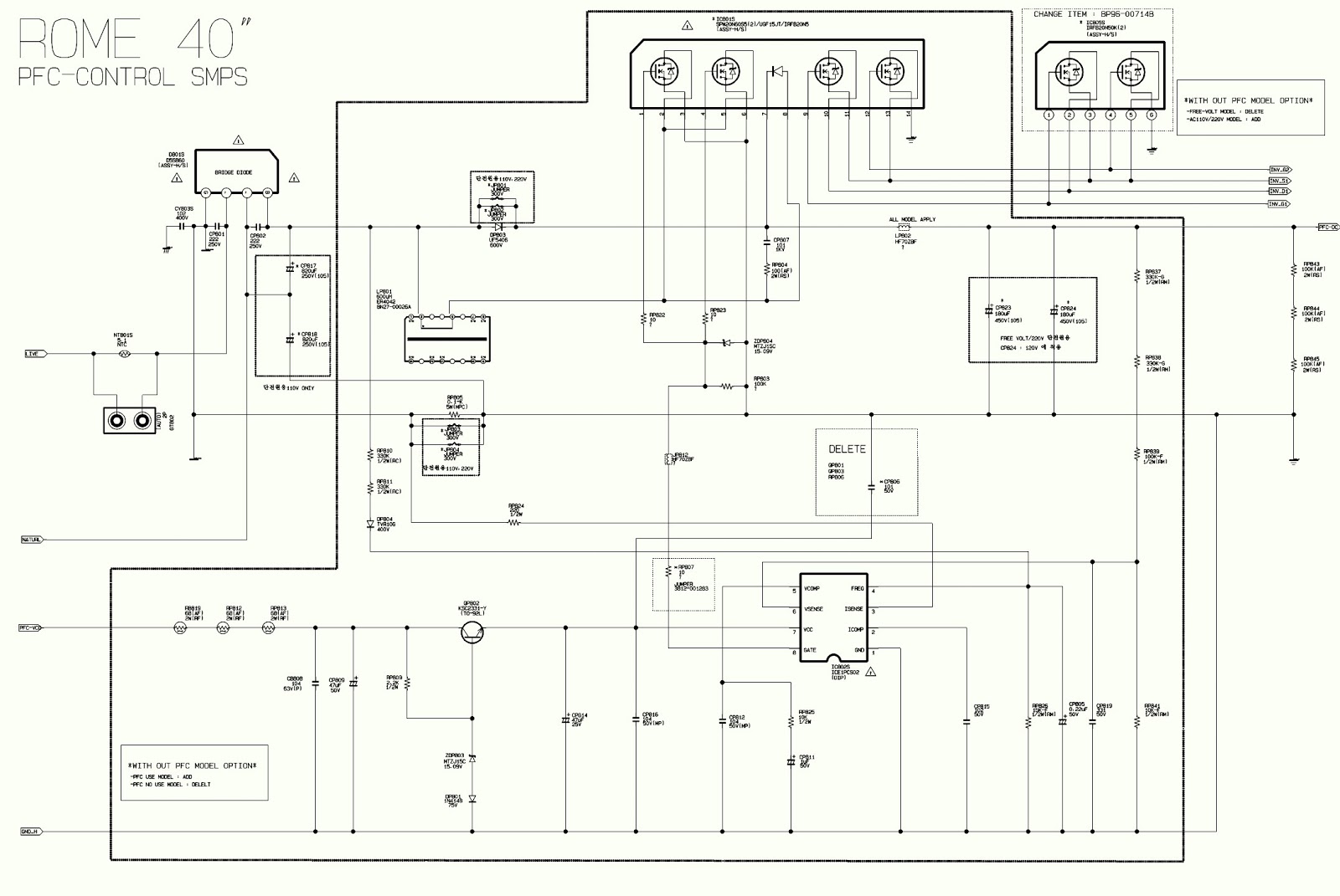

                          Originally posted by thoma
                          http://televid-sib.ru/index.php?topic=27588.0
                          schematic Power Supply BN44-00622B Samsung!
                          Registration required!
                          regards thoma!
                          Hi thoma, some how I cannot download that PDF. Can you do it and upload it here? Thanks.
                          I found them on the net but it does not match the board at all.
                          For example:
                          https://electro-medical.blogspot.com...ply-board.html
                          Many sites show the same diagram but it is not even close to what on the board.
                            i found these online.
                            they're barely readable though. i couldn't tell if they match or not, you guys have any idea?
                                I found that one too, but it does not match the board.
