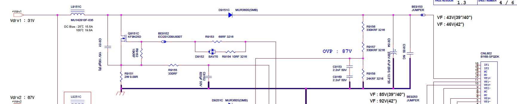

                here they are:
                  Re: Samsung EU40F6400 power cycling
                  looking at the scematics that 42 VDC over C9154 could be correct.
                  the other 3 'channels' (meanin C9252, C9354 and C9254) are all 80VDC but that is the way it's meant to be if my interpretation of the scematic is correct.
                  (see attached image)
                  could someone explain why that could be?
                  and if there is anything else i can check out for finding the bad component?
                  thanks for all the help so far anyway, i'm going back and forth, i know
                  it's a learning process...

                    i measured (when powercycling) CNL802 and CNM803 (see Excel file attached).
                    on CNM803 i'm missing some info. i need info on the yellow cells in the excel file. i don't know whether the values i measured are what they're supposed to be.
                    i also discovered something new.
                    when power cycling, voltage on VF4+ and VF3+ (pins 4 and 6 on CNL802) are 64VDC instead of 84VDC what it should be according to the scematics.
                    when i measure C9354 and C9454 (when powercycling) i get 64VDC aswell.
