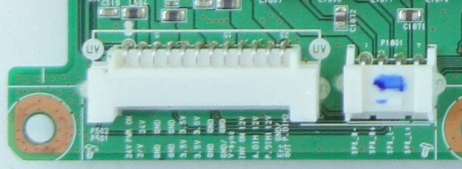

then i checked the power outputs, 12, 24 and 3.5V are all ok, no have any 5V from power supply board.

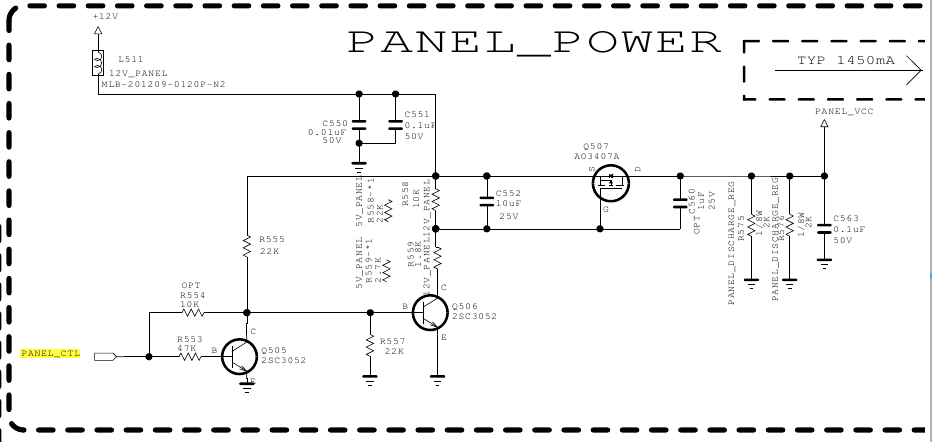

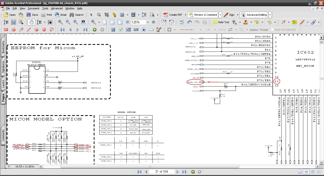

If I check pin 10 of IC602 which seems to be BL-on i see 3.5V there but no reaction from backlight.

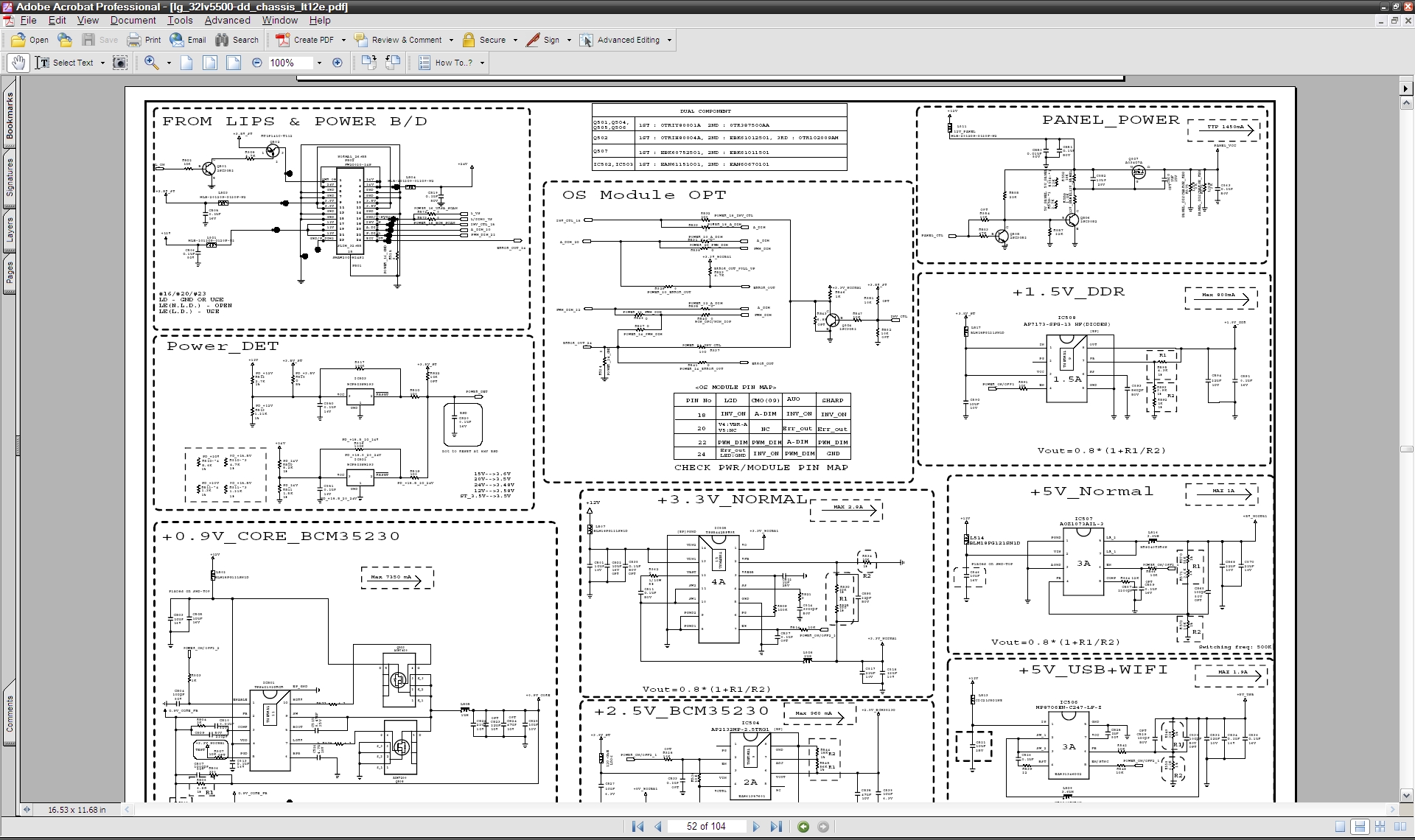

Where is the 1.5V for the rams ?
There is an image from the board i could find on the net, except the connectors i don't have on this set strangely.
