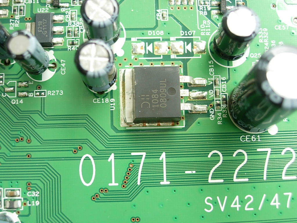

        Re: Vizio SV420XVT1A missing 12v on main board
        Can you post a picture of' U19, 0809 ul (1084)
        • bikerbuddy
          • Jun 2011
          • 134
          here is a pic of U19 DB.

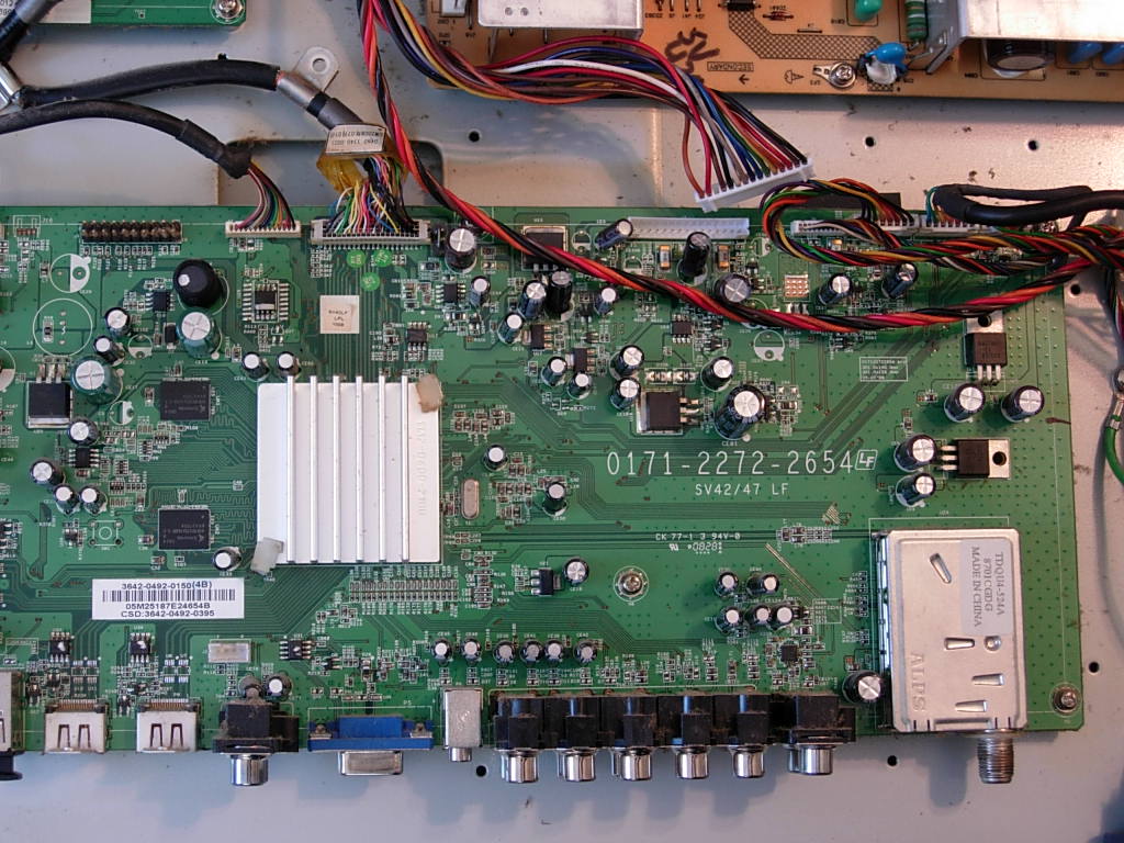

              here is a full main board pic
                Maybe this?
                https://cdn.badcaps-static.com/pdfs/...d543900844.pdf
                although on google images the marking at the top is ap maker
                      What you have is the Adjustable type, NOT the fixed output type, you can tell by the resistor network connected to the ADJ pin and the Output pin.
                      So get the Adjustable type.
