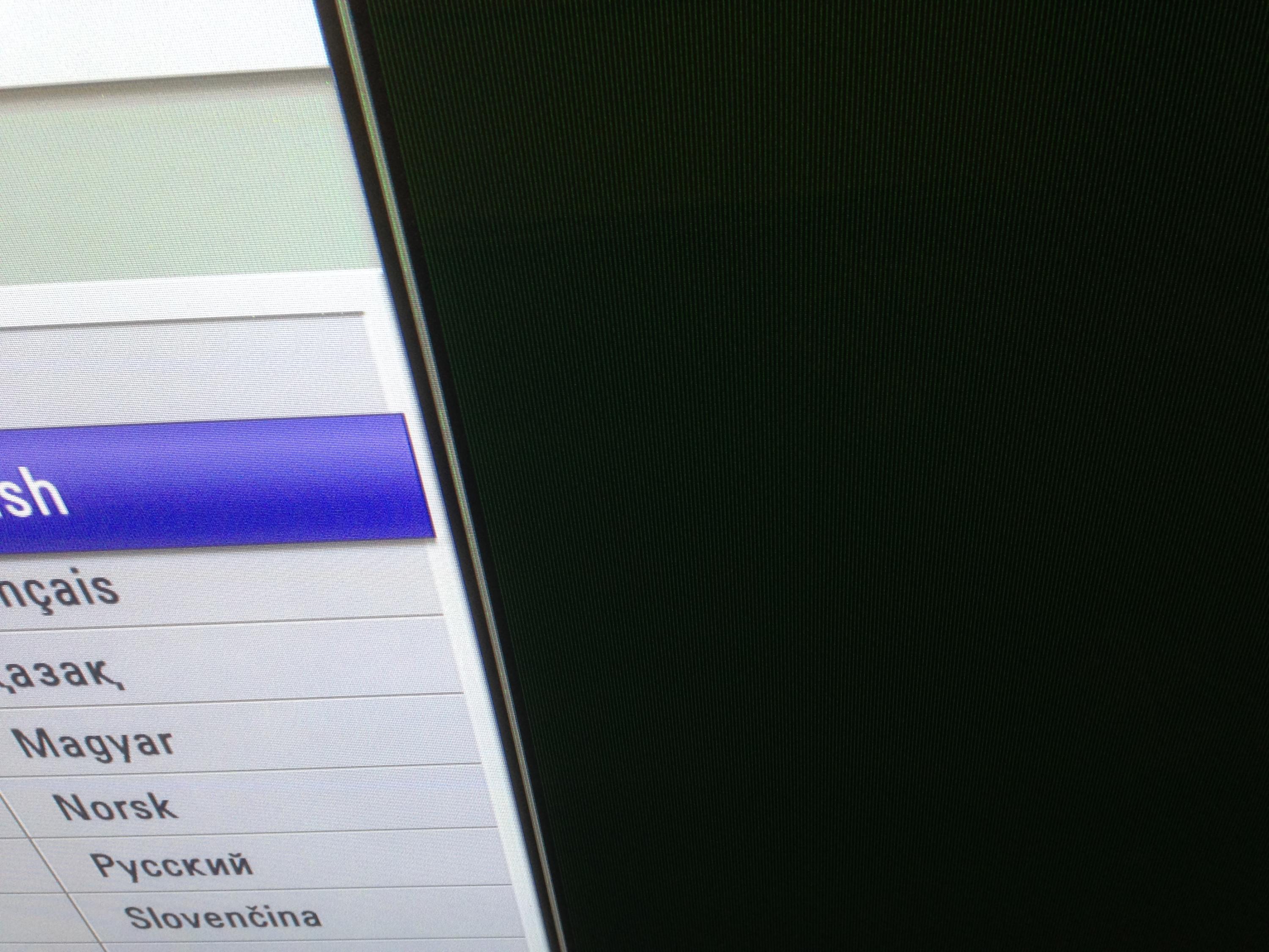

    Hi

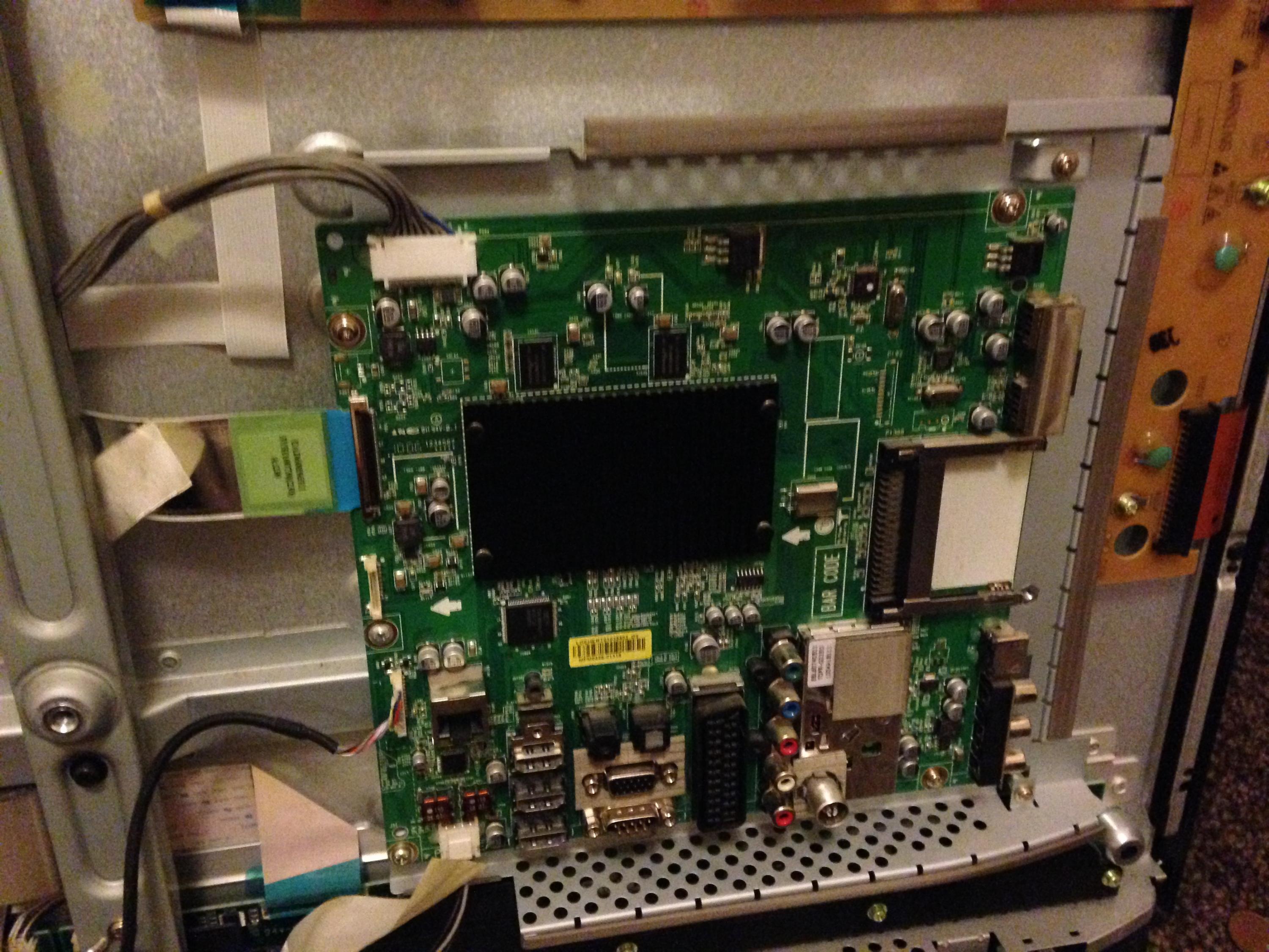

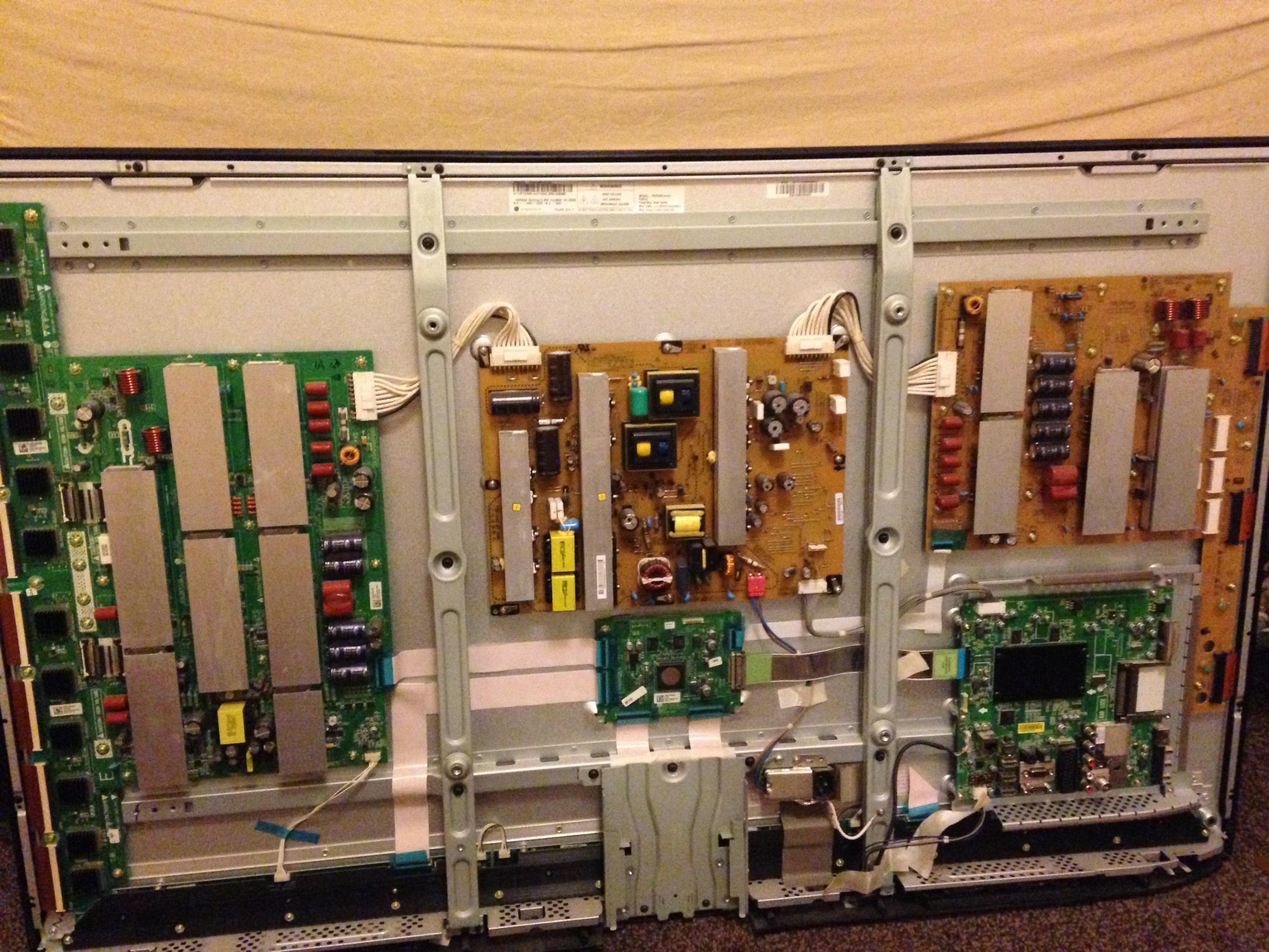

    My lg 50pk590 wouldnt switch on (switched on but with a glow no picture or standby light)- so I took a main board from mates tv and tried it in mine and the tv came on as it should.

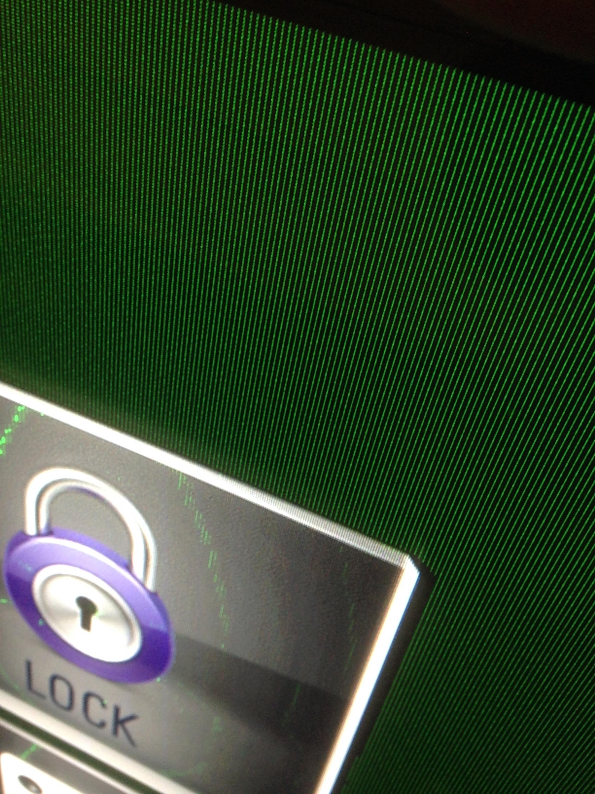

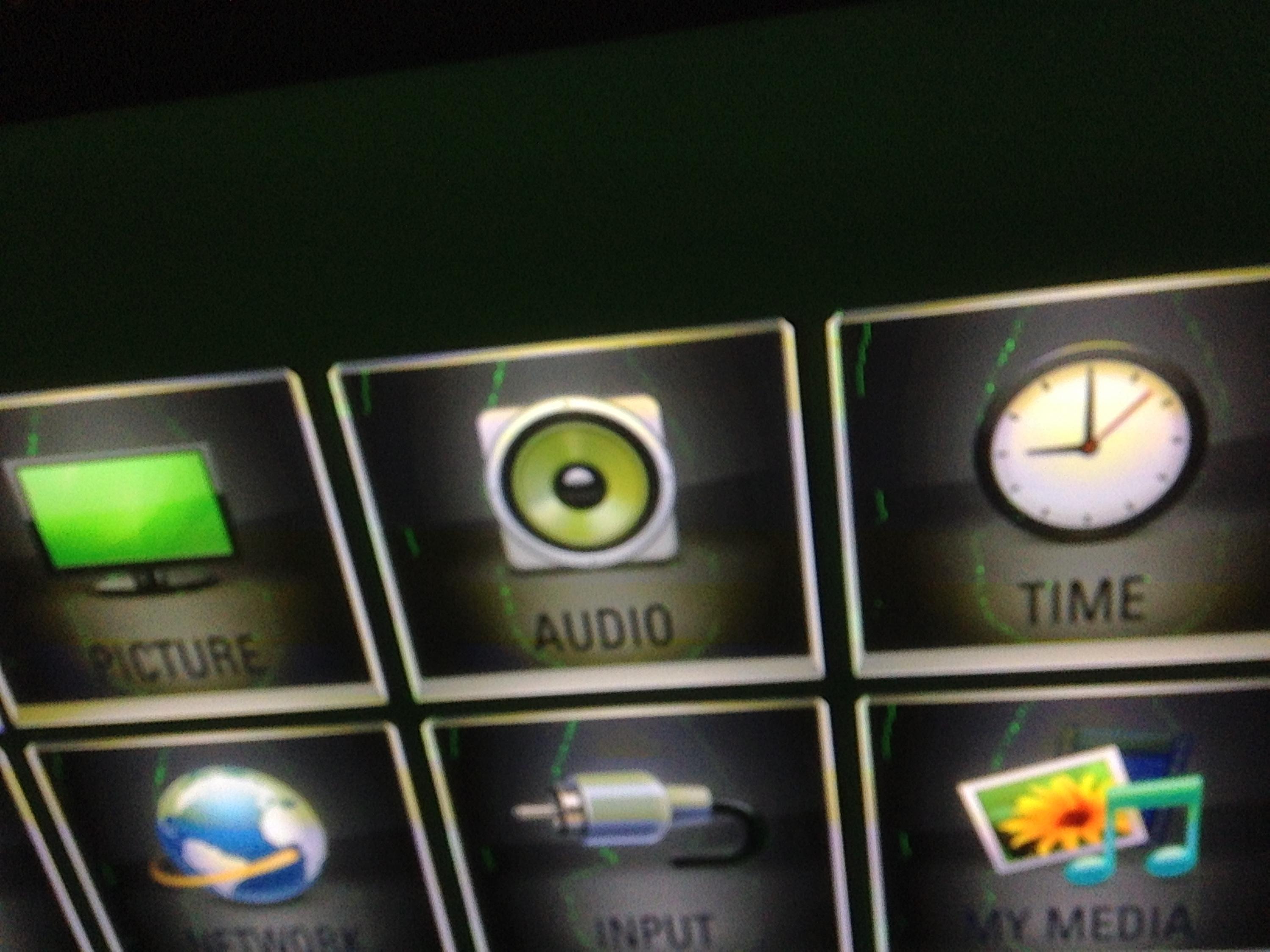

    I got my hands on a replacement board with the same ETB number. The tv turns on as it supposed to - but with a green background . Please see attached photos.
    When I press settings there is also a hint of green.
    Has anyone come across this- any help would be appreciated?
    the voltages were all within a volt
    (I cant run the test patterns becauseit doesnt seem to have ext autogen on the tcon)

    Re: 50pk590 working but in green
    Mainboard not the right one for that panel.
      Is there any way of tweaking it in the hidden menus - or is it just not worth the hassle?
      But when I run the options after orbiter (used to get of rid screen burn) the display is as it should be.
      Thanks for the response
      or tweaking the set up and set down etc?
        It does , you just don't know because it's not labelled.
        Join the 2 pads R51,R52, that's the autogen

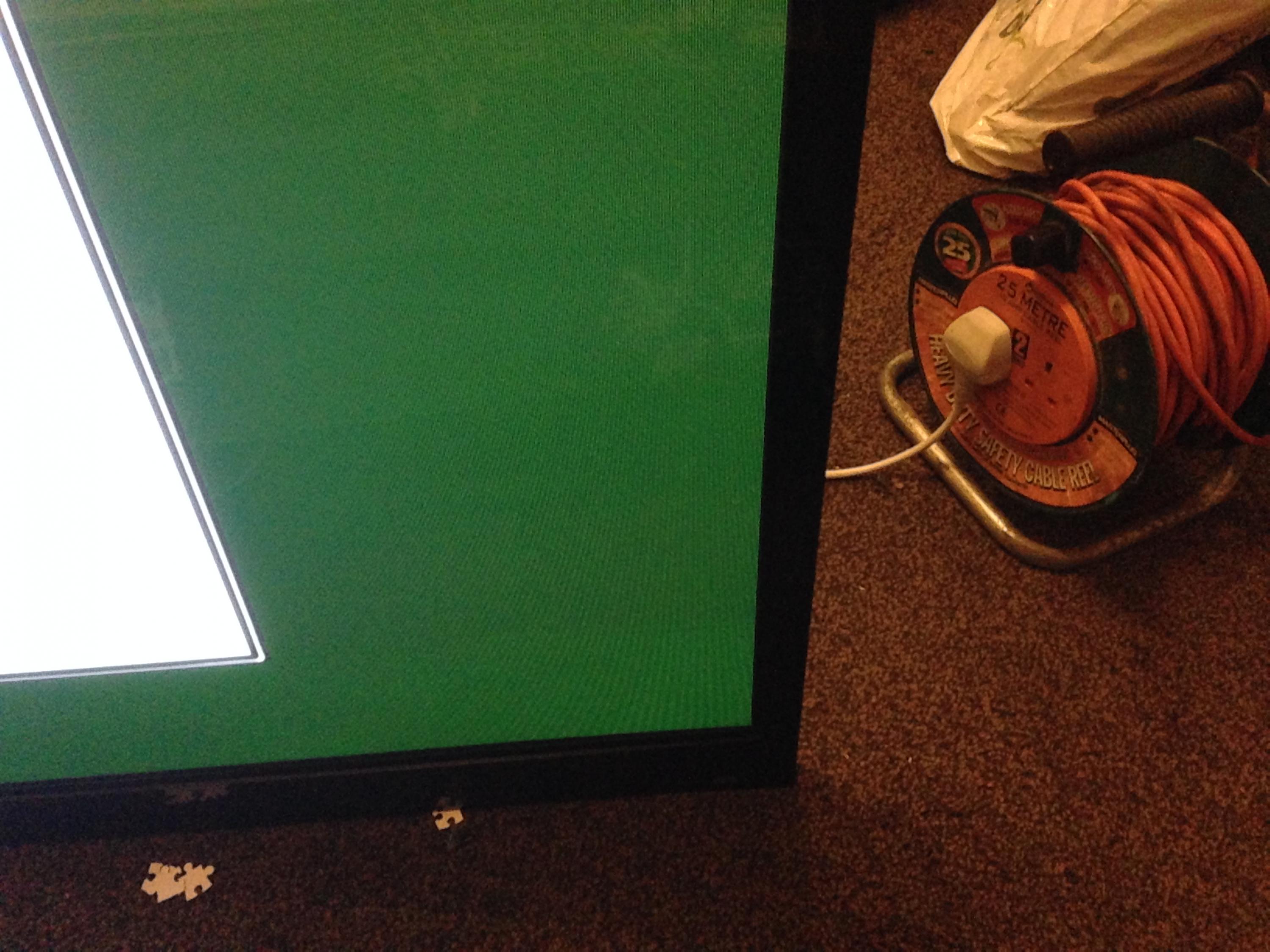

                Thanks for the info
                But strange thing is I decided to play the games that are built into the set and a couple of minutes later the green actually disappeared.
                It started to act like a normal tv. But then when I turned it on and off the green was back again and then it turned to black, what I mean normal no green.
                    I switched the tv on today and theres no green screen. (display menus are fine).
                    However I've still got a little green tint around the lg logo cube. I'm also getting a green flicker around images on a dark screen.
                    I then reseated the Tcon to main board ribbon several time nothing changed.
                    I've changed the Y sus still no change.
                    Shall I reseat the buffer ribbons etc? Any ideas would be appreciared.
                      Try pressing on the mainboard, its not the buffers it will be a Mb issue IMO.
                        I changed the Tcon board and its fine.
                        The Tcon board replacement came with the replacement MB board. ( All from a donar 50pk590)
                        Is that normal?-EAX numbers were different on the main boards, But EBT numbers were the same.
                        But tvs fine now thanks for the help
                        • ReeceyBurger123
                          Never Give Up !
                          • May 2014
                          • 7325
                          • Britain
                          Must be a Bga solder issue on the Mb very common on that chassis. Keep us updated on what happens
