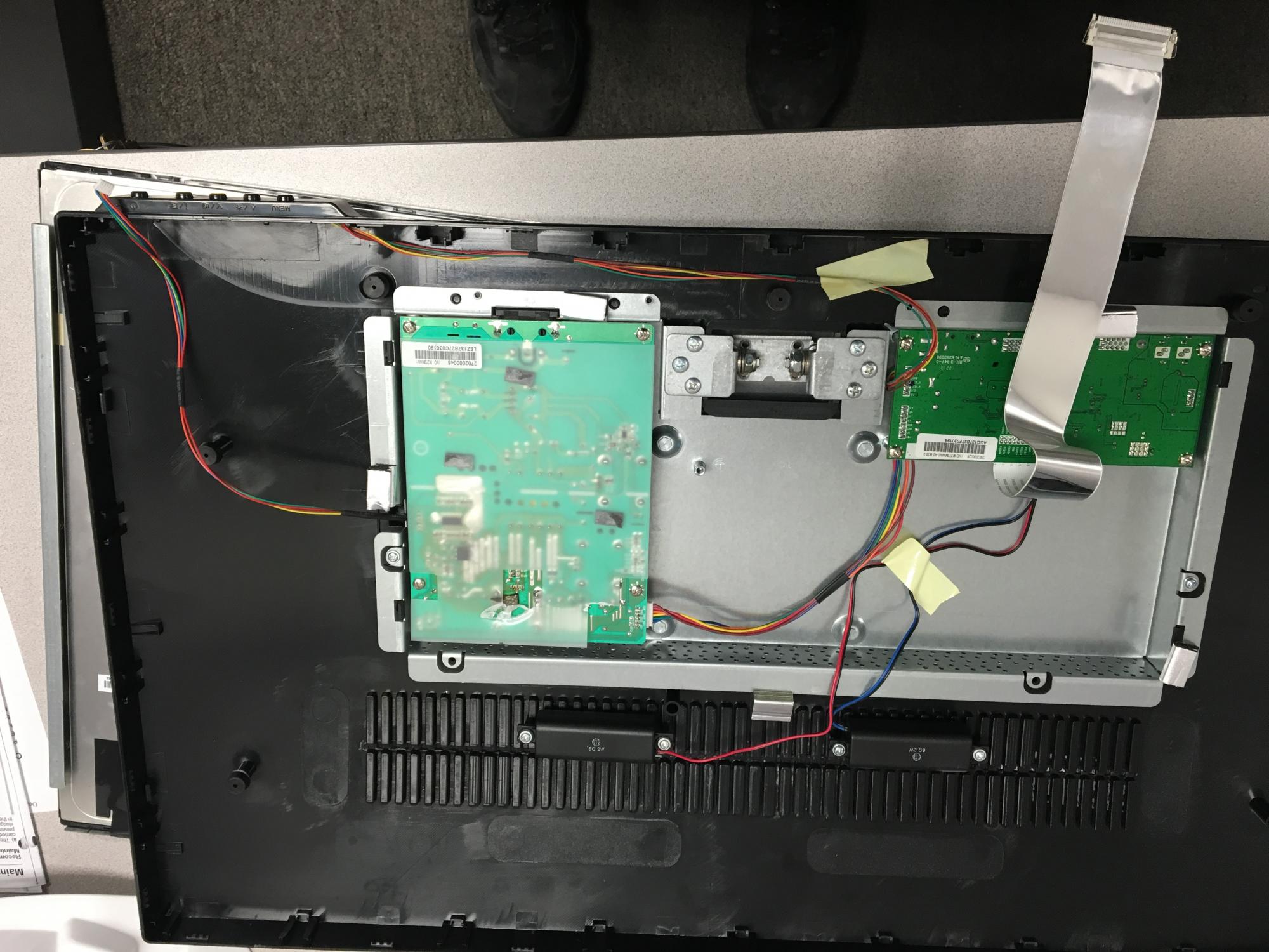

                    #29
                    Re: Cross reference for B90N08
                    Here is the picture of how the boards and panel are connected

                      1. "Do you have a picture of the back of the set with all the boards to see the interconnections"
                      Photo's please
                      2. You could try taking ENA to +5V using a 1K resistor and see if the leds light up or at least check the voltages going to them.
                      Have you tried this and what was the result.
                      3. Since it's a monitor it may not have ENA voltage unless it's plugged into a source but I'm not certain. Probably needs the ENA to switch on the OZxxxx chip to power the leds.
                      Is this a PC monitor and does ENA go to 5V when connected to the PC.
                      • ned1

                          #32
                          Sorry I missed that. There are cables at the top of the photo running to the right and off the photo and also cables at the bottom of the screen that go off to the unknown.
                          Edit
                          I'm trying to work out how everything is connected.

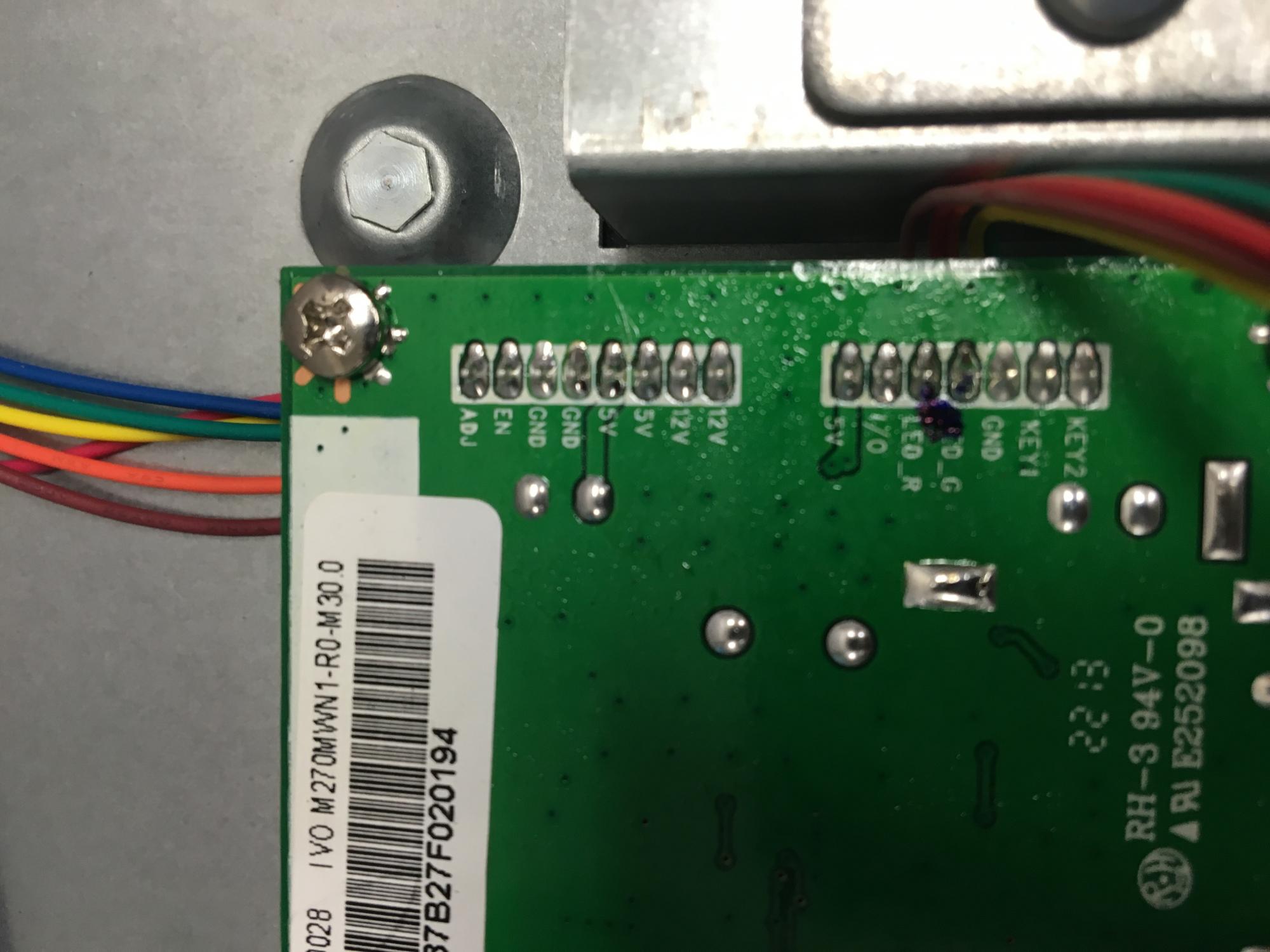

                              #34
                              Main board connection

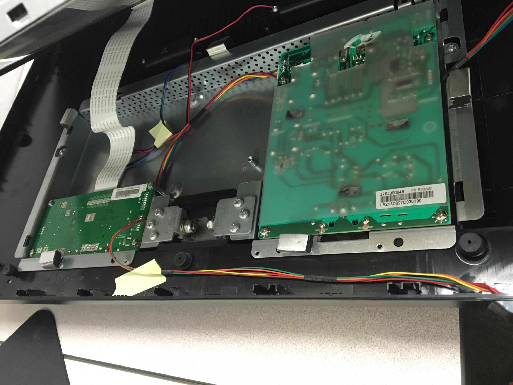

                                #35
                                Hope this helps
                                  It looks like the RED/YELLOW/GREEN/BROWN/??? wires bundle is for the LED BACKLIGHTS but not 100 % sure since we cannot see the whole LCD panel.
                                  When you force on the ENA pin, the connection going back to the LOGIC/MAIN board has to be disconnected otherwise the ENA line will be kept LOW by the LOGIC/MAIN board.
                                  The resistor can be anything between 470~1000 Ohms.
                                  It looks like it has 4 strings of LEDs.
