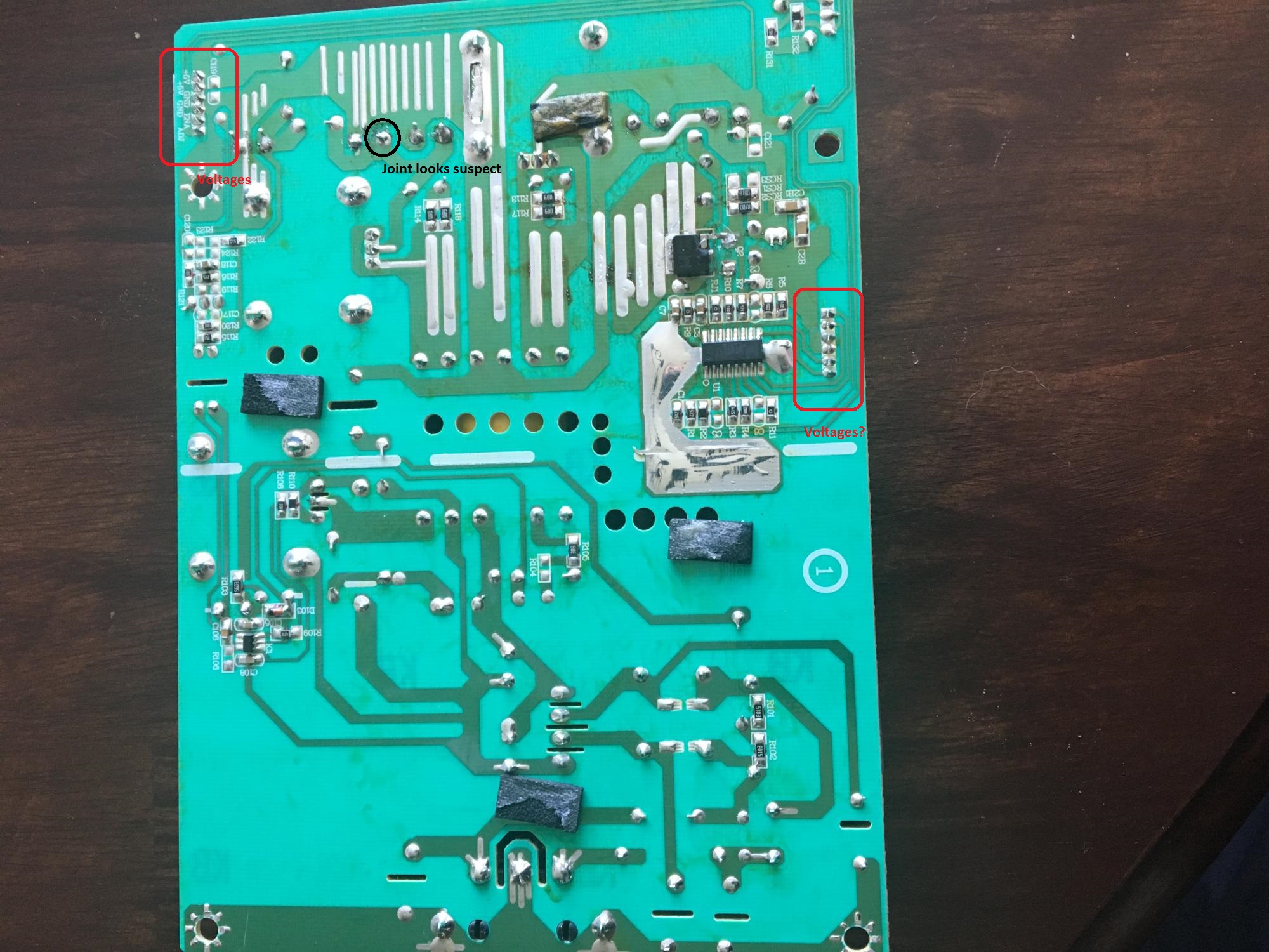

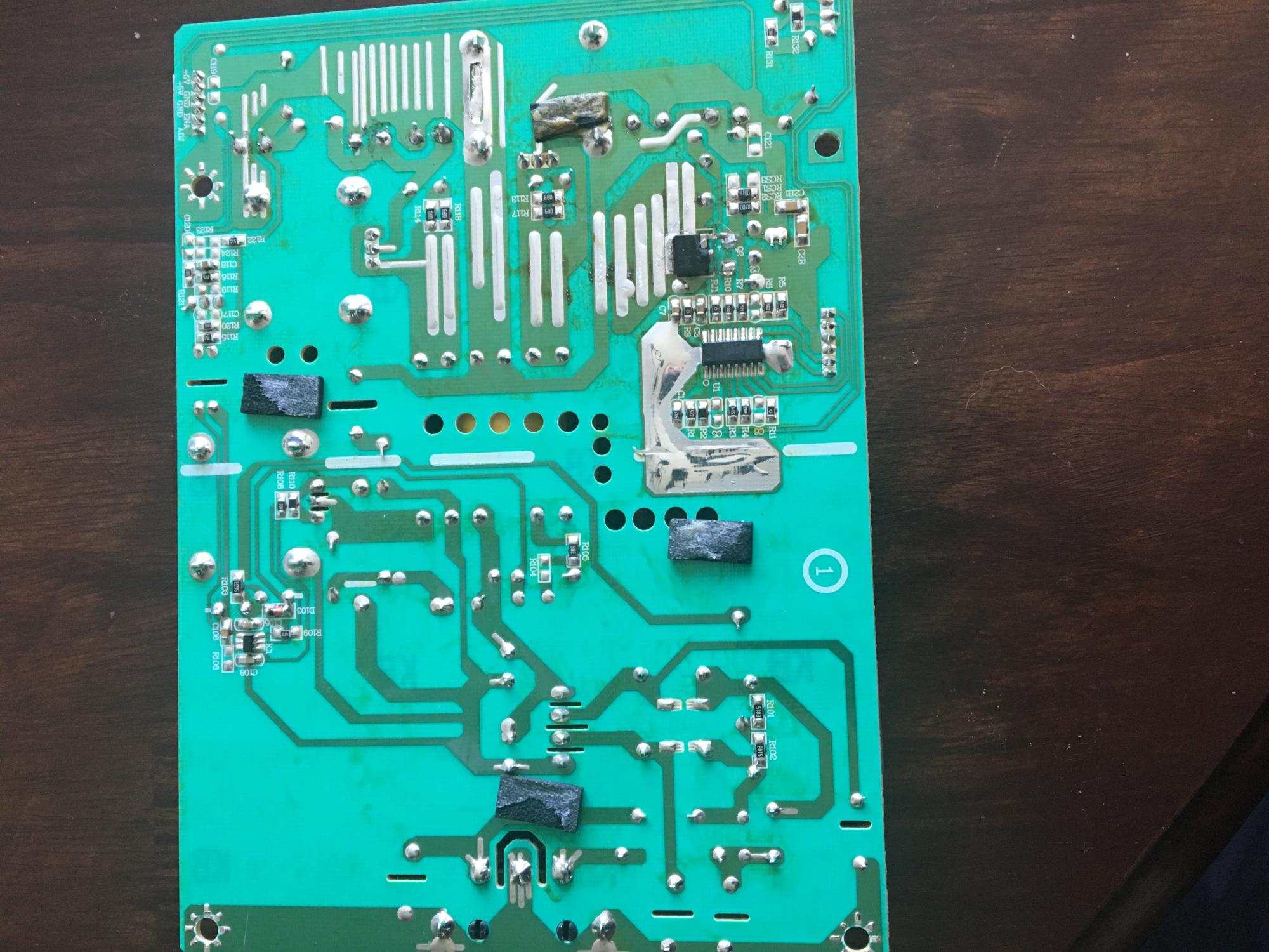

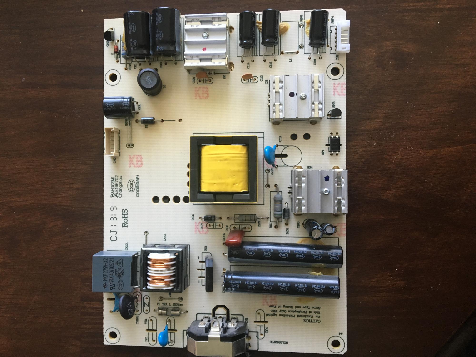

          Re: Cross reference for B90N08
          Here is the picture
          • ned1
            • Feb 2014
            • 139
            • usa
            I put the diode back for reference of placement on board. You can see damage from removal.
                Yeah... I can see it. Q2 you are talking about. That's a Mosfet. Trick is to preheat that board first, or having a sodering iron with some "Ooomph".
                        • ned1
                          • Feb 2014
                          • 139
                          • usa
                          So should I follow dick Barton recommendation or I need different one?
                                The marking on U1 Is OB3362HP
                                • ned1
                                  • Feb 2014
                                  • 139
                                  • usa
                                  Received FDD3570-ND and installed. Getting green light on the monitor power button indicator, but still no picture. Any more suggestions.
                                        with board removed and plugged to 120V I am getting 5V to both 5V pins to ground in and no voltages on ENA or ADJ pins to ground.
