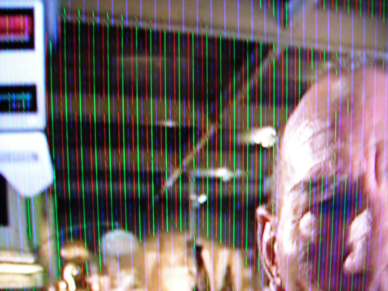

    This 26" TV show equidistant vertical abnormal lines. These are not solid pixel lines, but its intensity varies depending on image content. The pattern is as follows:
    1 red abnormal subpixel, 4 normal pixels, 1 green abnormal subpixel, 4 normal pixels, 1 blue abnormal subpixel, 5 normal pixels. Repeat.
    Panel is a ChiMei V260B3-L04.
    I've checked and reseated LVDS cable, no changes.
    This looks like a panel failure, doesn't it? No detachable T-CON in this case.

    This looks like a Main Board issue to me....or it could also be a bad LVDS cable....I would however tend towards the Main Board.

      Thanks for your comment. I have record of another 26AV733G repair, 4 years ago. It was the LVDS cable, but the symptom was different, it had posterized colors. I’ll check it more carefully, since it’ll be difficult to find a replacement now.

        Seems to me like panel tab bond issue which is very common for this panel. Remove the panel frame and press on the tab bonds see if it has any effect.

          I’ve been able to try another MAIN board and the issue is still there. So it’s LVDS cable or panel. I don’t think it’s cable because after checking panel datasheet, I can’t see how can a bad wire produce this effect.
          If I have time I’ll try to check tab bonds and report back.

              No luck. I’ve touched all 6 tab bonds and no changes. I’ve heated all ICs (not too many), no changes. I’m gonna give up with this one, as it’s clearly a driver failure and this one doesn’t have detachable T-CON.
              The effect matches the first picture from page 43, Sony T-CON troubleshooting manual, "MULTIPLE EVENLY SPACED [vertical] LINES NOT AFFECTED BY PICTURE ZOOMING".

                Hmm have you an image of the Tcon buddy ? It could be the flat flex wires that are bonded to it and the panel.

                  That's what we call Tab Bonds and that's what I've touched looking for changes in lines, to no avail. Its "T-CON" is a long PCB on top side of panel. One LVDS connector at one side and 6 tab bonds to the LCD glass. A CM2652A controller IC, a Texas TPS65161 and 3-4 smaller ICs.
                  I've already reassembled and closed it.
