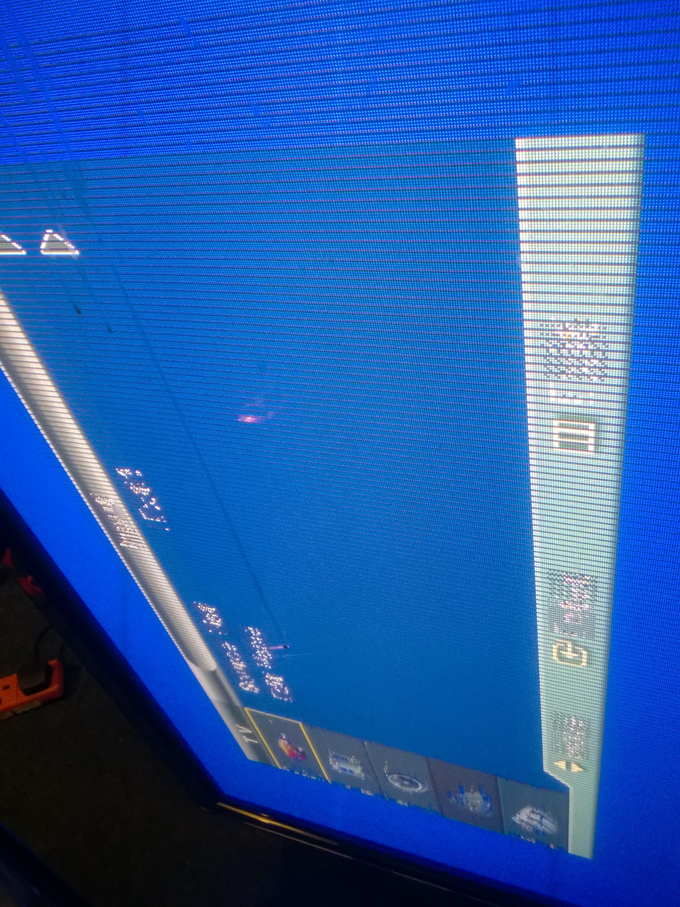

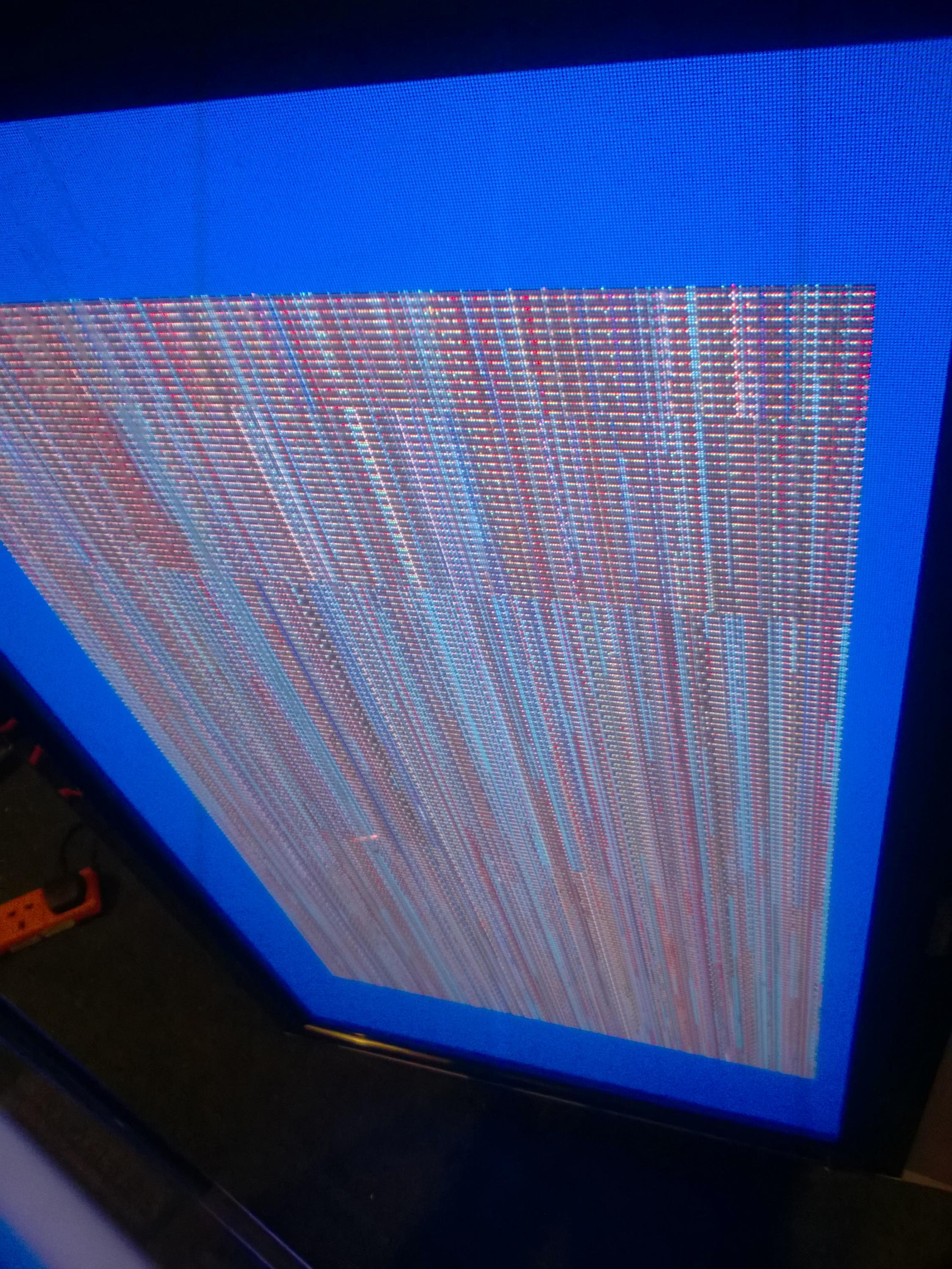

    Hello guys and gals,
    I got this tv recently, its a heavy monster! Issue is multicoloured lines on screen and general corrupted image.
    Everthing inside looks good, TV powers on without fail but still the screen corruption issue. I was the guide below to perform the self test function built in to some plasma panels.
    https://www.badcaps.net/forum/showthread.php?p=318461
    I didn't get anything on screen after jumpering pins 3-4 and disconnecting LVDS cable.
    I noticed that if I gently moved the LVDS cable in to a certain position when the TV was on all the corruption disappeared and screen displayed perfectly.
    I've inspected the LVDS cable connectors on the main board and the control board they look good. The LVDS cable doesn't have any visible damage but the lightest movement makes the corruption come back.
    If I counted correctly its a 32pin LVDS cable, very short in length approx 3-4"
    Are these generic parts, how can I go about finding a replacement to test with?

            Tested cable, good connectivity on all pins. The lines on screen still change/disappear when flexing the mainboard.
            Could be a cold solder joint, does anyone have previous experience with an issue like this
            I've attached images of what the screen displays. Whenever the mainboard is moved or has vibration the lines change.
