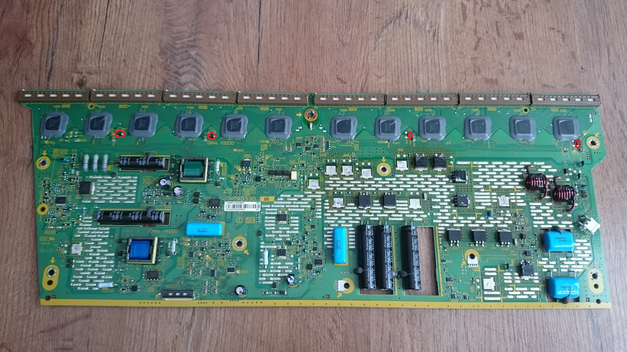

    I have this board (tnpa5330) from a p42gt30 and it's broken. it has the usual 30f131x3 and rjp30x3 blown. now... I am out of stock on rjp30, and have only 2 or 3 original 30f131, and I am wondering if I can use some DG301 or DG302 instead of them? Did someone else tried this? I know they are used (DG301) on tnpa5351 board, in 46g30 and 50g30 TV.

    Hope fully your 30F131 are good and not the bad chinese ones but the DG301 appears to be 330V 40A 250a pulse max, The RJP30H2 is 360V 35A.
    30F131 360V 30A, 200A pulsed.
    I'd give them a go.
    At the moment I'm using IRG7S313U which are obsolete but also 330v 40A on a 5349 in place of the 30F131 and they appear ok

      Then I'll give them a go, and I hope the'll do the job. my 30f131 are all originals, also dg301 and dg302. I know this because I have them from a panasonic service. I'll share a picture when I'll get home.
      On the other hand, I found here at a local supplyer fgd4536 - 21 pcs at 1.75 euros/pc...

            yes, bad power supply also. I found only 2 R6015 blown, and I have to find them too. do you have an ideea on some replacements? I have here some 12N50 if I'm not wrong, but I'm not sure the'll do the job.
            Do you think it may be something else blown on the power board? On a first check I found only these two R6015...
            Interesting thing with this TV, because I took it with "doing nothing" and no power led, hoping it is the A board (have one spare), and when I received it, it turned out to be a 7 blinker... this is it now...
            Anyway, I have to order some transistors, but the delivery time is about 7 days or more...

              yessss it's a fix! with 12N50 in the supply and dg301 instead of rjp30 on SN board, and it's working perfect! 18 hours until now and it's ok. so my last 3pcs 30f131 were ok...
              but now I am afraid to order again, so I think I'll go for the fgd4536 from now on.
