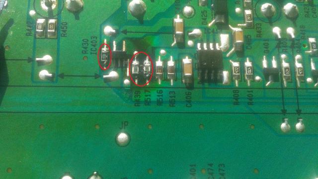

            I have the same LG TV model, there is no audio only video, after reviewing the Y board, I noticed that the resistors on the SMD surface are burned, also the transistors FGPF4633, someone that could tell me the values of these resistors circulated in red.
            • andariego
              • Mar 2011
              • 20
              Re: LG 60PV450-UA.AUSLLHR, repeat YSUS failure
              no one? Thanks
              • slidewire
                • Feb 2011
                • 10
                They're 10 OHMS.
