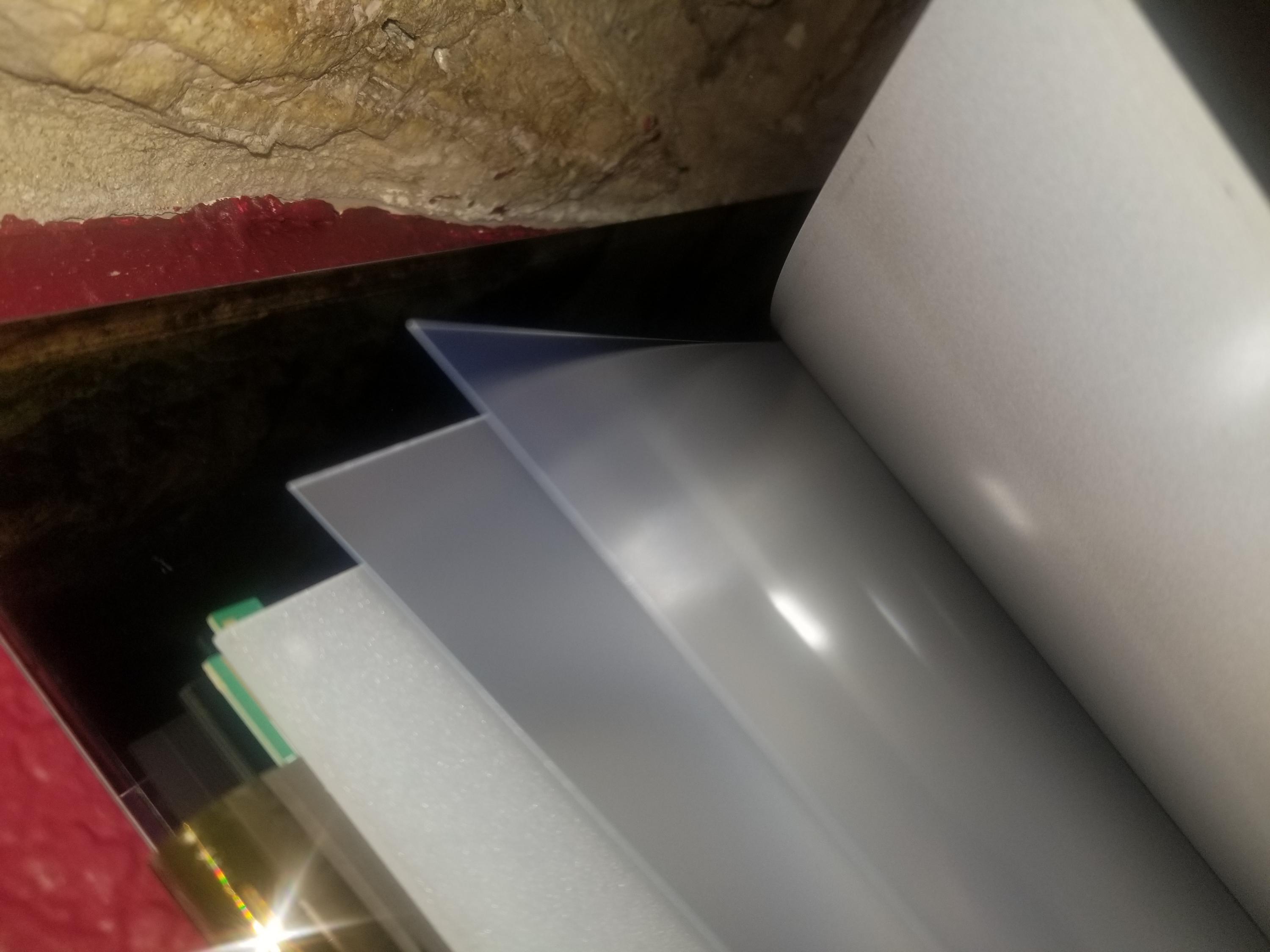

                  Here's the order.
                  The 2 clear sheets in the middle could be reversed which would cause the problem.
                  The LCD panel in that pic is on the opposite side thou. The sheet nearest the LCD panel in that pic should be the one right above the backlights then consecutively inline with my picture.

                    Thank you for the replies. There seem to be 2 similar "shiny" sheets that go in between the hard plastic and the top sheet. They have different sized tabs on the side with one being wider and the other being the same width as the tab of the top sheet. Does it matter what order these go in? Right now, I have the hard plastic on top of the LEDs with bumpy side facing up, then the shiny with the wider side tab, followed by the shiny with the skinnier side tab and lastly, the non-shiny sheet.

                      I'll look again tonight since the LG I'm working on is still apart for LED repairs.
