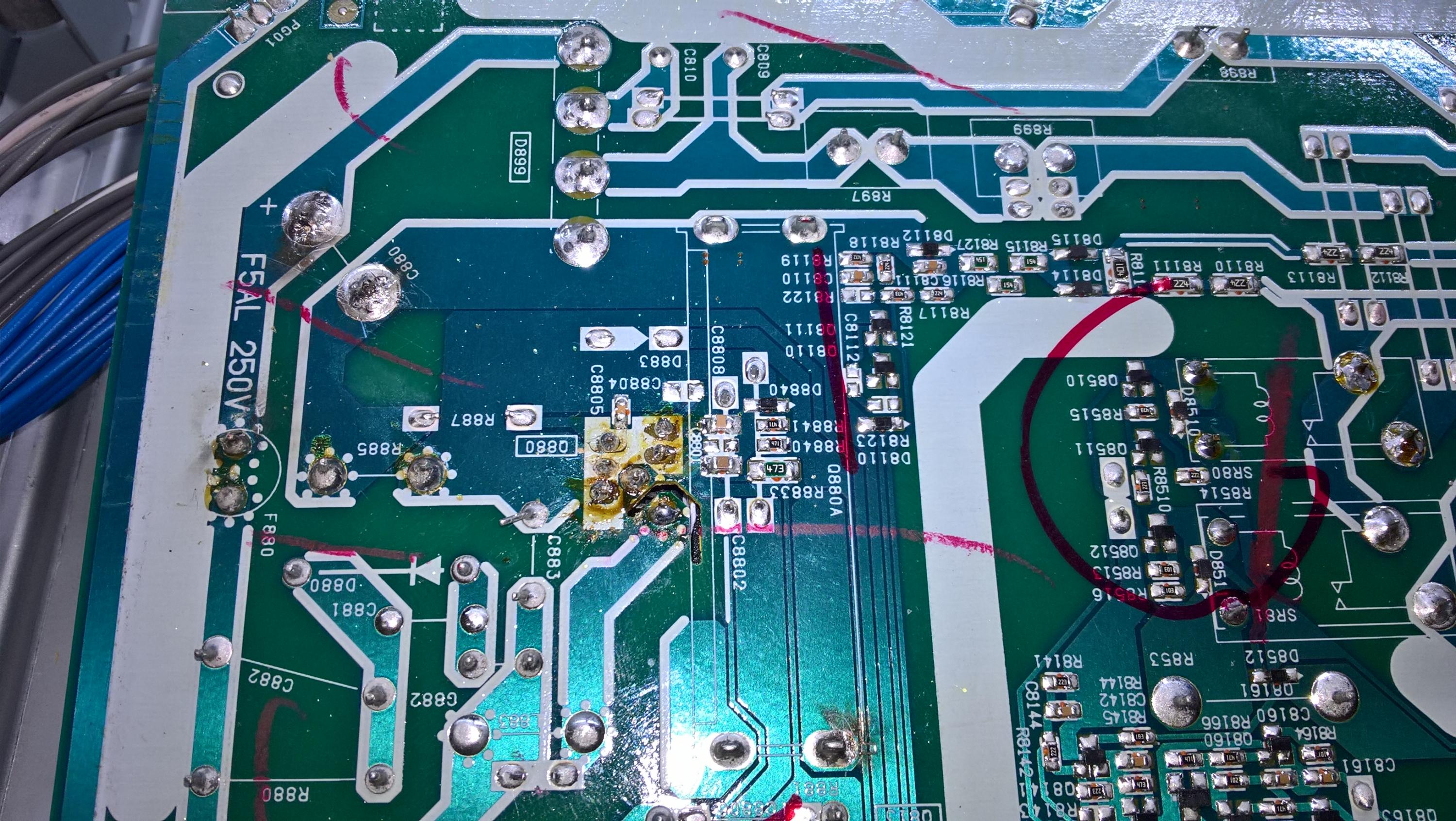

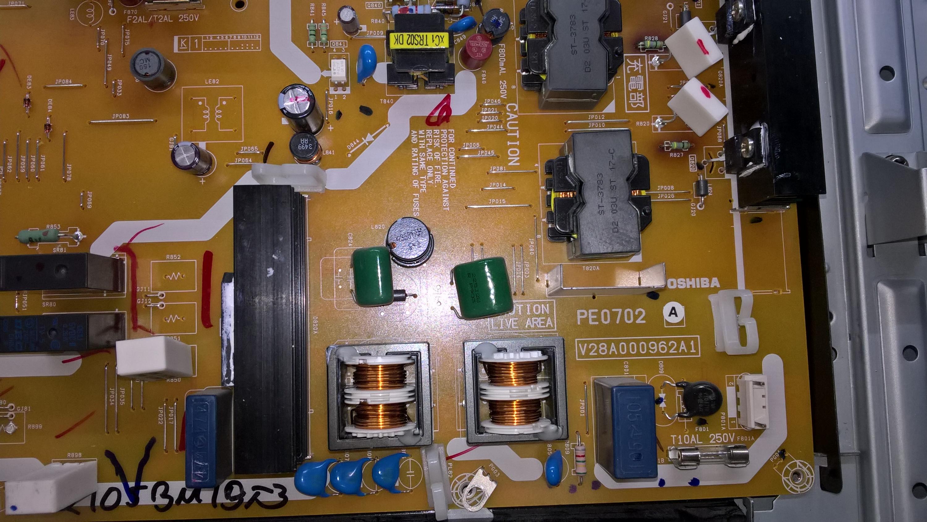

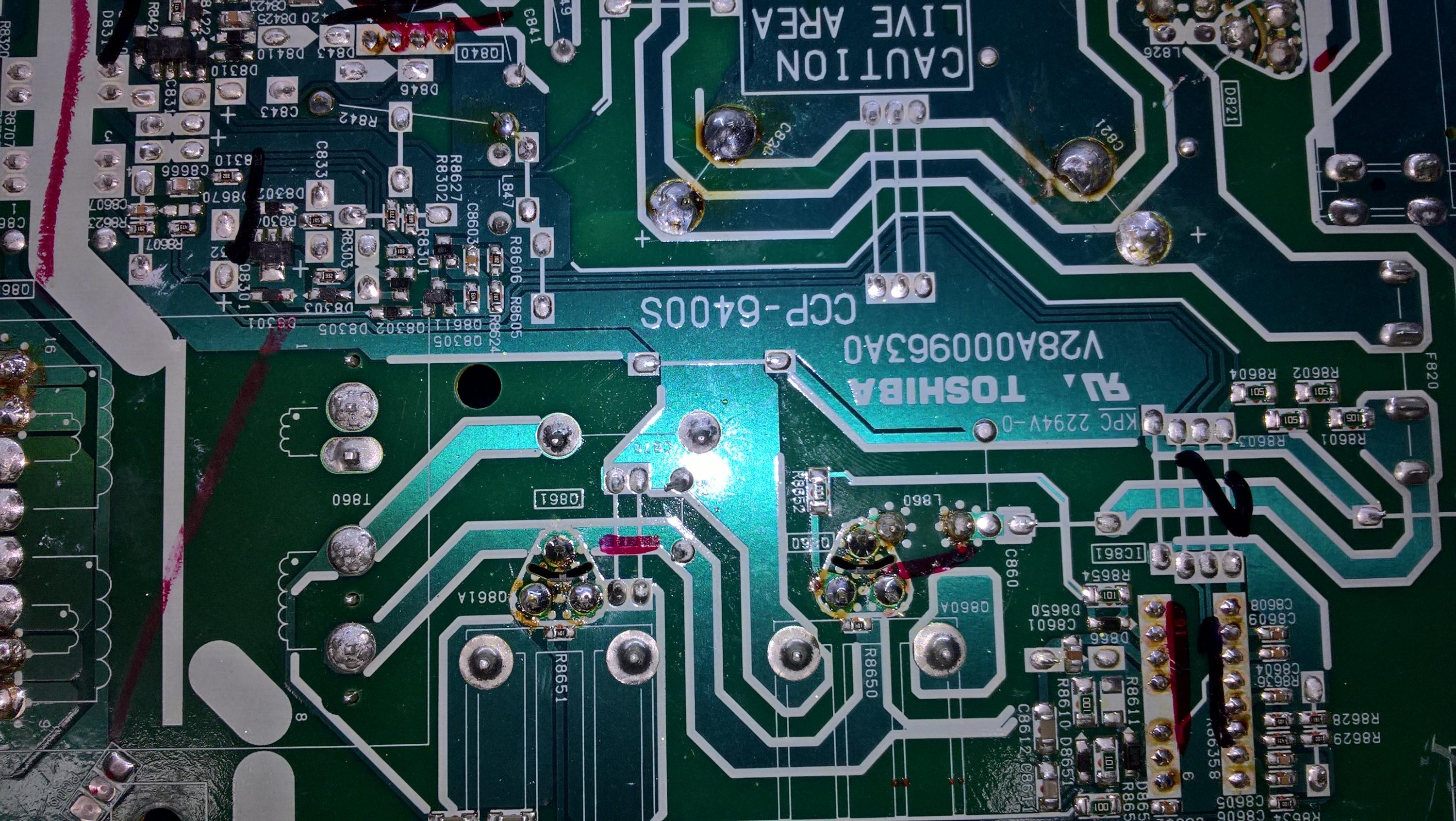

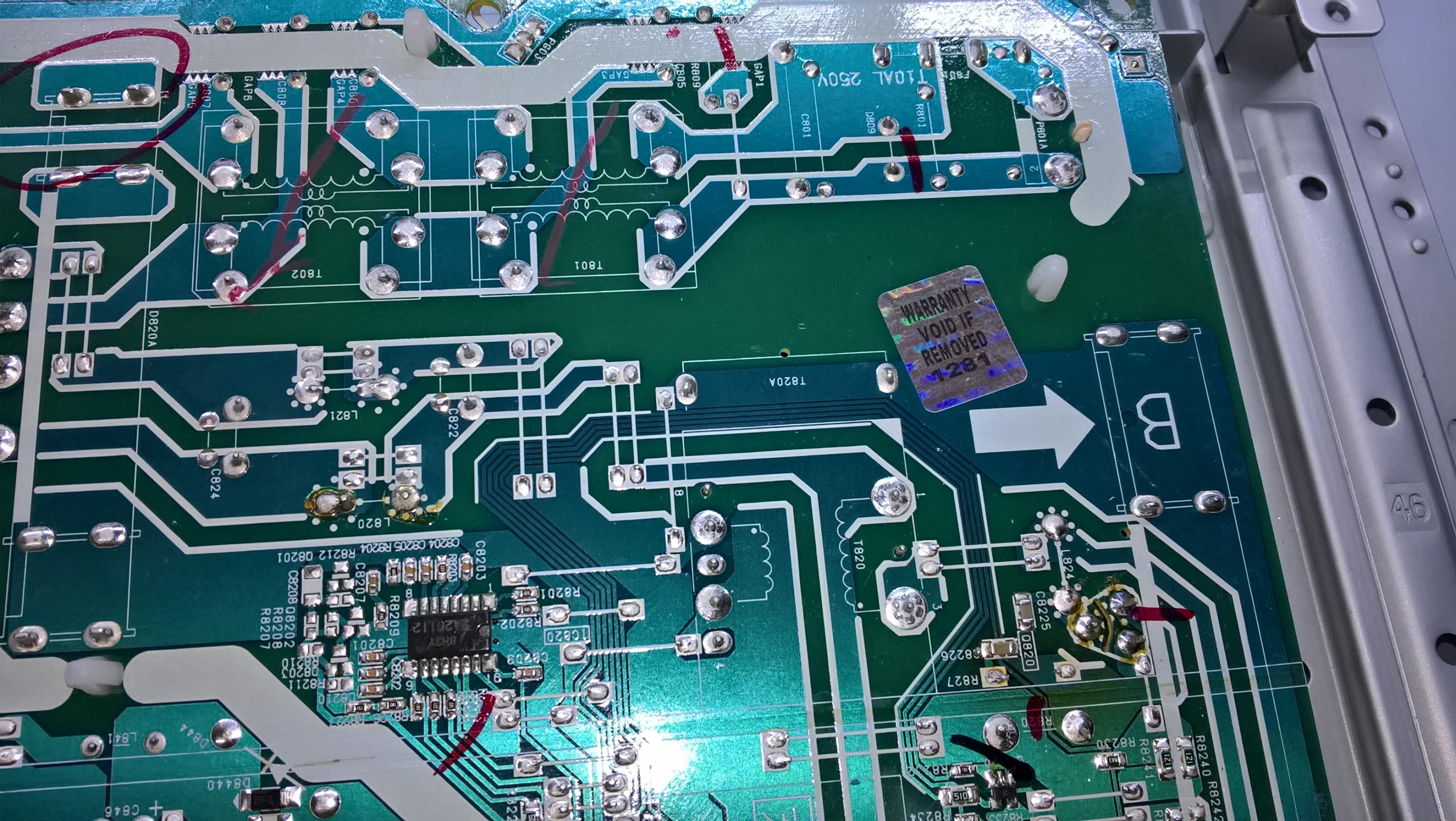

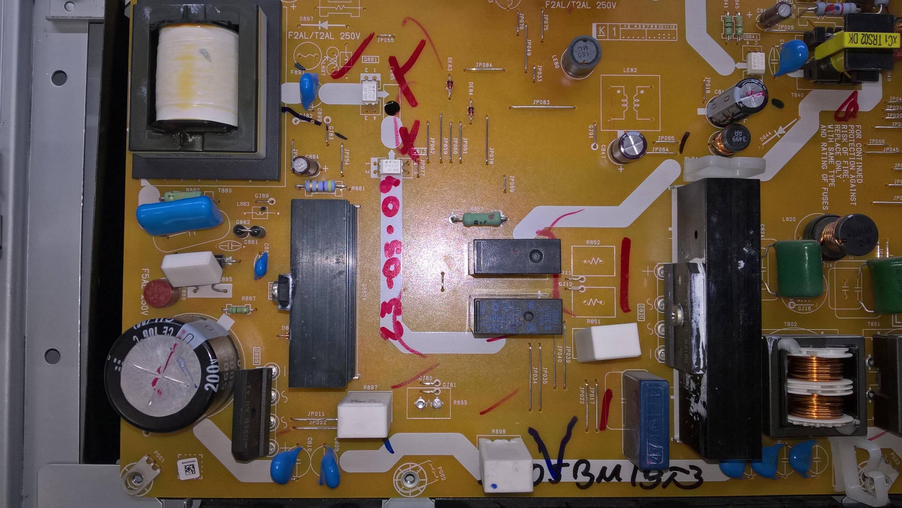

    TV: Toshiba 46XV645U

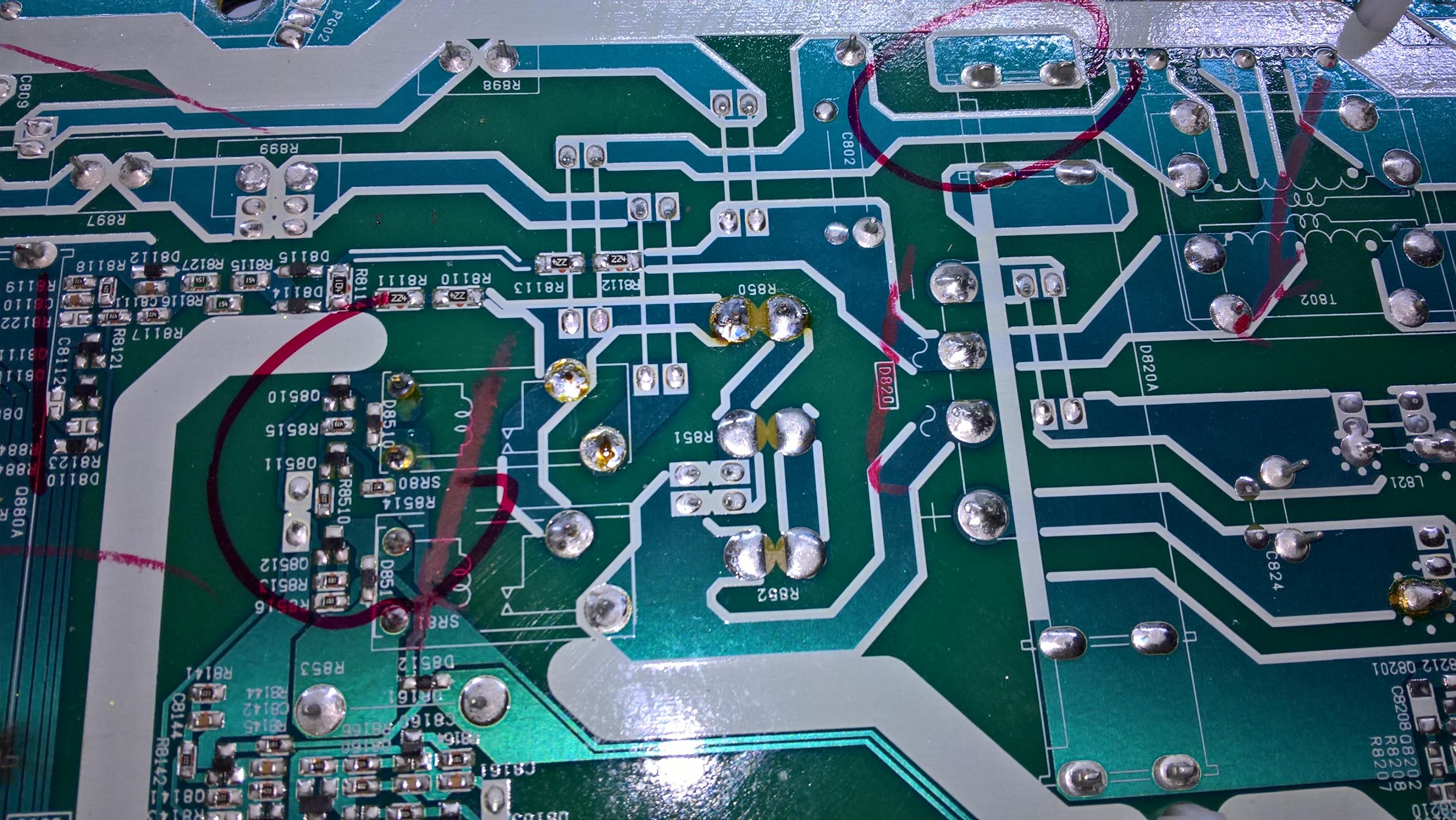

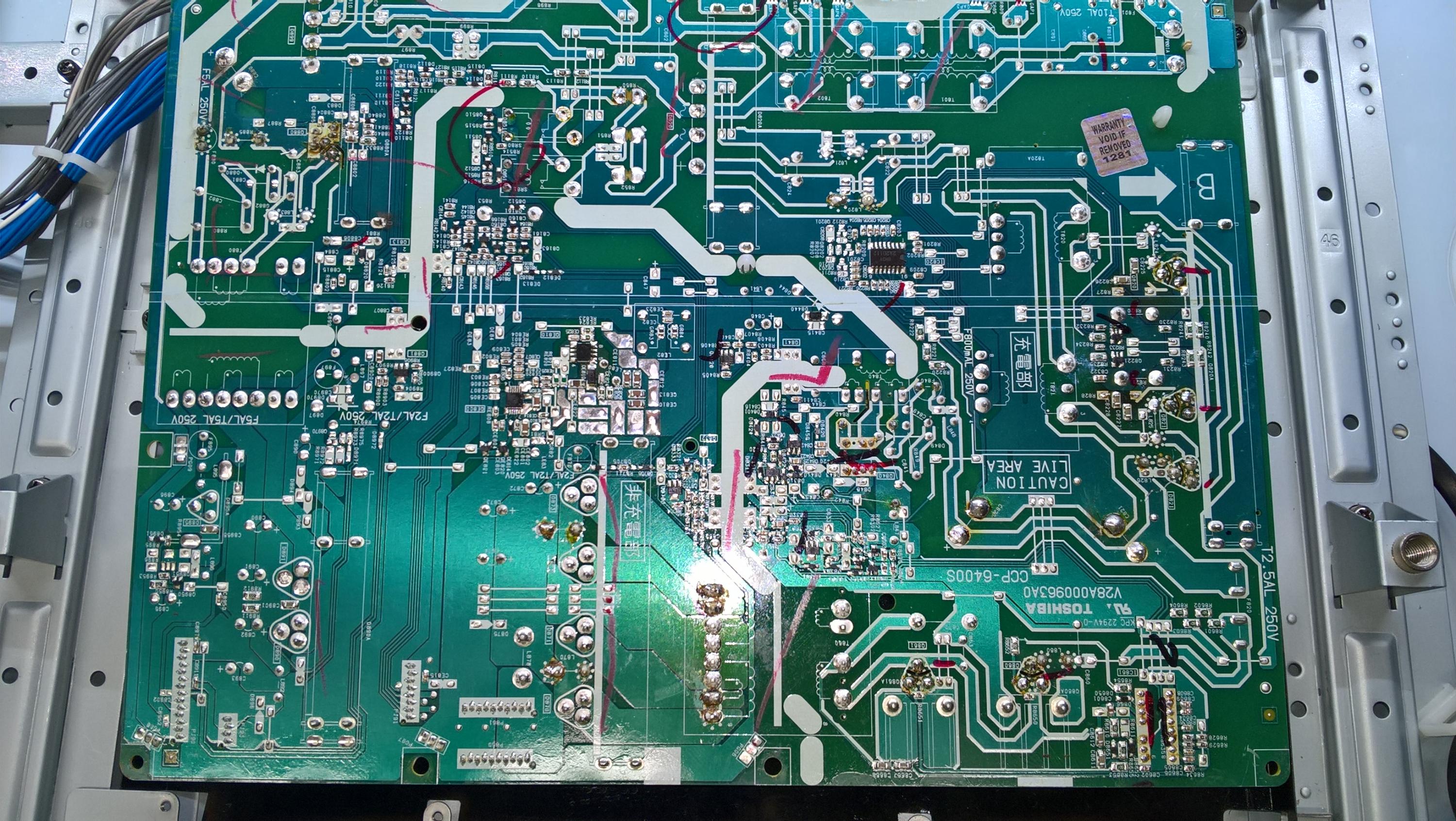

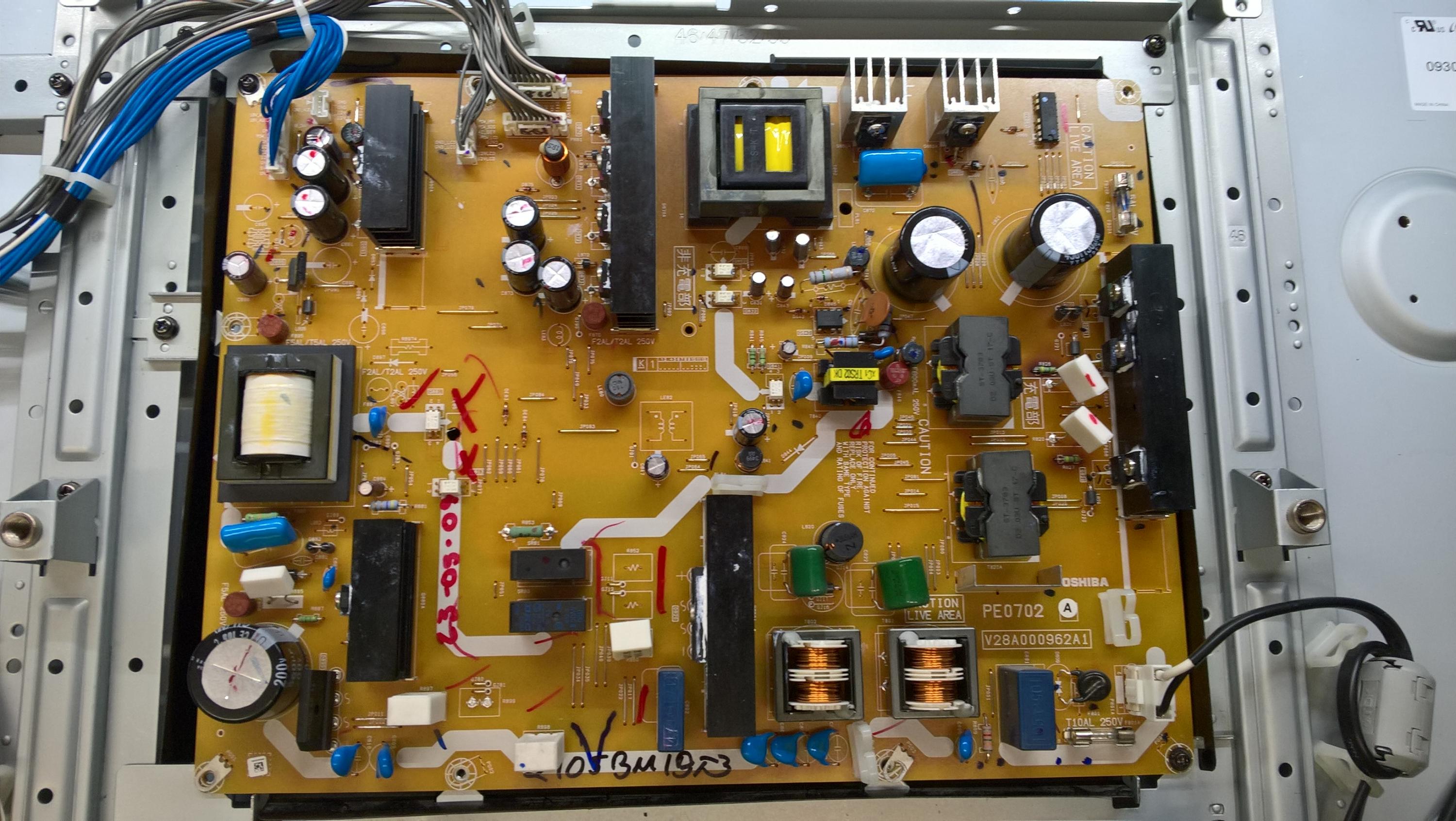

    PSU: PE0702A, V28A000962A1 (purchased used, appeared to been have been previously repaired and lasted 2 years)
    Issues & History:
    - No Power, No Click, No 5V: Tested and found Fuse R851 Open. Replaced R851 and Voltage regulator Q880. A well documented problem and it did bring back some life back to the board because after plugging, the relay engaged and I got 5V but still no 12 or 24V. No red light, nothing happens when power button is pressed.
    - Confused, I obtained a repair kit which replaced a bunch of components. I also replaced the capacitors at c820, c821 as they seemed slightly bulged. End Result: No Difference - same issue.
    Current State: I get 5V. I hear the relay engage. I do not get 12v. I do not get 24V. I do not see a red light. I press power button and nothing happens.
    Pictures provided
    Ideas? Where have I failed?

    Re: PE0702A, V28A000962A1 (5V Yes, 12V/24V NO)
    What voltage do you have on power on pin (P_On, Power ON/OFF) when you come out of standby?

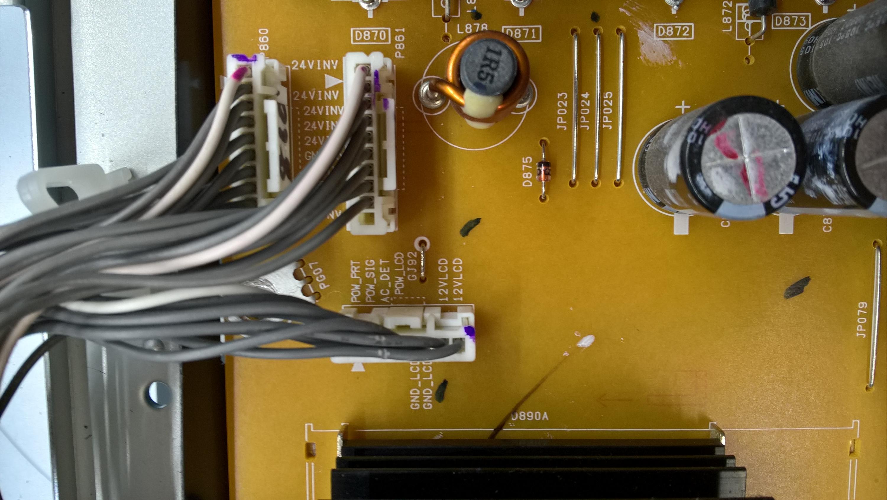

      The Voltage I get 3.04V on POW_PRT and 5.5V on POW_SIG , Nothing on POW_TV, 15V AC_DET
      • dick_barton
        • Aug 2015
        • 6643
        • Wales
        So you have the following:-
        Pow_Prt 3.04V
        Pow_Sig 5.5V
        Pow_TV 0.0V
        AC_Det 15.0V
        I'm not 100% certain but it looks as though Pow_Prot may be holding the power supply off and not giving the Pow_TV voltage out.
        With the TV powered up what voltage do you have across the two pins of the large capacitors C821 and the one along side it.
        If you disconnect the power supply from the mainboard and switch on what voltages do you have at the output pins of the power supply.
        Have you searched for a schematic for the power supply which would be helpfull.

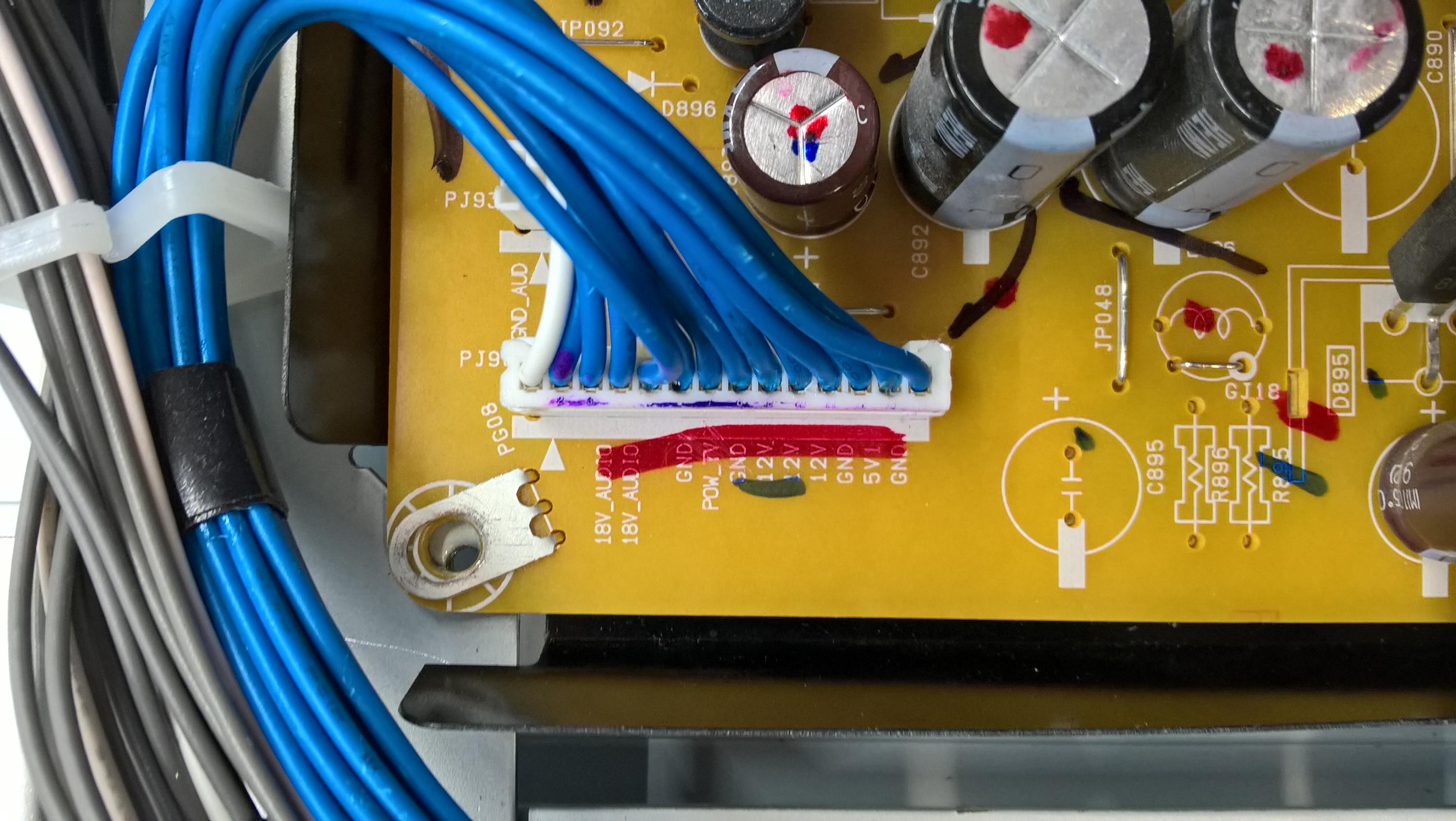

                Updated readings - AC_DET was indeed an misread in my previous post. It records 0 (or .01 to be exact).
                The only readings are
                CN90
                POW_TV 3.31
                Pin 13 (5V1) 5.06
                CN91
                POW_PRT 3.04
                AC_DET .01
                The rest are 0 with no changes noted regardless of whether the power button is pressed for any duration.

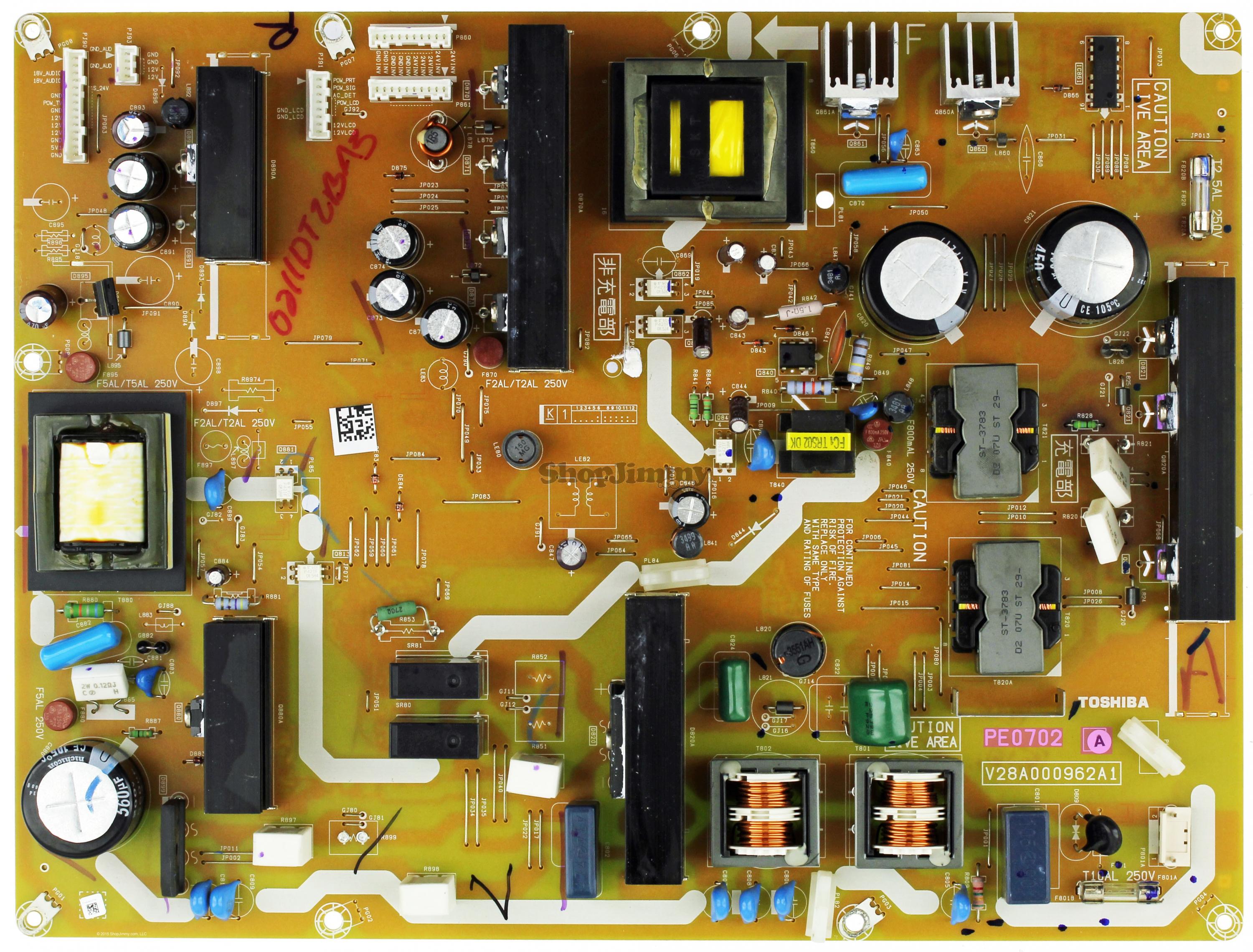

                  BTW, do you mean R850 the current limiter resistor, not R851 which is not installed. That R850 will go open circuit if the bypass relay SR81 has bad contacts so the resistor is not bypassed when the TV is in full power mode, common failure.
                  So the POW_SIG (PS-ON) is not present?
                  The 'AC_DET .01' should be more than 3VDC for OK, if it is low then it will lock out the PS-ON signal.
                  Pictures provided by SHOPJIMMY.
                  Toshiba 75014973 (PE0702A, V28A000962A1) Power Supply Unit.
                  http://www.shopjimmy.com/toshiba-750...pply-unit.htm#
                  BTW, all the red cylinder fuses are good, right?

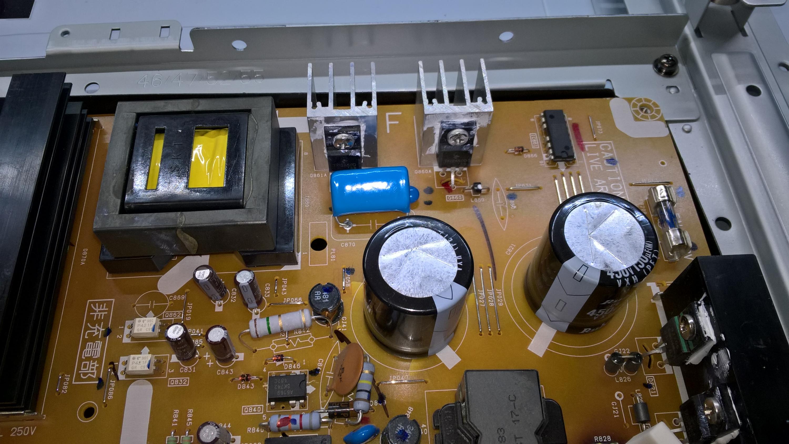

                    Yes, your right R850. That's the fuse that was open and was replaced as well as the voltage regulator at Q880. That brought back some life and the relay SR81 engaged. I also cleaned the relay contacts as part of the initial repair attempt.
                    F895 - I'm getting something odd compared to the other red fuses. My tone is steady on and off, not solid like the other fuses.. Going to investigate after some regular job duties and dinner. Rest of the red fuses are good. i even replaced on from the shopjimmy repair pack.
                    You also correct, POW_SIG (Pin 2, CR91) not present (0 Reading). Yes, an error in my initial post. Readings from post 8 are latest. Apologies for any confusion.
                    • yotsuya
                      • Aug 2015
                      • 20

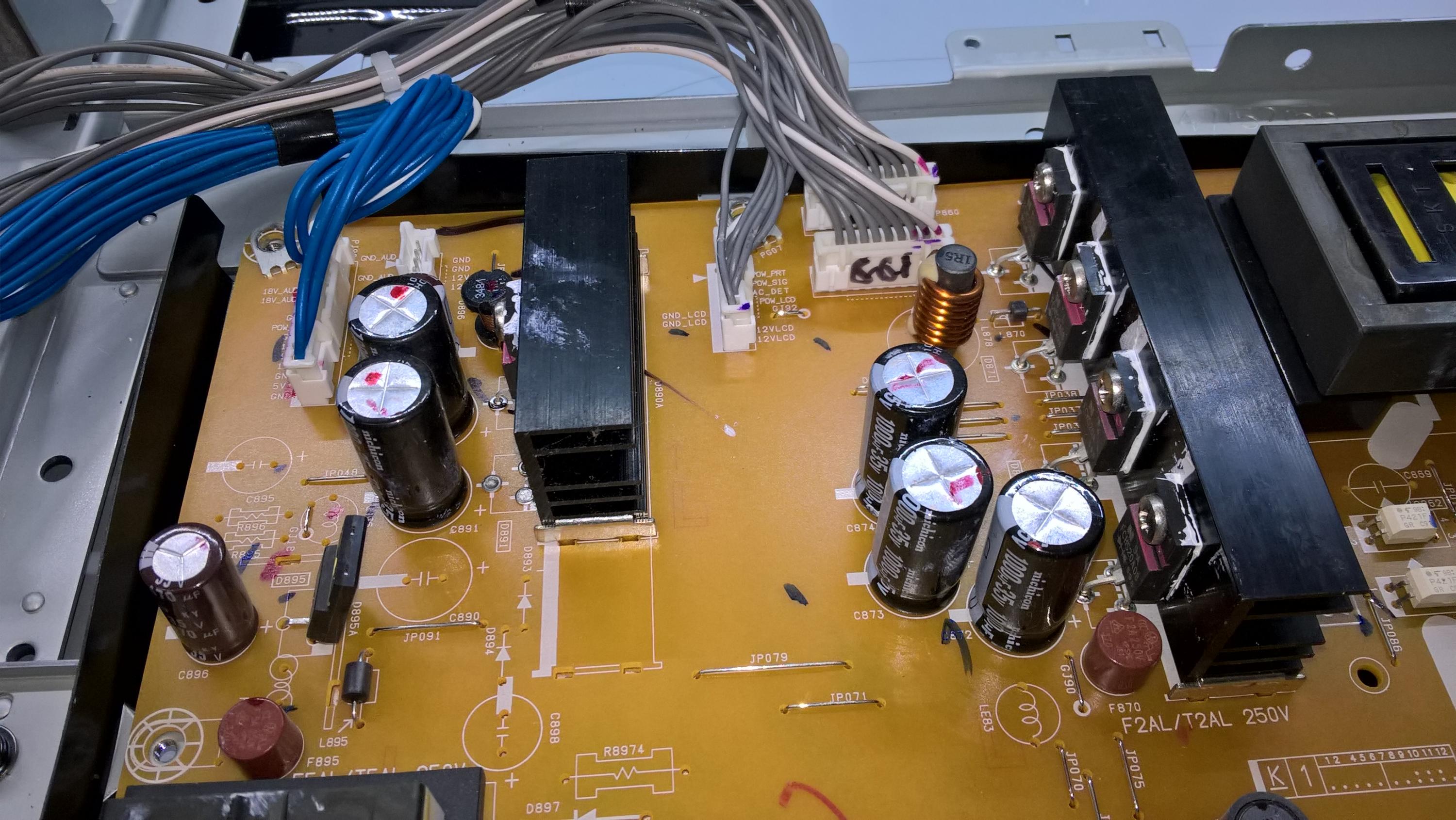

                      Status: Bad Fuse at F895. Going to replace with a Littelfuse Inc. 37015000000
                      The one below seems to match.
                      http://www.digikey.com/scripts/DkSea...62724773549168
                      Make sense? Should I check anything else beside all my other fuses again?
                      • yotsuya
                        • Aug 2015
                        • 20
                        Well, I'm stumped.
                        I replaced the bad fuse at F895 and now I get AC_DET 3.2, POW_TV 3.31, 5V1 is 5.06 and POW_PRT 3.04. The rest is 0 regardless of power button depressed states.
                        CN90
                        1 GND GND
                        2 GND GND
                        3 18V_Audio w/load 0
                        4 18V_Audio w/load 0
                        5 5_24V w/load 0
                        6 GND GND
                        7 POW_TV 3.31
                        8 GND GND
                        9 12V w/load 0
                        10 12V w/load 0
                        11 12V w/load 0
                        12 GND GND
                        13 5V1 5.06
                        14 GND GND
                        CN91
                        1 POW_PRT 3.04
                        2 POW_SIG 0
                        3 AC_DET 3.2
                        4 POW-LCD 0
                        5 GND GND
                        6 GND GND
                        7 12V_LCD w/load 0
                        8 12V_LCD w/load 0

                              Hi everyone,
                              I have this exact board... The problem I found is that the 5V relay (SR81 I believe) gets 5V at the coil ( When I short 5V1 to POW-TV), but doesn't close because there is no current flowing. Where does the circuit for the coil of SR81 go to ground?
                              Also, as of right now I have replaced R850 and do get a steady 5V on 5V1. Finding a service manual has proven impossible. I am an electrical engineering student so I know a thing or two, but I have checked all of the capacitors, diodes, shottky diodes, optocouplers, and I have tested the relay out of circuit.

                                        One ebay repair kit has the following parts.
                                        Kit Includes - so worth checking those components on the power supply
                                        4pcs FETs (Q820, Q821, Q860, Q861)
                                        1pcs Cement Resistor (upgrade to KOA resistor)
                                        2pcs Resistors
                                        2pcs Fuse
