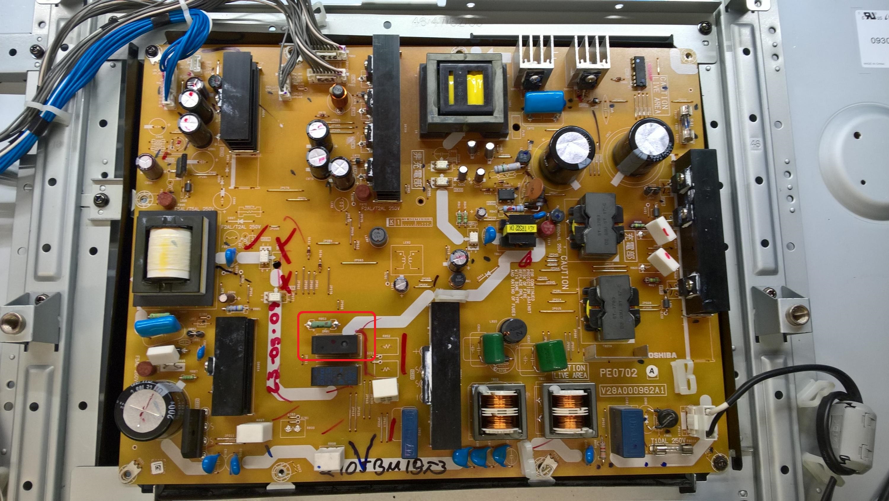

PE0702A, V28A000962A1 (5V Yes, 12V/24V NO)
  • Badger237
    • May 2020

    Good call on the FET's! Q821 was showing shorts between all pins, I removed it from the circuit to confirm that and that the pads were not shorted to each other. I should also point out that there are marks around the two power resistors near the FET's where it looks like it got a little hot. Will be ordering a new FET today.

      Re: PE0702A, V28A000962A1 (5V Yes, 12V/24V NO)
      Check the gate resistor when replacing the FET. I would also change Q820 to be on the safe side and again check the gate resistor
        If by the gate resistors you mean R827 and R828, they check out, those are the resistors I had mentioned had burn marks around them. Their resistance is still spot on, so I'll let them stay. While checking those, I discovered one of the fusible resistors had opened, R821. Will replace Q821 and R821. R820 is still closed and Q820 still checks out, so I plan on letting them go as well, if I was fixing it for someone else maybe I would change them.
                  Have you found a schematic for the power supply. You have four red wickman fuses, the red circular fuses. Are they all OK.
                  There's a resistor alongside one of the relays with a dark mark on it but the picture is not well focused. It could be R853. Have you checked it out?
                  There are also 4 white large ceramic fuseable resistors that you can test are not open circuit. Also check R850 which should measure 1.8 ohms.

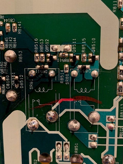

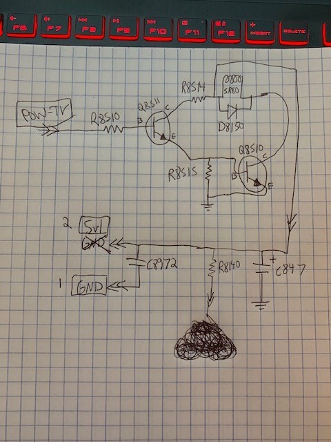

                  • R_J
                    • Jun 2012
                    • 9518
                    #29
                    Does POW_TV connect to JP051 (near the relays)? Also does Q8510 emitter connect to hot ground (JP062)
                    If the above is correct, POW_TV connects to R8510 which turns on the base of Q8511, Q8511 collector connects to 5v so when turned on the emitter supplies 5v to Q8510 base, which when turned on connects the relay coil to hot ground.

                      #30
                      Here are my findings:
                      I will say I cannot confidently determine the direction of the coil diode or that the transistors are NPN or PNP without removing them from the circuit, and they are SMT and small which is a huge pain for me. I will energize the circuit and take voltage measurements tomorrow.

                        #31
                        The diode is backwards, the cathode should be to the supply (5v) Do the transistors have any markings? you may need to clean them with alcohol or something similar to read them.
                        Q8511 might be (LY)
                        Q8510 might be (CCA)(CCB)

                          #32
                          Good call on Q8510, I powered the circuit (shorting 5v1 to POW-TV with 1k Ohm resistor) and found sufficient voltage at the base. After removing the transistor from the board, I tested it and found an open in all directions between all pins. Will attempt to find a replacement, as the transistors I have are all THT.

                            #33
                            Q8511 (LY) = 2SC4116
                            Q8510 (CCA) = 2SC3326

                                #35
                                Howdy everyone!
                                Good news, after soldering in the new transistor (I ordered a CCA and they sent a CCB) the relay now closes when the 1k ohm resistor is placed between 5v1 and POW TV. I still get no rail voltages, however. Is there another pin that needs 5 volts? both bridge rectifiers are at full power (160V), and I am testing it on the bench. What do I need to do to get 12, 18, and 24 on the meter?
