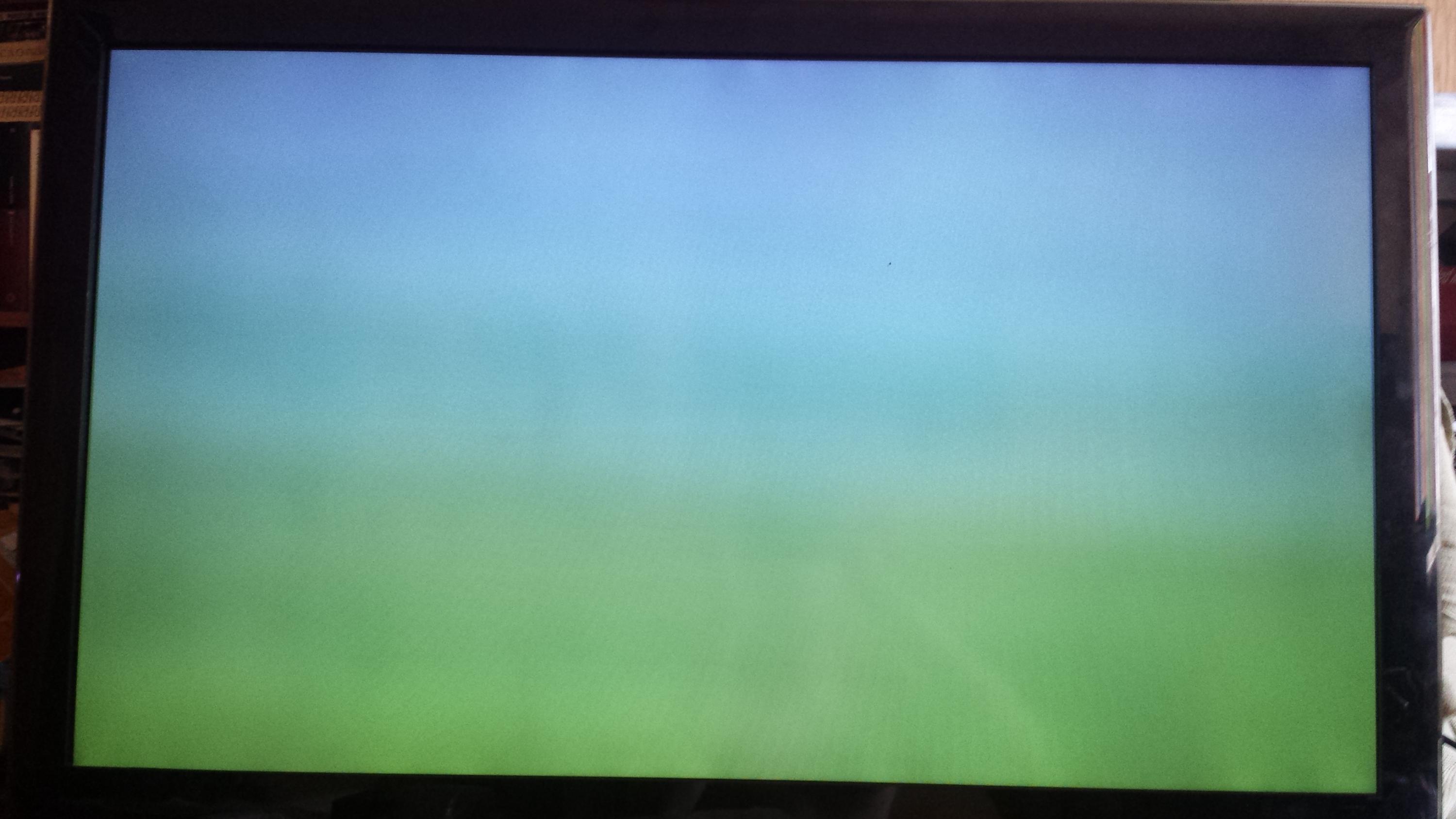

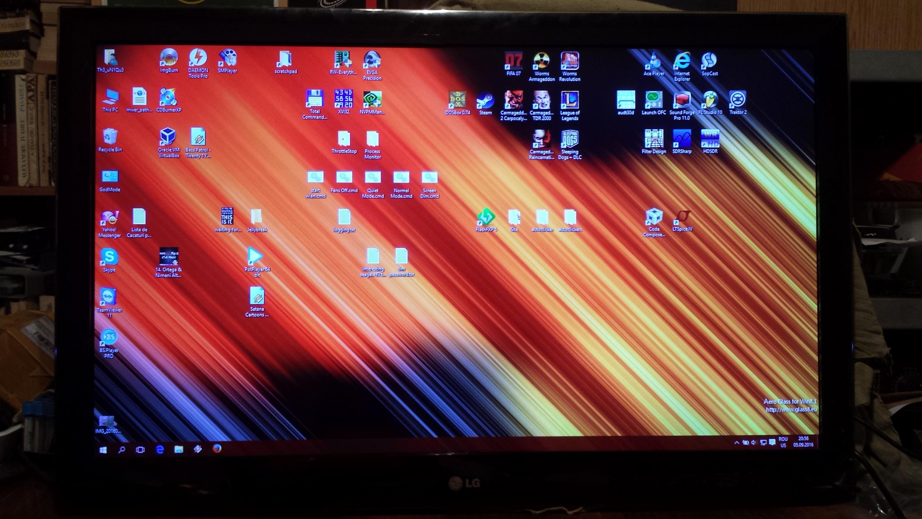

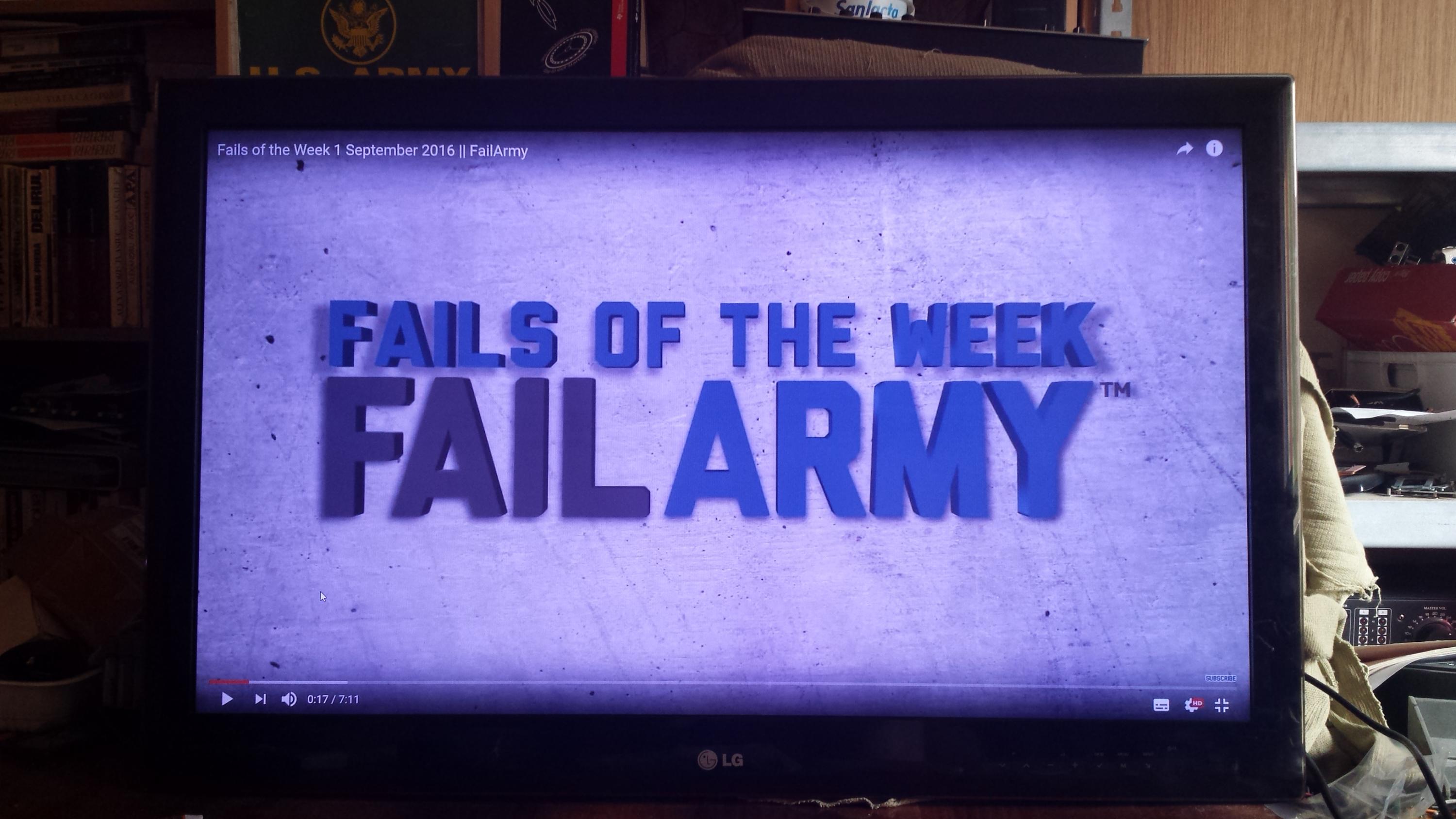

              Re: LG 37LE5300 no picture no backlight, request firmware dump
              Here are some pics, in the last one you can see the dirt. It also has very slight burn-in which shows up on bright pictures, so i left a "dead pixel fix" flashing pattern on before going to work.
                Yak that needs a bath lol, also the burn in is because the Lcd hasnt been used in a while I have found that Lg Lcds if not used in ages get image retention unsure why though.
                  Well i wouldn't bathe it just for that one speck of dirt, i can take that off with my tweezers and put it back together.
                  However this came from a smokers' house as i found smoke residue even underneath the LCD frame. The contrast seems to me a bit weaker than expected so maybe a good wash of the polarizers would help that.
                    Been using this TV to watch youtube mostly, and also to mess around doing some music in FL Studio - i can finally see stuff properly in these crammed music making programs!
                    Have not gotten around to trying to fix the old board yet, or to taking apart the panel. I've had a lot of work to do and also had bad insomnia all weekend, fortunately i managed to get rid of that last night.
                    Overall i am very happy with this TV. I like the colors, the auto backlight adjust ("eco mode") could use some work but i still left it on. There are lots of picture adjustment options - more than some monitors have, for that matter! There is even a built-in calibration wizard which is great. Also "Trumotion" (frame interpolation) works great for YouTube videos - i don't remember liking this feature on Samsung TVs, it made motion look too soft. Built-in speakers are good enough too, for when i don't want to be tempted to disturb my neighbors.
