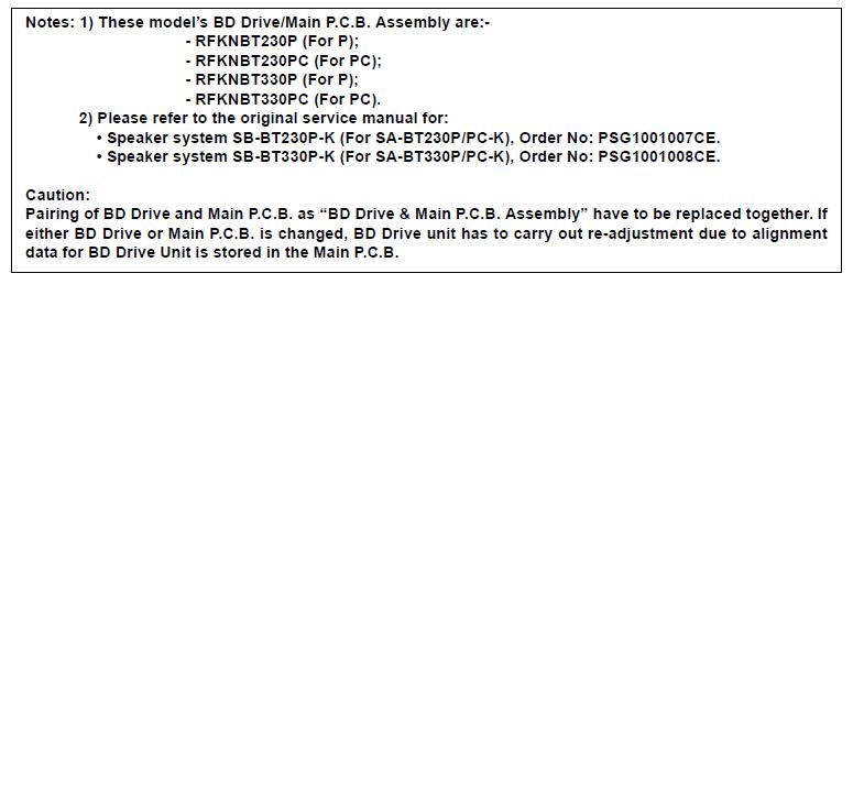

                  This is from the manual:
                  F76 error is "Abnormality in the output voltage of stabilized power supply" Description of error "in normal operation when DCDET1 is detected (low) for two consecutive times, F76 is displayed on FL for 1 second and after that PCONT will be turned to (low). This is due to any of the DC voltages (+9V, +7V, -7V, +5V, +5.3V etc.)
                  so bad C5712 (main filter) could cause the error.
                  Also mech & main board are replaced together ( I did a bunch of these when they were unde warranty)
