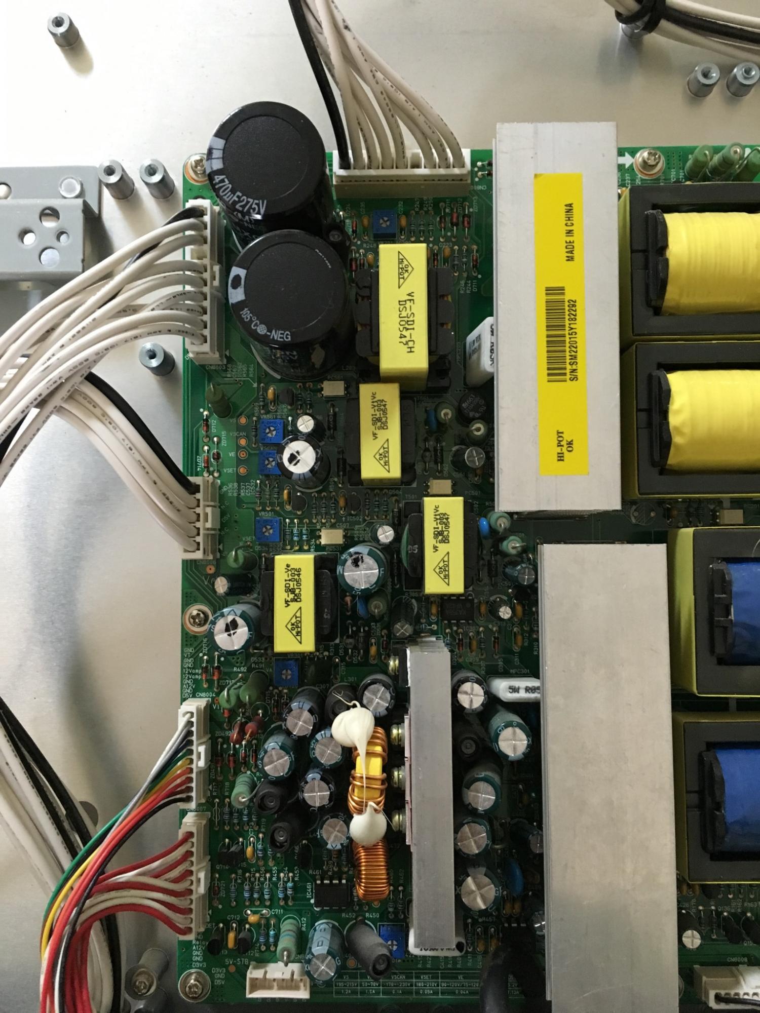

    I picked up a magnavox plasma 42mf230a for free that randomly turns on by itself and off and then would just powers cycle and makes a click sound when powering on and off. The image looks great when it works. Sometimes it will work for 30 mins or longer and sometimes it's after just a minute.
    I downloaded the service manual and checked voltages coming from the power supply and hey all seem to be within spec. I checked e power supply board for bulging caps and did not see any but went ahead and resoldered them in case of a cold solder joint. I also unplugged the "Y" board and "X" board and tv would still power up and down on its own. I even went as far as to unsolder the rfi sensor for the remote to make sure it was not picking up something. He tv did not come with a remote either so I can not go into the service menu.
    Any other ideas? I'm pretty sure it is probably a cap issue on the power supply but don't want to randomly change them, there are a lot of them. On a side note all the boards and panel are labeled Samsung.
    One other thing I have not looked at is the PDC board aka power down control board, wonder if that may be an issue?

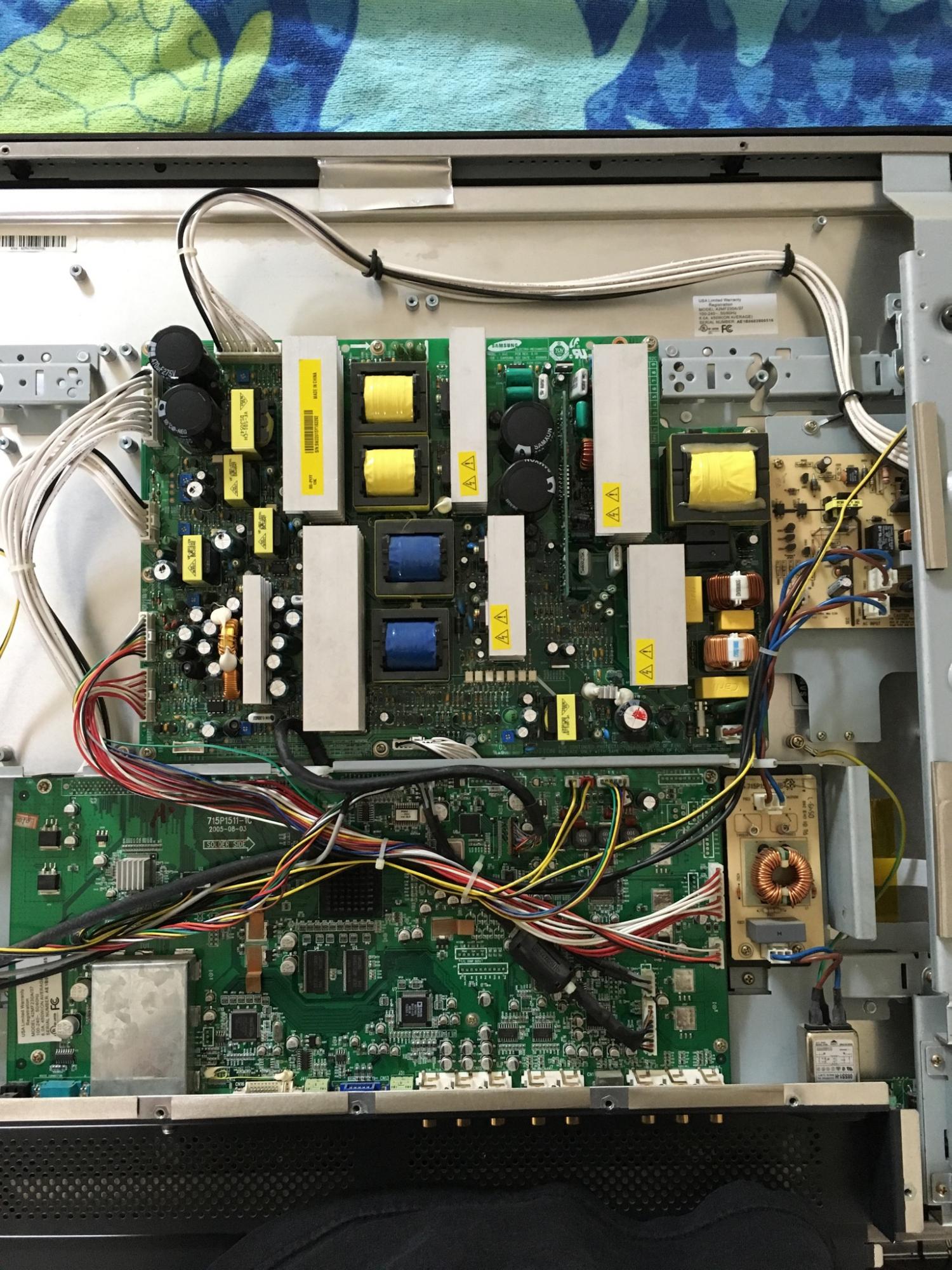

    Re: magnavox plasma 42mf230a Power issues

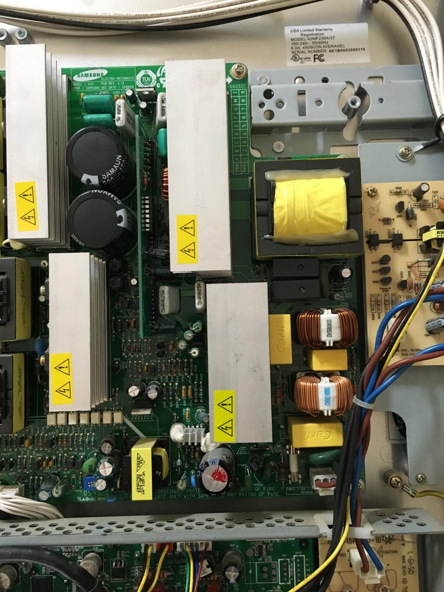

    Images of the boards please ? Also maybe try heating the Psu with a hair dryer see if it goes off faster ?
    • splatee
      • Jul 2016
      • 95
      Here are some pics of power supply, and other boards
      • splatee
        • Jul 2016
        • 95
        Power supply
          Another of power supply

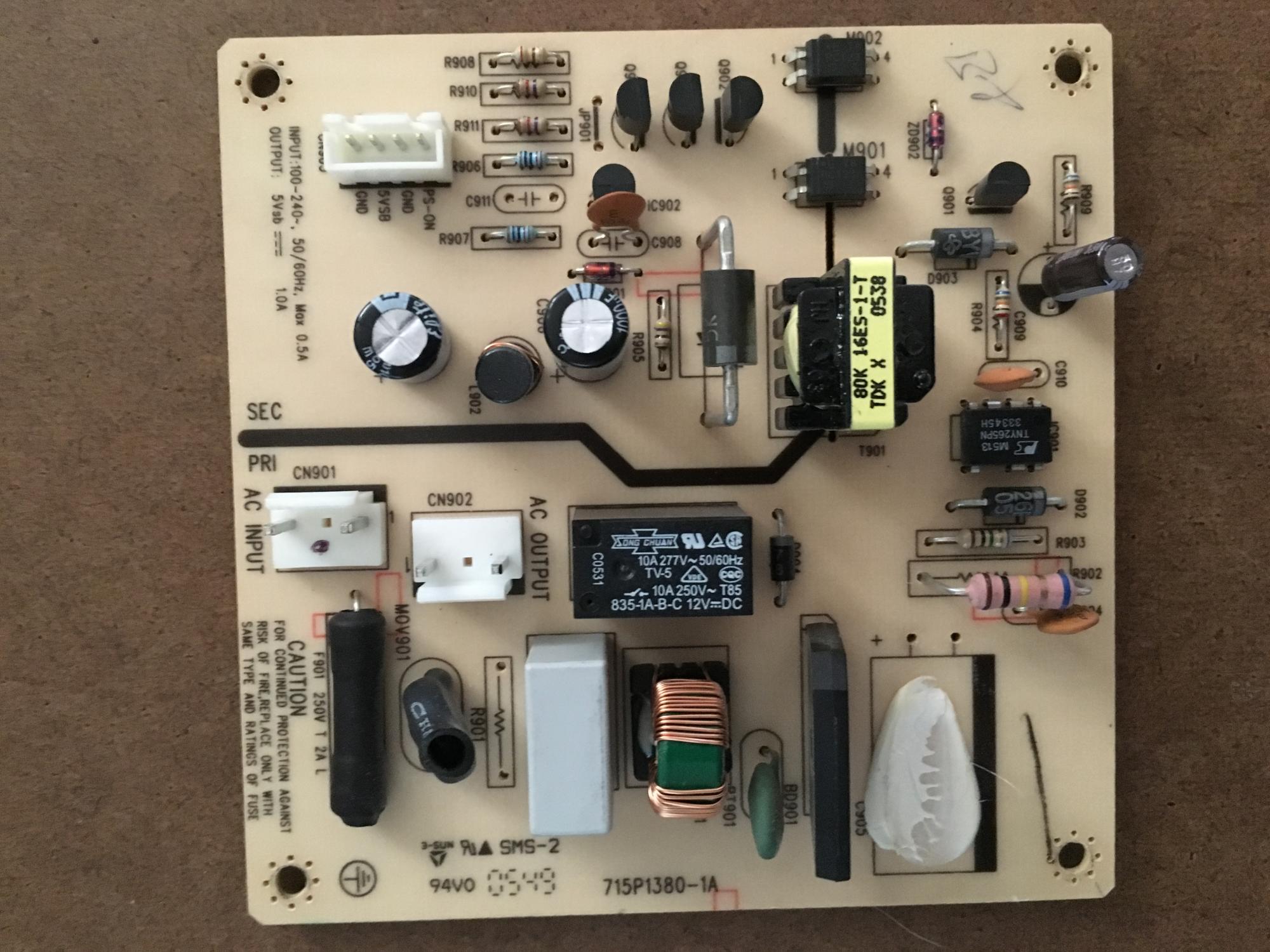

            Looks like i narrowed it down to the Power Down Control Board "PDC". Checking voltages on one of the capacitors it should be 300v but only reading 158v. From there it says to check an IC and a Diode. I have not checked those yet because i pulled the cap.
            Also i had it completely disconnected from the main power supply board and it was still powering on.
            Thank you
                Image of board

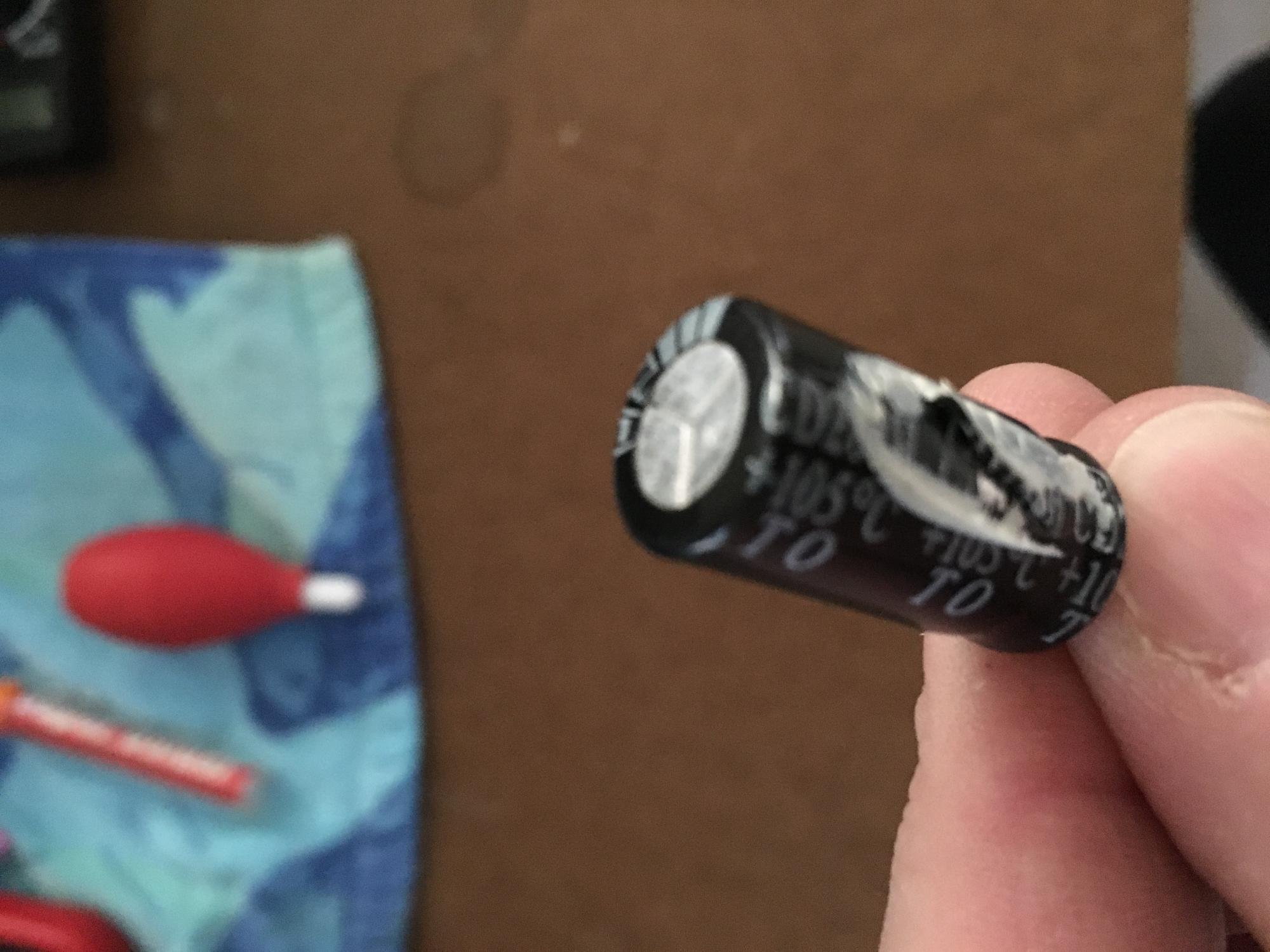

                  Capacitor
                  • splatee
                    • Jul 2016
                    • 95

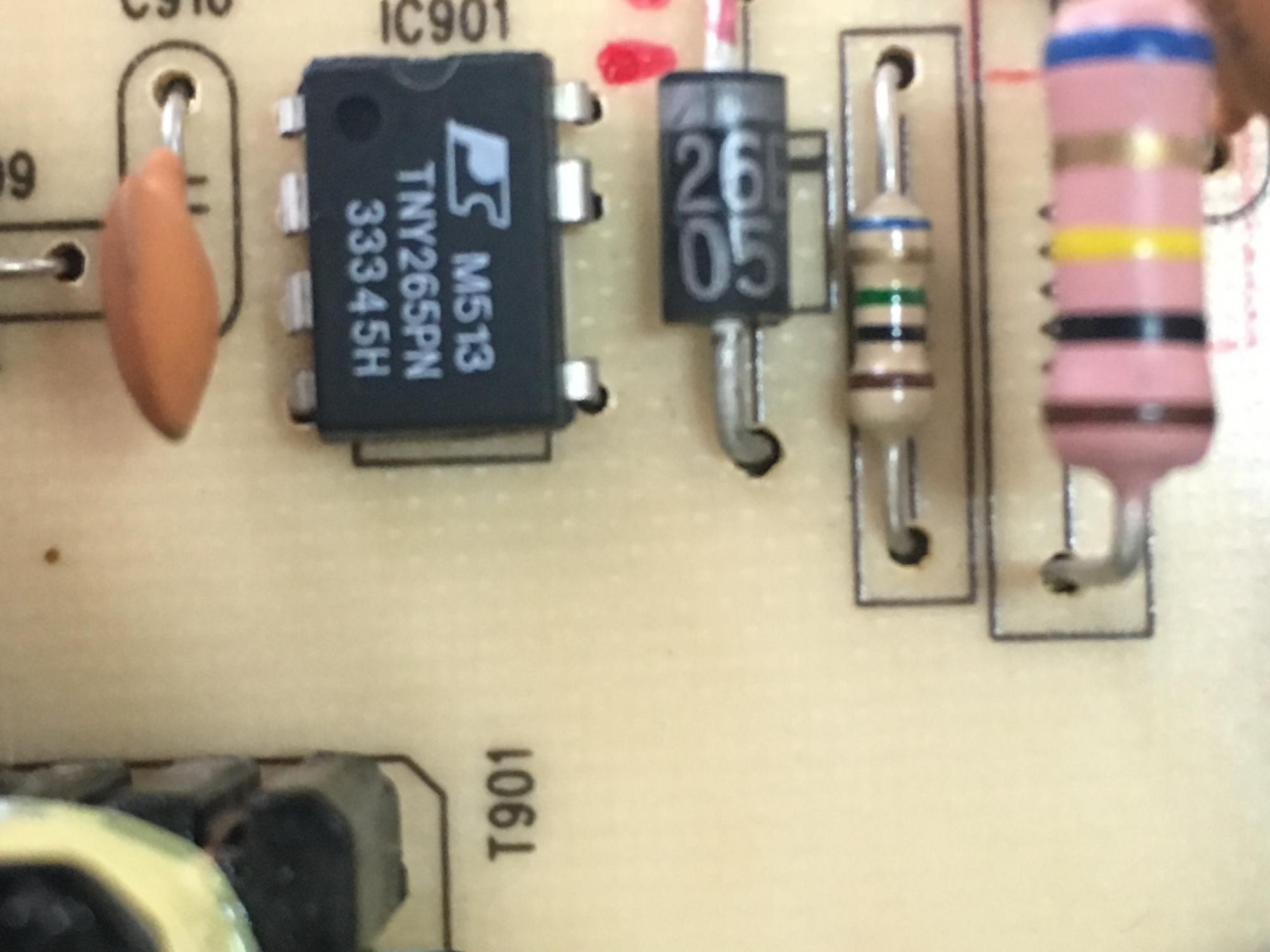

                    Well still no luck. Changed the capacitor and still reading the wrong voltage. I went ahead and checked the fuses and diodes on the board and they are fine. The only other thing to check for per the service manual is an IC chip on that board. I went ahead and ordered one from Mouser.
                    The main number on the chip matches but when I googled it with the rest of the other numbers it did not come up. Hopefully it works if not I guess I will just dump the set.
                    • splatee
                      • Jul 2016
                      • 95
                      Tv is back up and working again. Replaced the IC chip that I ordered from Mouser.

                                  I will swap the tact switches on the keyboard and see if there is a change. I may just order a PCD board as well. Because even after swapping the IC chip and capacitor on it I still am not reading the correct voltage at the capacitor. It should read 300vdc but I am getting around 153vdc. There may be some other component on the board that's bad.
                                  • R_J
                                    • Jun 2012
                                    • 9630

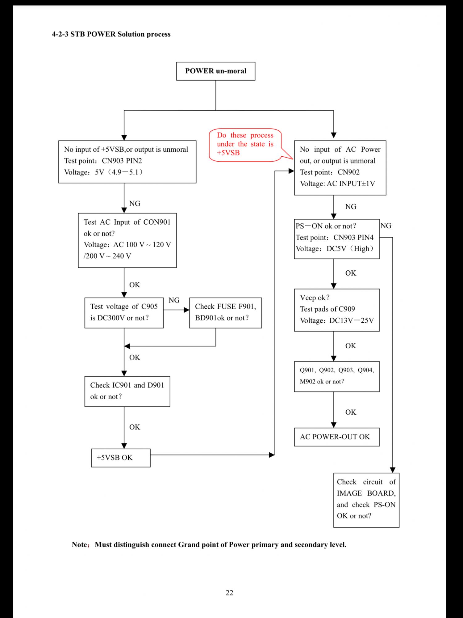

                                    Are you talking about this board? because all you are going to get on c905 (with 120 volts ac input) is 160 volts dc, if you supply it with 240 volts ac (europe) then you will get around 300 vdc. thats the only reason for the high voltage rated capacitor
                                    See that printing on the board near the 4 pin plug?
                                    input: 100 ~ 240 50/60 Hz
                                    All the board does is come up with + 5 volts standby, and supplies it to (I assume) the main board, the main board then tells the PS-ON pin to turn on the relay which takes the a/c input on cn901 and connects it to cn902 which supplies the main power supply board.
                                    • splatee
                                      • Jul 2016
                                      • 95
                                      Yes that is the board. Ok I was going by what the service manual said I should get at c905 it did not specify (Europe). I am going to open it back up again and check voltages again. Also pull the keyboard and swap the power tact button.
                                      This is the flow chart I was using to trouble shoot.
