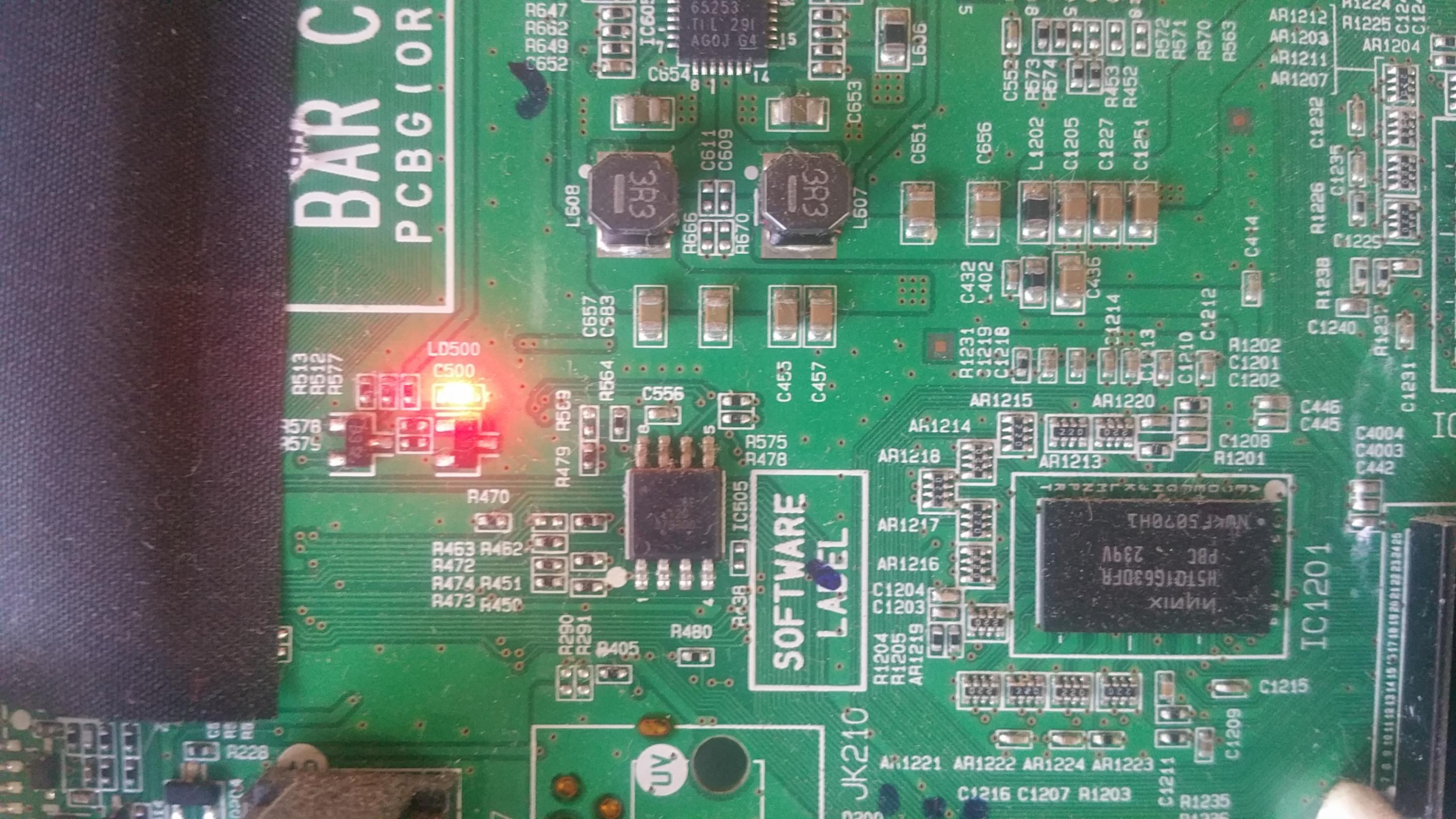

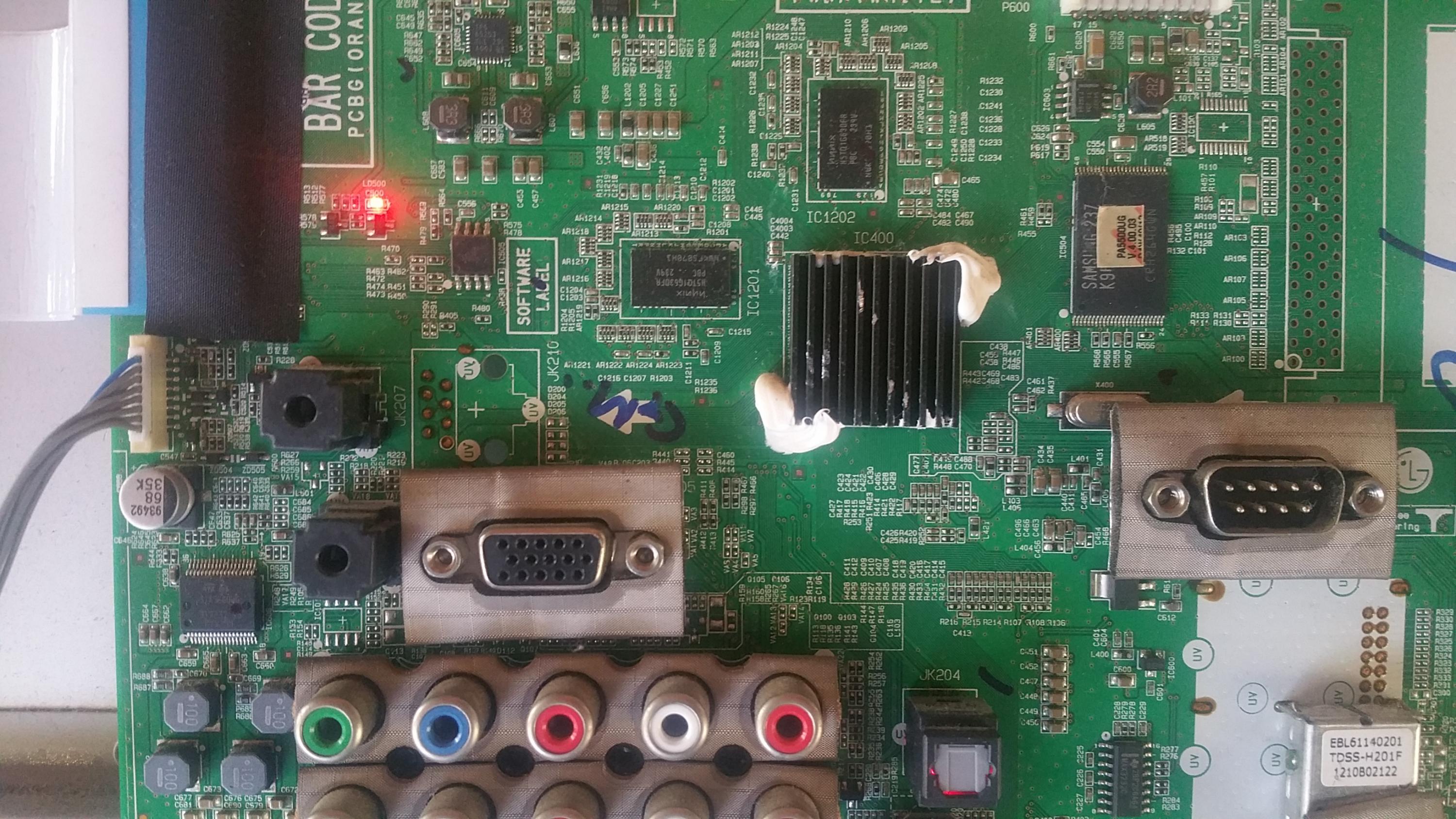

      Attached pictures of the input board.
      Oh, and about the sound: I did get it to give me some static, but no picture, only once. I think it's stuck on an input with nothing coming in. But I can't change the input to test again because I can't see the screen...

        Thanks Moreno! When you say "the main board" Is that what I'm calling the "input board"?

          Thanks Moreno! When you say "the main board" I'd that what I'm calling the "input board"?
          Like in your post #3 first picture. That's the main board.

            Probably Bga solder under the main Cpu which is mounted under the heatsink on the Mb. Maybe reflow it see if it sorts it ?

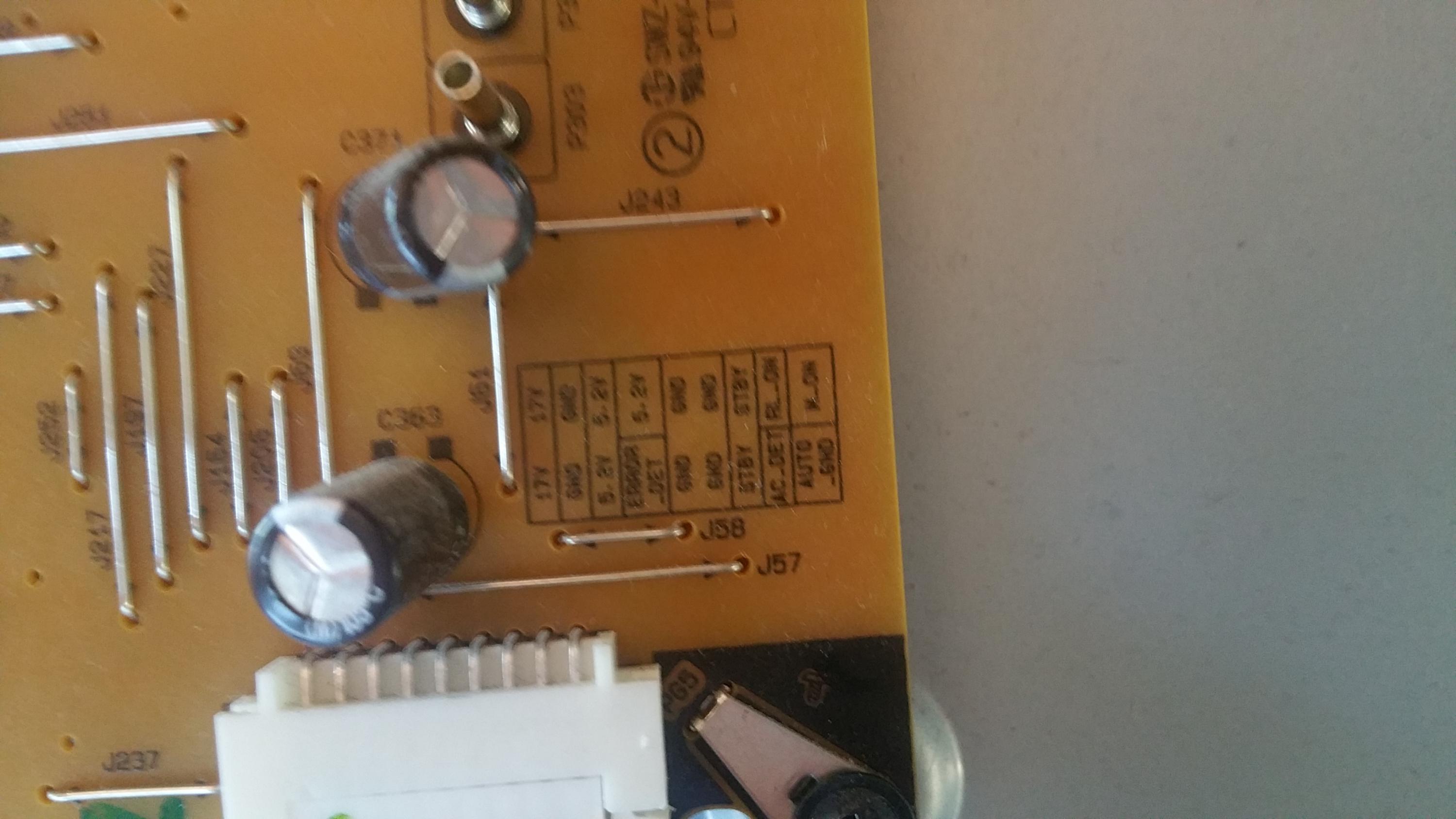

                        There are two rows of pins, and a key coming of the power board (picture attached). The pins are in rows of nine (top and bottom). I disconnected the wiring harness to the main board, and measured the voltages supplied. They are (name, then measurement)
                        1) "17V" measured 17.3V
                        2) "GND" measured 0V (of course)
                        3) "5.1V" measured 5.1V
                        4) "Error Detect" measured 5.1V
                        5) "GND" measured 0V
                        6) "GND" measured 0V
                        7) "Stby" measured 5.1V
                        8) "AC Det" measured 0V
                        9) "Auto gnd" measured 0V
                        Then the bottom set of pins
                        4) "5.2V" measured 4.8V
                        8) "AC Det" measured 4.8V
                        9) "Auto gnd" measured 3.8V
                        Figuring that "Error Detect" might be an error flag, I unplugged the zsus, and checked again - still 5.1V. Then I reconnected zsus, unplugged ysus, and checked again - it dropped to 0V!
                        Does this mean there's a problem with the ysus?

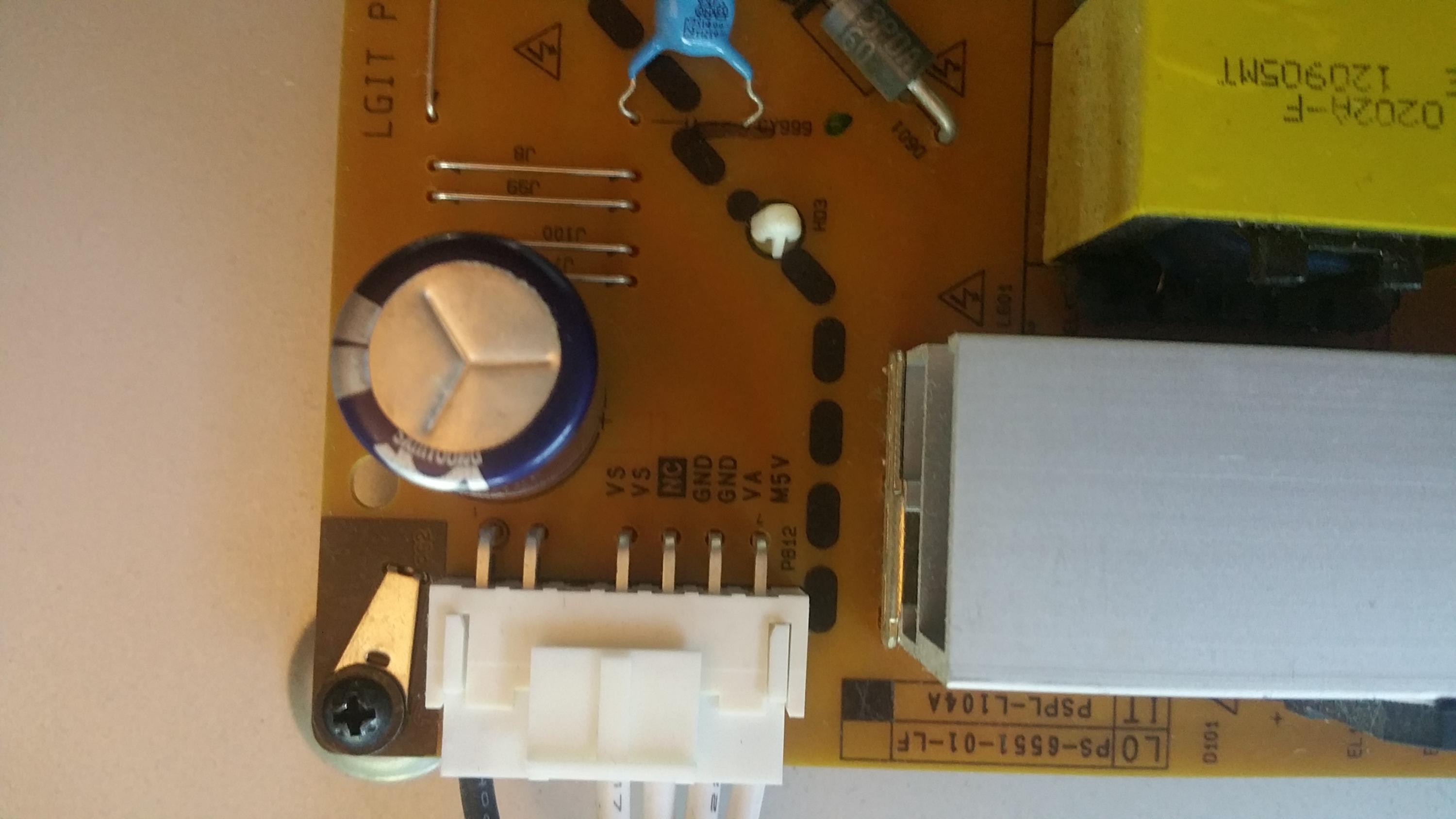

                          Next, I checked the power coming into ysus (again, picture attached). They measured
                          "VS" measured 205V
                          "VA" measured 55V
                          "M5V" measured 5.1V

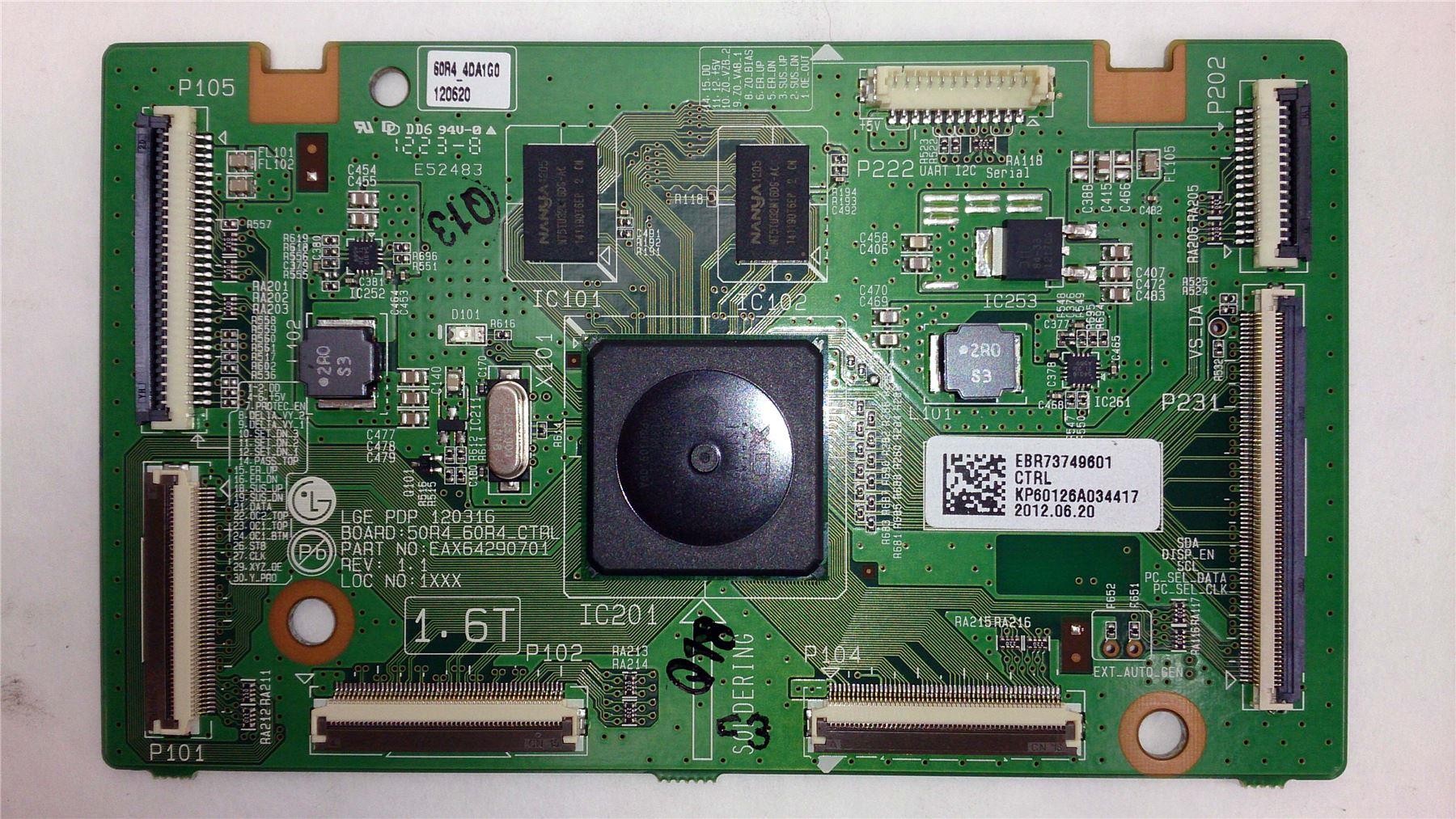

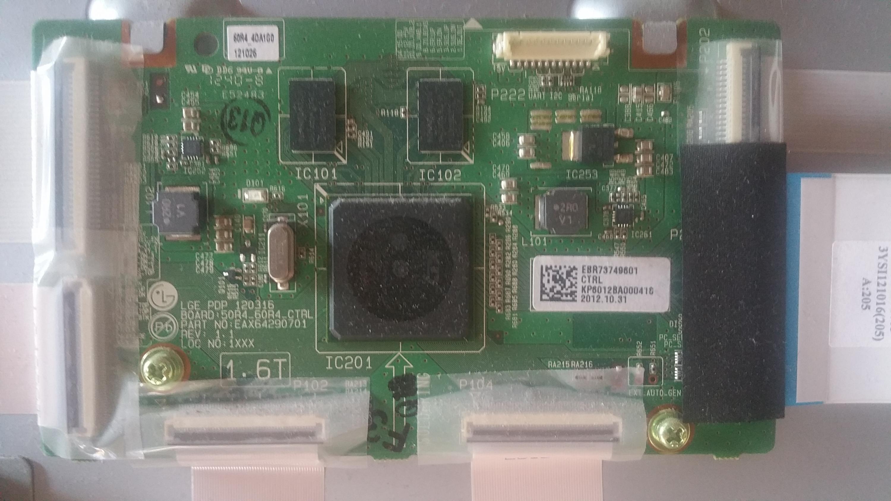

                                Upload picture of control board
                                  Picture attached to post 3

                                    Picture 3 is the main board not the control board
