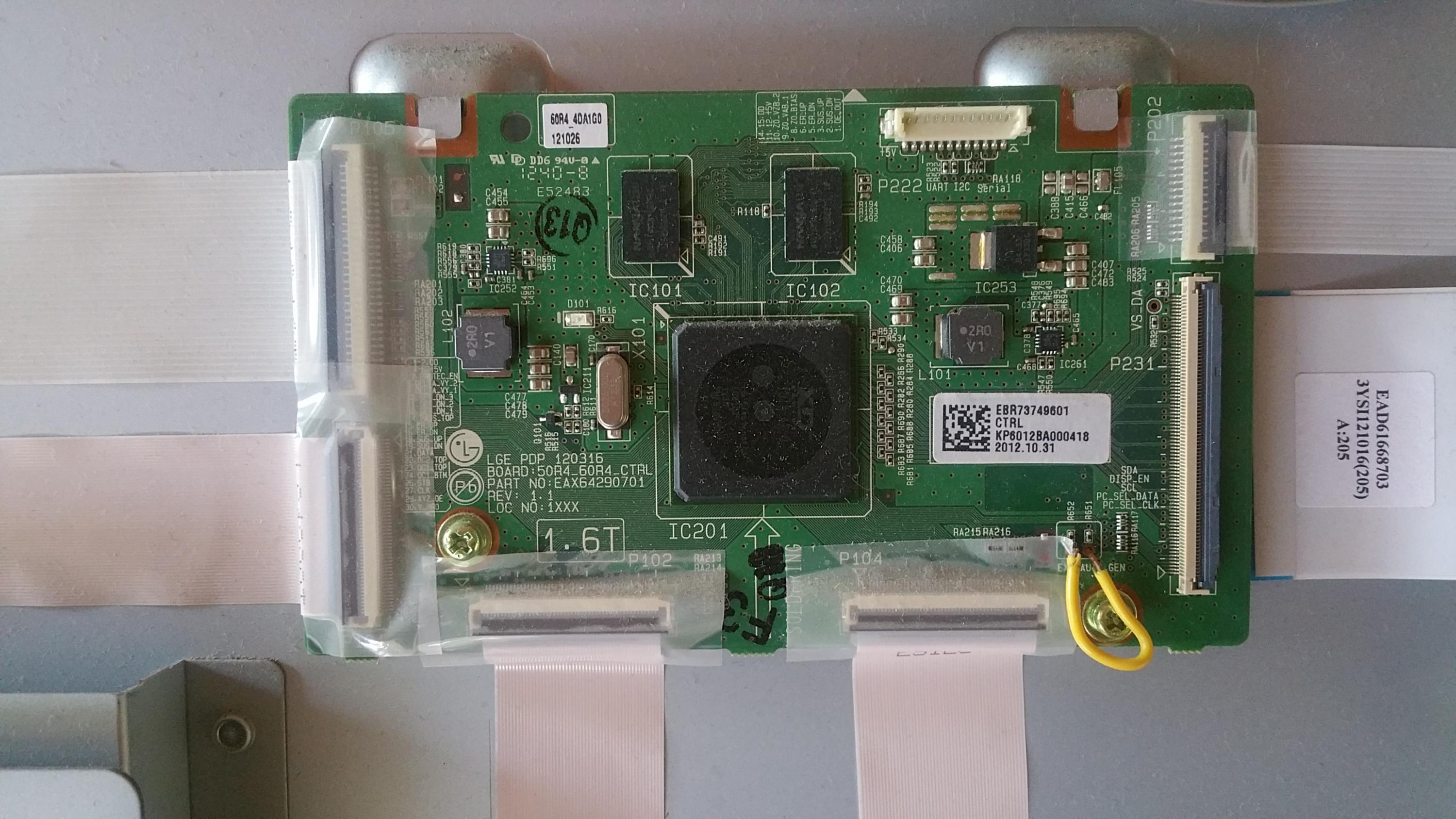

    Follow the link in post#18 which tells you how to complete this test.
    I don't see anything for LG in there, although I only skimmed it.
    Anyway,
    To run test patterns on your model, firstly Disconnect the LVDS cable (the one with the black tape)
    Next connect the 2 holes marked Ext_Auto_gen with a bit of wire, paperclip etc.
    Plug in the tv and turn it on.

            Done! Thank you Hamie!
            Screen comes in and runs test pattern. Whole screen, red, then blue, then green, then alternating black and white in different patterns. Looks normal to me (though, admittedly, I don't know what "normal" looks like).
            I'm assuming this to mean the YSUS and Control board are good? And now likely problem is with main control board and/or zsus?

              Yes, you have a faulty main board.
              Possibly needs the BGA reballed or reflowed.

                I have the exact same set and ran the test with the exact same results. Was the mainboard the final solution? Ciper108 never said if he fixed his plasma tv. I have run some of the voltage checks that passed - but not all the voltage checks. So am I to assume the screen test is final proof positive it is a mainboard?

                  Test-patterns OK, = mainboard stuffed.

                      Thanks guys - wanted to be sure before I locate a board.
