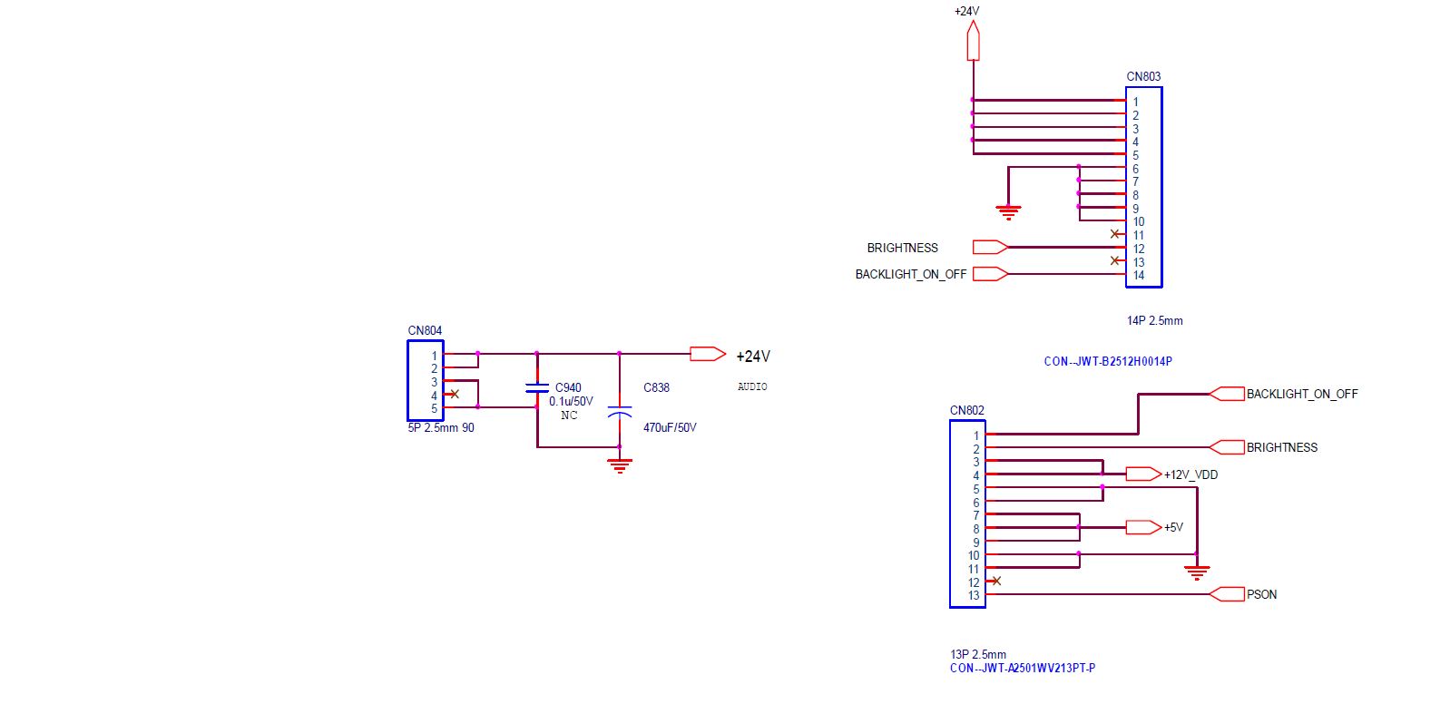

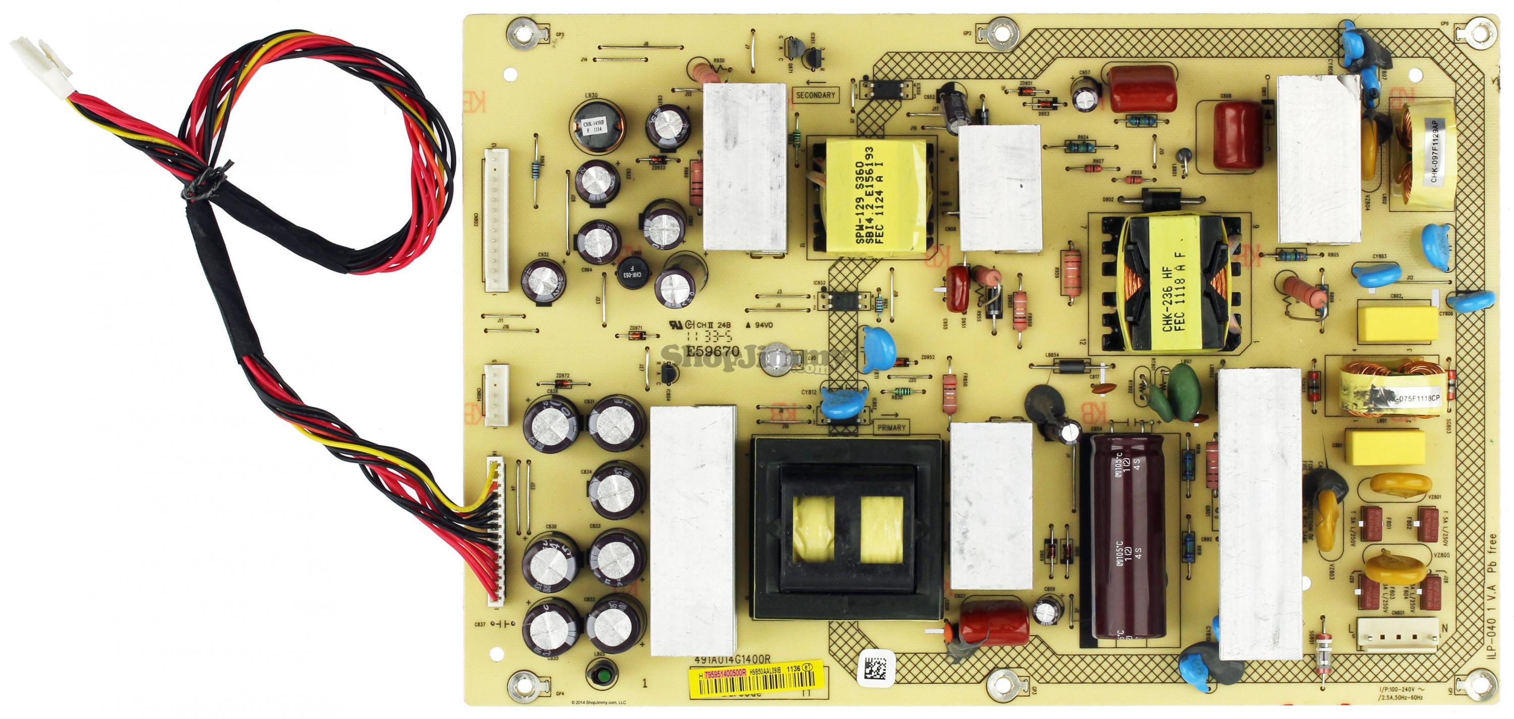

    Seemed like a main board issue. So I jumped PS-ON and BL-ON, backlight flickering. The 12V voltage comes up, but 24V is erratic, bouncing from 21-26V, every once in a while settling in at 24V. This happens with or without inverter board conncected.
    So I think the main board is bad, and another problem on the PS.
    Is there something common that would cause this unstable voltage, even with no load?
    Also note the voltage at the large cap also fluctating when PS-ON, from 390-398V +-
    Attached is SM, and you can find schematics starting on page 119. Any help would be apprecited! Thanks

                          I am jumping the PS-ON and BL-ON with 3.3V, and turning on the PS. This is when 12V and 24V come up, but I the backlights were flashing on and off. When I checked 24V line it was fluctuating.. I am just trying to see how I can narrow down where the problem on the power board is. I know the main board is bad too.. Thanks.

                                Re: Sharp LC-42D69U won't turn on, has 5V standby.
                                The dim command signal stable?
                                • kevinm34232
                                  • May 2012
                                  • 1884
                                  Is DIM the BRIGHTNESS as in photo? I'll have to check again, but I think there was 0V. And remember, this is with the main board disconnected from the power board.
                                    the brightness is the same as DIM, 0VDC = NO BACKLIGHTS.
                                      BTW, what is the LCD panel model number?
