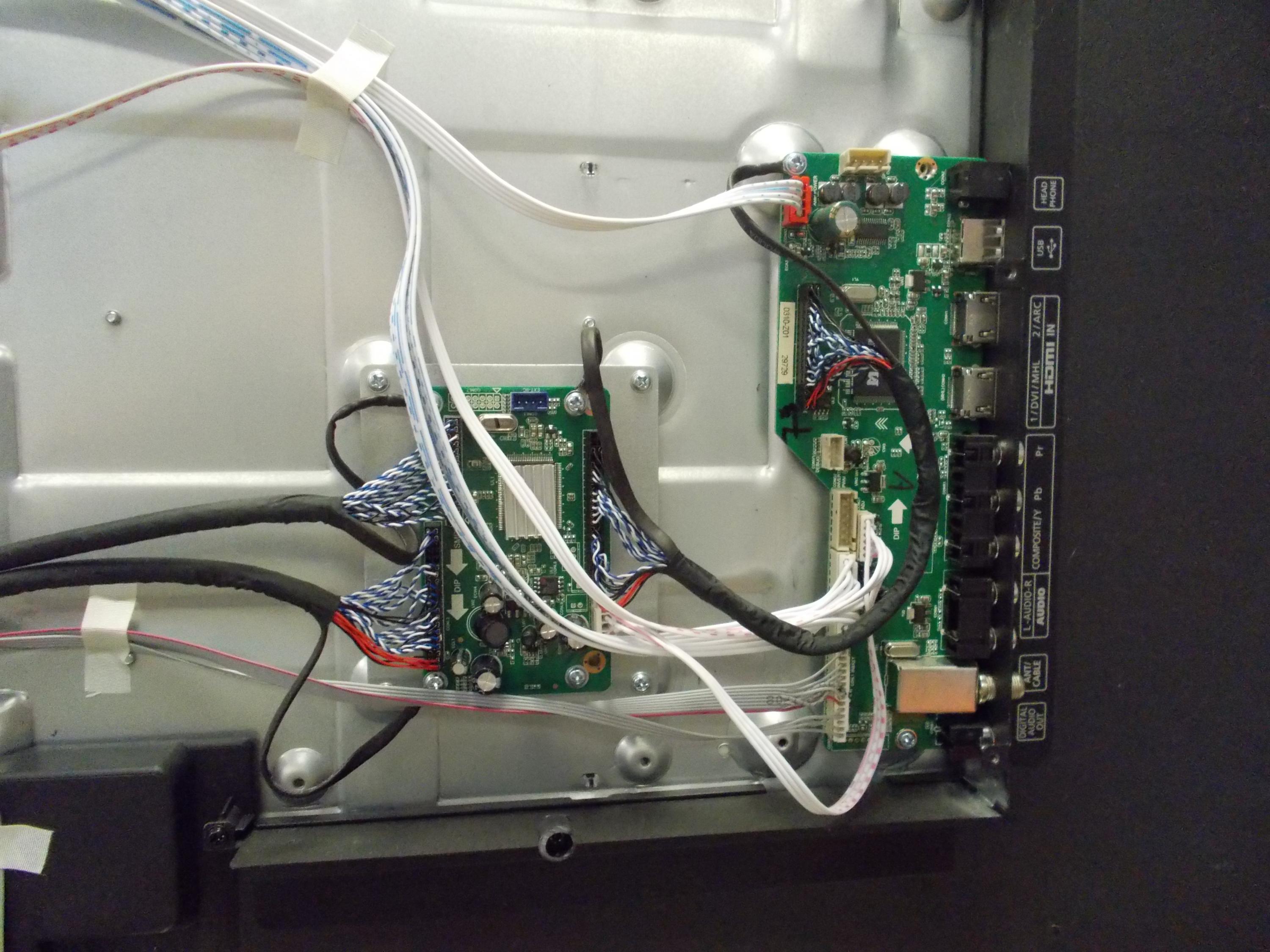

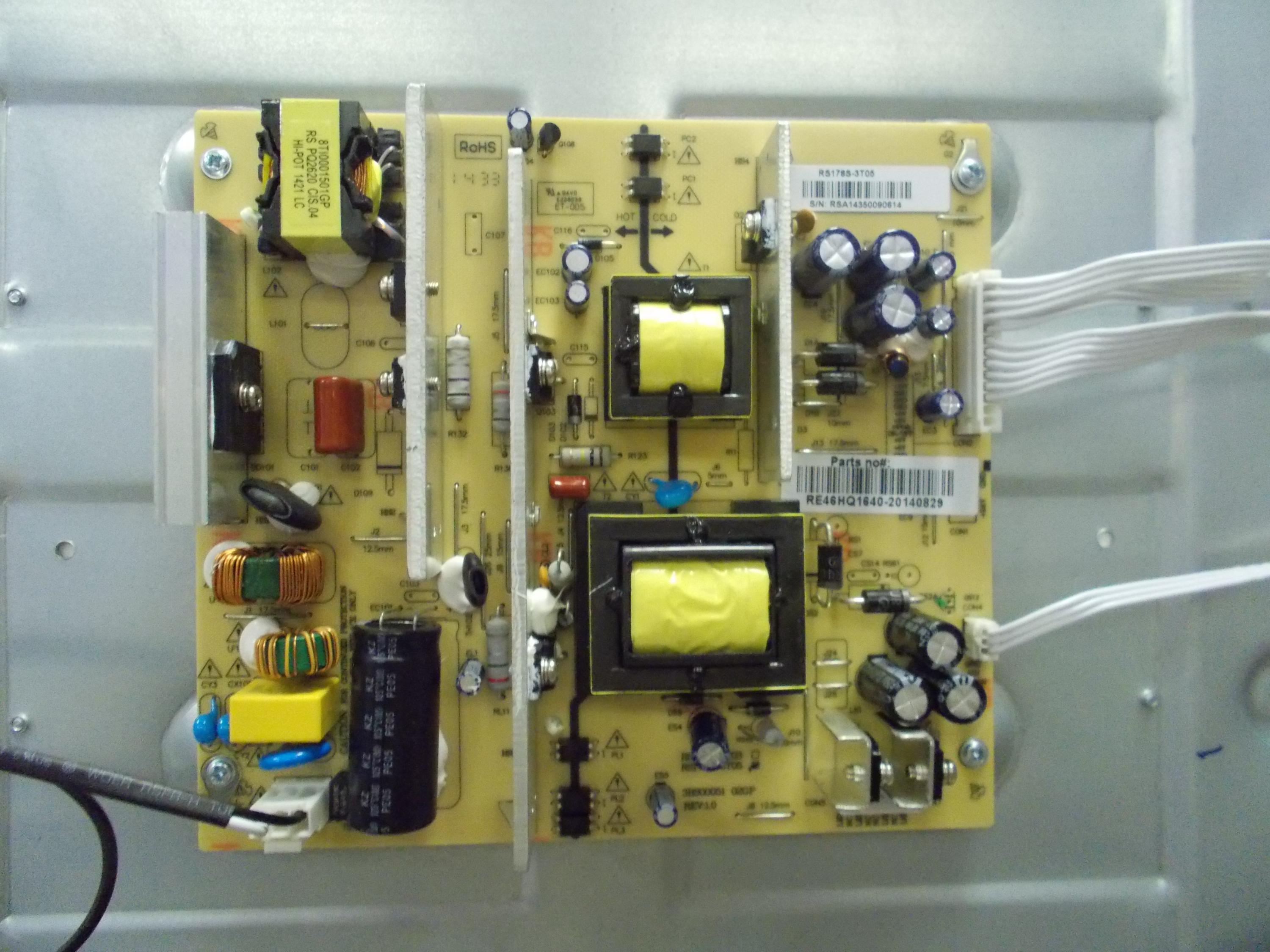

    I have an RCA LED55C55R120Q that I picked up from my local recycling center. It was in the original box and is in really good condition. It turns on with no backlights. This is what I have tested so far:
    I can see an image on screen with a flashlight.
    I get 3.3 at bl_on and adj pin and it stays steady.
    At LED + pins I get 132v when I turn the TV on but that quickly drops, eventually reaching less than a volt.
    I am guessing I probably have bad LED's but wanted to be sure.

    It probably has a bad led that pulls the voltage down. Tv turns on so good chance that the psu is good.

      Yes, it is a bad LED or two. IIRC, the white background in the LED "chamber" is stuck down with double-sided tape. Use a hairdryer to soften the glue while you remove it to get to the strips.

        Thanks for the confirmation on the LEDs.
