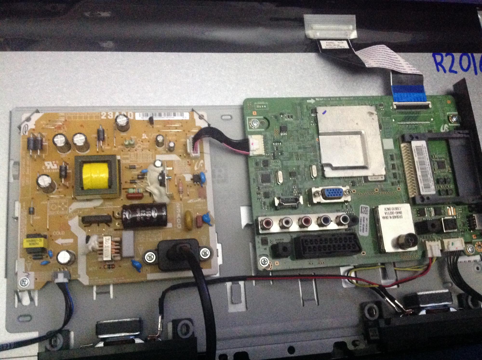

    Simple fix here chaps simple broken solder joint on the Psu switching transistor, alot of the joints were looking quite bad so possibly flawed from factory ? Either way resoldering them fixed the set.
    Interestingly enough set only has 79 hours on it so its basically brand new not a spec of dust or dirt in it.
    In the image it shows the Psu and motherboard, I added a heatsink to the main processor as it gets burning hot and wasn't heatsunk sort of an obsession of mine heatsinking things ohh well will help it last longer, I used a heatsink off a scrap board and stuck it down with thermal silicon lol
    Hopefully help someone here

    Is this a tv with a adapter as power supply? There is not much in there tbh! Cant be more then 200/300 euro haha

      Lol can you not see the smp in the picture haha
