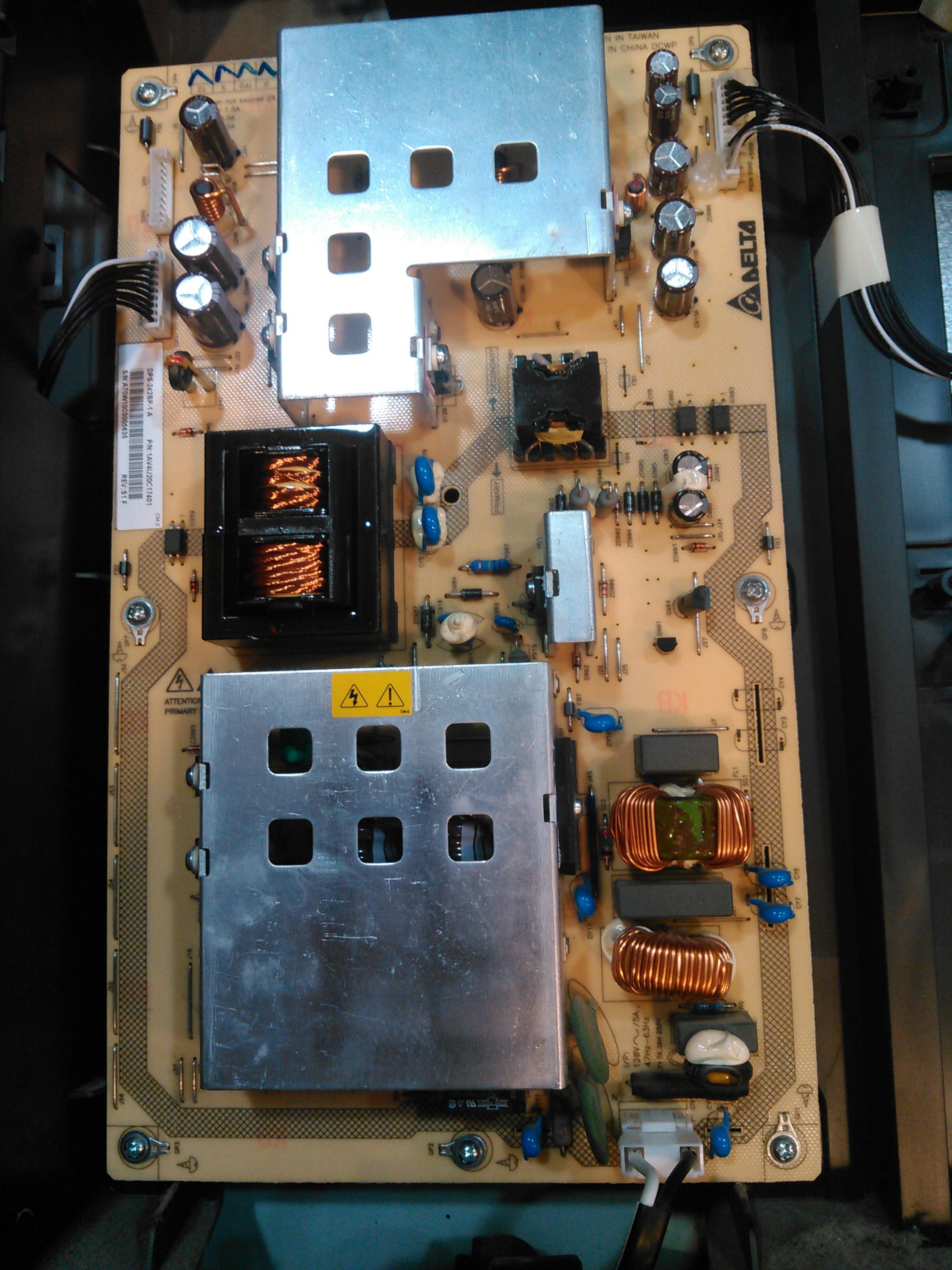

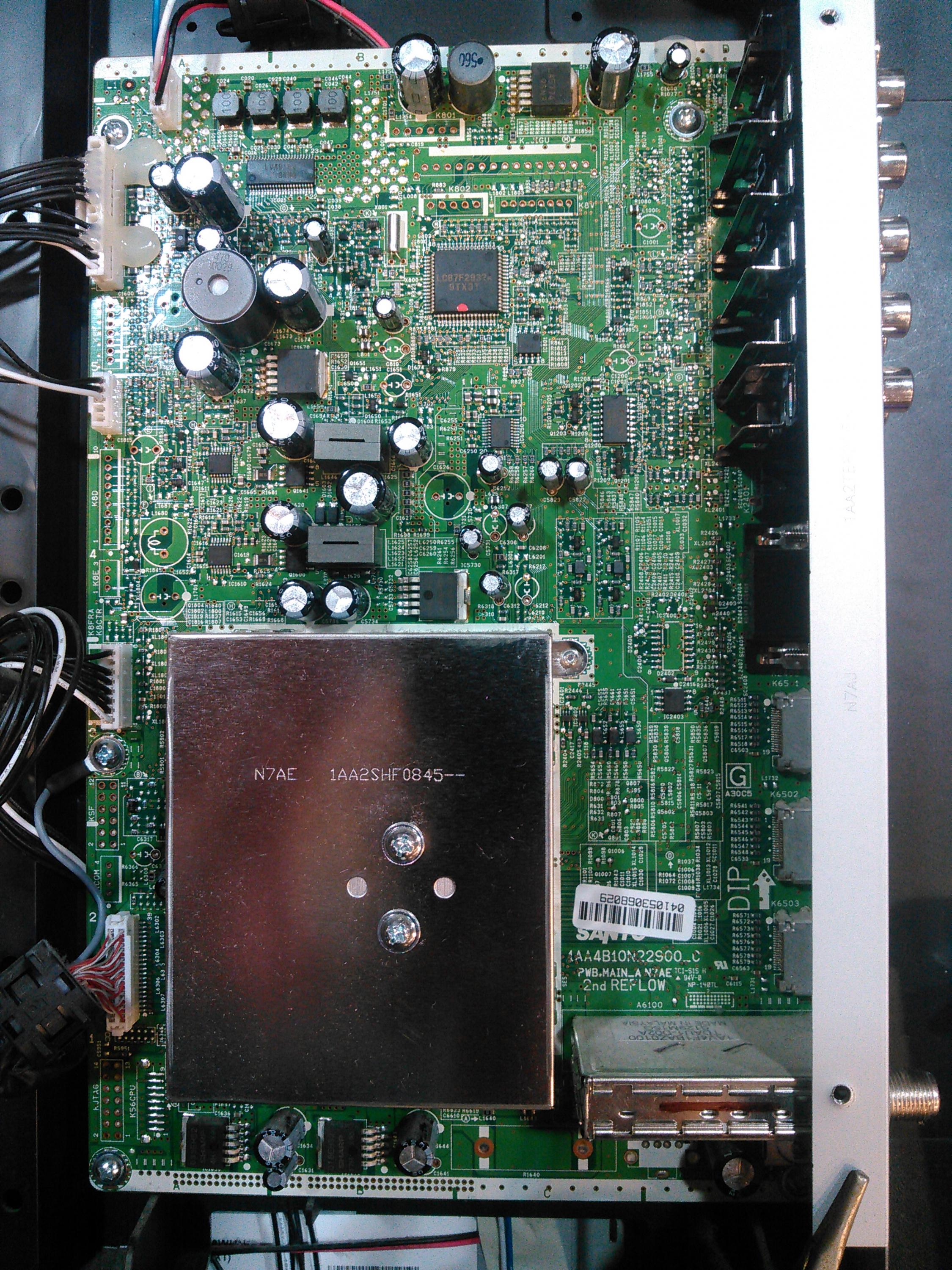

    I have a Sanyo dp42840 that cycles on and off over and over again. The backlight never gets a chance to come on.
    main board is n7ae
    I measured voltages on psb
    PS ON = 4.98
    5v = 5.02
    12v = 11.81
    24v = 24.05

        So all those Voltages stay at the same values but the TV is cycling ON and OFF?

          No, the voltages cycle on and off with the click of the power supply. The only voltage that never changes is the best 5vsb.

            I'm at work at the moment so this is just from memory. But I did check the pins 48 and I think it was pin 23 of the IC on the main board and they both have 5 v on v them. Fail safe circuit.

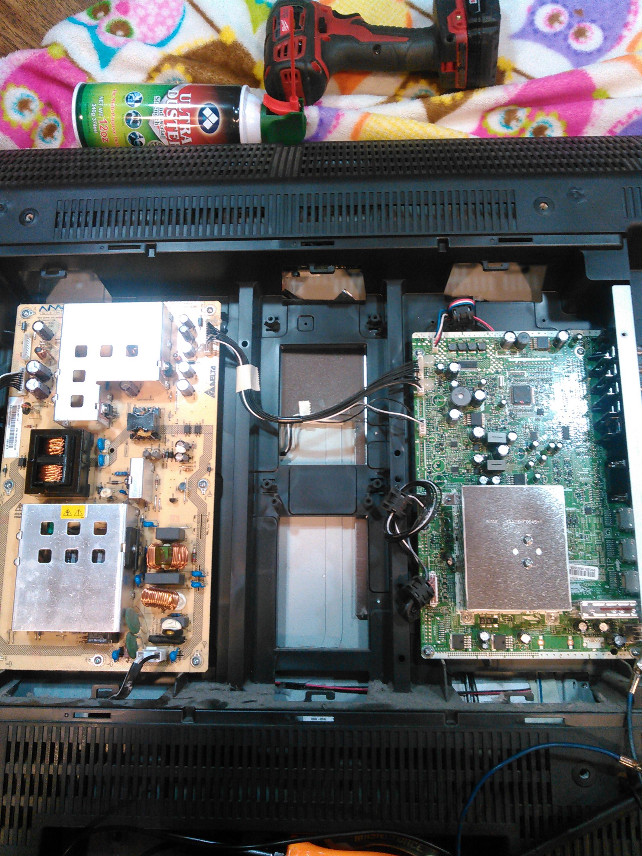

                Re: Sanyo DP42840 Cycles on and off
                Disconnect the cable to the inverter board to see what happen.
                Since the PS-ON is generated by the main board, then the main board some how is not sending steady ON command so the power supply is just going on and off due to ps-on cycling.
                • shadetreetrader11
                  • Oct 2015
                  • 230
                  Thanks BudM. I just unplugged the cable running to the inverter board and there is no change.
